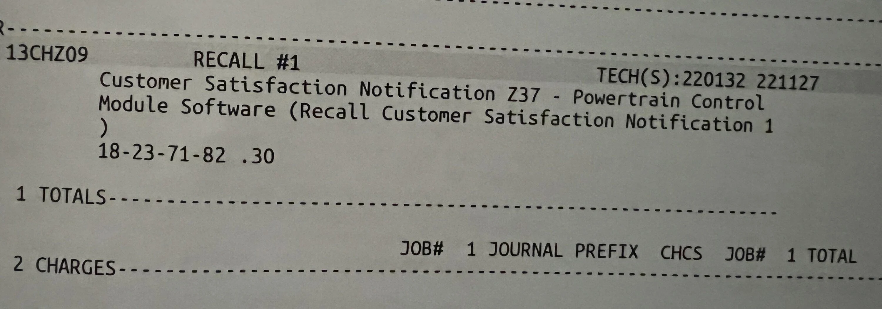

I just looked at the customer satisfaction letter copied on page one of this thread & it states "Z-37".
The Z-37 was just published this June & is the same as my VIN # reflects for service & is referred to above in reply #34. I'm going to speak with the service manager this week & report what he relates. Meantime this looks like a SNAFU.

Had mine in for my first oil change today and they said they did a pcm recall flash that I had no idea about. Finally had time to sit down and saw this thread. Was going to ask what it was all about.
Jeep Gladiator Throttle body recall for 21-22 gladiators 60729E2A-974F-4D6B-A82F-D87490AD07A4

Sounds like you got lucky that it worked!
when’s your build date? Mine was December 21
