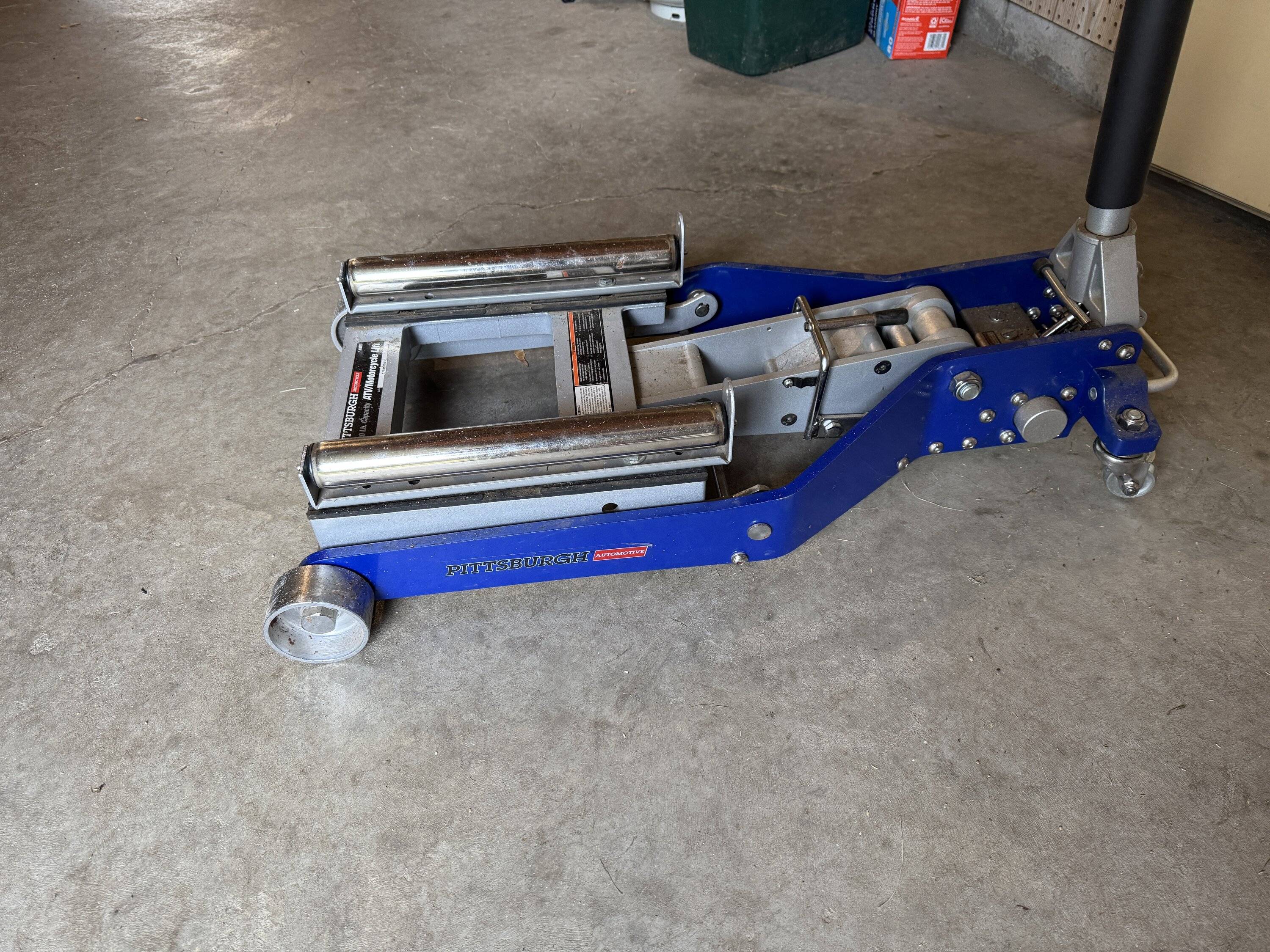

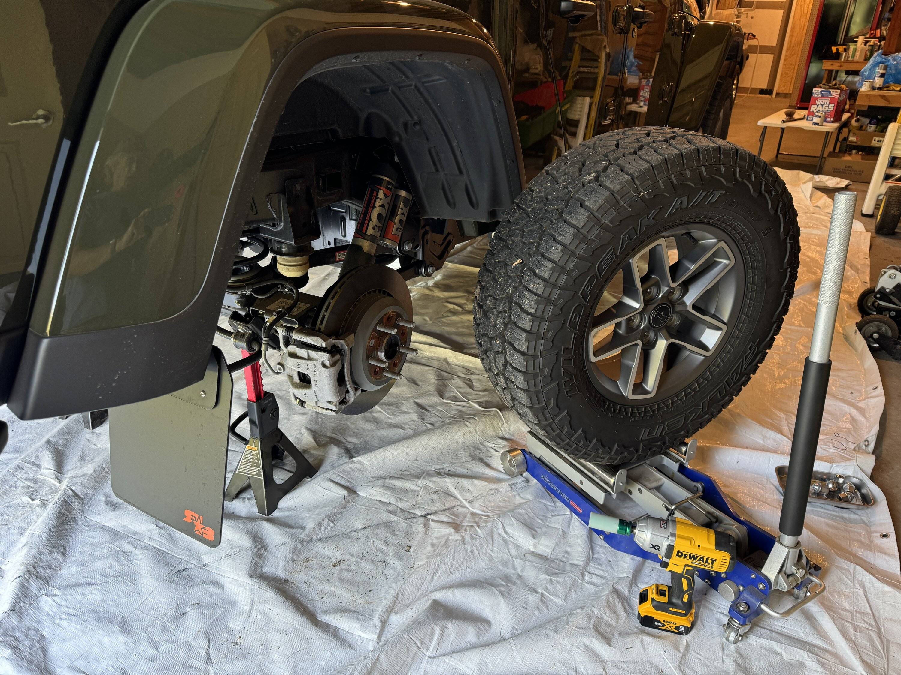

Just in case you have not thought of this . . . if you happen to have an ATV lift around, just add a couple rollers and you have a really nice way to dismount/mount wheels when you get around to rotating. The rollers are not essential, but makes it really easy to align with the studs.
Lots of choices around; I went with this lift years ago LINK. The rollers I used are not still around, but just search for Conveyor Rollers on Amazon and you will get a lot of choices.
