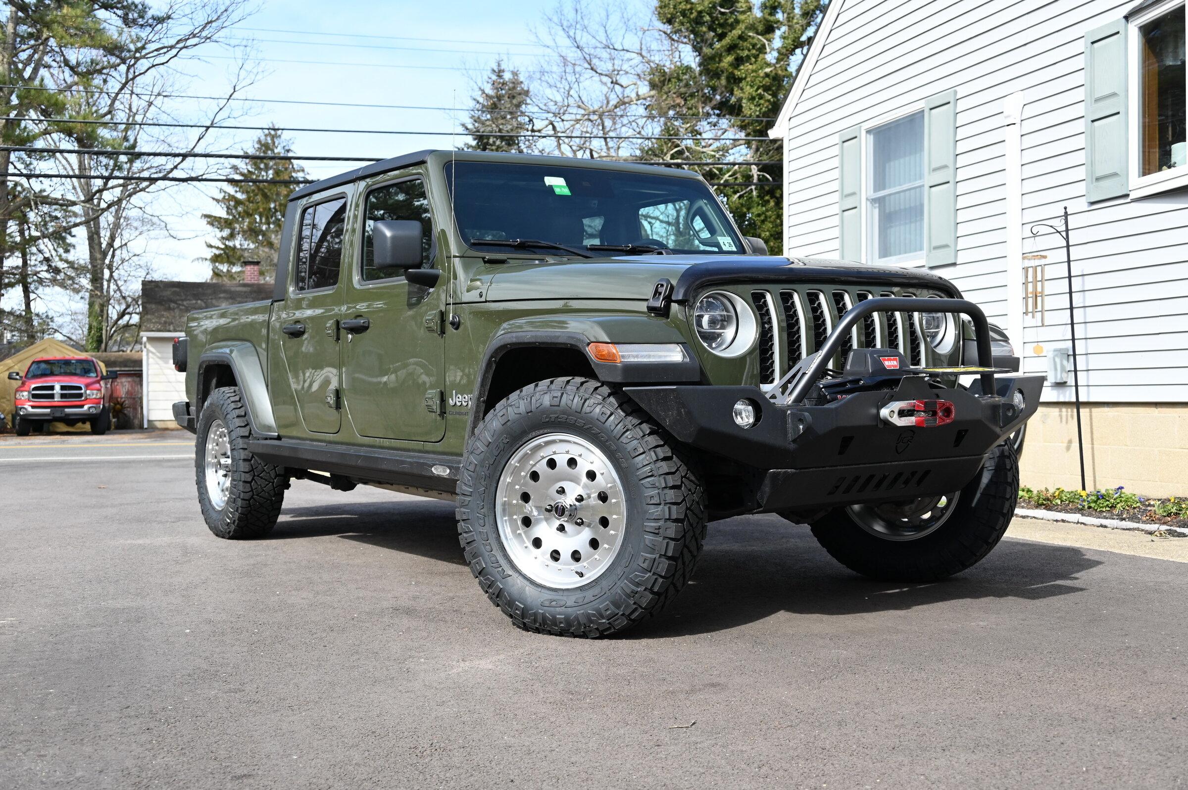

Machined or black? The machined wheels look awesome with Sarge Green! I just put those, but in 18", +30, with 285/70 18 Ridge Grapplers on my Overland earlier today. Yes, maybe it is an old style, but it's classic!​
