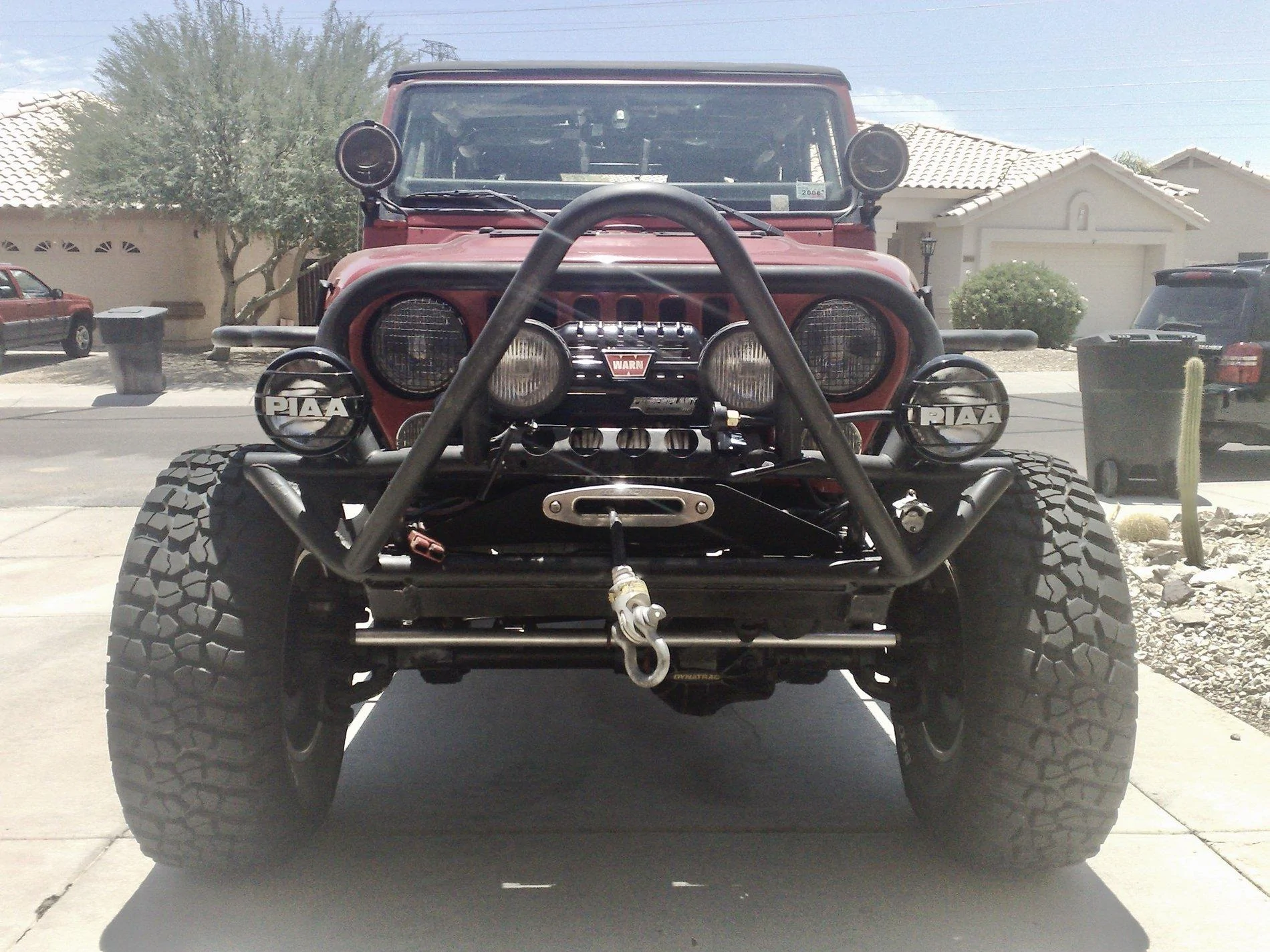

Is it the end? Who's to say? Do photos of your well equipped Jeep prove that 16 psi is sufficient pressure to maintain structural integrity of a tire during emergency maneuvers at highways speed? Maybe we should set up a timed slalom course...
My concern is that someone reads your recommendation of 16 psi for on road use, then takes off down the highway at 70 mph in a Jeep that is incapable of safely avoiding unforeseen traffic situations, resulting in injury or death.

Throwing in cool pictures of your awesome Jeep does not make your argument correct. We might just have to agree to disagree on this issue. If your "street pressure" and your "highway pressure" are two different driving circumstances altogether, you might have clarified what they mean to you up front, because to most people these are the same thing...
Whatever. Hopefully this issue can rest.

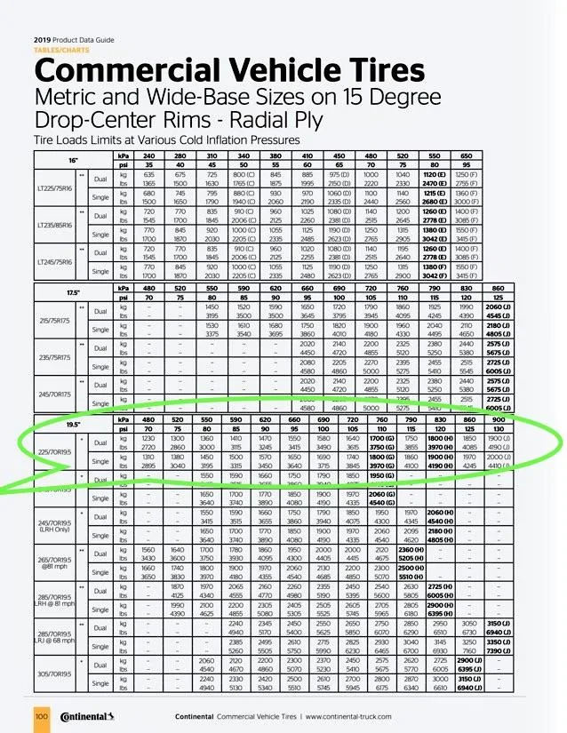

1). Get the Mfg chart on you tire and it will provide psi <> weight. In example you Jeep weights 3850 lbs, you look the chart closest to 3850 lbs and it says 32 psi. This your starting point.
2) Look at your contact patch. In the tire business FULL CONTACT patch is the objective at that point in time you have optimizes your CoF (Coefficient of Friction) this gives max: Braking, acceleration, lateral performance and tire wear-mileage.
I learned this was I was 14 and dad would send me out to fix flats on our ranch trucks and tractors. We did not have any tire gages or air compressor except my arms and a hand pump.
I gave the answer to your question, told how or you can use their solution but its YOUR Jeep, your wallet, your pride of ride you do it as you see fit.

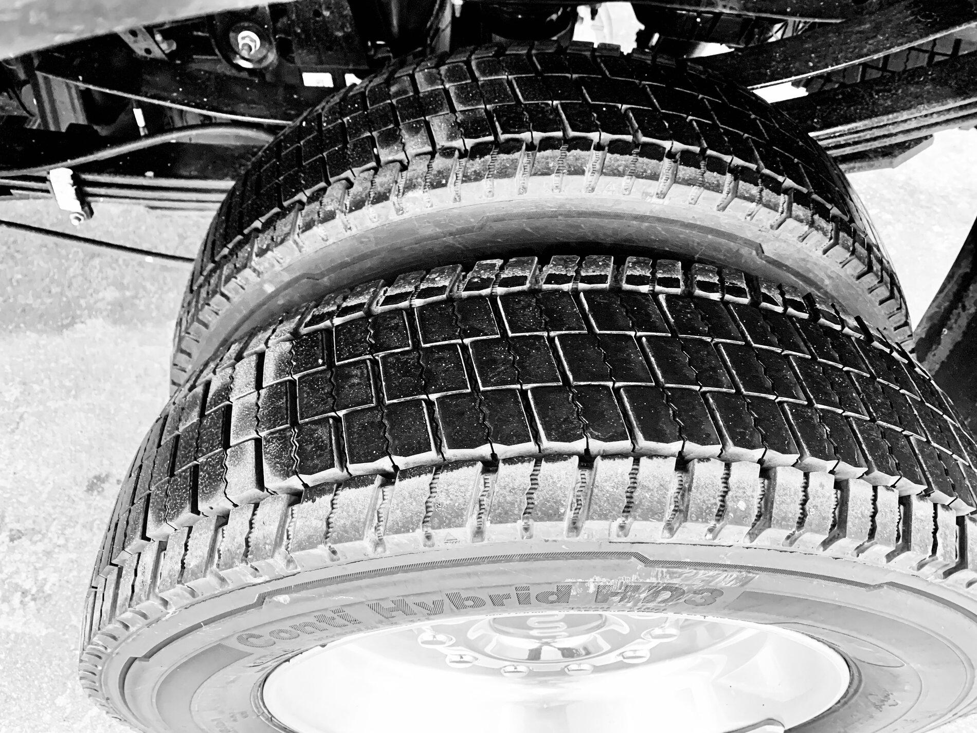

Here is the data sheet on my OEM tires on my truck. I run 70 psi on the street but when I am loaded I run 80 on the front and rear. The pic of my tires on my F 450 truck when I picked it up. The dealer had put in 90 psi but the door jam calls for 80. At 80 I get full contact patch but at 90 the outer tread does not touch the pavement, note how white it is vs the black where the tire rides. Without adjusting to contact patch you will wear out your tire faster, simple as that.
You are welcome to follow the experts on here...
