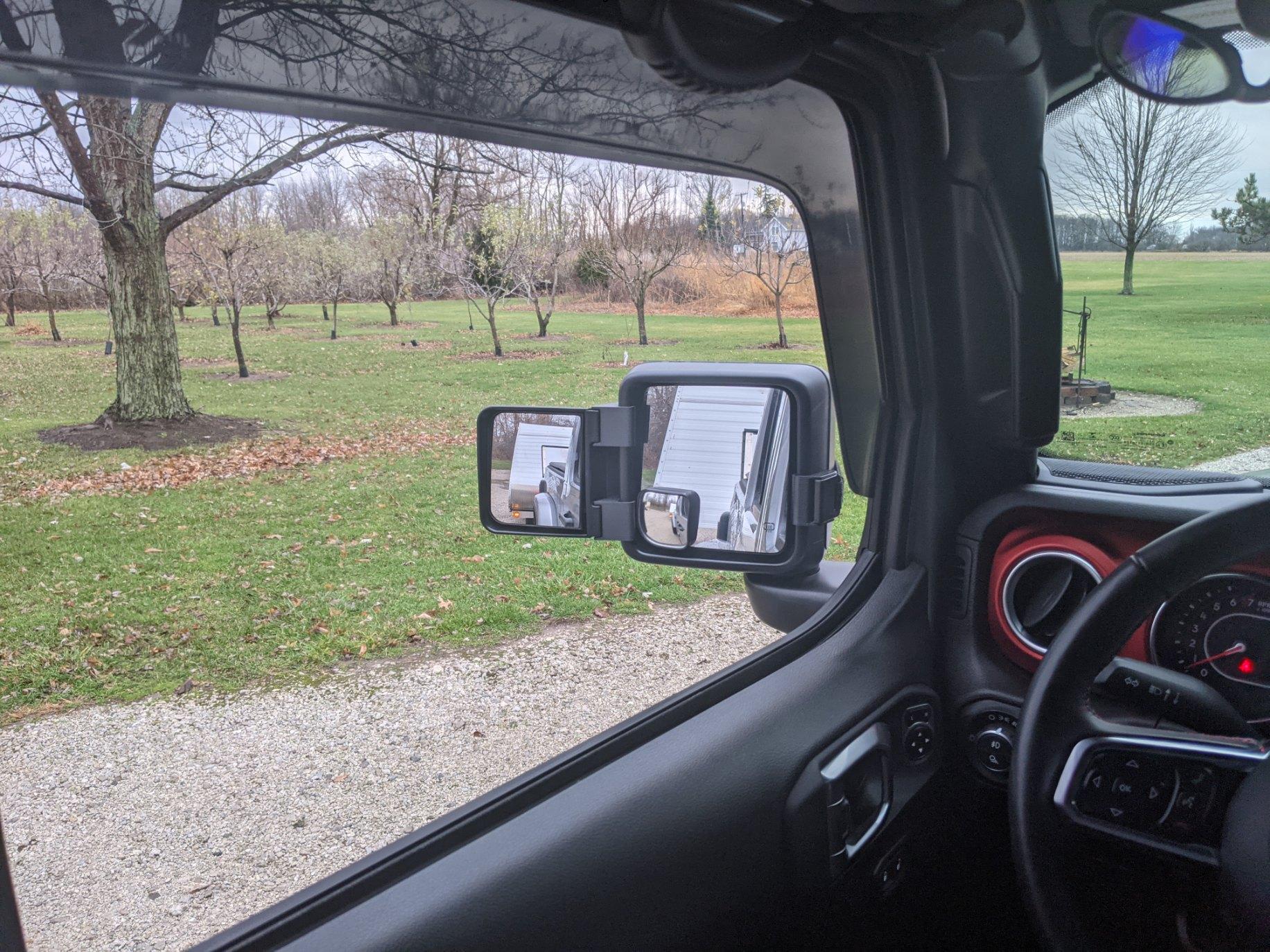

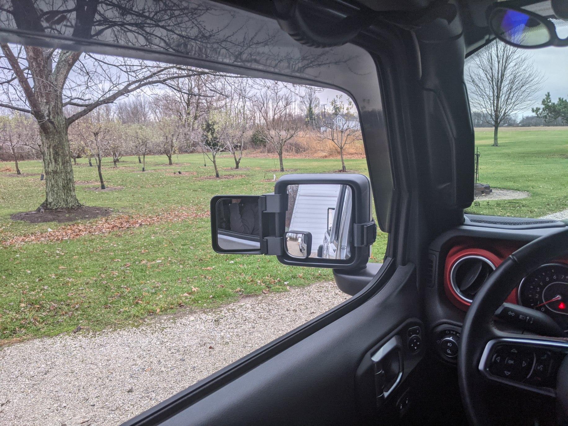

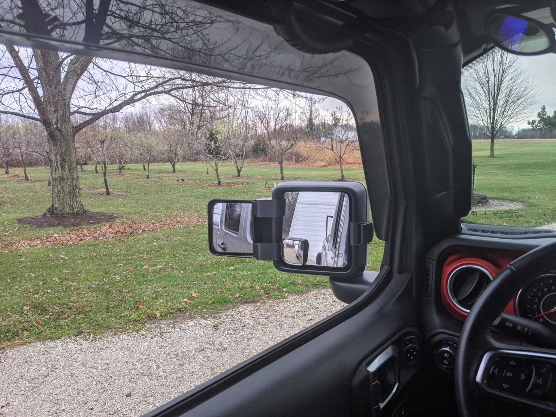

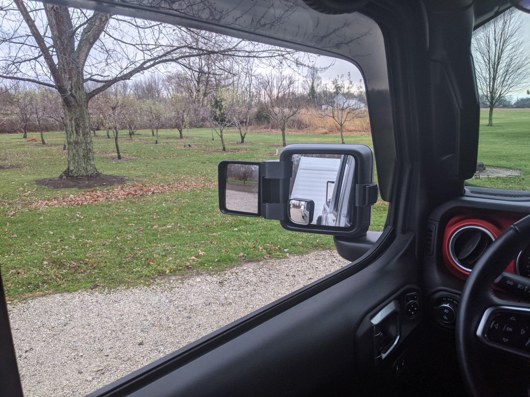

Everyone,
As shown in the post a few above, the driver side adapter has been redesigned with an additional 10 degrees of outward angle. This has significantly increased the ability for the mirror to be adjusted outward to the point where a trailer is not even seen. This, in my mind, offers a much more usable adjustment range. Below are some pictures showing the difference between original and second revision. I held my phone/camera in the middle of the headrest as a common point (look at the trailer in the factory mirror and its pretty close to the same in each picture) and adjusted the Rampage mirror all the way inwards and outwards. The trailer in the pictures is a Triton 12' long, 101" wide, clamshell snowmobile trailer. This is as wide as a trailer can be (legally) and tow mirrors are an absolute must when pulling it. One (1) trip up north without them lead me to design the adapters (which I used for years pulling the same trailer with me JKUR).
Original tow mirror adapters adjusted fully "in" and "out":
Jeep Gladiator Tow Mirrors - Rampage Adapters for JT/JL ?hash=06e0ed47b373aa2fabde8b04e298b5f6
Jeep Gladiator Tow Mirrors - Rampage Adapters for JT/JL Original-Out
Revision 2 (+10 degrees) driver side tow mirror adapters adjusted fully "in" and "out":
Jeep Gladiator Tow Mirrors - Rampage Adapters for JT/JL 10 Degree-In
Jeep Gladiator Tow Mirrors - Rampage Adapters for JT/JL 10 Degree-Out
I am looking for feedback from anyone on whether this is provides what some have been asking for. I will be updating the full set adapters to include the new design for the driver side. I'll also be offering a retrofit fit kit with two (2) new driver side adapters for around $15 for those of you would like to update.
As always, I love the input from the forum and look forward to continuing to improve the design where it makes sense. Please let me know if you have any questions.
Once I get some feedback, I will begin printing and offering the updated sets/retrofits. My goal would be to have this done by December 1st.

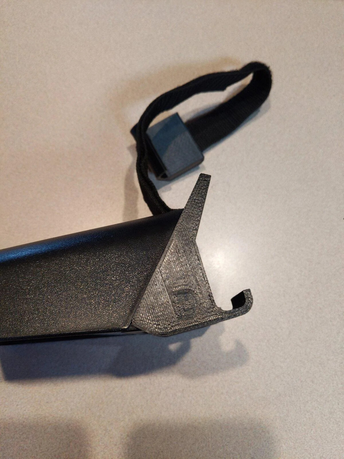

My adaptors came today, went together easily, mount solid without pulling too hard on strap. You did an excellent job and your son counted the screws perfect. I put some 3M two sided tape on the small clamp then did a couple wraps with super 33 electrical tape just so I couldn’t loose them.
I really want to thank you for doing this you are literally a lifesaver, there isn’t really anything close to this for us....THANX!

Jack,
Thank you for the feedback! My son is all about making Jeep Truck Parts!
I've seen a couple tweaks for the small hook/clamp. Glad you got something that works.
