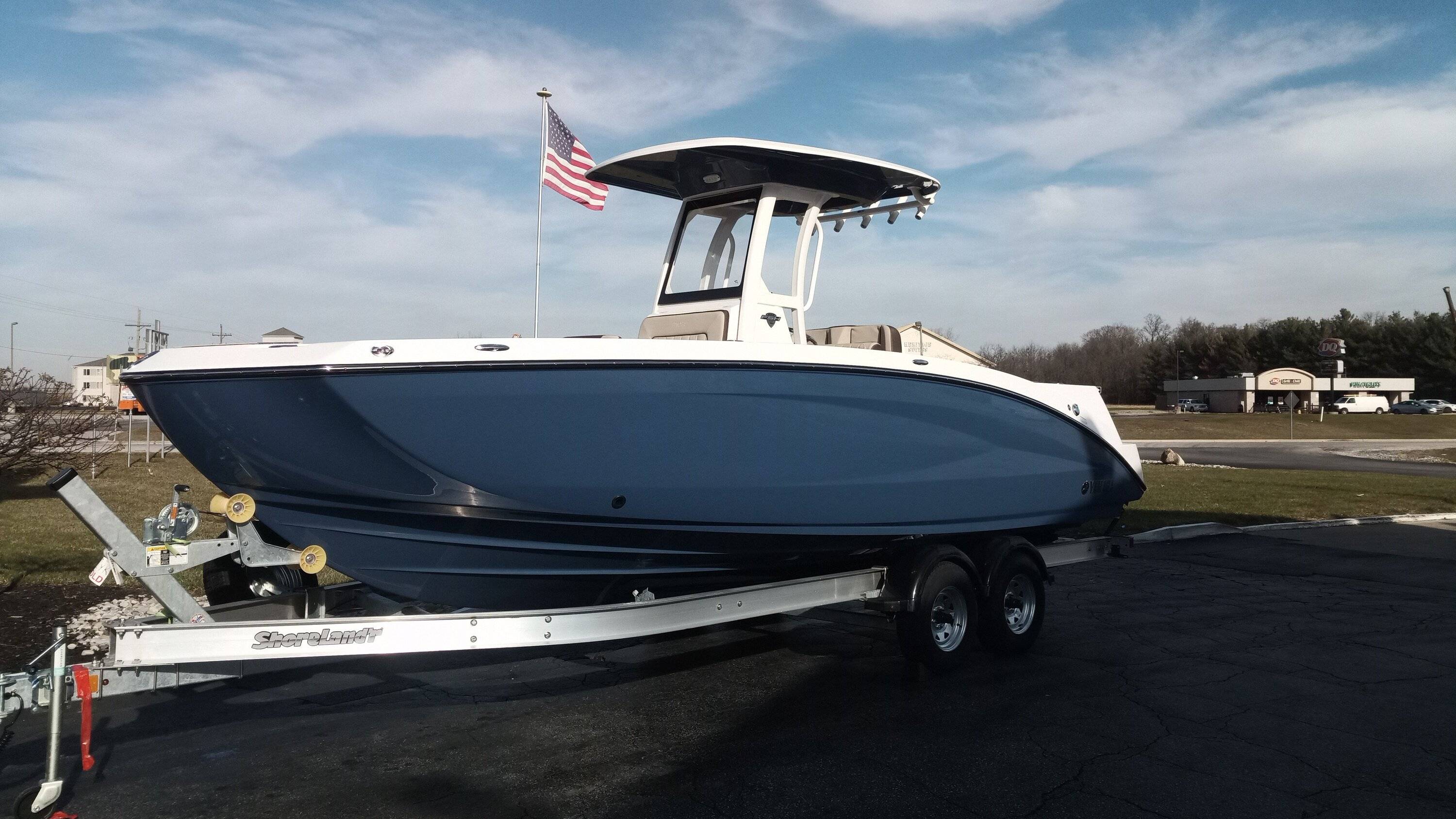

New guy here, reading threads for a few hours thought I would join, I just bought a 2023 FSH 252 (non charged hard to find premium fuel will leave it on jet dock at the house so not near land gas stations ever). Need a tow rig for the 252 and while it is the same weight and just over 6K on the trailer I plan to have it near empty on the fuel and no water onboard for any tow. seems payload is over 1500 on max tow S models if have 600 on the hitch leaves 900 for cargo and people which is plenty for me. Actually just left Stellantis as an employer and they gave me a 20K voucher I get in mid 2024 as a leave the company incentive. Not wanting a Ram unless I have to (although even a V6 ram in half ton chassis is similar tow rating to the max tow) there is not much else in the lineup that interests me, Grand Cherokee L perhaps but need a V8 pushes you to limited trim to get the hemi and even then 7200 max well under the max tow.
what did you decide to do in your situation? If rarely towing (I may do a trip a year or two, boat will be used off jet dock) renting a half ton truck is an option as well, keeps the miles off your ride as a bonus and have a capable half ton truck or more for comfortable towing for long trips with the boat without interfering with your regular ride.
Just a few rambling thoughts...
Jeep Gladiator Towing 7000# Yamaha FSH 255 Sport H sideshotridehome
MattKay
Aug 14, 2020
58
Grand Rapids, MI
Gladiator Sport S Max Tow
