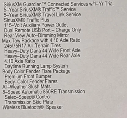

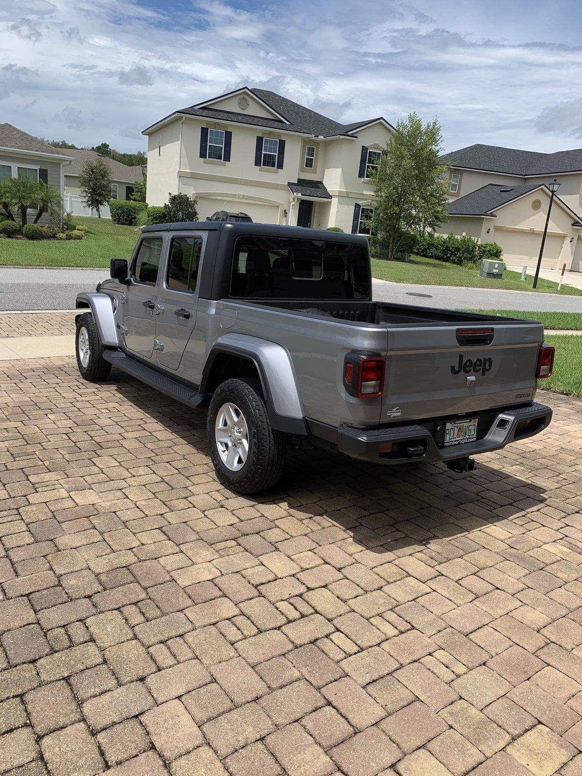

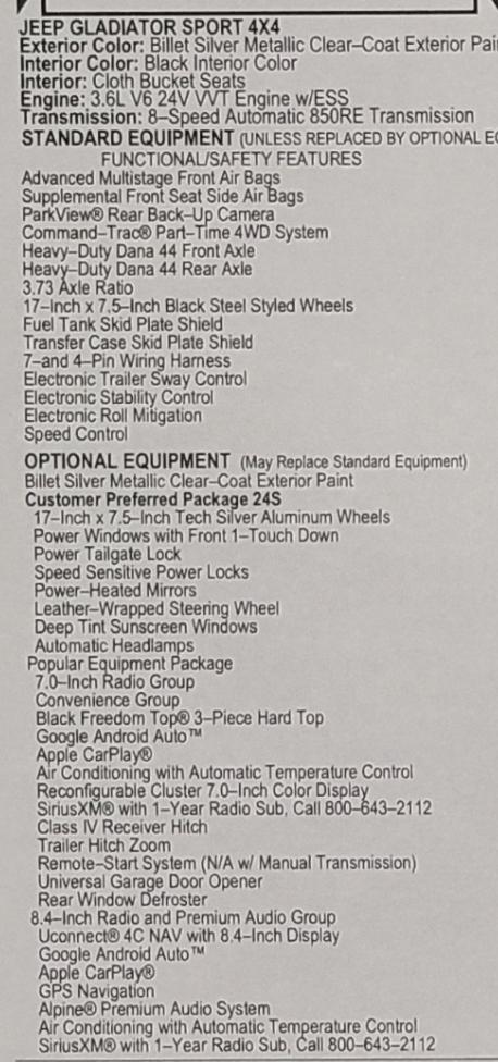

KVJ
Kenneth
May 31, 2019
625
774
Trumbull County, Ohio
Sport S W/Max Tow
@Jpeazy21
What does the sticker at the right bottom of the tail gate say? I tried to enlarge it but I can't read it.
