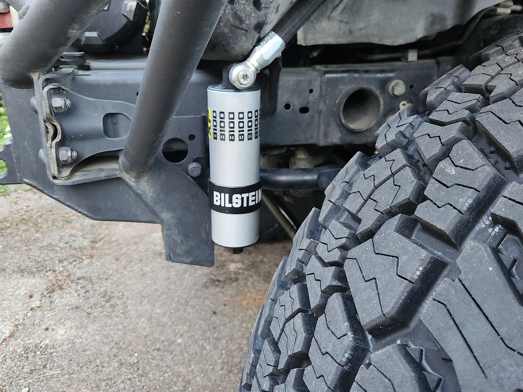

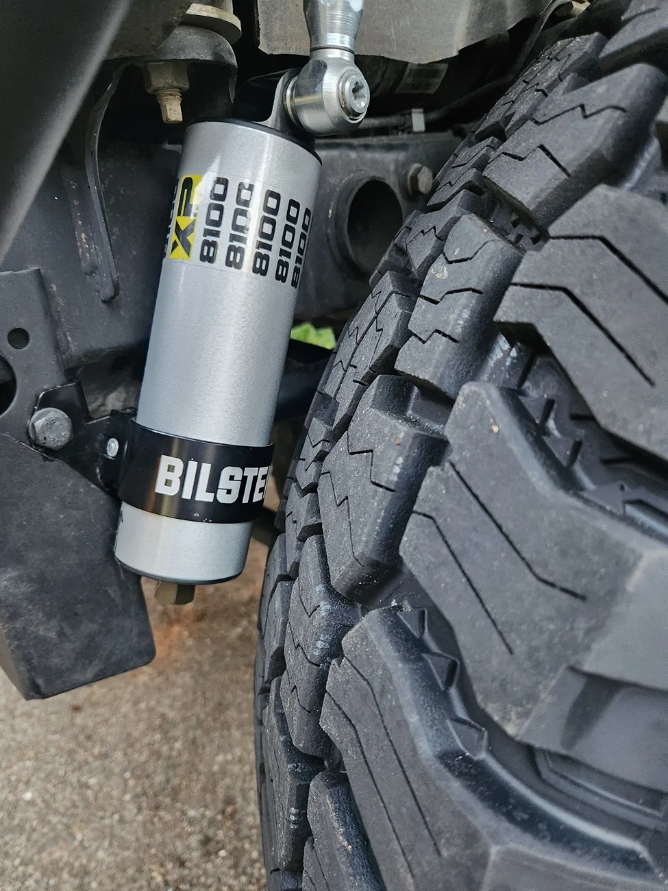

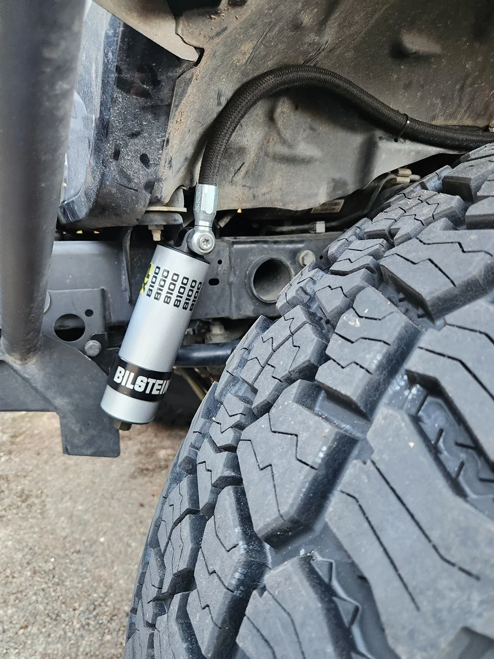

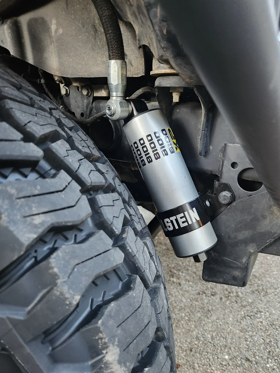

so I installed AEVs blue spring high capacity 3 inch lift witg 8100s. I have a 2021 gladiator rubicon. It worked with 35 inch tires, I switched to 37s on factory wheels and now the tires drag on the reseviors. I can pitch them back and they clear without flex, but I bet any flex would ruin my day. Has anyone else experienced this? Any suggestions on how else/where else i should mount the reseviors? Thanks!

On those rears you should be able to find a clamp and mount them to the rear of the shock itself.
On the front I believe most mount them to the frame horn. Usually a bit higher and more tucked in than you have them there. Depending on the bumper you may need to drill a hole in the steel there.

I agree with Bandit. Looks like you have an aftermarket front bumper preventing the reservoirs from being mounted more forward and up. You may have to get a little creative with placement.

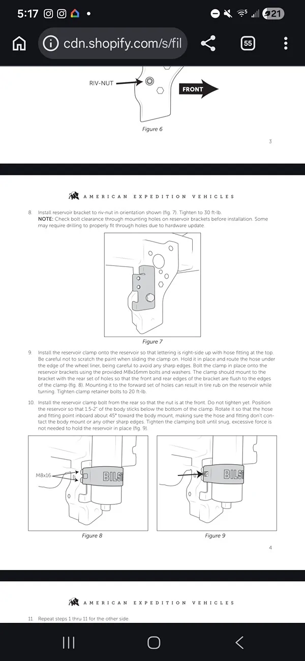

Thank you! The rears came all set up connected to each other, and the bottom picture is of how it was recommended to be mounted by AEV. It did take drilling and riv-nuts to get it there, but it seems like thats the only spot the AEVs brackets work with, and in the vertical picture, thats as high as they'll go until it hits frame/mounts behind the grill.

Yeah... unfortunately, creativity is what I lack, and these tubes arent as long as Mojave tubes so I don't have as many obvious options. I spend time staring at it, and moving them around, but my cognitive limits are many.

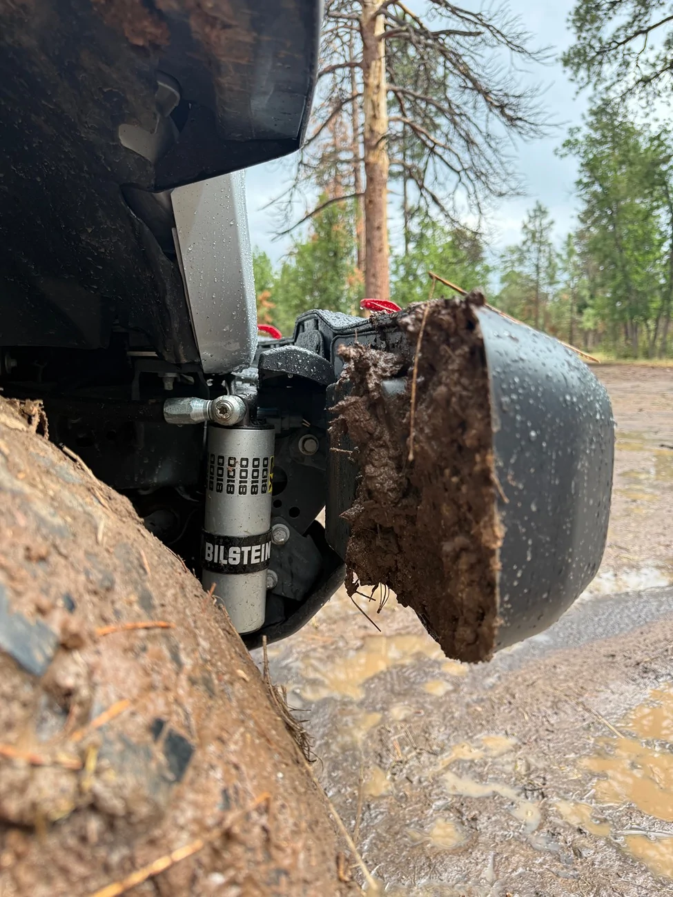

I don’t think you’re that far off. Can you turn them horizontal? Here’s a pic of mine for reference. They appear to be right below the grille.

Oh man, these look just like mine but maybe 2 inches forward amd maybe 2 up. Were these the AEV mounts? I'm suddenly thinking I screwed the wrong holes again.... time to go check. My bracket seems to be a newer one from what I've seen on some youtubes, I'll see if I can find a Pic from their instructions

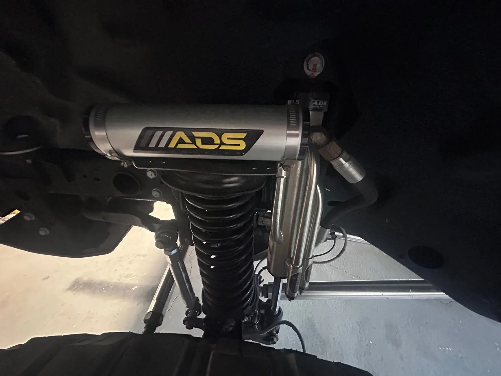

here is another res mount idea, but you may need to find fabricator/welder. This is a Gladiator
Jeep Gladiator Trouble placing Bilstein 8100 resevior with AEV lift 1775577706197-gn
