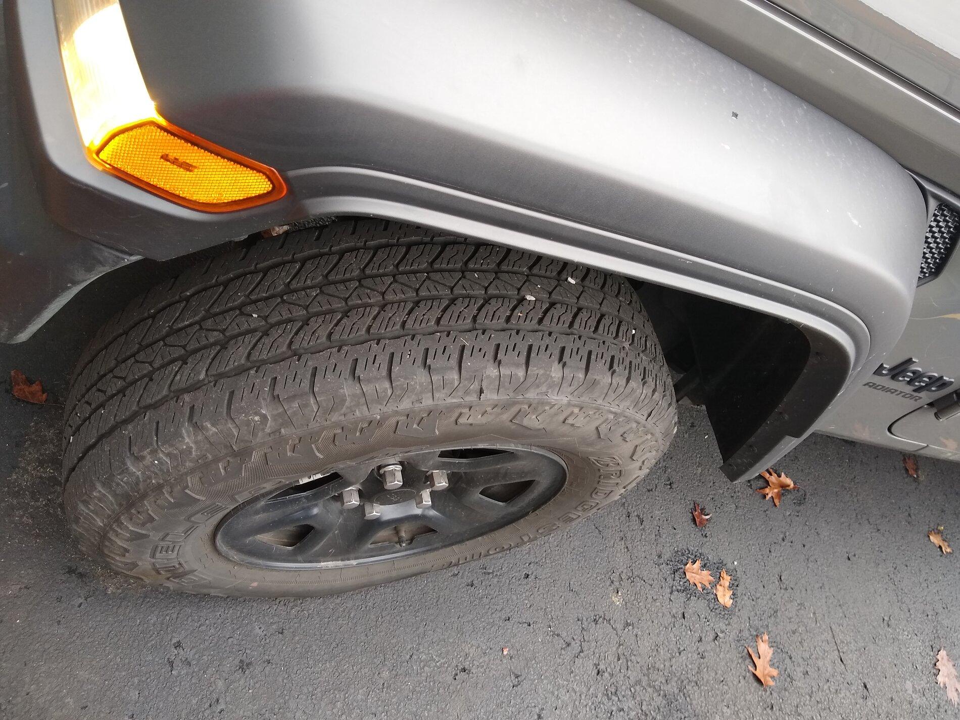

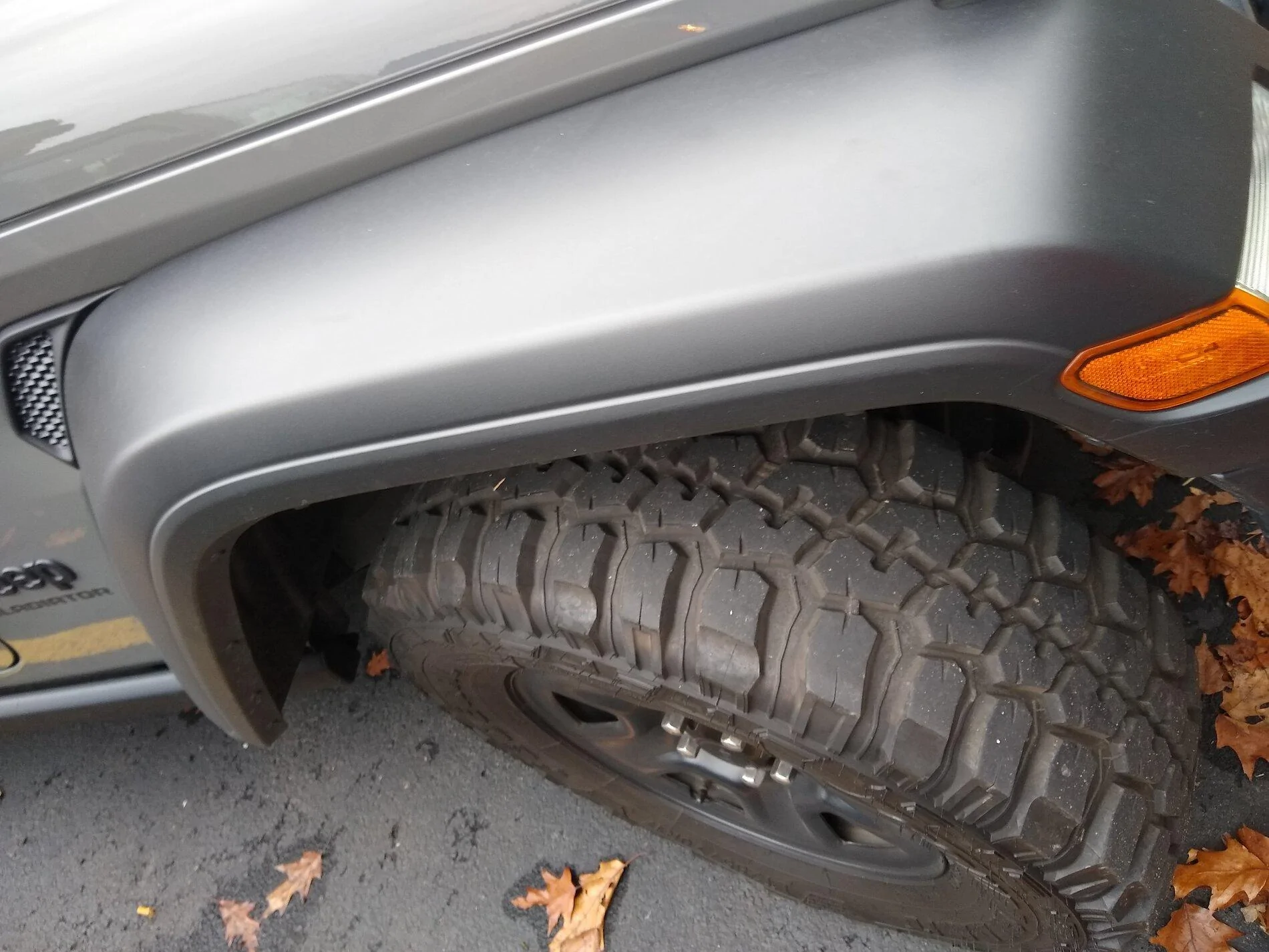

The rear will fit 35’s with no lift. The reason tire size is limited on the front, is due to the rake on the vehicle. The front is lower than the rear. On anything other than Rubicon and Max tow, the gap between the tire and the top of the fender is closer, which restricts tire size. By lifting the front to match the rear, effectively eliminating the rake, you’re able to fit bigger tires. The Max tow uses rubicon fenders due to wider axles which are mounted higher and give you more front clearance.
Gobi-Wan Kenobi
Feb 22, 2020
100
94
Earth
2020 Gladiator Sport
Max tow does not use Rubicon fenders. It has it's own fenders that are basically sport fenders with an extra lip. So you can fit the wider axle and keep the tires covered to be legal in all 50 states but you don't get the extra space for larger tires like a Rubicon with it's raised fenders. So 35 inch tires may rub in the front on a Maxtow under certain cercumstances just like on a regular sport or an overland.
This. Rubicon specifically (and only the Rubicon) has high clearance flares. The max tow vs regular flares are an extra small bit of plastic making it wider. That covers the rest of the tire and helps to protect the body with the wide Dana 44s. The Rubicon has wides as well but the design is different due to their high clearance.

When I swapped my max tow fenders for rubicon fenders, I gained between 3/4 to 1 inch in clearance.

The max tow and sports have three plastic air dam that causes the rub. Removing that, or trimming will give the needed clearance that the Rubicon fender has without the trim piece.
Gobi-Wan Kenobi
Feb 22, 2020
100
94
Earth
Yes, you can modify the fenders to get additional clearance. But it is still clearly a differnt fender then the one on the Rubicon which actually mounts the fenders higher and doesn't need the inner liner removed to clear larger tires.
