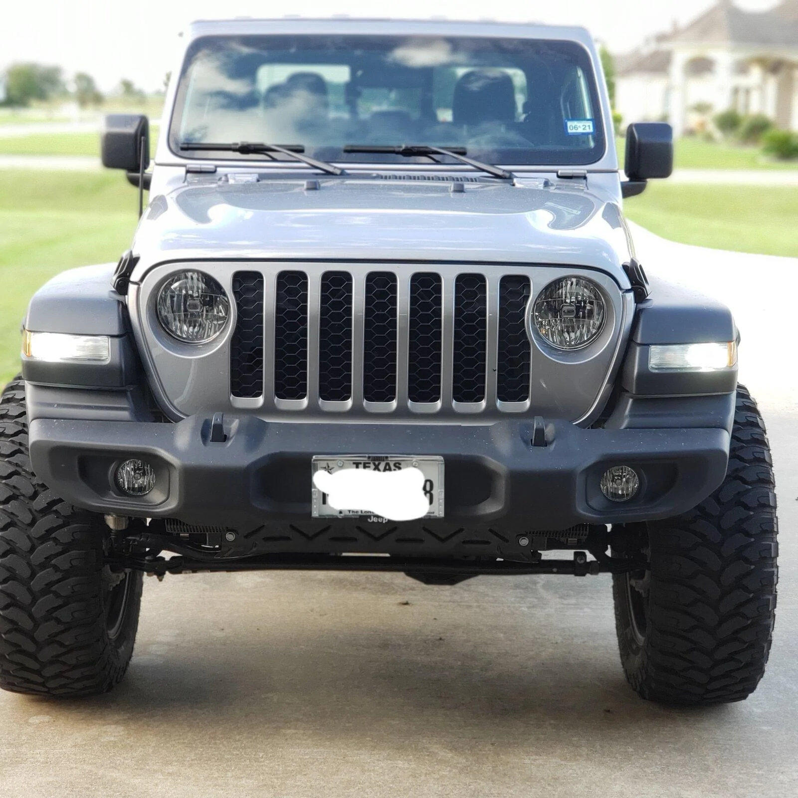

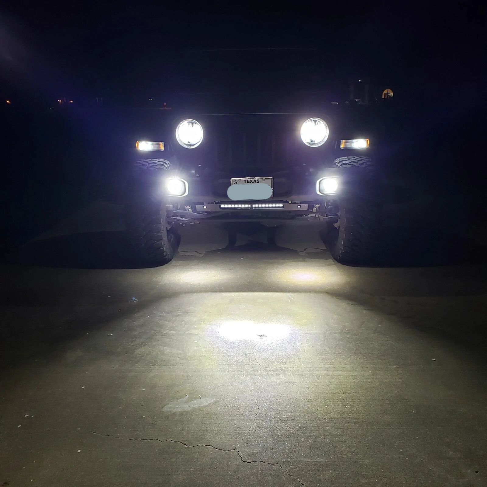

As far as I know all Max Tow optioned Sport S's have DRL's. The 2 piece fender comes with 2 bulbs - 1 for DRL & 1 for blinker. The DRL bulb is on the outside and the blinker bulb is on the inside. The non-Max Tow Sport S's have the single piece fender with a single bulb for the blinker.

Well then maybe they added it to the package at some point. I have a 2020 base Sport with max tow that does not list daytime running lights on the window sticker. I know they rearrange the option package contents periodically like when they added limited slip to the max tow package (which mine does have).
Every fender has DRLs does it not?

As of 2020, the DRL’s come standard on every trim outside of Sport/Sport S. Sport only gets DRL with Max Tow, otherwise you just get a single turn signal bulb in the fender. The Sport S comes standard with just turn signal bulb on fenders, unless you get either Max Tow package, or you get the body colored fenders. I have a Sport S with painted fenders, and the DRLs. But I didn’t like the stock halogen units, so I upgraded to an aftermarket LED system.
