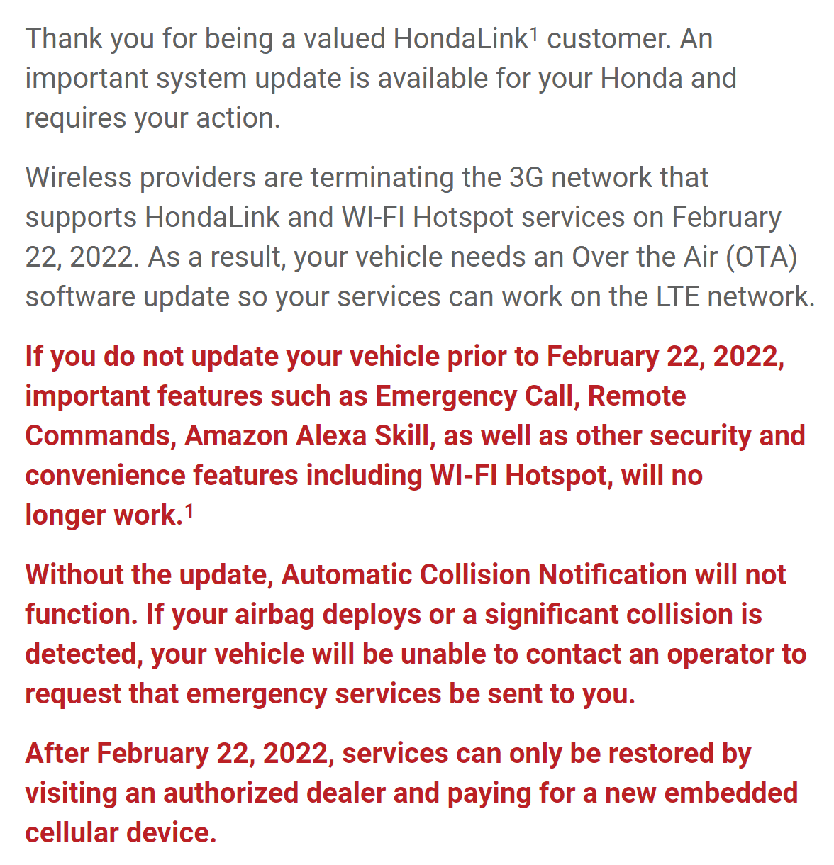

My Wife had to run an update on her Pilot for issues similar to this. Not sure if it's the same issue.

And a year later, new info and update. No Wifi access unless I purchase some little adapter from AT&T to plug in. Decided it wasn’t worth it so I no longer have wifi. My best guess is that AT&T didn’t want to work with Uconnect to come to an agreement because someone didn’t like the terms being offered so they decided to create their own version.
It's not UCONNECT, it's the Panasonic hardware. There's a TSB about it. AT&T made some changes - Jeep didn't.
My guess - AT&T apparently decided it wasn't worth their effort to remain compatible - suspect it's possibly due to 5G
"UCONNECT" is the software and doesn't really impact the WiFi but hardware sure does. The issue has impacted thousands of Jeeps. Officially "compatibility between the hardware and AT&T.
Well, it used to work - so guess where the change came in.
The TSB says "AT&T is suspending........." Hmmmmm
The dangers of trying to work with a company that has better things to do than support a few thousand Jeep owners.
Makes me think that 10+ years in the future, if you have a current modern vehicle like ours with the infotainment systems that are so hardware and software dependent to stay relative, they are going to be just big unsupported bricks.
Kind of like Apple and Samsung with their phones and tablets, just going to wakeup one day and get a message that no more updates will be applied
