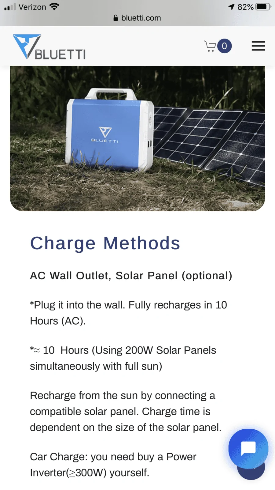

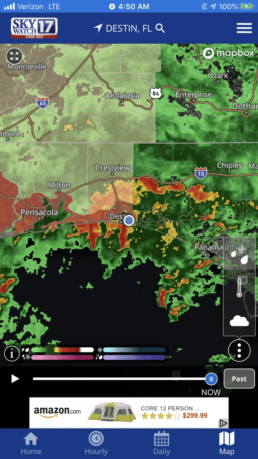

The Bluetti states that you have to buy a power inverter to charge it in your car. Now those are cheap but 12V plugs are rated at a max of 10 amps. I can’t find in their information where it has any type of weather rating. My last trip I drove out of Destin as a tropical storm rolled in.
Your absolutely right. Dang... No 12v charging from the vehicle. Well then.... This one is out. I will need that. There are many others that do have that feature though. One that comes to mind is the Ecoflow DELTA 1300. Its about 100 bucks more but has a real fast recharge rate.

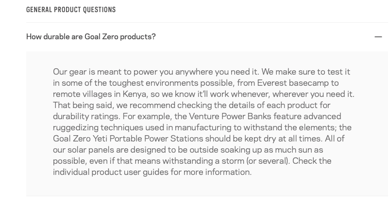

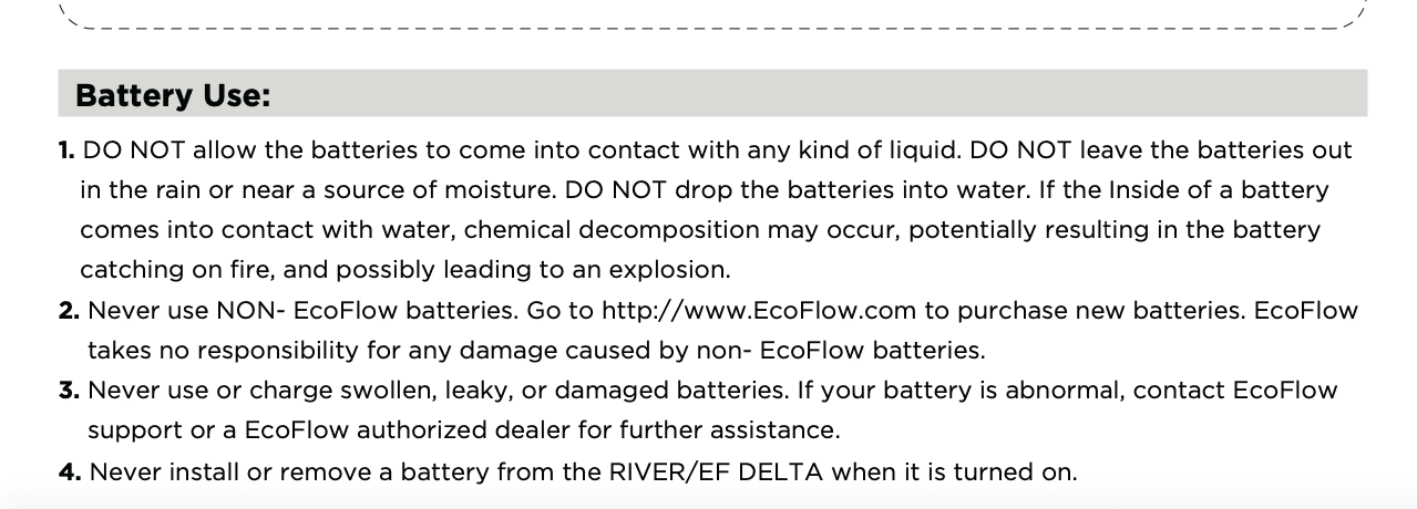

I was able to find these two screen grabs from GoalZero and Ecoflow. They fake rugged but can't really cut the mustard when it is needed. These indoor power stations are like a Honda Ridgeline that looks the part and can do a little and my power stations are the Jeep Gladiator that can live up to the hype and demands of true outdoor enthusiasts.
