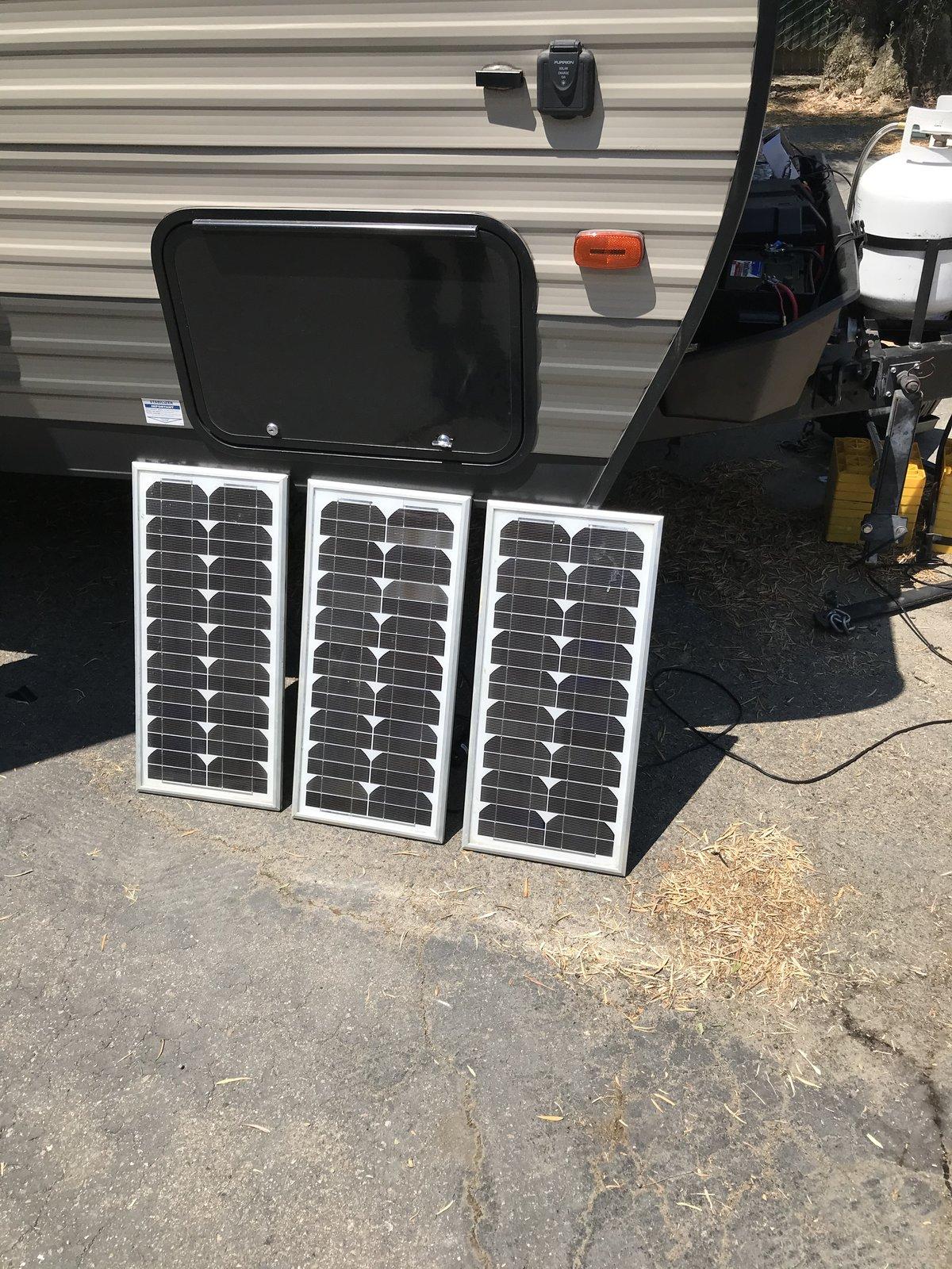

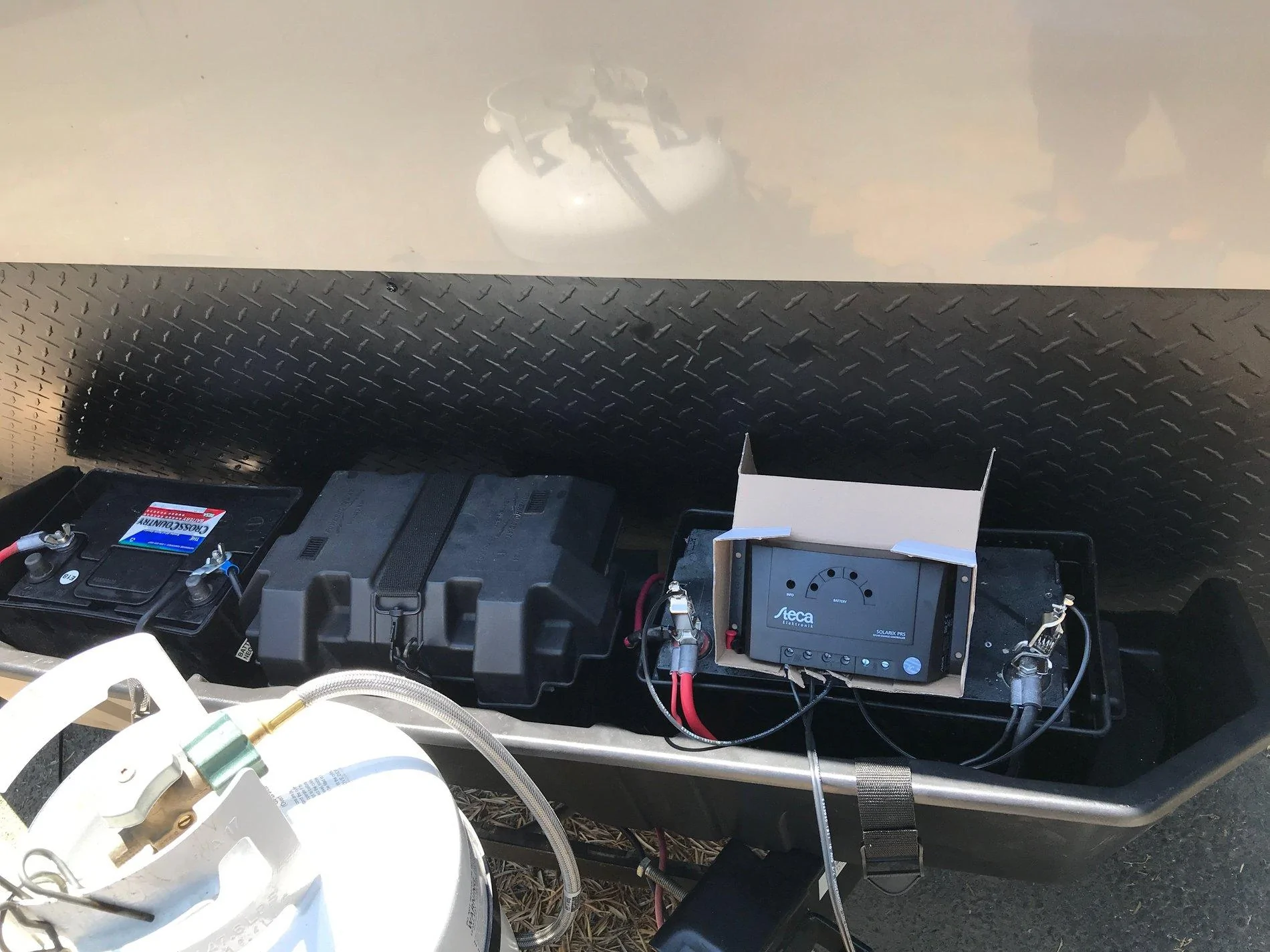

Wired 3 20 Watt panels in parallel with quick disconnects to a solar regulator connected to some large charging clips. The though bring you can move the panels around to keep them in direct sunlight. Good for trail and trailer camping camping, storing anything with a battery, but also if the power goes out. Im no doomsday’r but I think everyone should have a little back up power system.
