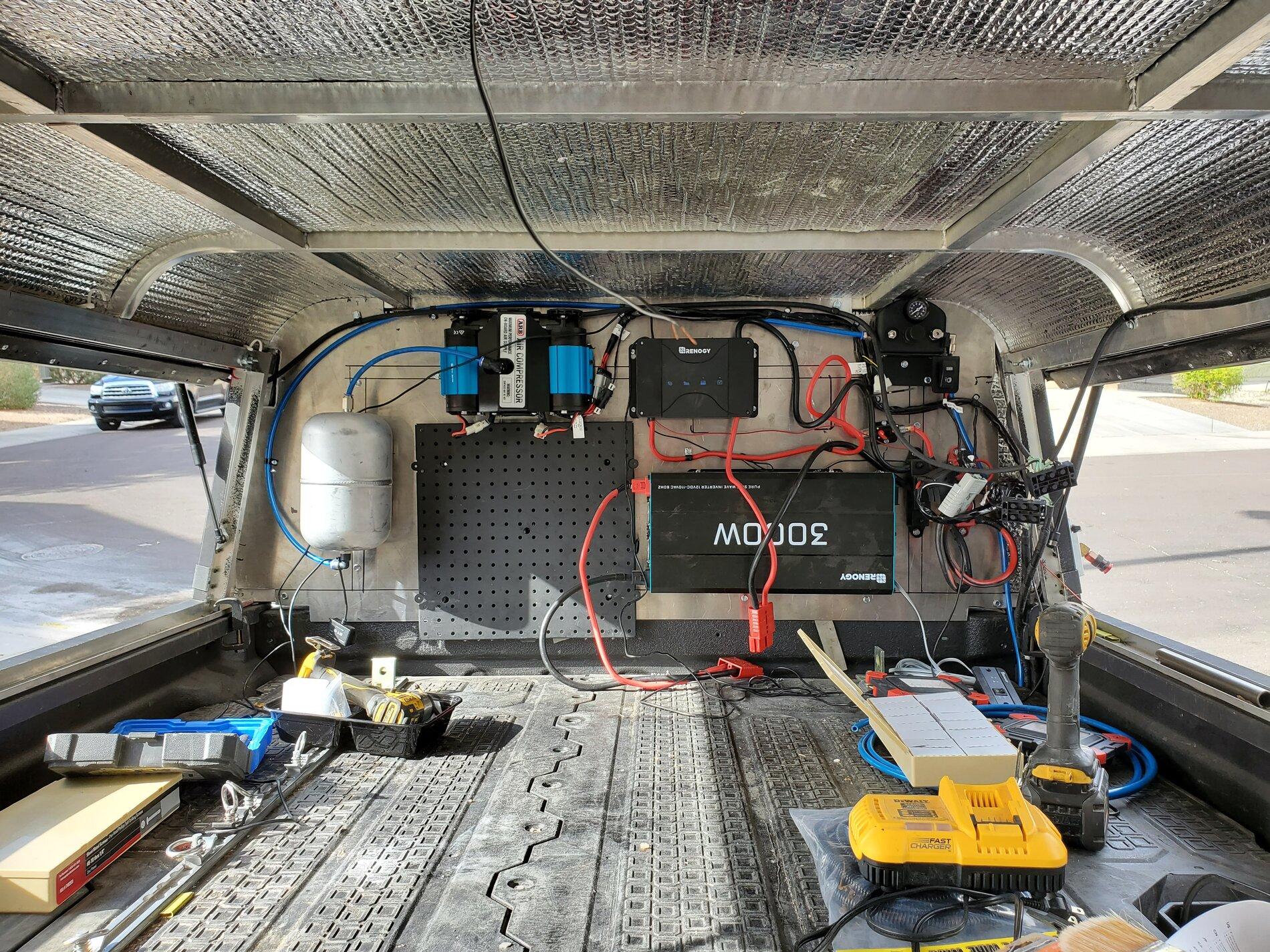

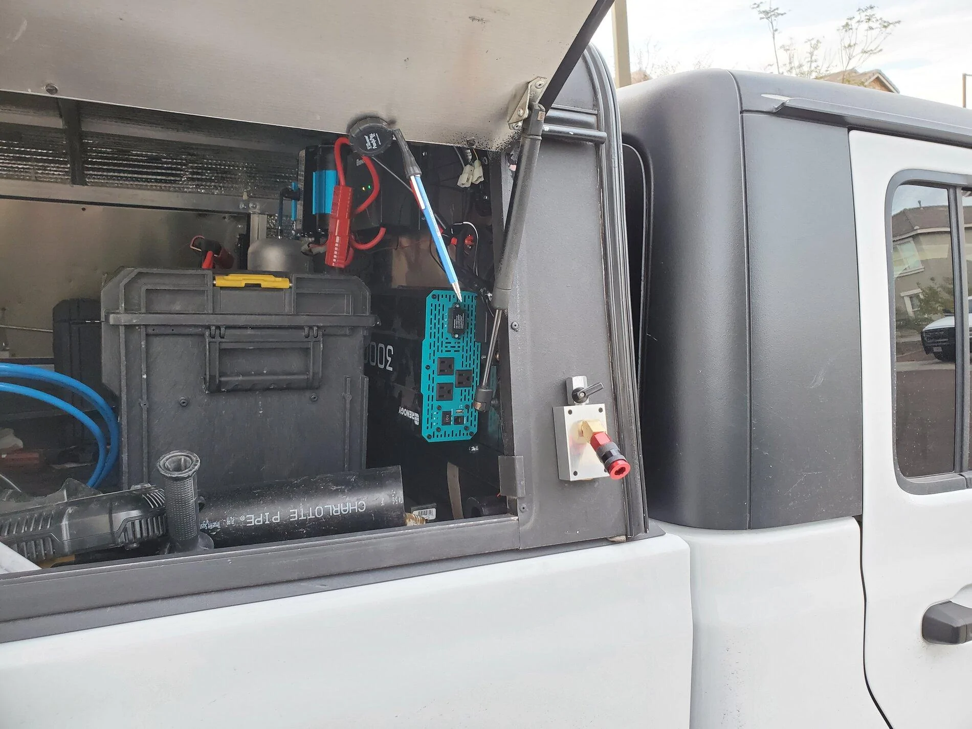

That is what got me to this point. I did build my own system with 2 100ah batteries and it works but it takes up too much bed space. So I asked around and found someone who can mold the box and install the components into a smaller package. All that with a two year warranty. Why wouldn’t I say build me some and let’s test them.?
Here is my setup in my bed. 50amp dc-dc solar mppt, 3000w pure sinewave inverter and 200Ah battt and 2 100w solarpanels. I also have a Cascadia solar panel on my hood with their mppt to my truck battery.
Also my Cascadia80w system has been running my Iceco VL 65 for over a year with no issues.
Truck even sat for 15 days without starting.
