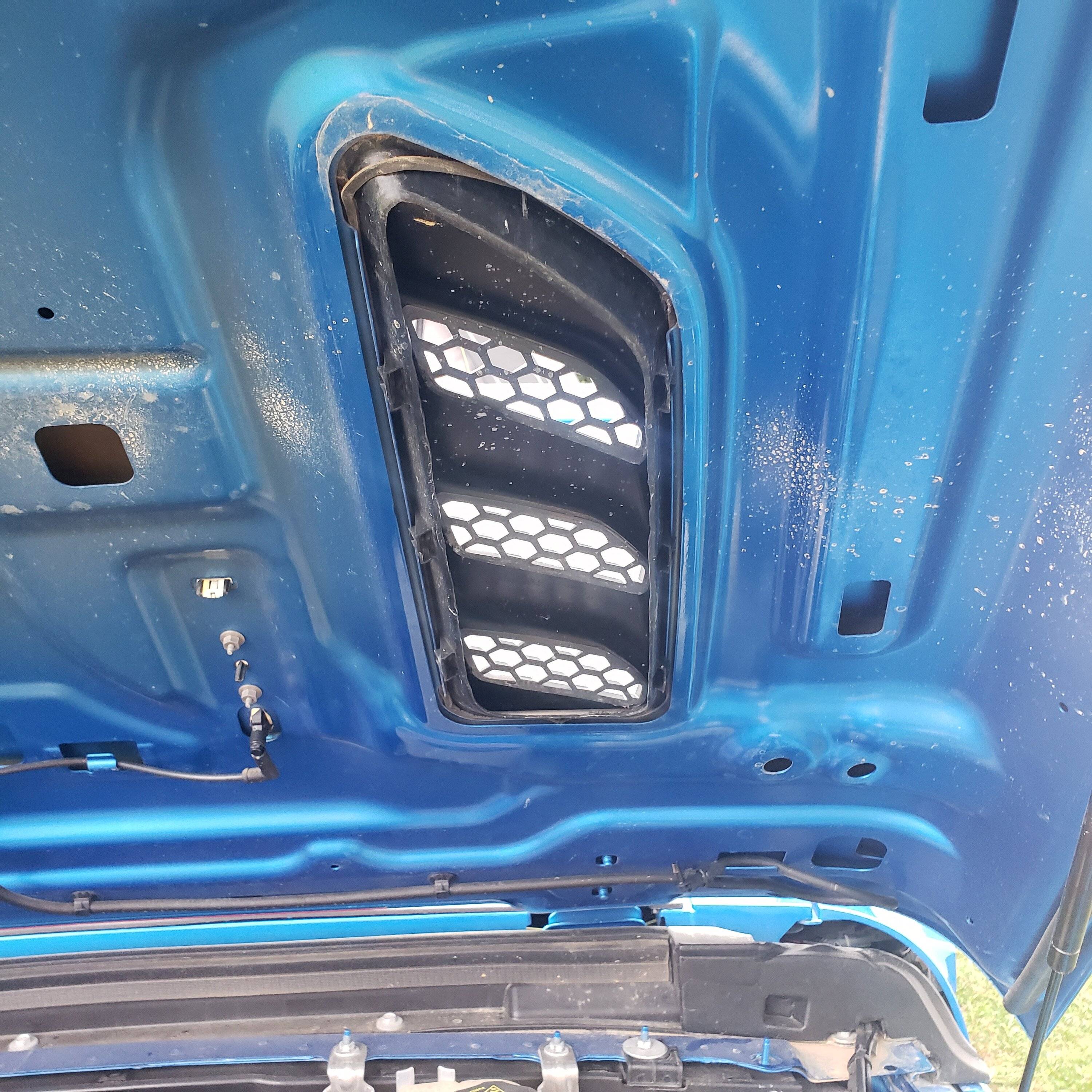

I have been running mine for about a year and a half with no hood liner since making the rubicon vent functional. I have had no issues. I can visually see the heat rising out the rubicon vents and the electric fan doesn't have to run as much while offroading.
Pics of the underside of the hood with the vents functional?

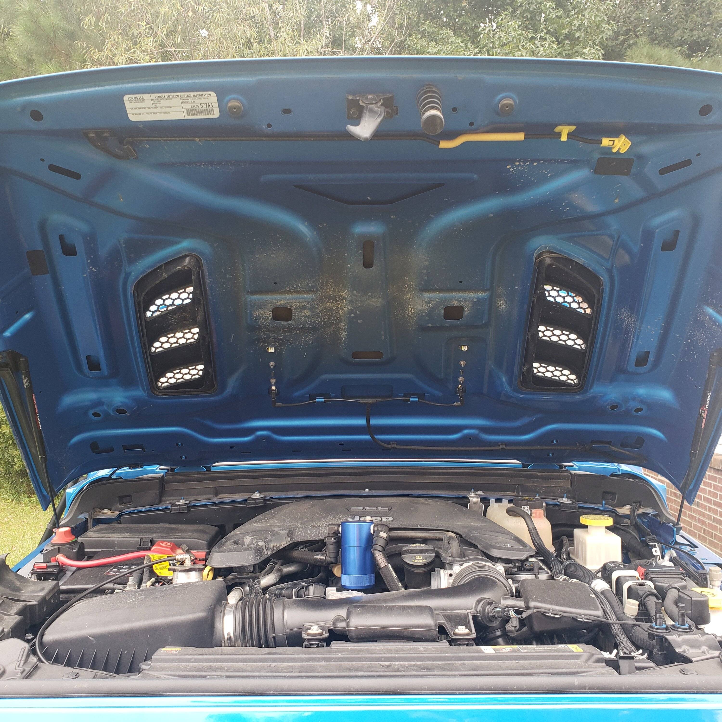

I more or less didn't put it back because most of the clips broke when removing the insulation and I was lazy about buying the clips and marking and cutting the insulation for functional hood vents.
This might be a stupid question, but what’s that blue shiny filter? I’m curious about that, please educate me as I’ve never came across that before. Pretty cool!
Thank you!
It is a UPR products oil catch can in the PCV line from the back of the valve cover to the intake manifold.
I actually like the location they put it in because it gets hot enough to burn the moisture content out of the catch can and leaving just oil and keeping it out of the intake manifold and lowering the octane rating of the fuel.
