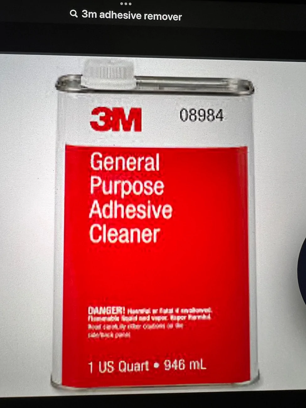

If the undercoating is still soft a 3M general purpose adhesive cleaner will work well and is easy on non porous surfaces when applied.
Jeep Gladiator Unhappy with Zeibart. What do I do? IMG_7846
