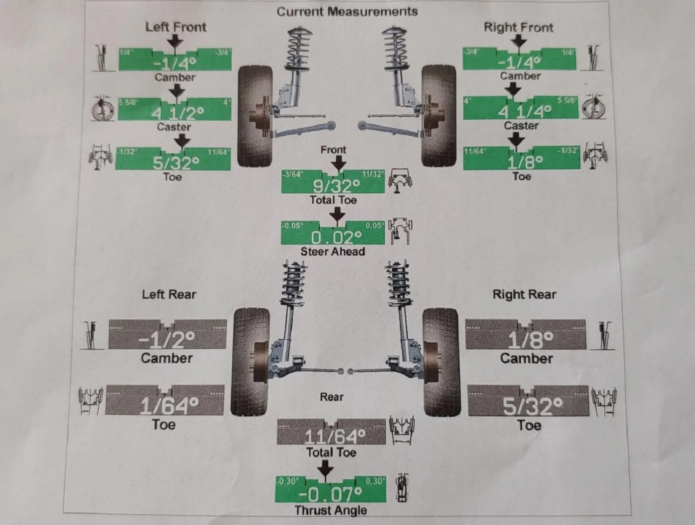

I asked the service writer today for a copy of my alignment numbers from May when they replaced the steering gear again (2nd steel box).
They couldn't find the numbers, just where it said an alignment was done/checked.
He asked the service manager to look as apparently the manager has more or deeper access to details. Nope, numbers not there.
I said "I'd sure like to see the numbers sort of as a baseline and to see if the MOPAR lower control arms for the 2" lift would be worthwhile for me - but I didn't want to make any changes without knowing what my numbers were.
I simply acted disappointed that they couldn't find the numbers and thanked him for looking.
And guess what they did -
They put my truck on the rack, had their best alignment guy do it (apparently as an apology for not having my numbers for me the first time) and they gave me a printout of my truck's current alignment numbers.
Jeep Gladiator Updated Steering - Not so Updated 20210915_JT-alignment
