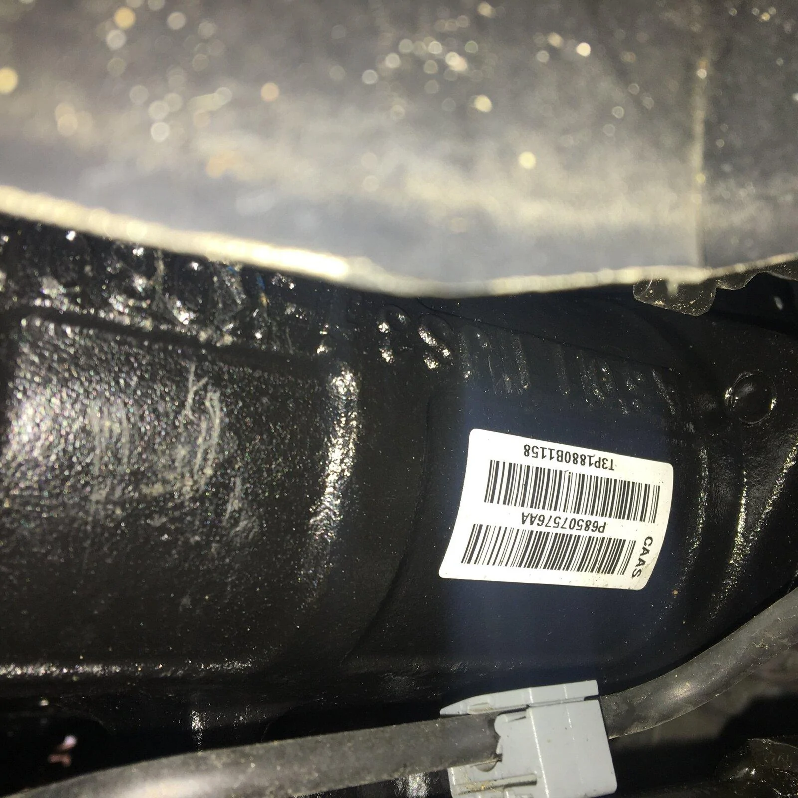

Dont forget to verify that the part number is correct for the JT ... They put a JL box in mine ...

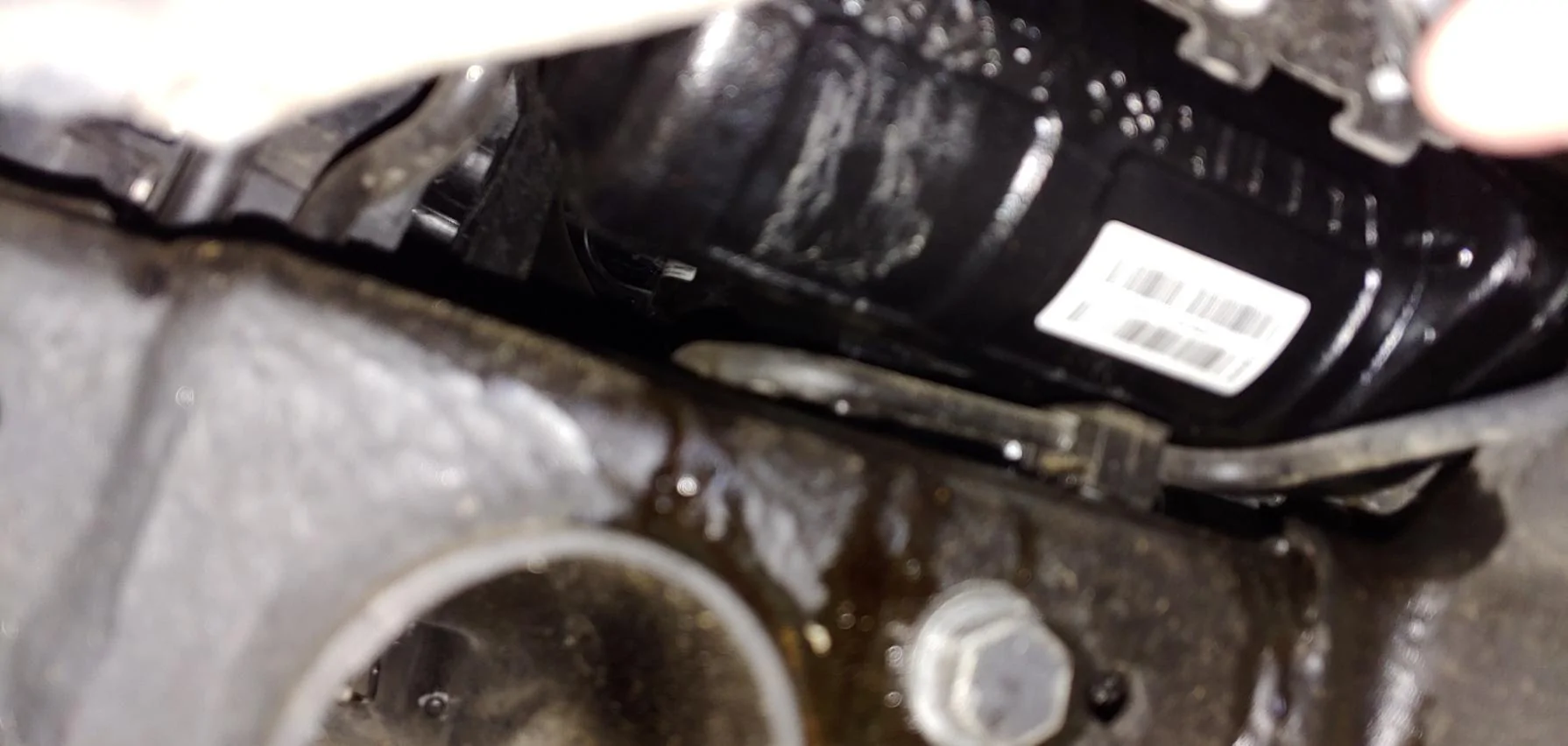

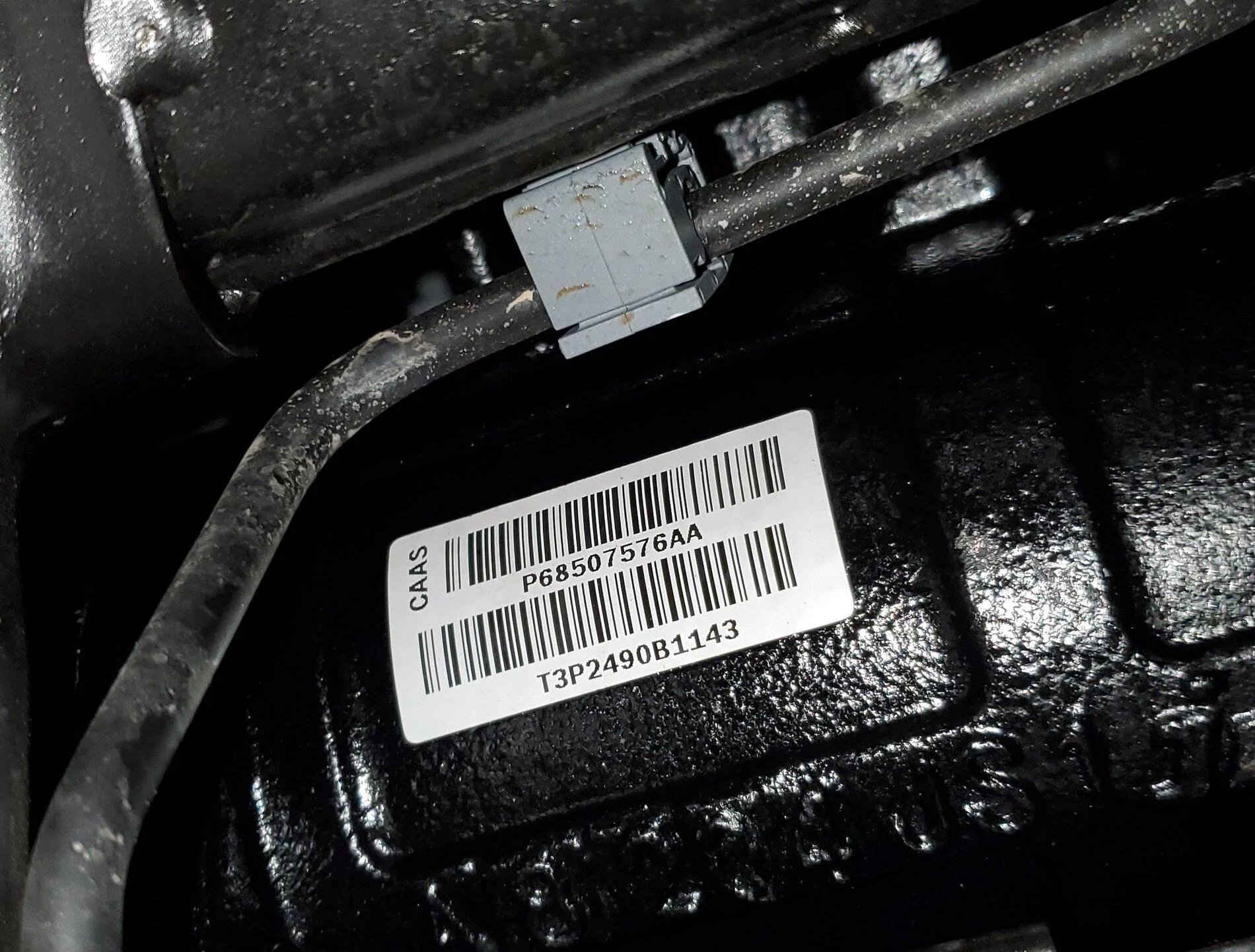

Where would I find it? I've looked as best as possible and the only number I am seeing is on the top of the pump(?)

Pull back thin plastic fender liner, just ahead of the axle, above the frame -
Don’t need to even move the liner, should be able to just stick your phone in there and snap a picture.
Don't know about your truck but if I did that the phone would be against the steering gear.
