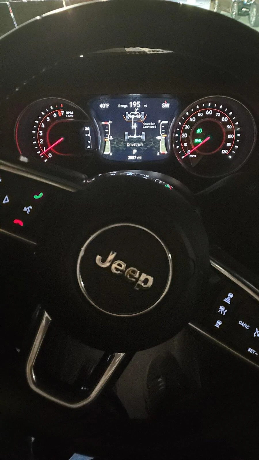

UPDATE: got my JT back on Saturday and it drives noticeably better. One of the first things I noticed was the lack of "wander"...often when I looked over my shoulder to check the lane next to me, I would feel the truck wander. There is no wander any more...that alone is a huge plus.
It definitely feels tighter and buttoned down...love it.

Haven't had it on the highway yet, but did confirm that they installed the right PN, replaced the bolts, and flashed the new code to the ECU. The steering is much firmer than it was, and there is zero noticeable dead spot. When I wiggle it back and forth at speed, you actually feel the front end dart each way - y'know - like a vehicle should.
They didn't get the steering wheel alignment exactly perfect, but its close enough that it won't register on Offroad Pages, and is easy enough to dial in myself.
Anyone that says poor steering is a "solid axle thing" has no clue what a properly set up solid axle vehicle should drive like. My Glady finally drives better than my abused 16yo TJ :)

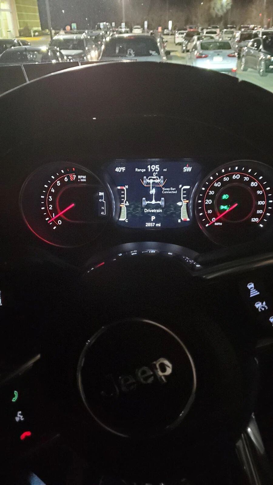

Mine is done. Initial impressions are what you are saying. Very firm and responsive. Took it up to 80 on the highway. Most confident it has ever felt. Took the hands off the wheel for a bit and no pulling. My wheel may be a bit off too but not much. Once I get the springs in I can reset. I have not looked at PN or any fo that. I'll check the paperwork. Be interesting to see how it does on my normal routes.
