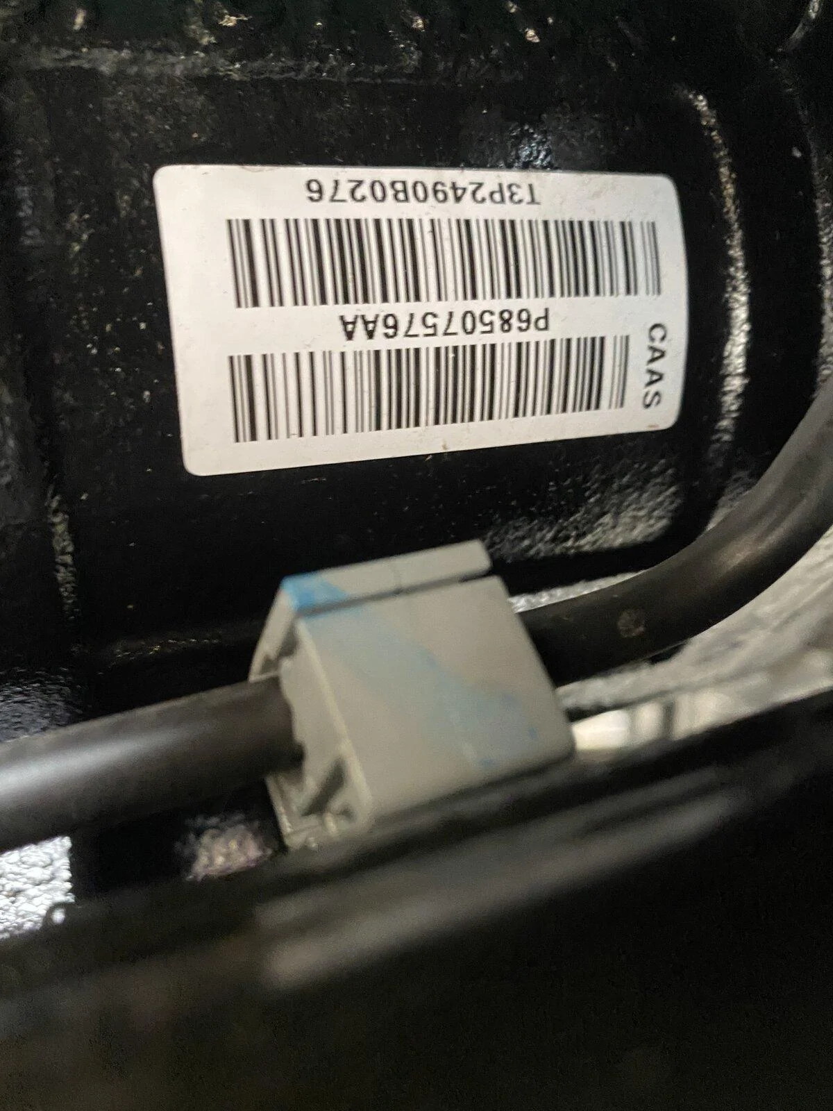

I can tell you if they screwed it up....Old Testament rage. It clearly has the right part number in the work order. I doubt they did. But 2020. All bets are off.
Shouldn't have to crawl under...just peal back the inner fender liner just a bit on the driver's side and you should see the label...once you spot roughly where it is, you can just put your phone in there and take a pic...
