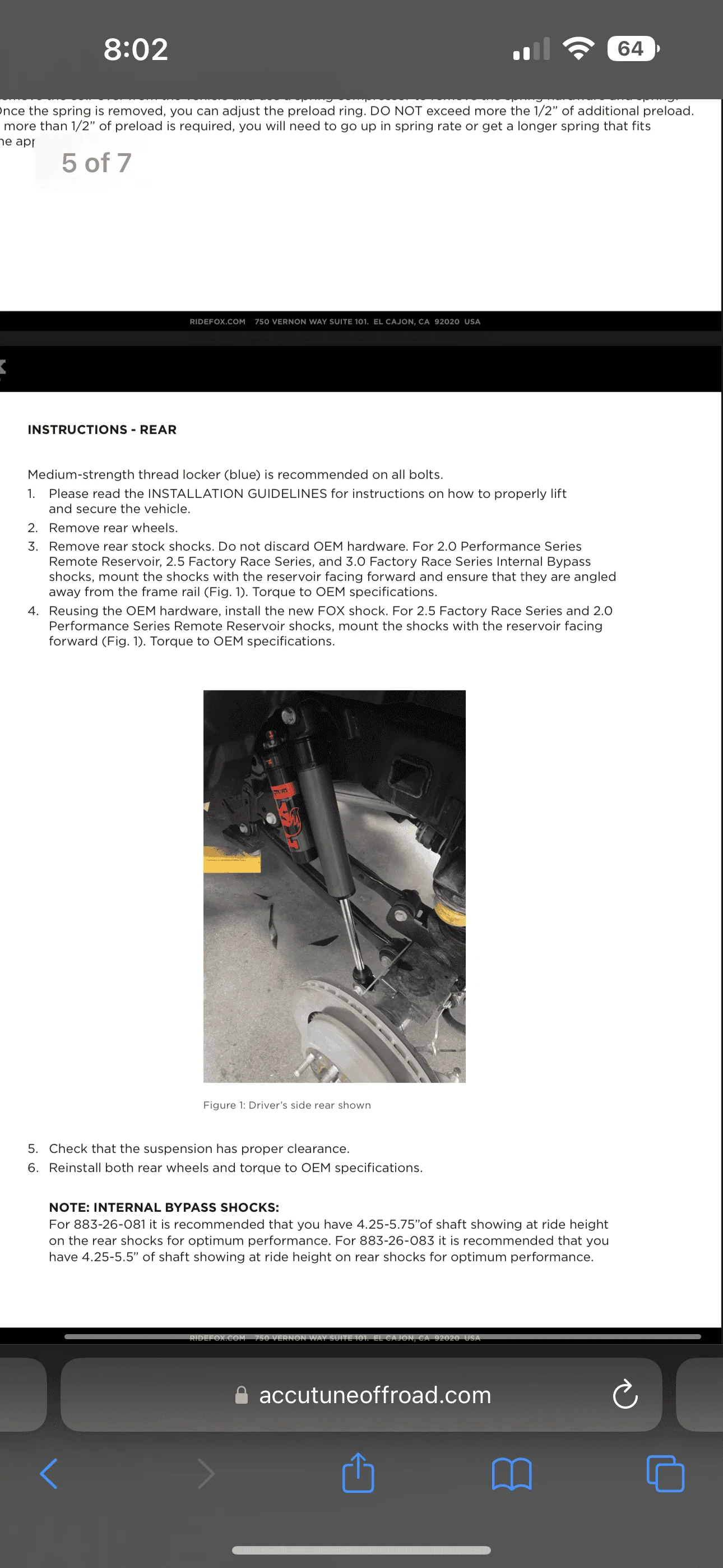

So I just installed Fox 2.5s on the rear and followed the instructions. It said the reservoir should face forwards per Fox instructions.

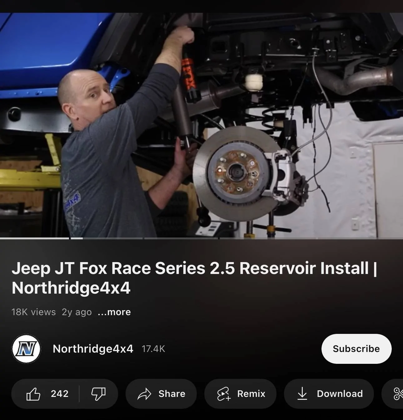

I watched a Northridge install and he put the reservoirs towards the rear. Does it matter which way or the other?

I would follow the Fox instructions. If anything bad happens they can't say you installed them incorrectly.

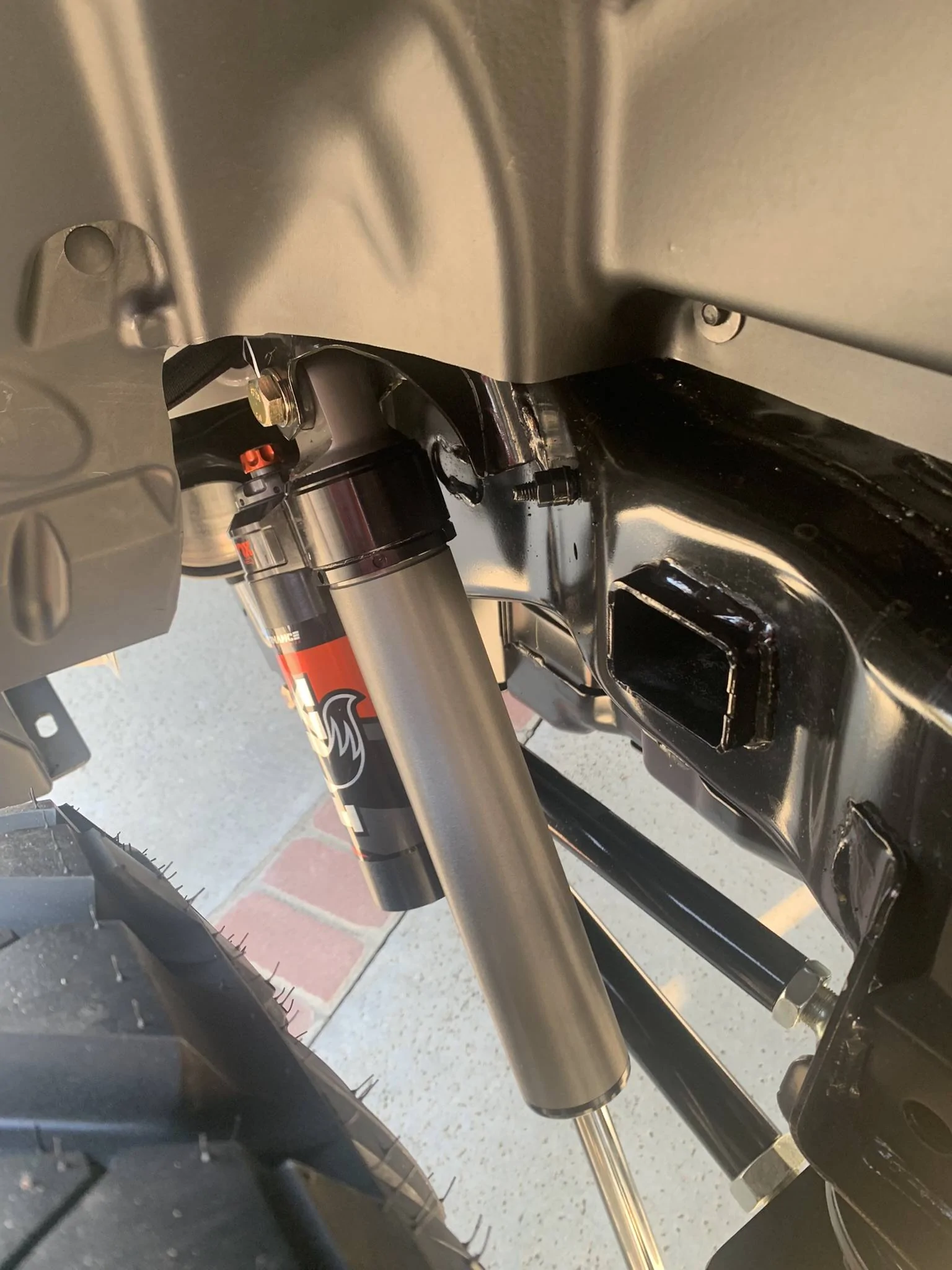

Here’s how mine are mounted. This is the driver side.

Good lord, your truck is clean!
