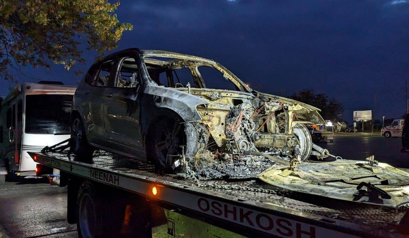

So.....what you're saying is that it's entirely unreasonable to expect a car manufacturer to produce a vehicle that doesn't spontaneously catch fire?? Will insurance bring your family back to life if it burns your house down in the middle of the night????
It's not "spontaneous". There's a reason. It's just unknown at this point. It may have nothing to do with the manufacturer.
You should always have things like smoke detectors and evac plans to help protect you and your family. Don't rely on others to plan these things for you, take the initiative and do it yourself. I have, and that's how my family and I survived this:
(And no, I am not blaming BMW for what is being described here as a "spontaneous" engine fire.)

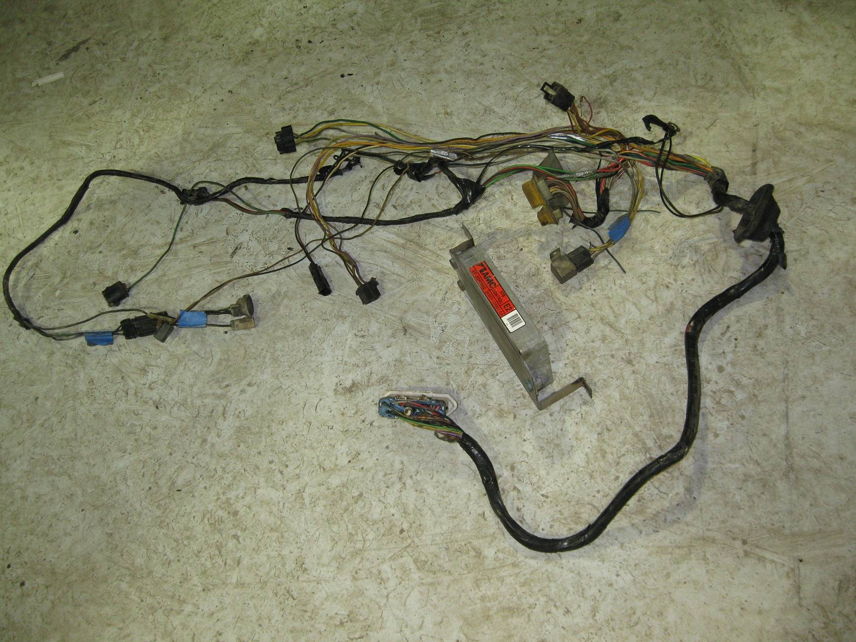

Need to go back farther - I have a big fat book for the 1994 ZJ and the electrical alone is a huge section with page after page of wiring diagrams and schematics. I think the PCM connector alone was something like 50 wires.
I had to figure out each one to get the engine to work in my SX4, and merge the 1982 wiring and technology with the 1994 wiring and technology. Anyone who ends up with that car after I'm gone will be bald after ripping all of their hair out trying to figure out the wiring - unless they also get my sheets of diagrams I made to show what wire ended up in which color and where. Even 1982 was a mass of wiring, control modules and multiple pages of vacuum lines. There's a full page of just the 4x4 vacuum control diagram, not to mention the complex emissions control wiring and vacuum diagrams.
This was the "ECM" that sat behind the right kick panel in the car, and the wiring harness that went out to a multitude of relays, sensors and solenoids, etc. in 1982.
Only a handful of people today could get it figured out. This doesn't even include the electronic ignition module, etc.

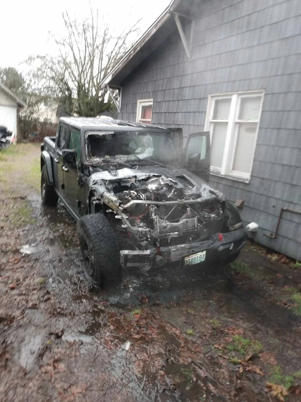

"An Auburn, Washington owner told NHTSA a 2022 Gladiator after just 1,758 miles driven burned while parked next to the owner's house despite not having been driven for about two weeks."
...this is a concern.
That was me. (Play the video muted if you're sensitive about language.)
