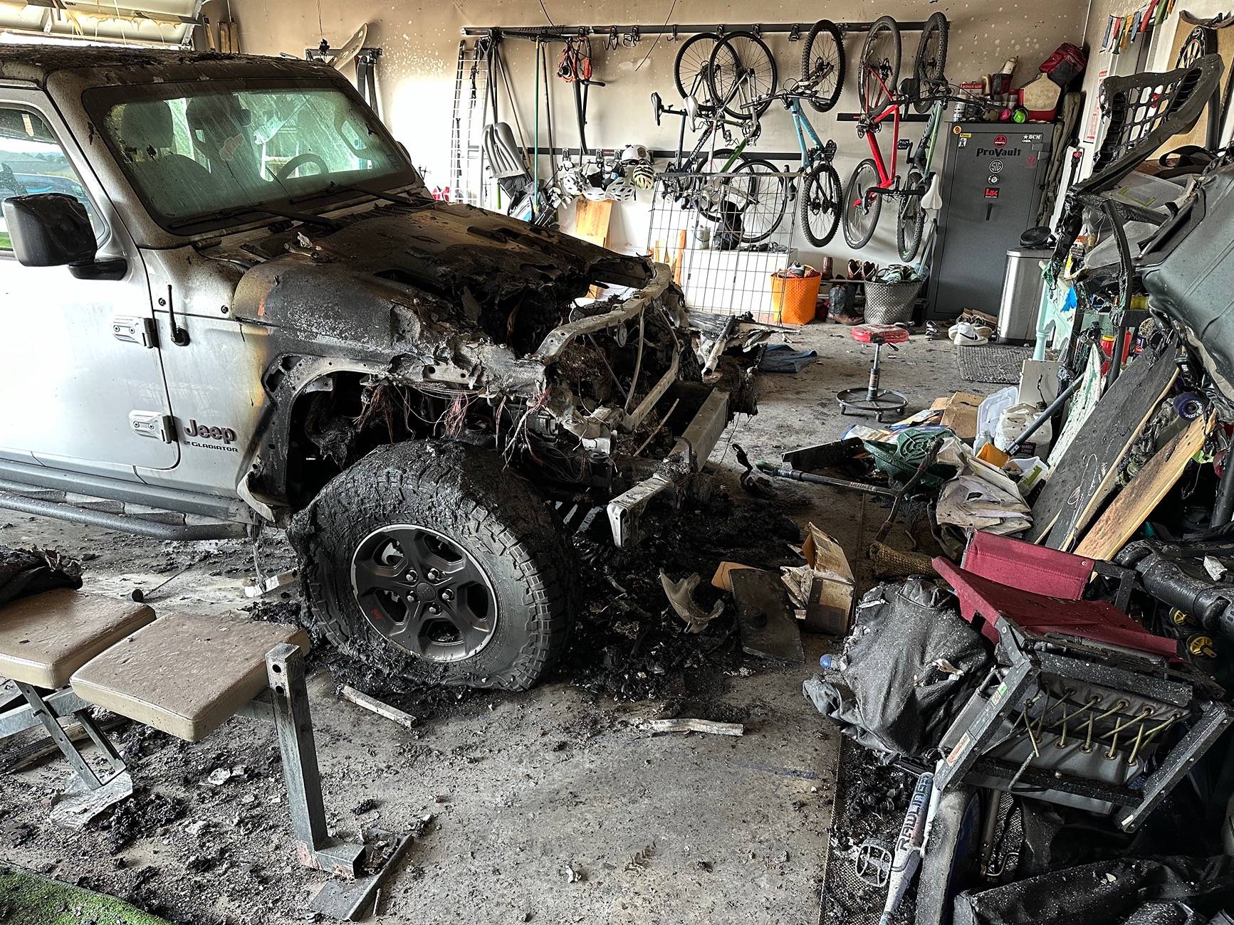

This is real and I'm pretty certain it's what caused my 2023 Gladiator Rubicon to spontaneously catch fire.

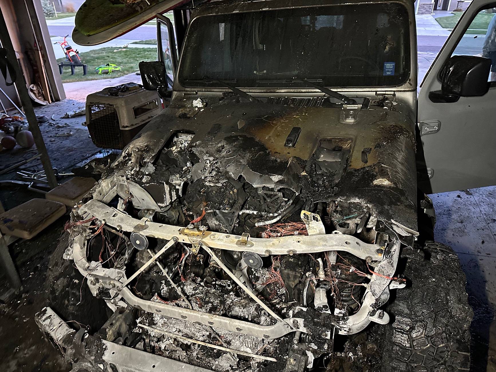

Brief summary: 2023 Jeep Gladiator Rubicon purchased in late February, 2024, new. It operated well and was without issue. I had made minimal aftermarket changes - sprayed bedliner, running boards, steering stabilizer. No electronic aftermarket additions like light bar, winch, etc. The weekend prior to the fire we crossed 1,000 miles.
On April 24, 2024 (only 2 months of ownership), we returned home from a drive across town and parked in the garage and went about our night. Around 7:15pm while cleaning up from dinner I heard a subtle noise sounding like an air compressor dump. I went to the garage and when I opened the door was met by smoke from shoulder to the ceiling. Flames were dropping out from the underside of the Jeep’s engine compartment. Luckly the garage doors opened and we called the fire department. I was able to hose down the Jeep and keep the fire at bay until the fire department arrived and was able to put it out. The actual fire/flame damage was minimal, however, the smoke damage totalled my garage. All said and done, with the cost of the Gladiator, $225,000.
A local fire investigator was onseen immediately after the fire and completed an investigation. His report concluded the fire originated in the engine compartment, locating in the front passenger side. The Gladiator was picked up by StateFarm, my insurance company, and taken to a local garage. It was investigated by StateFarm and a fire investigator with FCA. All confirmed the fire started in front passenger side, however, no identifiable reason was found. I speculate the evidence was located in the pile of ash below the engine bay.
StateFarm was amazing and paid out the claim without issue. They told me they couldn't subrogate or go after FCA because the cause of the fire couldn't be identified. It'd be an uphill fight for their lawyers. They suggested I contact Stellantis as the property owner. I did and requested they pay my auto and home deductible ($5,361) and provide me with a replacement vehicle of same make and model (Jeep Gladiator Rubicon). They gave me the middle finger and claimed no responsibility. Here is a snippet from their reply, "We have completed our investigation of the incident. We are sure you understand that fires of this nature can occur for a number of reasons not associated with the manufacturing process."
When I found out about the NHTSA investigation I filled an official report. I'm posting here because I'm really upset with JCA/Stellantis and feel they have handled my case poorly and are not a very respectable company anymore. I'll never buy Jeep again. I've owned 3 and still have a 2011 Grand Cherokee. I'd be very careful if you own a 2021-2023 Gladiator or Wrangler. It all just sucks.
To be fair, your local fire investigator, State Farm investigator, and FCA's investigator couldn't identify the cause of the fire. I don't think it's wrong or unethical for FCA to not accept responsibility when there's no clear evidence.

I had a vehicle with 1030 miles spontaneously start on fire in my garage. Thankfully I was home and it occurred while I was awake so my entire house didn't burn down or one of my family members get hurt or die. I was without a garage for 5 month's and lost a ton of personal items. I hadn't done anything electrical and it was kept in a garage without rodents. Yes, none of the investigating parties could find an identifiable cause. I speculate because the evidence was destroyed in the fire. If it was the power steering pump and it was incinerated, one would never know.
I'd like to hear biodiesel and sharpsicle's theories on why the fire started? Come on guys. The most reasonable explanation would be a manufacturing problem. I really just want Jeep to pay my deductible and make me whole. The request for a new Gladiator was a home run swing.
I really hope nothing like this happens to anyone else. It really sucked

If it was a manufacturing problem, it would be happening to more vehicles. At the mileage and age, it was possibly a defective part. You can't rule out rodent damage just because it was in a garage. Without any proof, you cannot reasonably expect Jeep to accept any responsibility. That is why you have insurance.
Tell me about it! I hate those meeces to pieces. And for some reason, rodents love to chew on wires and insulation. And it's not a flavor or taste, it's for dental maintenance according to true experts (not internet posters)
For a fire to start - there has to be a source of ignition. Think back to Ford pickups doing the "spontaneous combustion" thing back in the 1990s. Brake light switch! It was in the master cylinder (or was that the brake line by the master? Can't recall now) but that switch overheated and the rest is history. Ford came out with a kit to replace it with a new design, don't recall how long it too to determine the cause or how many fires there were - but that one would be a really super-easy one because of the location.
These may be caused by wiring or connectors buried deep in the engine compartment, under vinyl and plastic parts that melt and really mess things up. Anyone who has cut and burned trees and brush like I have, and tossed plastic bits in to help get the fire going know exactly what I mean - the plastic gets hot, ignites (not a big flame, more like a candle) and the burning melted bits keep dropping down, landing on other stuff and igniting the other stuff. We have the air box and tube and a lot of other plastic and wiring bits there. Better to have a fire start on the left side than the right side, IMO. Less of that plastic stuff to get drippy when burning and spread the fire all over the place. And - as the fire heats the battery area, fuse panel/PDC, whatever, now you have MORE sources of heat and ignition.
Anyway, for there to be a problem, that cable feeding the EHPS pump has to get hot enough for some reason to take off insulation, and then that cable has to make contact with ground. There has to be heat generated, or sparks generated (sparks likely wouldn't do it - there's really no fumes to ignite on these, not like my poor Javelin. Clue - don't prime a dual quad engine with the air cleaners off and have it backfire. I was lucky. )
So if it's the EHPS pump feed - for some reason, it's getting hot enough to lose insulation and then making contact with something of the opposite polarity. You can run with a wire with no insulation and be fine - it's when it touches a ground that things get stupid crazy.
