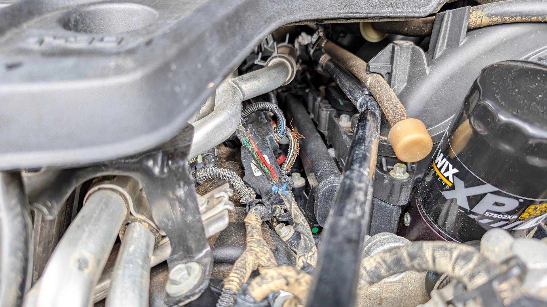

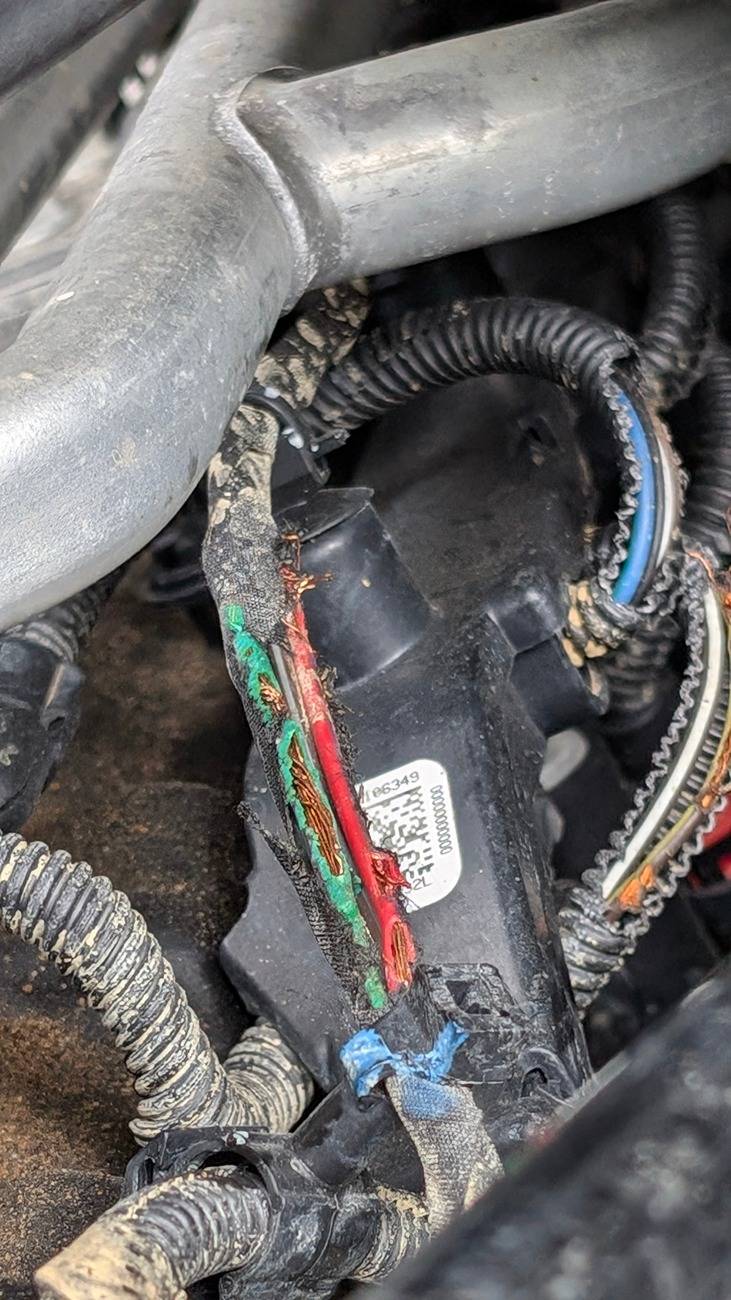

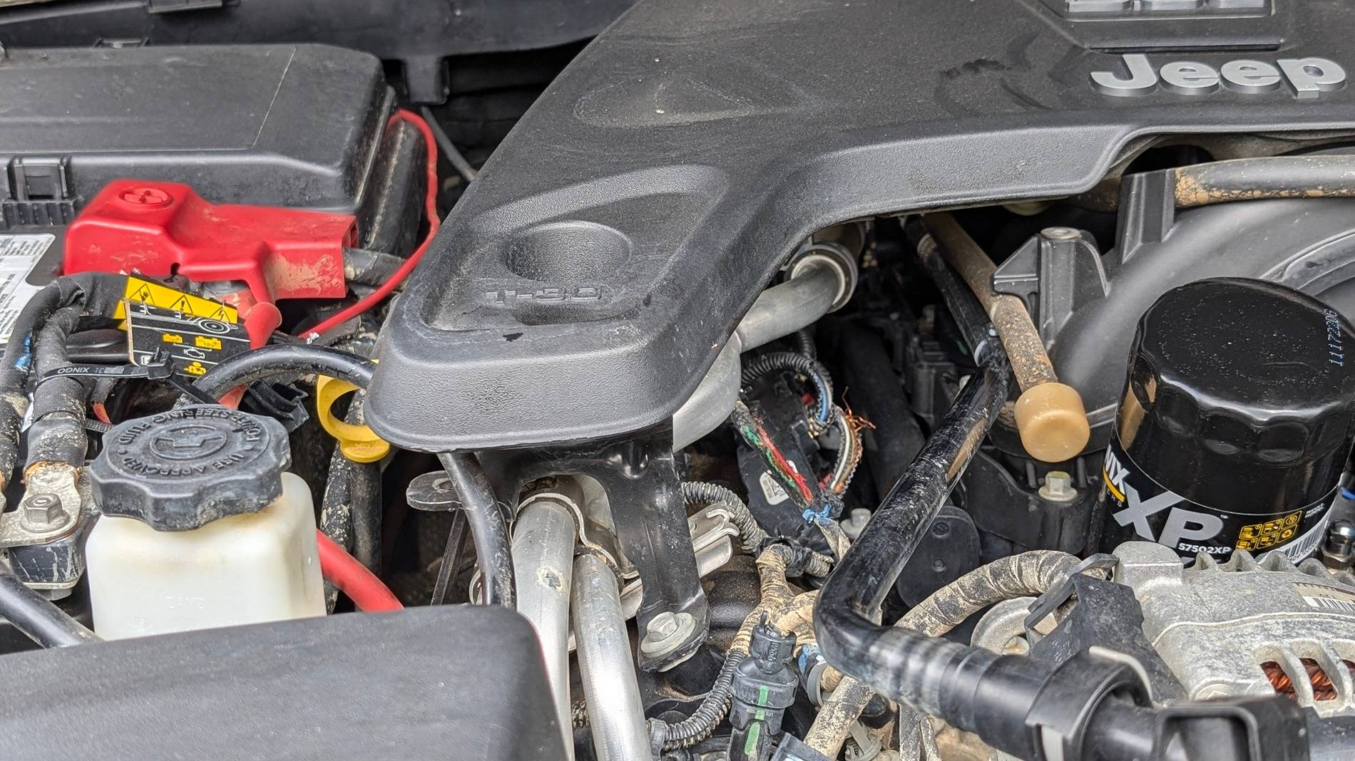

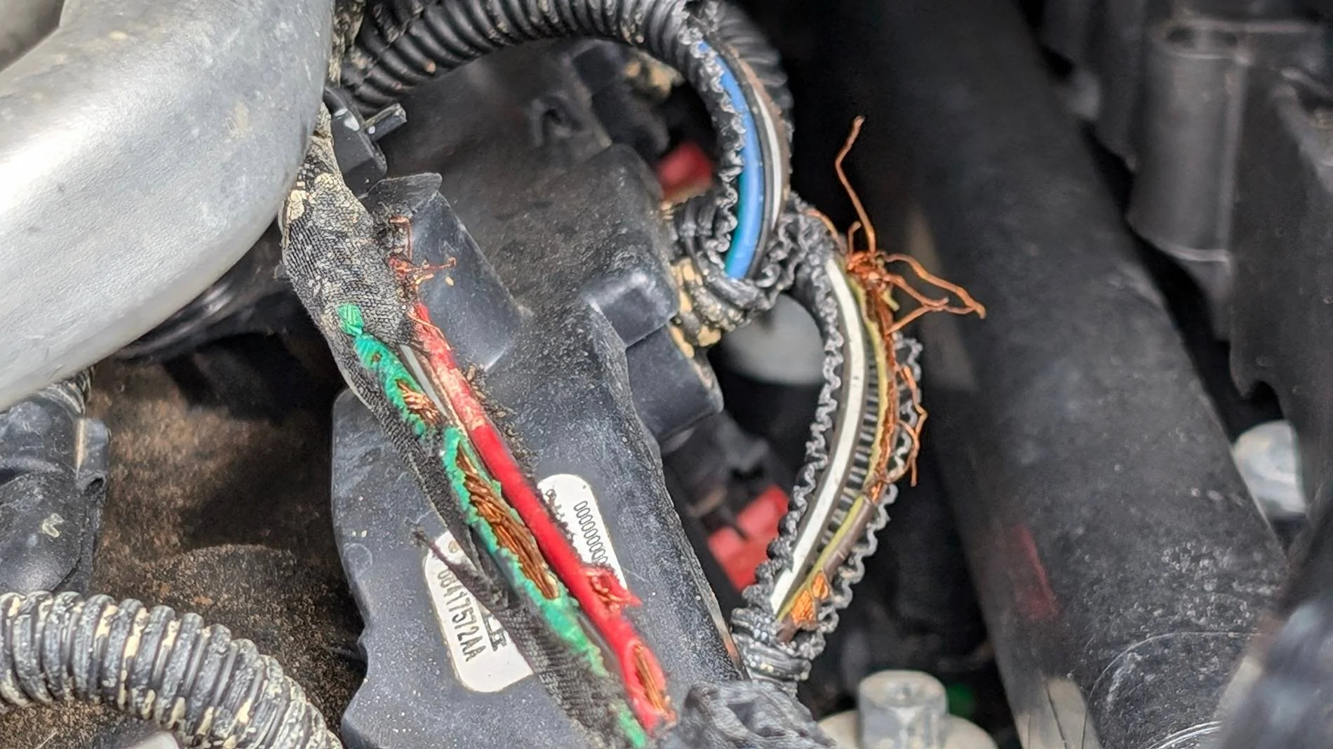

I just found this while changing my oil and air filters this weekend: Can anyone confirm if this is the same issue?
That is rodent damage.
Unrelated.
Man thats bad. Time to set traps under the hood and salt the earth under it with poison. Moth balls...
seriously, and look for other damage as that is real bad.
