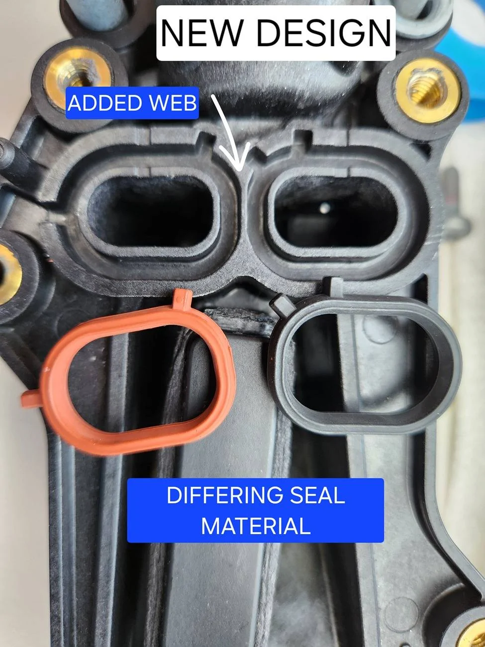

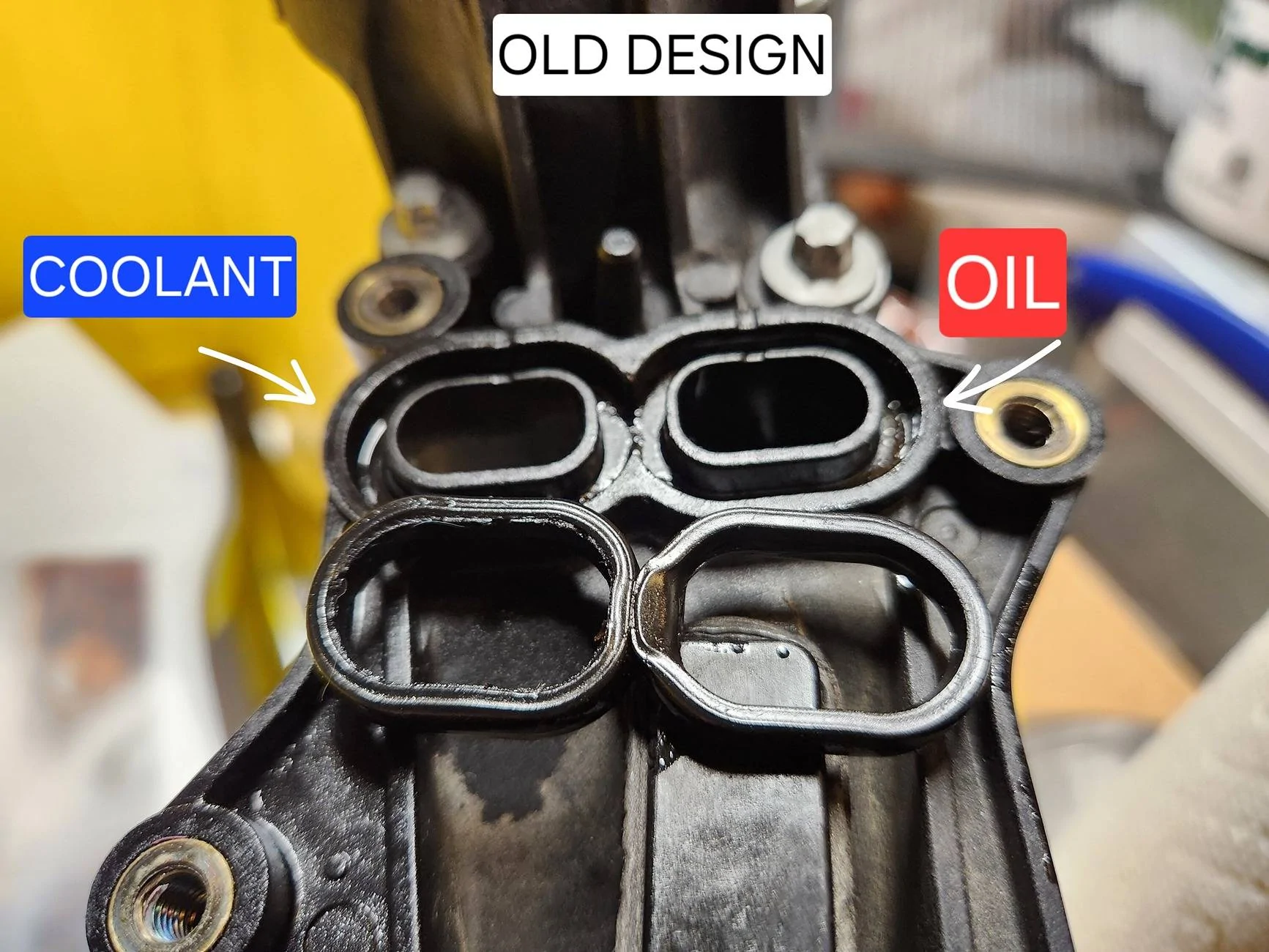

How can I tell if I have the old oil housing or new one - there a website? I been searching Vin, part# and ...etc. yaa. - build sheets arent showing me part#'s. Like this is the new one 68596318AB

Based on what I can see in the 2023 parts data it is not the new design.
I also wanted to note that Mopar now also sells the Dorman aluminum version through their affiliate program. We can get them for about 240.00
Please let me know if you have any other questions at this time.

Thanks Benny, I was leaning on the Dorman as I plan/trying to ensure my Egnine lasts my lifetime - but I guess the redisgn mopar did is better/fixed the issue of original issue? - IDK ppl have thoughts
Which:
Part Number: 68596318AB
or Dorman
https://www.dormanproducts.com/p-13...pe=Engine%20Oil%20Filter%20Housing&origin=YMM
