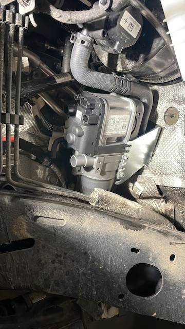

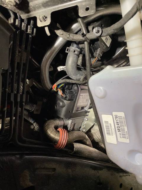

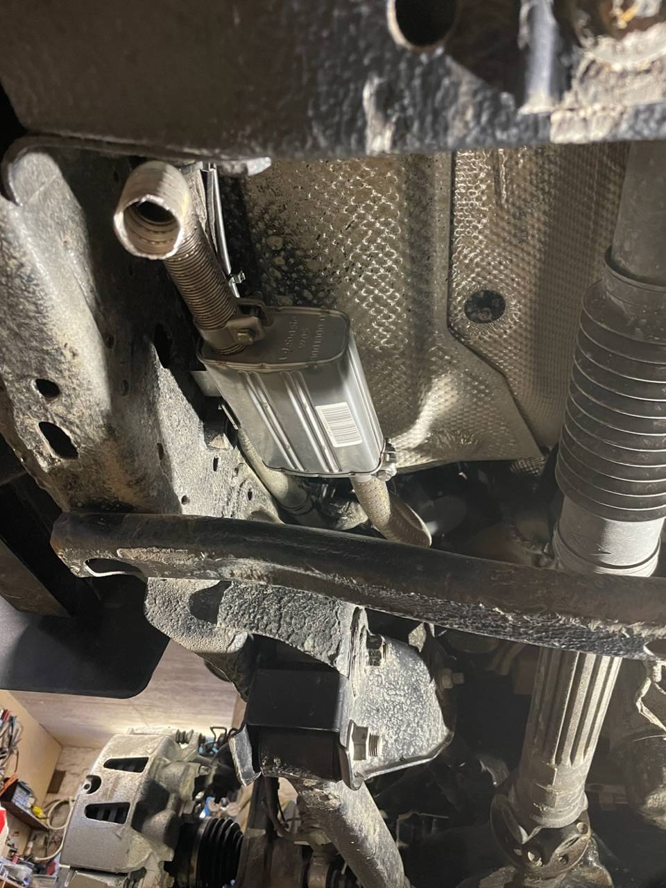

Started to build a webasto heater for my JT.
There is a Webasto kit for a ”parking heater”, but that doesn’t warm the engine ( probably because then it is not anymore euro6 emission engine)
But i want that the engine is also warm at those cold morning starts.
I bought the Thermo Top Evo 5 heater with universal install kit, and few extra 90° hoses and other parts.
Heater fan control kit is for JT (and other Jeeps)
Also i will install the Thermoconnect, easy to use app for the phone. App will show inside temperature in the cab and battery voltage etc. Also the thermoconnect device have a GPS antenna, you can check the location or activate the alarm if the Jeep is moving out of the area where it was parked.
Few pictures, more will come after i have done more work with the install.
Heater is located under the brake booster, this is the place where Webasto installs it in the instructions. Water pump is over the heater:
Jeep Gladiator Webasto engine heater B794489F-8809-46FA-BDD8-AD56AE5D987B
Jeep Gladiator Webasto engine heater 75E6D327-B987-43F3-8AA9-8D678A90327D

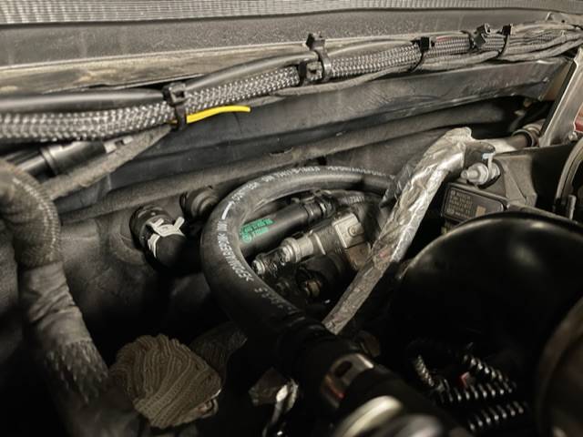

Heater hoses. 90° with green marking is the heater core inlet ( this hose goes to webasto outlet).
Long straight is the engine outlet ( this goes to webasto water pump inlet)

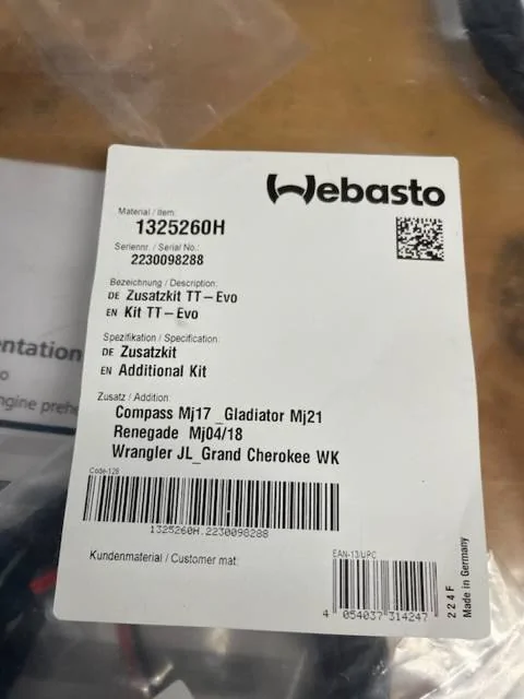

And pictures of the part numbers:
This looks a lot like a “frost heater” for VW’s.
If so, are you going to use in conjunction with the block heater??

No need for the block heater.
This will warm the engine and cab in 30 minutes.
5kw diesel heater.

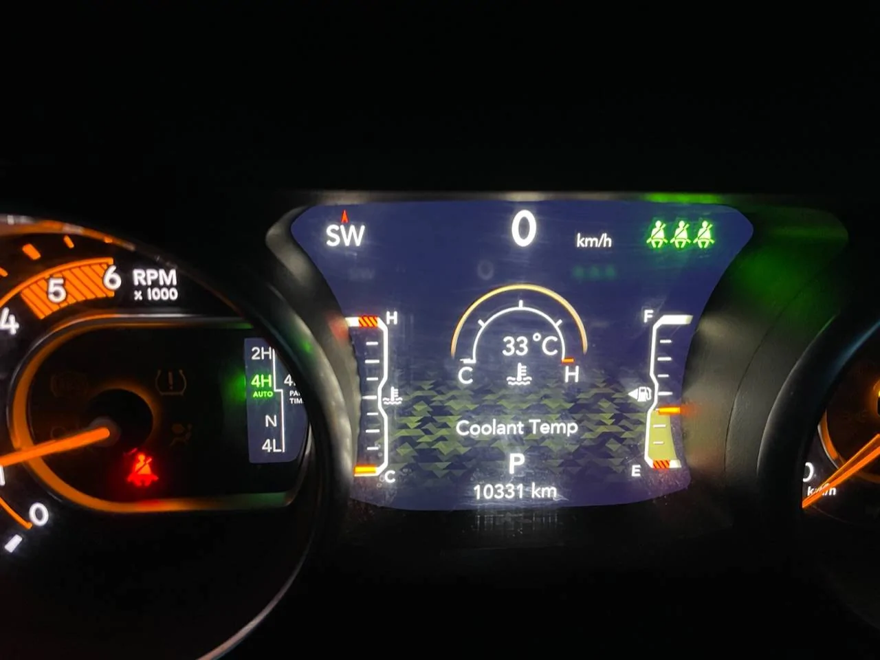

First test done.
Jeep was outside for the night, in
-7°C (19.4F) temperature.
Webasto was on for 30min.
Coolant temp 33°C (91.4F) and inside the cab was 8°C (46.4F)
Those aren't bad numbers for 30 minutes of run time. If I recall right, the 5.9/6.7 Cummins burned about a gallon per hour of idle time, I'm guessing the EcoDiesel would be 2/3ish of a gallon per hour. The preheater I believe is some where around 1/8 of a gallon or less. Plus the no idle time on the ED would be a major benefit. Pulling those numbers out of my head, it's been 10 years or so since I was around those webasto heaters.
One problem that most of these heaters have, is that the thermostat in the vehicle's engine cooling system doesn't open until the water temp reaches 160-180°F. So you don't get much water flow thru the vehicle's heater core, of course some water will flow around/thru the thermostat.
Out of curiosity, does this system turn on the Gladiator's fan, the one to circulate cabin air?

water flow is enough, engine outlet for heater is in thermostat housing and intake/heater outlet is usually in block/water pump.
yes, there is relay system which turn on the fan to circulate the air
