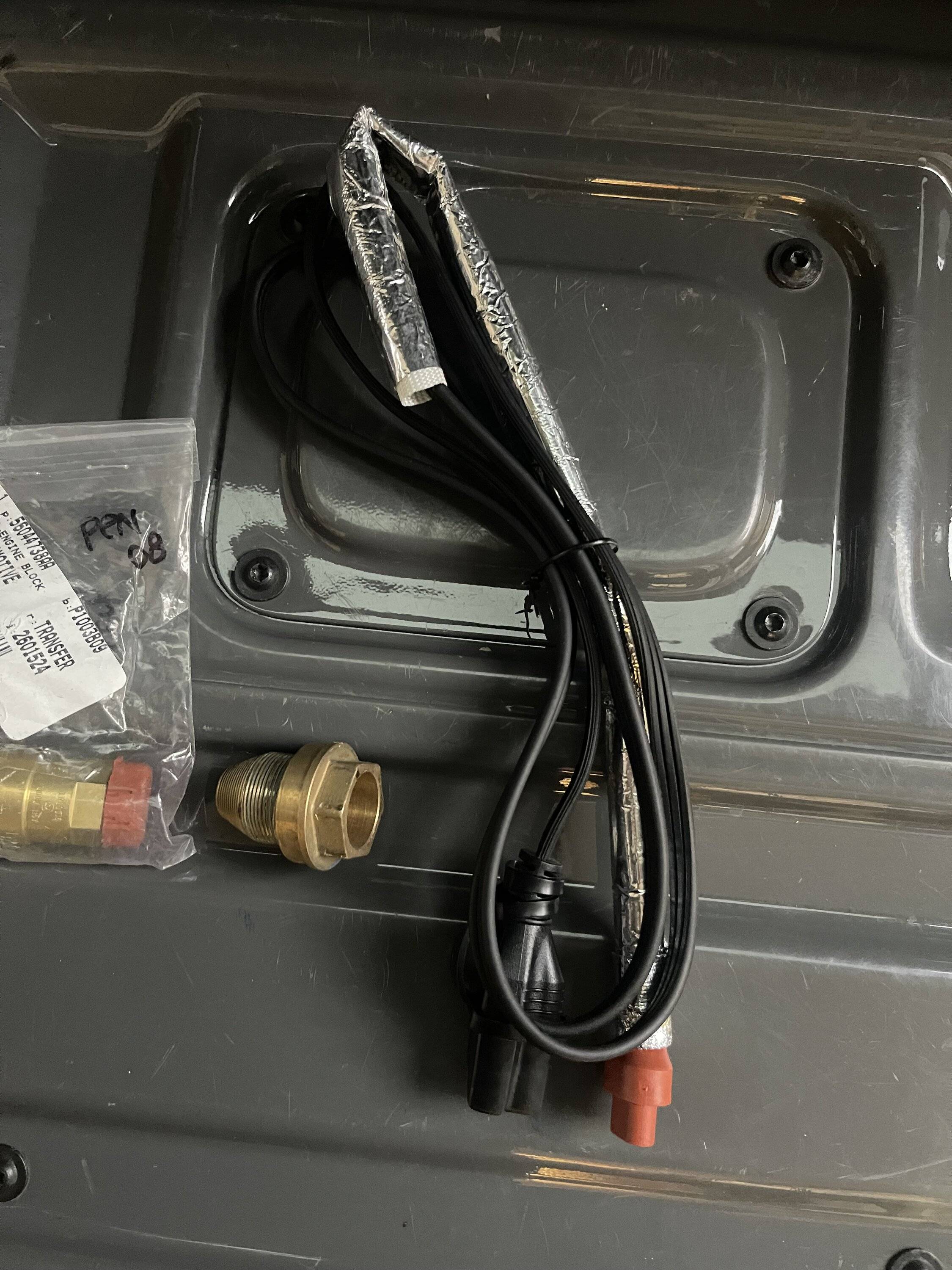

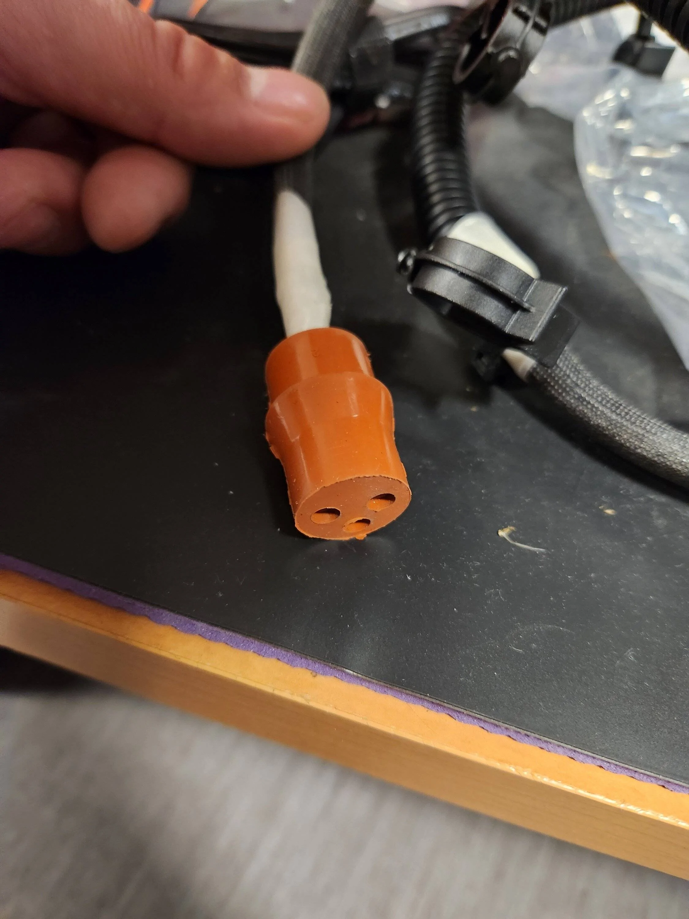

Got my cord today, will install tomorrow and report back later.
Why is there threads on the heater, but nothing on the cord to thread it? ? thats kinda dumb.
Pics of the heater , wondering what threads you are talking about.

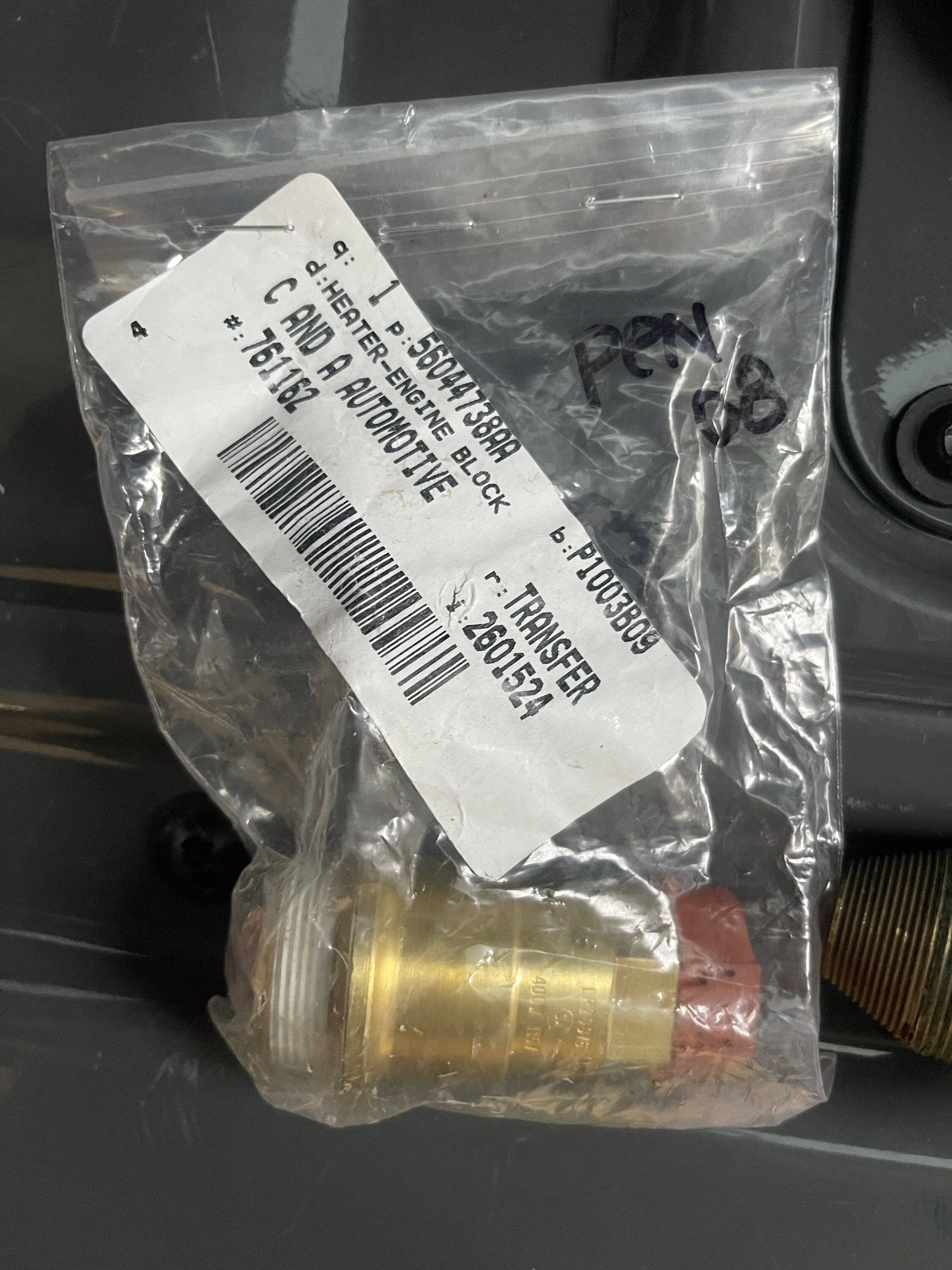

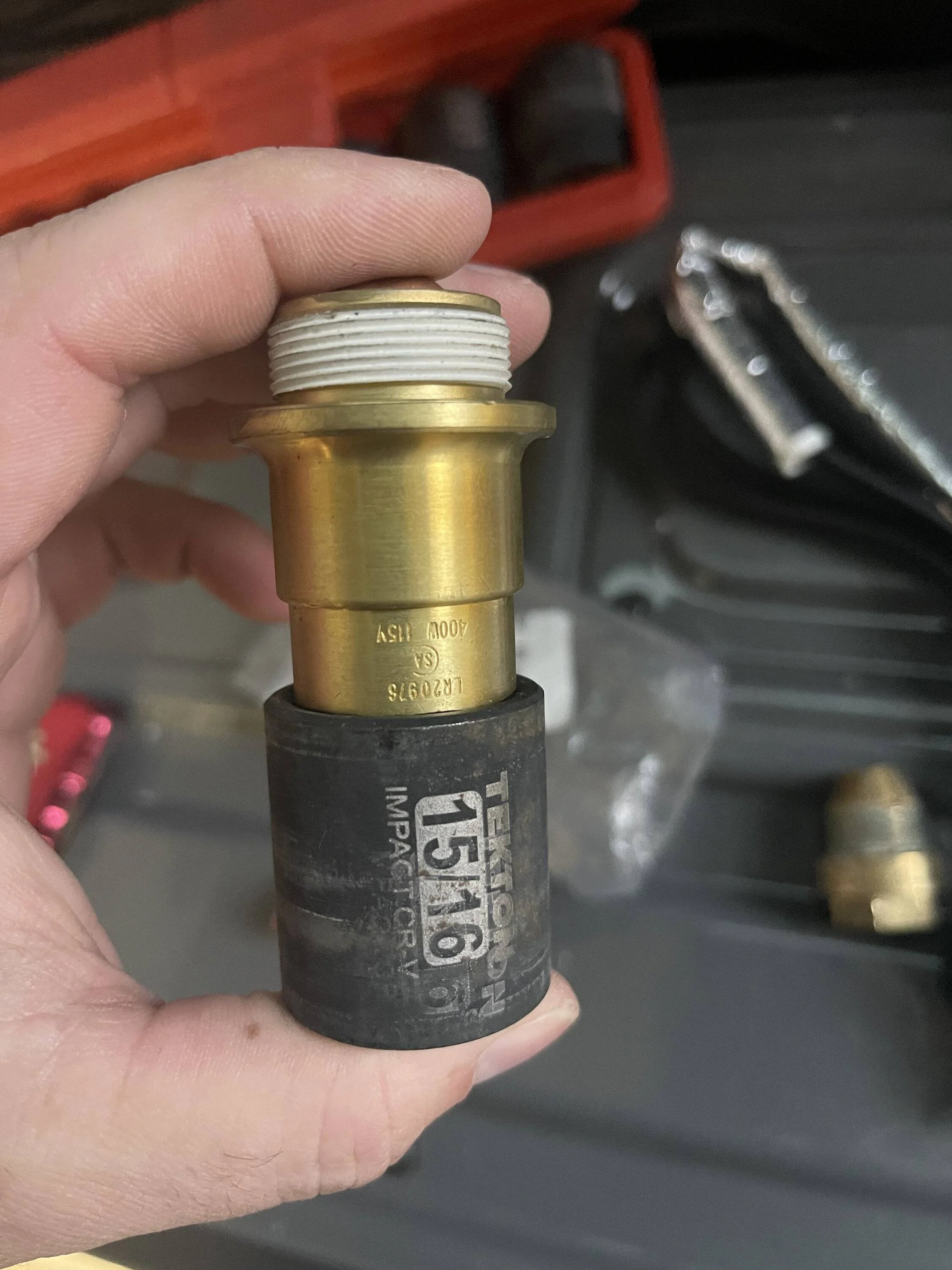

I just went through the same thing. That part (68523853AA) is not for the gas engine. You insert it into the brass plug that is in the block. It fits perfectly and clicks when it’s fully seated. No need to drain coolant or remove the plug. I scratched my head for two days and almost sent the part back until someone on Facebook posted a pic of the same part inserted into the brass plug. I was like, “What? No way!” But, it works.

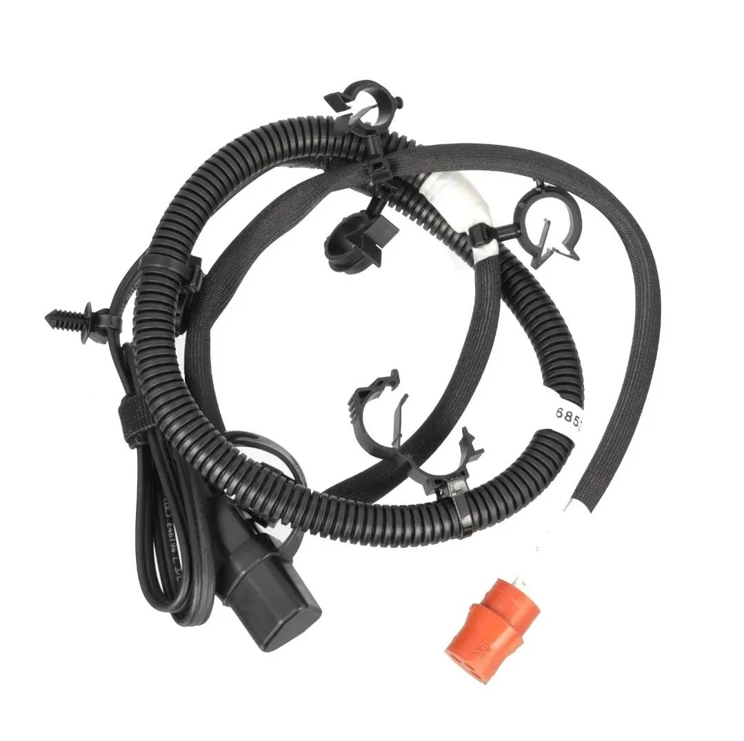

What cord did you get to work with it ? The Mopar plugs ,I saw didn't have a screw cap that screws onto the heater ... it looks like it just pushed on... but it appears the heater has threads for the screw cap ?
Was the part#
68535072AA

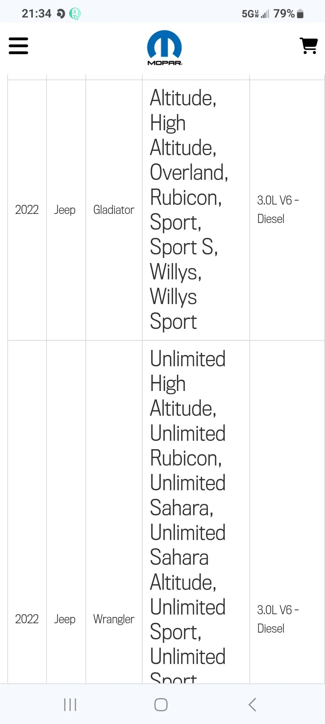

Jeep Gladiator EcoDiesel Block Heater Installation Screenshot_20231220_214512_eBay
12,260
32,670
Was the part#
68535072AA

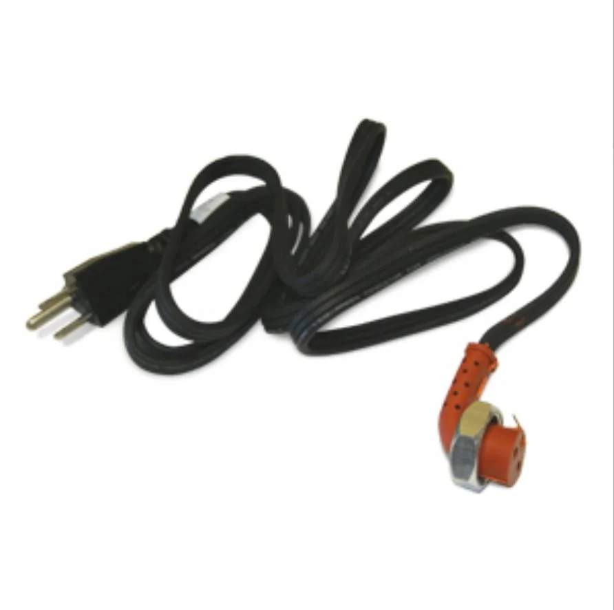

I have the old style block heater and cord. From what I've seen. All the cords just push in.

I think so. It’s listed for the ‘23 but I don’t see it listed for earlier models. The question would be if the factory brass plug for the ‘23 is the same as previous year models, or if it was modified for ‘23 and this part only fits in the ‘23 plug. I don’t know.
Its listed for 22/23

The plug for the gas is completely different.
Yeah, just realized... been starting at this screen to long.
What I can't figure out is why Mopar didn't add a screw cap to their plug, looks like both heater styles have the threads for it.
Like this:
Jeep Gladiator EcoDiesel Block Heater Installation Screenshot_20231220_214834_Chrom

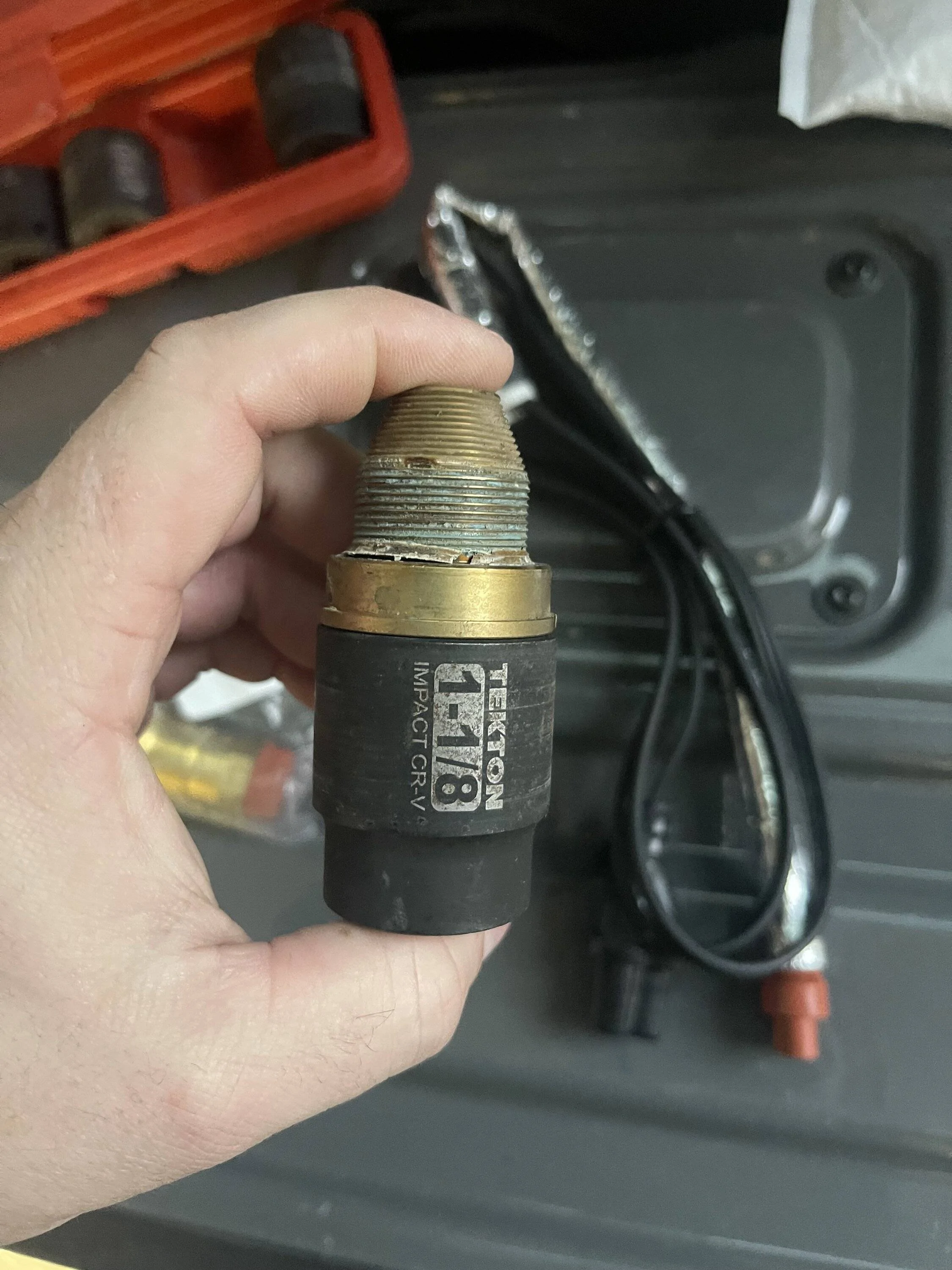

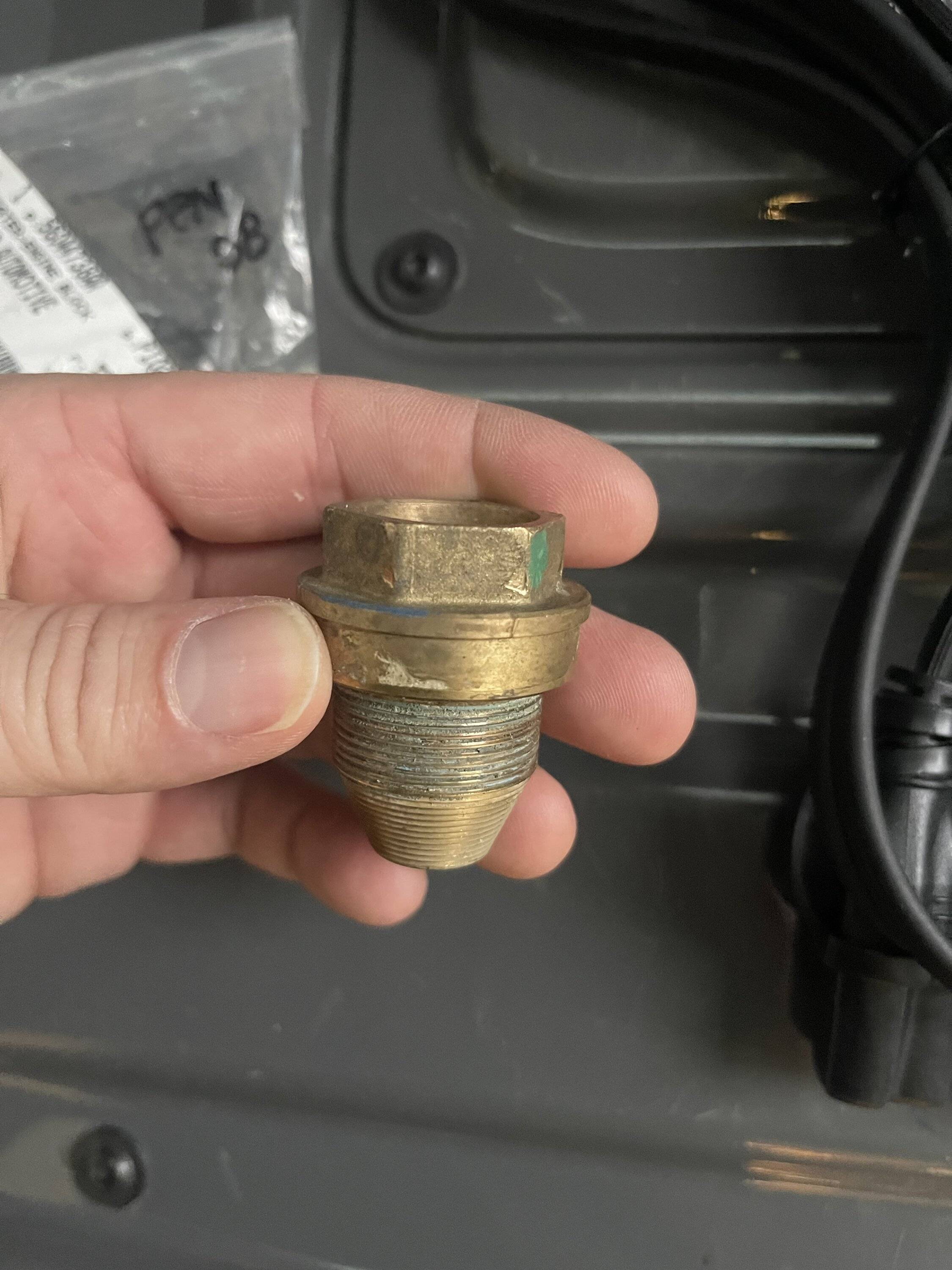

Confirmed it will fit in a 2023. Literally just put this stuff in this past weekend.
Don’t forget the “Mopar” coolant…. Didn’t need much…. But did need some.
Heating unit:
Plug that is in the block and needs to be removed.
Did you get the oem plug ? Or is it aftermarket ? If aftermarket, link please ?
