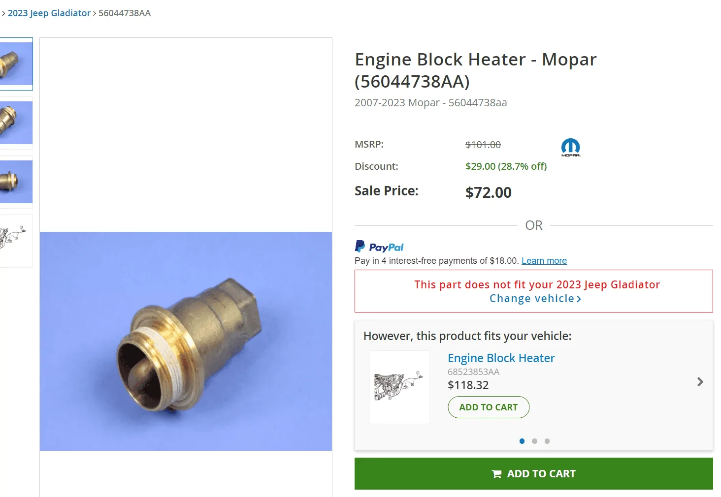

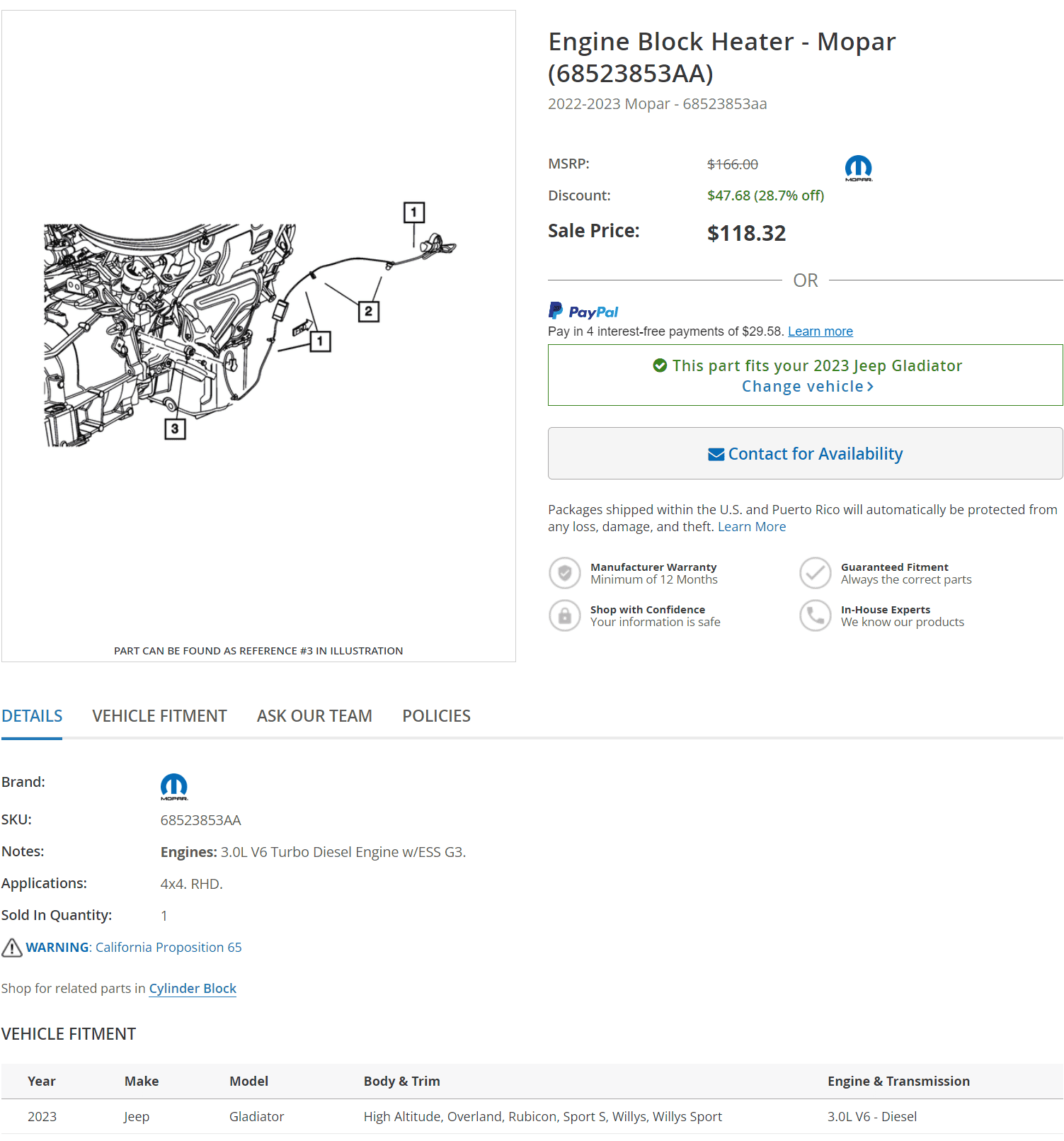

Thanks everyone for providing the "how to" info in this thread. It is especially helpful since the dealer wanted $1000+ to install the block heater. I have a 2023 JTRD and since I am in Calgary I will need a block heater this winter.
I looked up part 56044738AA the various online Mopar parts stores show this as for the 2021 JT Ecodiesel but not the 2023. So I ordered the part they show for the 2023 JT Ecodiesel 68523853AA and it doesn't have a threaded end for the block (but it does for the cable end ???). Chatted with online store and was told based on VIN that this was the correct part and I should see if there is an alternate location to insert it.
I returned the part and just wanted to see if anyone could confirm that 56044738AA will work in the 2023 JT Ecodiesel which I assume it will as I can't believe they made any changes from 21 to 23.

The 56044738AA from the 2020 JT is the one I used in my 2023.
That 2nd one, 68523853AA is for the gas engine.

I just went through the same thing. That part (68523853AA) is not for the gas engine. You insert it into the brass plug that is in the block. It fits perfectly and clicks when it’s fully seated. No need to drain coolant or remove the plug. I scratched my head for two days and almost sent the part back until someone on Facebook posted a pic of the same part inserted into the brass plug. I was like, “What? No way!” But, it works.

https://store.mopar.com/oem-parts/mopar-engine-block-heater-68523853aa
Has it listed for 22-23 models.
Damn. I mean the other option wasn’t difficult to put in… but I mean- this new version seems like it would make this a 5 minute job.

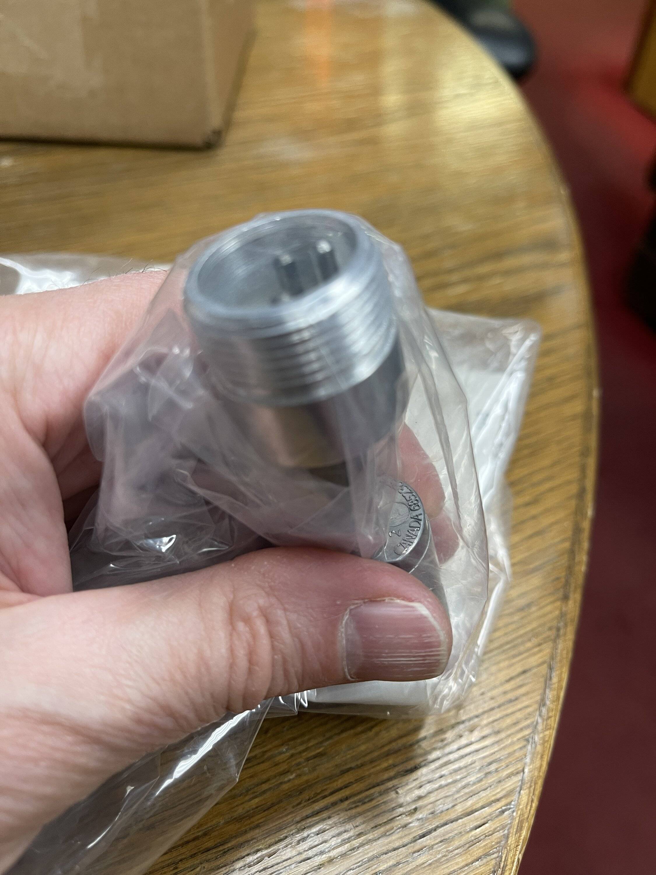

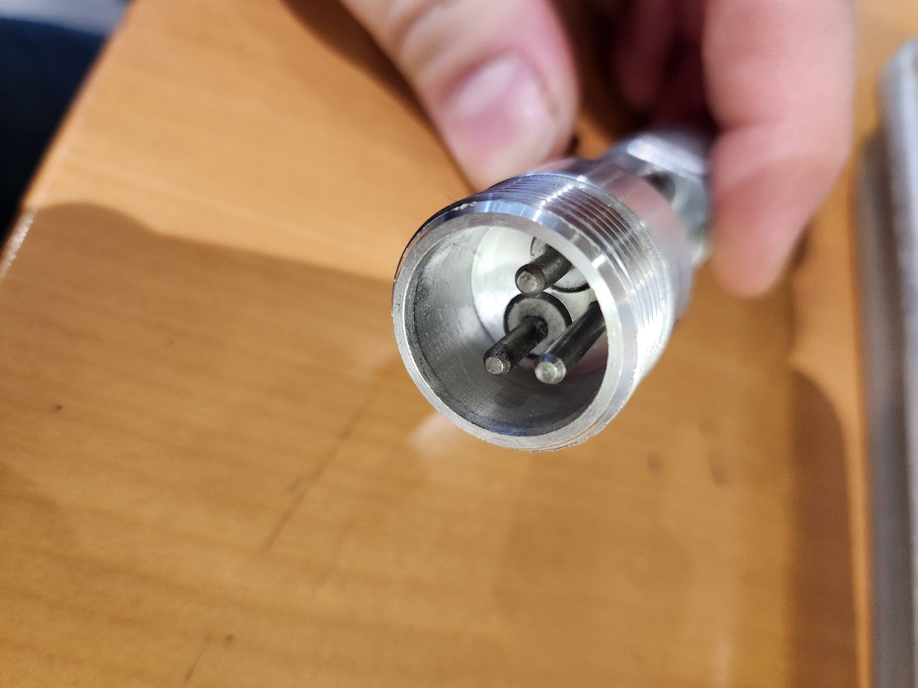

Would you mind posting a couple more photos of this? The two ends.
Please/Thank You.

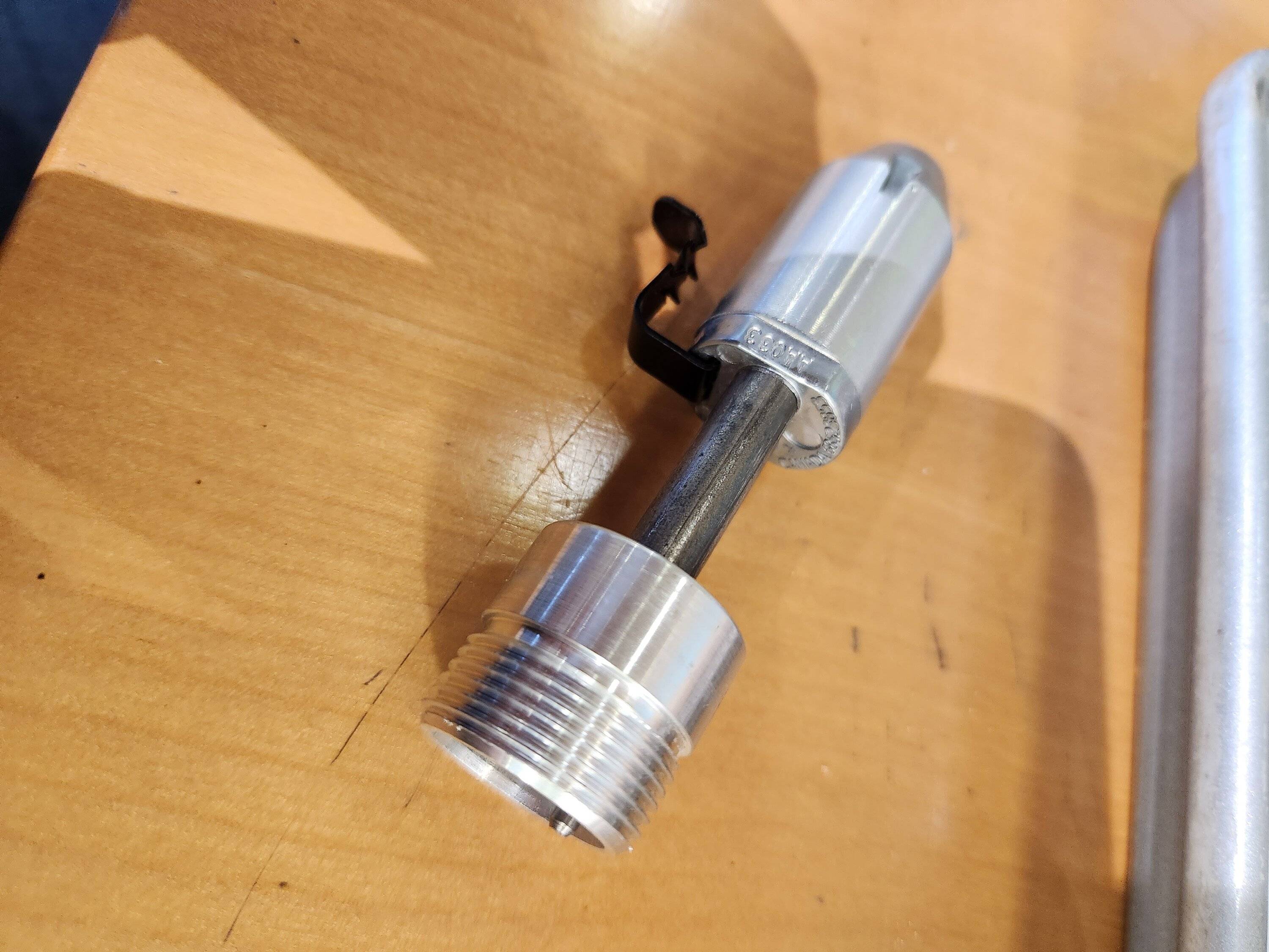

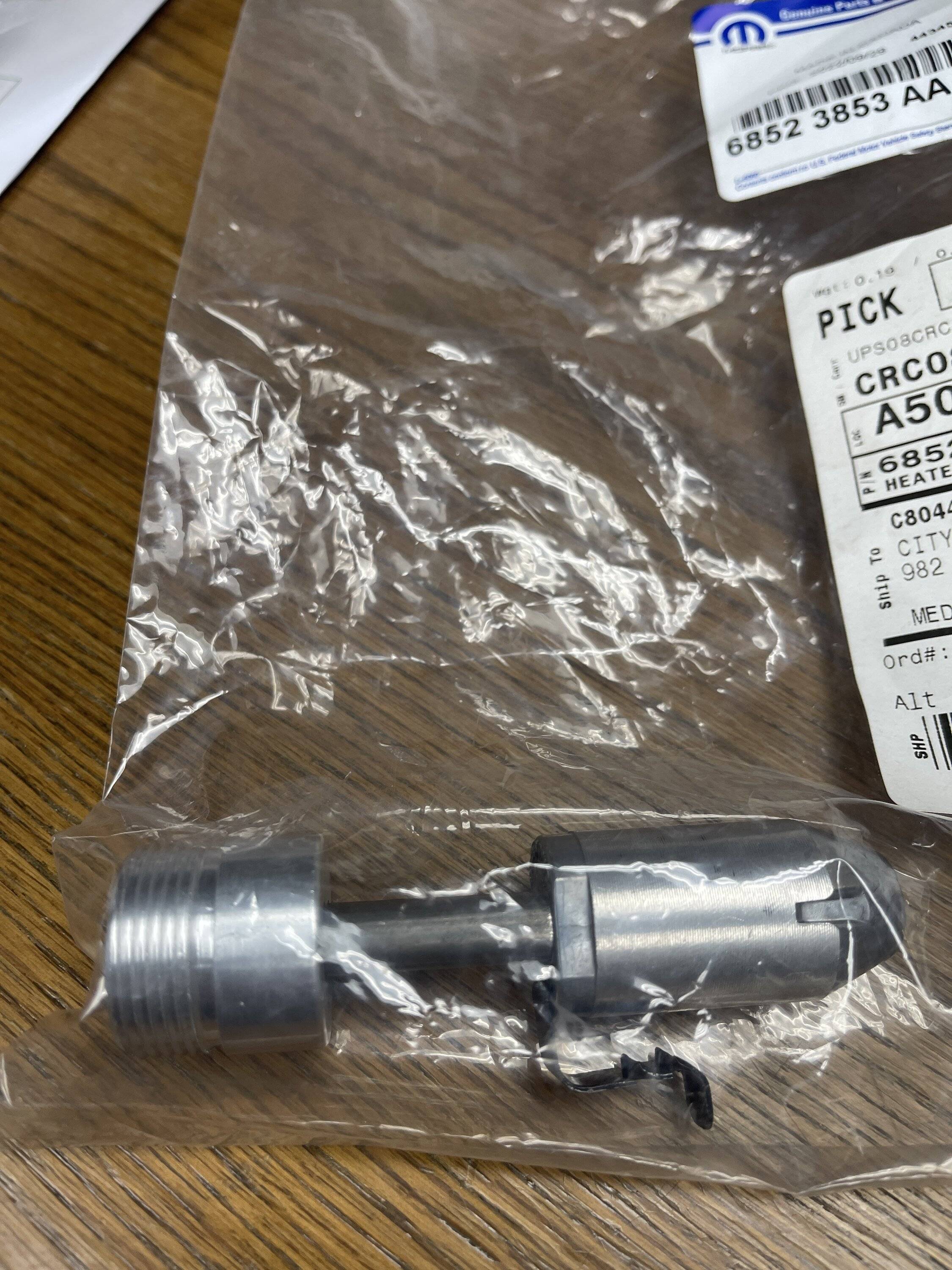

Here is a (bad) photo of the cable end of 68523853AA. I already sent it back as I couldn't believe it would seal properly. Once I install 56044738AA I will take a photo of the brass plug and see how easy it would be to drive through the middle of it with a socket to see if is possible to install the newer part by pushing it through.
Edit: if I was only smart enough to realize the new style clips on the brass plug and is not driven through it...
