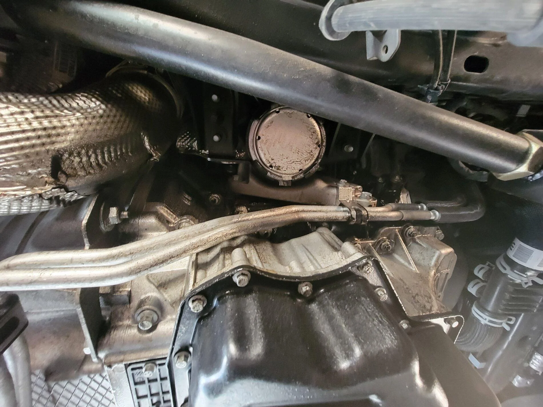

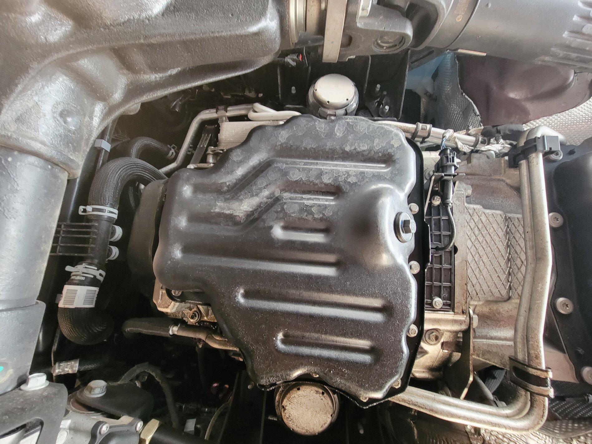

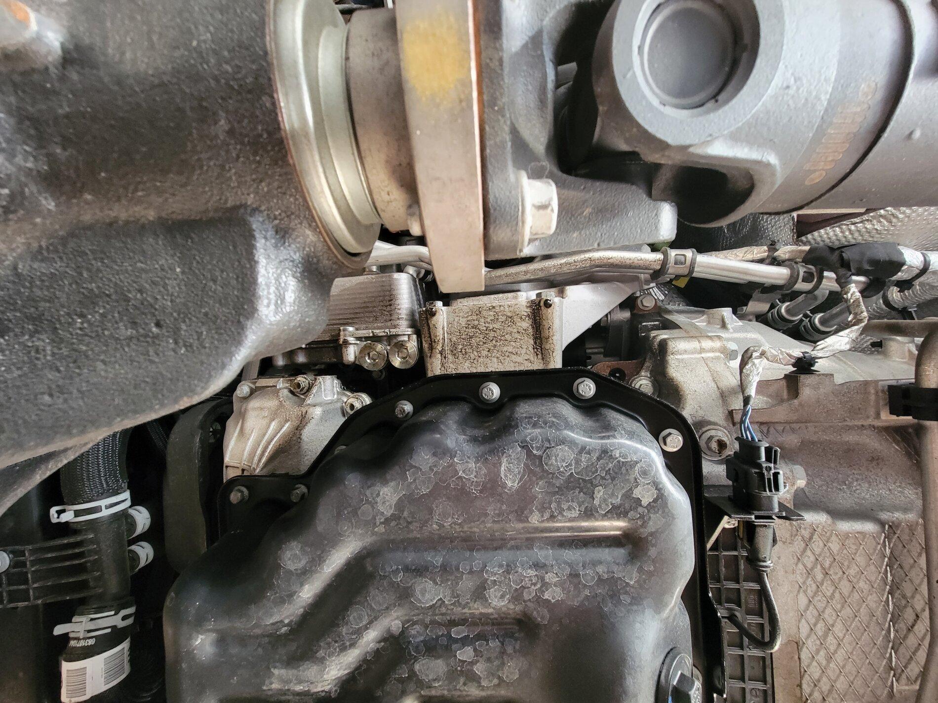

I‘ve seen two cracked 3rd gen EcoD blocks and both cracked between cylinders 2 & 3 on the passenger side.

Damn do you have any pics or more info? Where do they crack? And how did you find the crack? Thanks!
12,203
32,487
That's about where the block heater is at.
