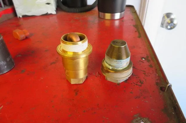

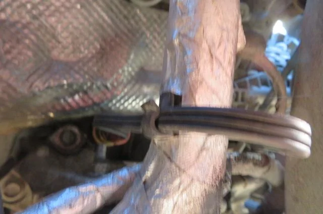

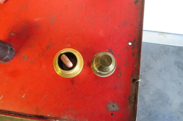

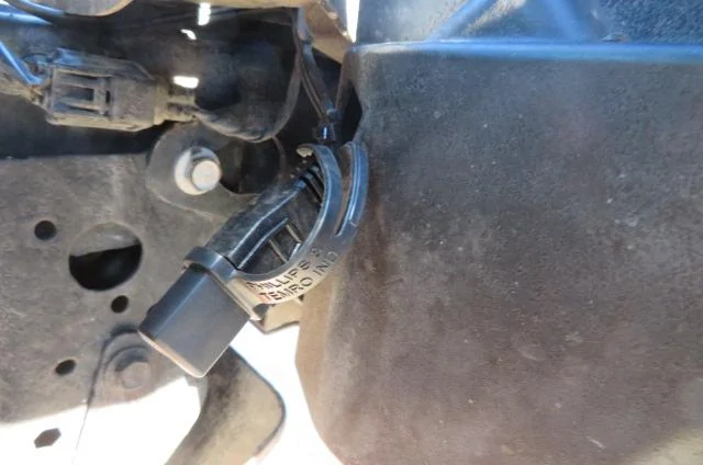

Installed the block heater in my diesel today. Simple job uh. Unscrew the block plug and screw in the block heater. Figure 45 minutes tops. Ehh 2 hrs later. I'm done. Got the old plug out with no problems. Start to thread the new block heater in. Didn't feel right. Took it back out and found the first 2 threads started the cross thread. Chased the threads and cleaned them up with a file. Put it back in and it seated. Torqued it to 75 ftlbs. That's where it felt like it bottomed out. Ran the power cord from the bumper back along the frame. Found hooks on the back of the bumper and on the frame for the power cord. It took just over a half gallon of anti-freeze.

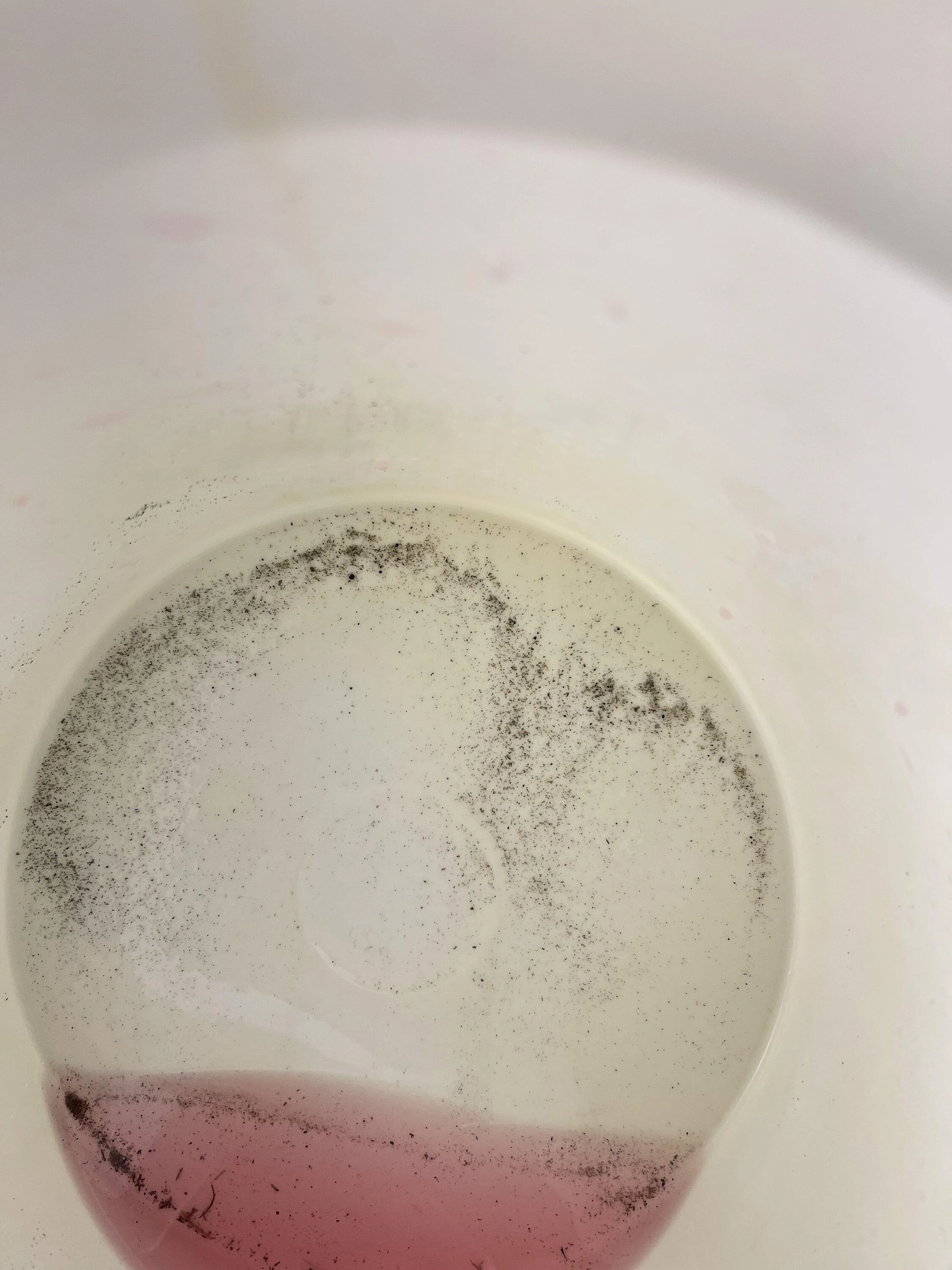

Thanks for this- installed my own heater today… have used it on 3 other Jeeps in the family too.
found mind to be a slight PIta… the aluminum heat shield above the plug had to be bent out of the way to get the socket to fit… no big deal- except it’s a pain to get Up there and bend…. Lol
also noted- these eco diesel blocks are a bit sandy…. Not ford powerstroke sandy…. But more than many other motors I have worked on.
