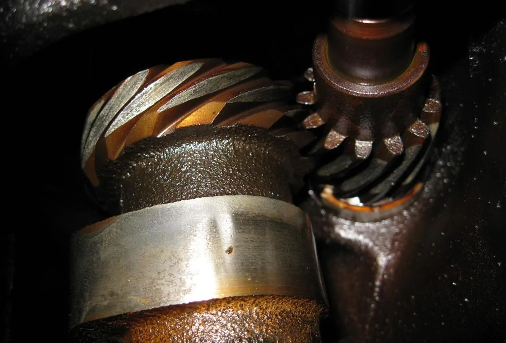

I have to stick to top oil in my Eagle because that 4.0 I built has .023 shaved off the head and a cam that has radical ramps (as rad as I could go on the stock MAP and PCM)
It sounds like a truck engine. It takes a good oil capable of handling those cam ramps as they tend to slam the valves open and then let them drop. It's how they can move more air with less lift.
When I got the donor Jeep with the 4.0 it had 100,000 miles - I expected to be able to simply move the engine over - until I saw the insides of that engine. I have never seen a 4.0 or any AMC 6 worn like this one was. The cam distributor drive gear was toast, the distributor driven gear was toast. It was a total mess. I had to go about .020 under on the rods and mains. Yet the cylinder walls were not bad - not much ridge at all, valve guides had some wear, not horrible. This told me the oil didn't handle load really well. (and perhaps they didn't change it too often?)
Jeep Gladiator What’s everyone using for oil? cam-dist-gear-0055
