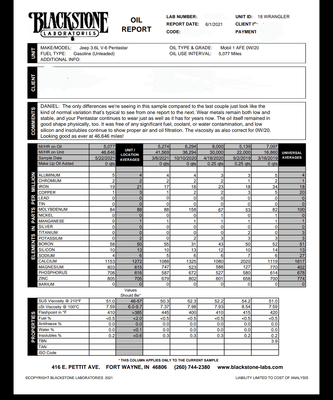

I've used Wix or the cheapest I can find on Amazon. I've had a used oil analysis done every change and they've always shown good filtration. I think the most recent is a Car Quest. That last UOA showed excellent filtration after a super dusty trip to Moab. When I replaced the filter before driving home, I tapped it and a TON of dust dropped out. I always swap it out after a dusty off-road trip, or after about 10k to 12k miles. Cheap insurance. And btw, I think the Mopar filter is very good, too. Just expensive usually.
There isn't enough power gain to justify, IMHO, a cloth filter, dry or oiled. The paper filter has LOTS of pleat area, so I don't think it has much restriction to begin with.
Here is the latest UOA. Read the comments and see the data below. One pattern that has emerged is lower insolubles with a Fram Ultra oil filter compared to Mopar and Mobil 1. 0.2 ppm with Fram vs. 0.3 ppm with the others. (Really a negligible difference.) And this last one again went through massively dusty driving in Moab and both air and oil filters did their job exceptionally well. Note the tie for all time low silicon, too. So that Car Quest filter really did the job. I'd almost swear by looking at it that it is the same exact filter as the Mopar.
Jeep Gladiator What air filter is everyone using once it needs replaced? Screenshot_20210605-075219~2
