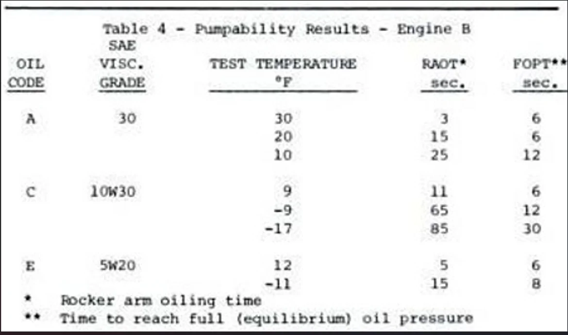

Just some basic science to add to the discussion. In general…
0WXX is tested for cold cranking at -35C (-31F) and for pumpability at -40C (-40F).
5WXX is tested for cold cranking at -30C (-22F) and for pumpability at -35C (-31F).
This means that for the vast majority of us a 5W will be fine. So will a 0W but unless you live in the extreme northern part of the US or Canada a 5W will be fine.
Also, the speed that the oil gets into the various galleries in the engine is directly linked to the speed of the oil pump not the weight of the oil. The galleries will fill in a cold engine just as fast with a 0W-20 as a 5W-30.

The multifaceted report....funded by GM and several major oil companies and published years ago in the SAE journal (sadly, you need to be a member to read) noted that:
The pistons/cylinders are only lubricated by oil that flys offs the rod bearings and the tiny squirter hole on the rods. The crankshaft oil is fed from the mains, though the crank, then into the rod bearings....by then under almost no pressure and no flow when thick and cold....the end result is only one drop every few seconds flying up to the cylinder/piston interface. Later, when the oil is hot and thin this is a continuous shower of oil. The conclusion of this study was related to the switch from 10W30 to 5W30.....and that many typical driving profiles that this alone would increase engine life by 30 percent. Data was reinforced by multiple testing procedures, including pistons, rings and sleeves using various radioactive isotopes and running instant real time wear measurements. The first few minutes of operation cause more wear then the next hour!
From AMSOIL -
Thicker Oil May Not Flow Quickly Enough
In Brad’s case, his 15W-50 racing oil may be too thick to flow quickly enough to fill the spaces between the crank journals and main bearings while the engine is running.
The oil won’t form a consistent lubricating film, allowing metal-to-metal contact and wear. His engine was designed specifically to use a lower-viscosity oil, in this case 0W-20. Its lower viscosity allows it to flow faster and fill the tiny clearances between parts, leading to a durable, consistent lubricating film.
Not only that, but the engine will waste energy pumping the thicker oil, reducing fuel economy. Since thicker oil doesn’t transfer heat as well as thinner oil, operating temperatures will increase, possibly leading to accelerated chemical break down (called “oxidation“) and harmful sludge and deposits.

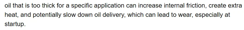

Even Lake basically keeps suggesting that................. but there are plenty of engineers that know better (on forums everywhere) and keep thinking that thicker is better.
Have to laugh about the extreme change from 20 to 40 as it's a given, proven, even, with tests on real engines, that jumping that much leads to hotter oil, and hotter engine parts - and then they complain about engine heat. Uh, they cause their own problems.
From those oil engineers -
it's crucial to use the correct viscosity for the application, as too-high viscosity can cause other issues like increased drag and heat.
So you believe ithe engineers haven't worked to make the oil and engines work together...................
