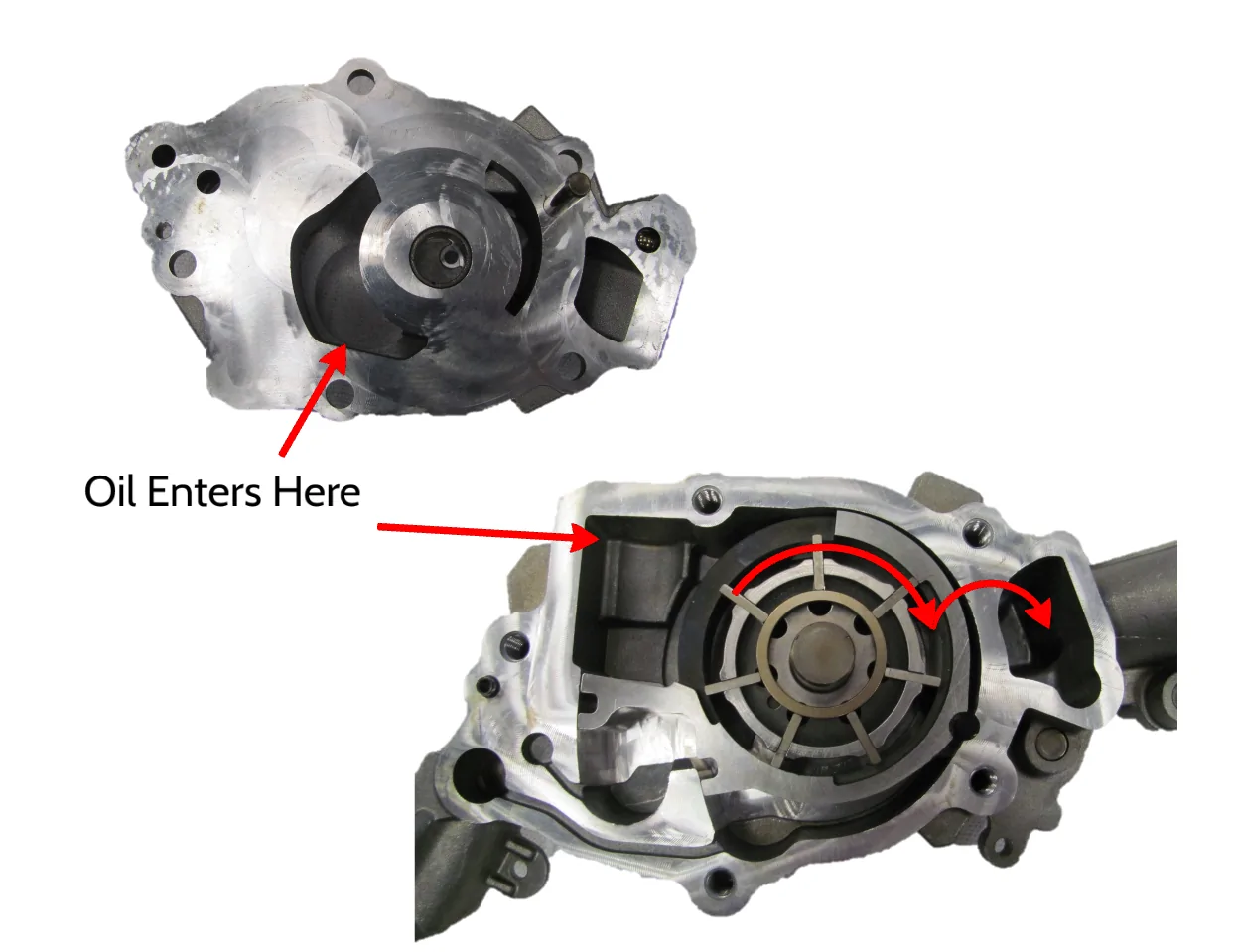

These oil pumps are chain drive off the crankshaft.
They default to high volume mode.
That means they are pumping oil fast - probably close to double the volume that's pumped in normal driving below 3,000 RPM
I'd bet they can move more oil faster than gear type pumps of the past that were driven at half crankshaft speed by the camshaft.
These are the oil pump workings of a 400 cid V8 Chevy - and running half of crankshaft speed.
That's oiling a full V8 at 6,000 RPM while only spinning 3,000 RPM (and yet it can shoot massive amounts of oil over the fender at idle - ask anyone who has adjusted the lifters on a SBC engine)
Jeep Gladiator Anyone Using 5W-30 Oil? Tell Me your Opinion/Thoughts 1763052580405-h
And the Jeep 3.6 oil pump -
Jeep Gladiator Anyone Using 5W-30 Oil? Tell Me your Opinion/Thoughts Screenshot 2023-04-04 095638
