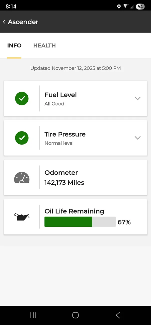

Same for me - with 0w20
So the point is? Maybe there is no point LOL
and that could be due to the change in the oil chemistry, not viscosity.
If you buy a 0w20 and a 5w30 from the same company, there will be variations that alone can account for analysis changes - as well as your own engine age, driving, loads, temps and so on.
so far, there's no data that is able to show that a change in viscosity alone does anything - because people also change either brands, or even if the same brand, the chemistry will be different.
So at this point - it's literally impossible to test for the change in viscosity alone
You can find at least two people in the Wrangler areas who had cam failures - and ran heavier oil. Their conclusion was a shrug - oh, well, guess it wasn't that.
All I'm saying is - meh, there's no evidence of anything, and there is at least some evidence (although limited cases) where viscosity just didn't matter.
(and millions on the road doing well may suggest something?)
Someone posted a video from lake speed talking about a fake 0w-20 vs 5w-30 video mostly AI . Said the video had actually cabbage some of his stuff. In the video Lake said that the took 7 yrs. Of test results on engines all above 10k miles and 5w-30 didn't do Jack crap and the wear metals etc. We're very similar . Now I aint say Im right . I think its more in the filter and how ya run em than the oil .
OW-20 filter change at 50% life . Oil and filter @ 10% .
Filter Wix 10010 & Amsoil 0W-20 signature series.
