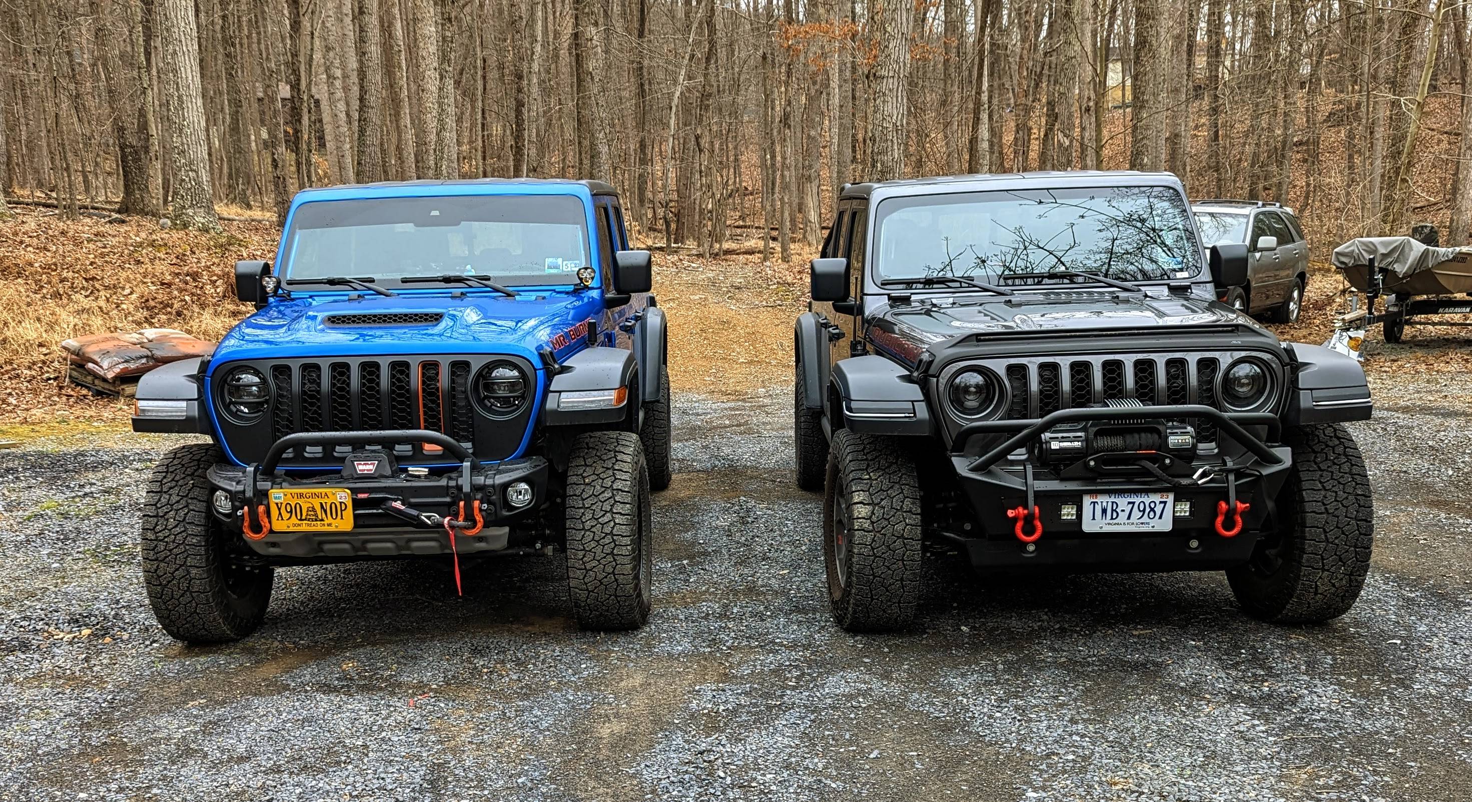

I have the AEV Mojave specific 2" puck lift and am still on my factory 33" falcons. I've done nearly every trail system in VA with the exception of Potts Mountain with my Mojave and i've yet to be limited by my tire size. For mild / moderate trail riding 35's will be plenty imho.
Im going to re-gear when I do get bigger tires and will probably have a front locker installed then. That being said, between BLD and the rear locker, not having it hasnt been an issue for me yet.
I dont overland / have a RTT, but between my diamondback bed cover and all the gear I keep in my truck I have a pretty decent amount of added weight in my bed (hundreds of pounds) and I also tow with mine. The Mojave suspension does well with the load.
As far as not having an electronically disconnecting front sway bar like the Rubicons, that doesnt affect me at all. I just take the bolts out of the end links and zip tie them up. Easy peasy and they dont try to reconnect themselves if I go more than 18mph ;)

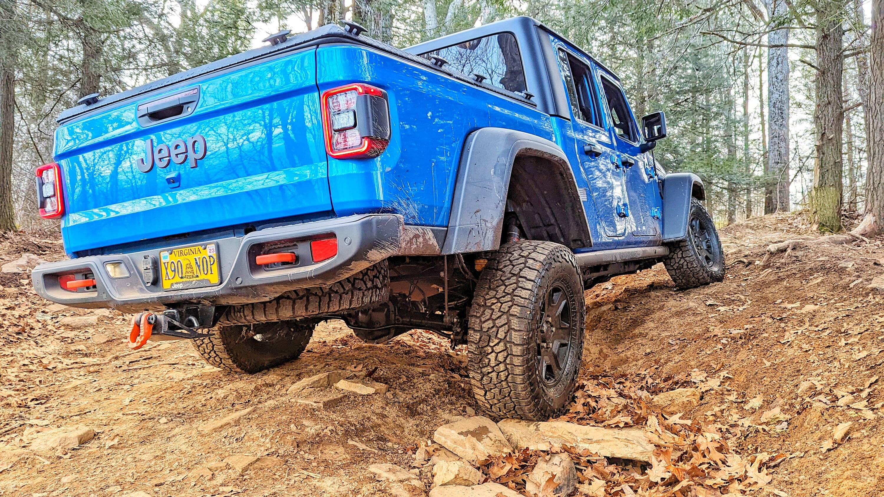

Jeep Gladiator What can a Mojave on 35s NOT do? PXL_20221122_215047840

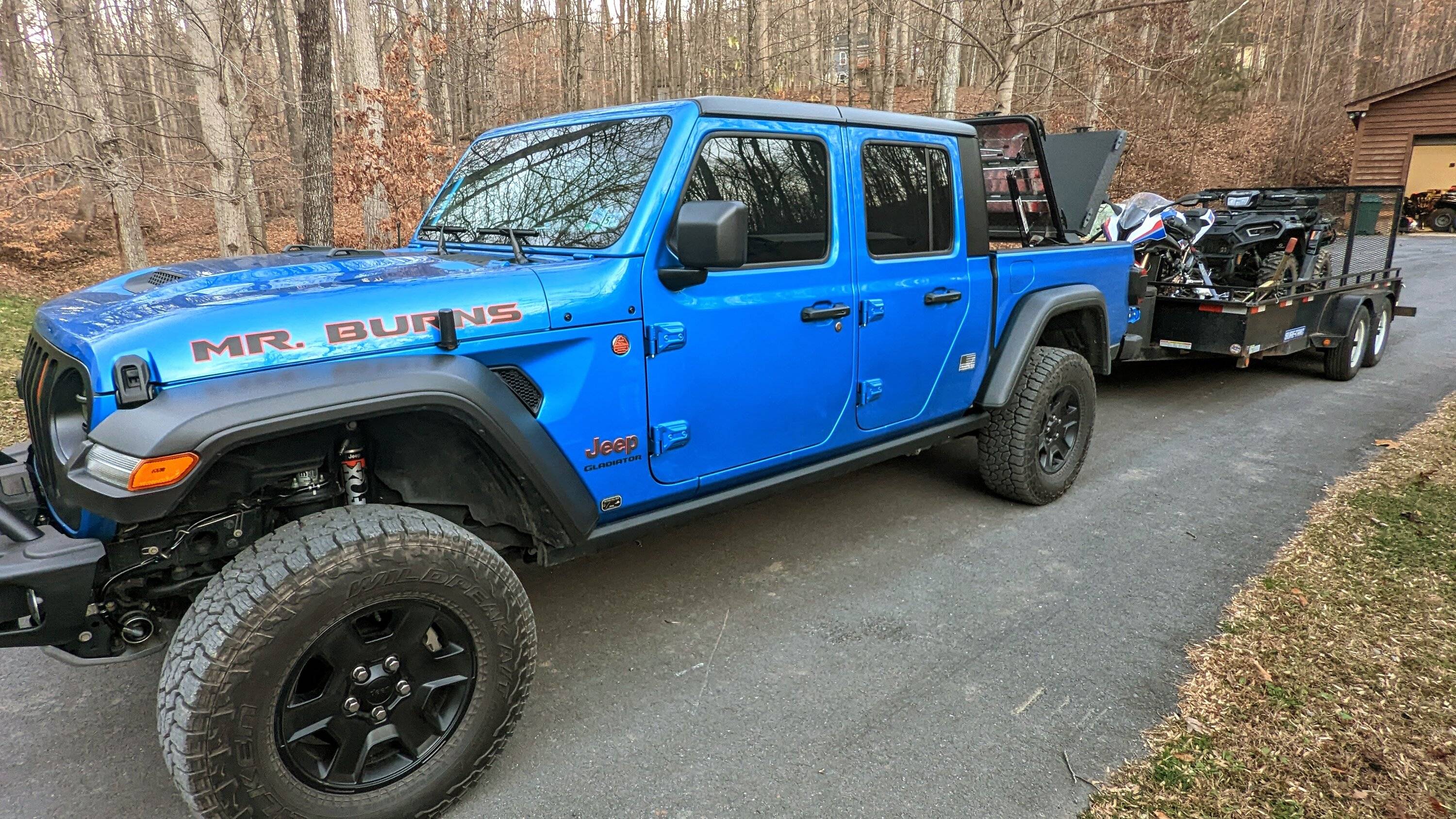

I use a redarc towpro elite brake controller, trailer gets up to 5k ilbs sometimes and the Mojave does well with it

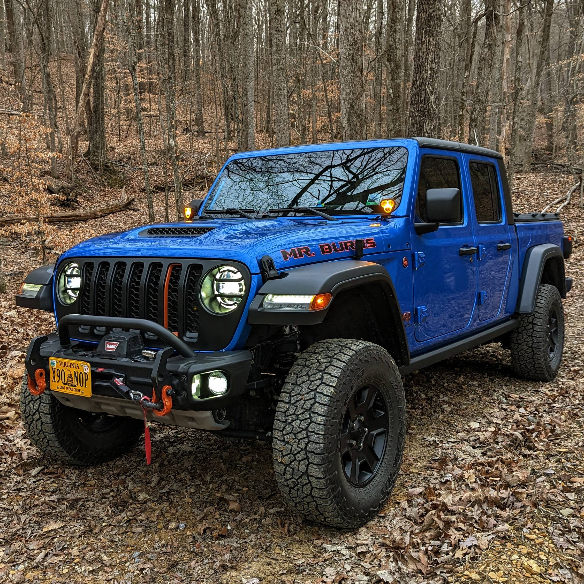

Jeep Gladiator What can a Mojave on 35s NOT do? PXL_20221126_194313621_edited

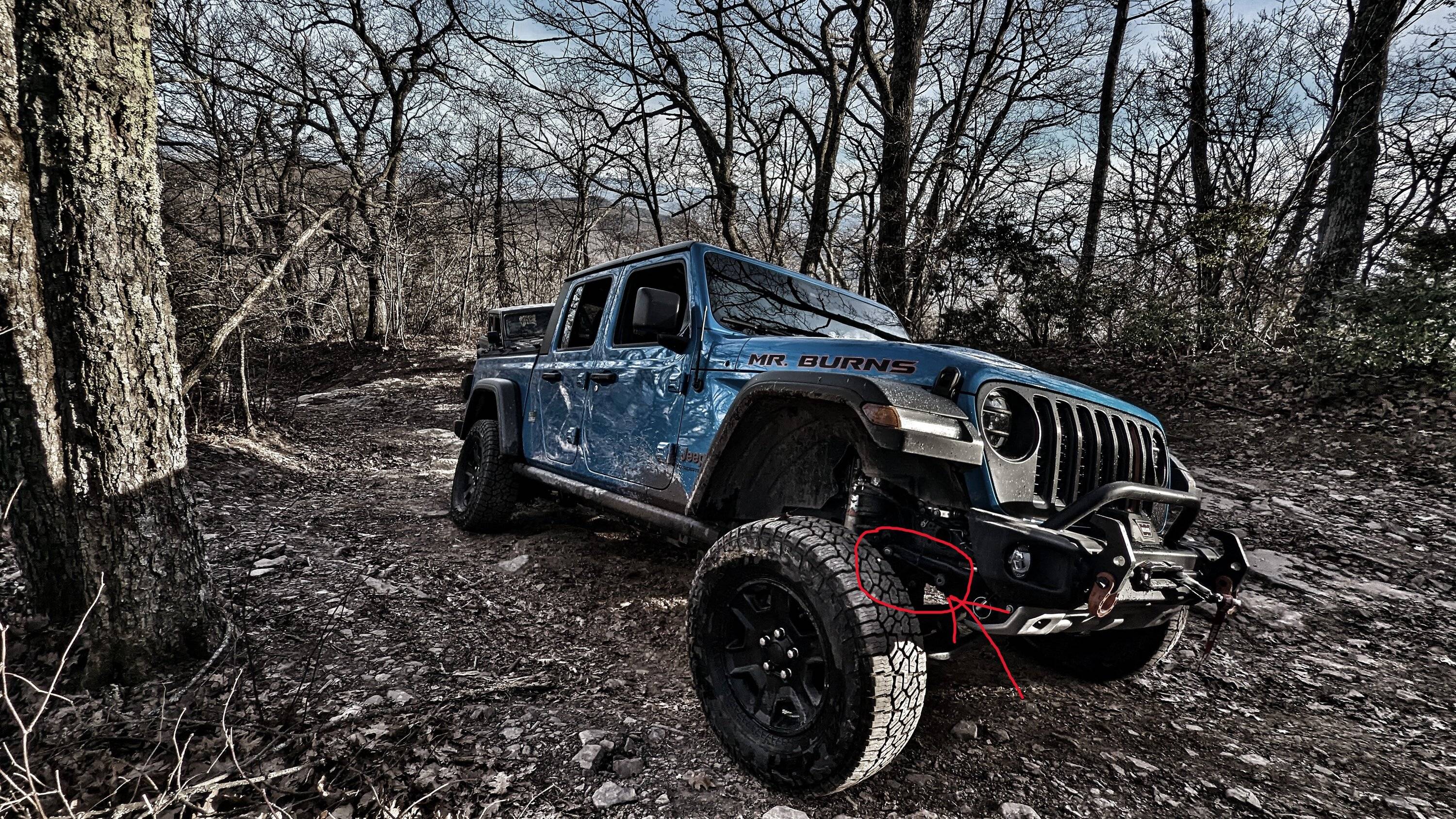

Jeep Gladiator What can a Mojave on 35s NOT do? PXL_20221126_201539051
I circled my sway bar in this pic, you can see the end link disconnected and zip tied out of the way:

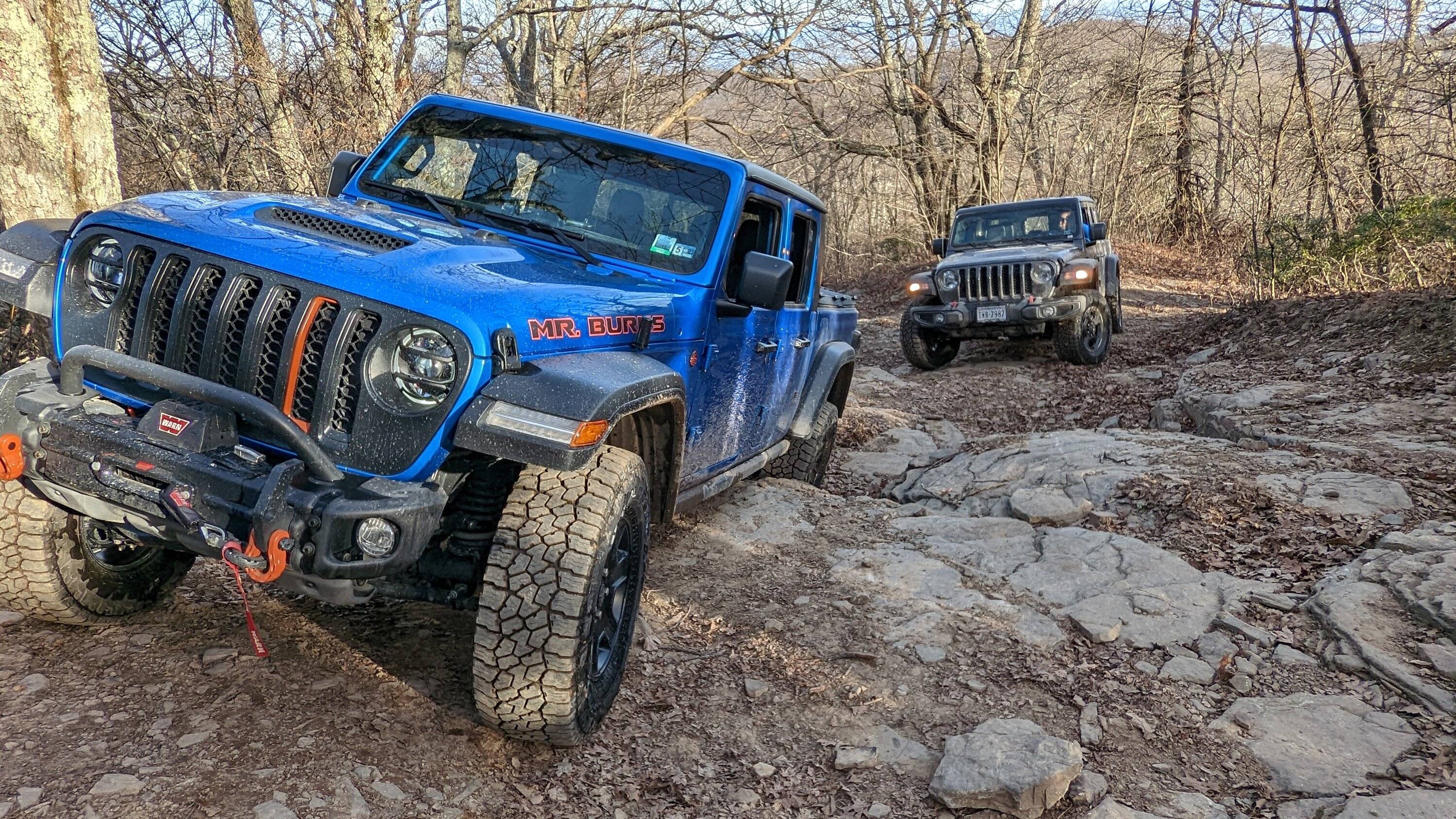

Jeep Gladiator What can a Mojave on 35s NOT do? PXL_20221126_201549164_edited

This is my 22' Mojave next to my buddies 22' stock heigh Rubicon for reference
