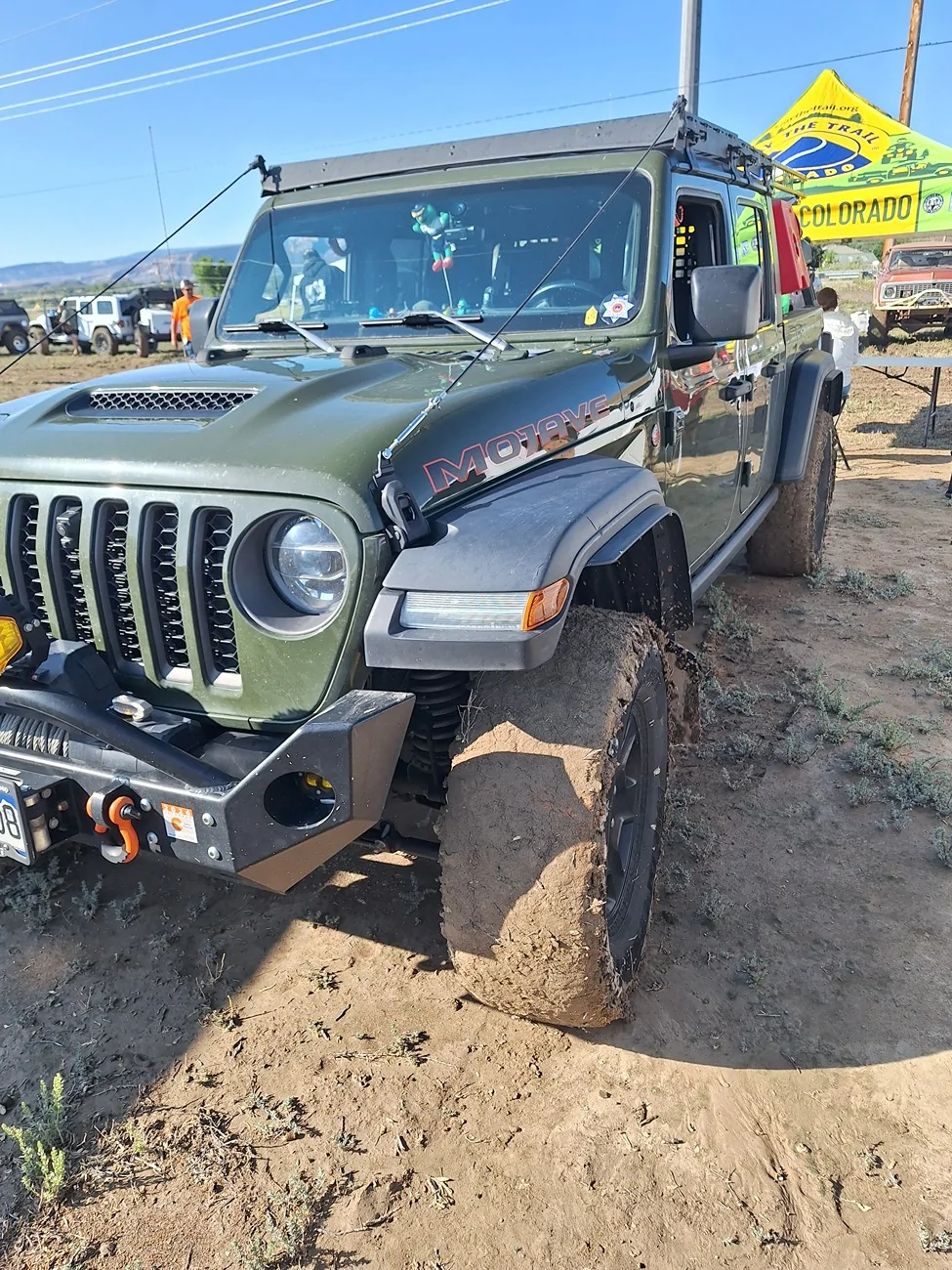

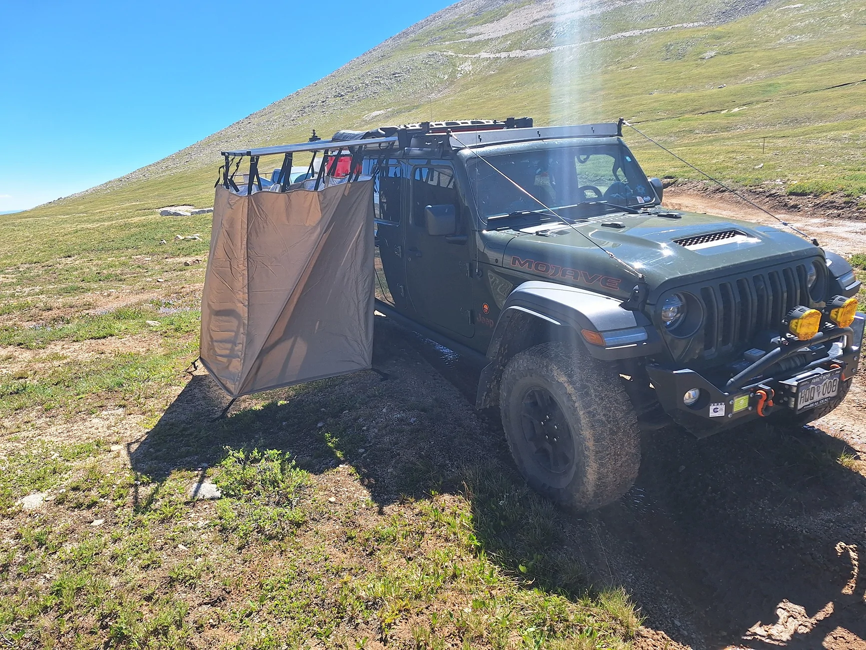

As a daily driver, the Mojave has the best road manners, most comfortable seats and in 2021 when I ordered mine, the Auto 4WD (Select Trac) 242 transfer case option. Living in Colorado it is great for winter driving. I also use mine for light trails and overlanding duties as I have a 2002 TJ on 40s for rock crawling. I also volunteer with CORE, Stay the Trail and Tread Lightly so I work a dozen or more offroad events amd trail projects every year and my Mojave is a great vehicle for carrying all that gear. It is not a rock crawler and its softer suspension does detract from its cargo carrying and towing capability, but that isn't what I bought it for.

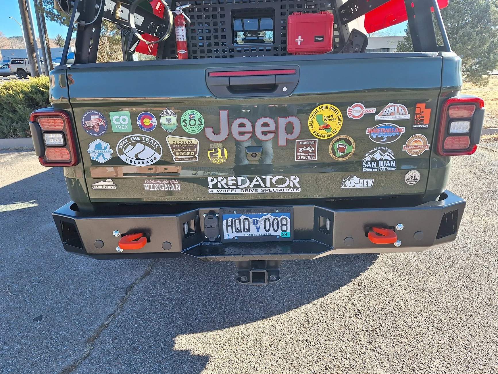

My front and rear bumpers are Rock Hard aluminum. The front is their mid-width which is actually lighter than the factory plastic bumper. Also, the winch plate sits low, between the frame rails so my Warn Zeon10 winch doesn't block any air flow to the radiator. Rock Hard is a great, veteran owned company, and all their products are US made in Nebraska. It also has a front skid plate to protect your remote shock reservoirs.

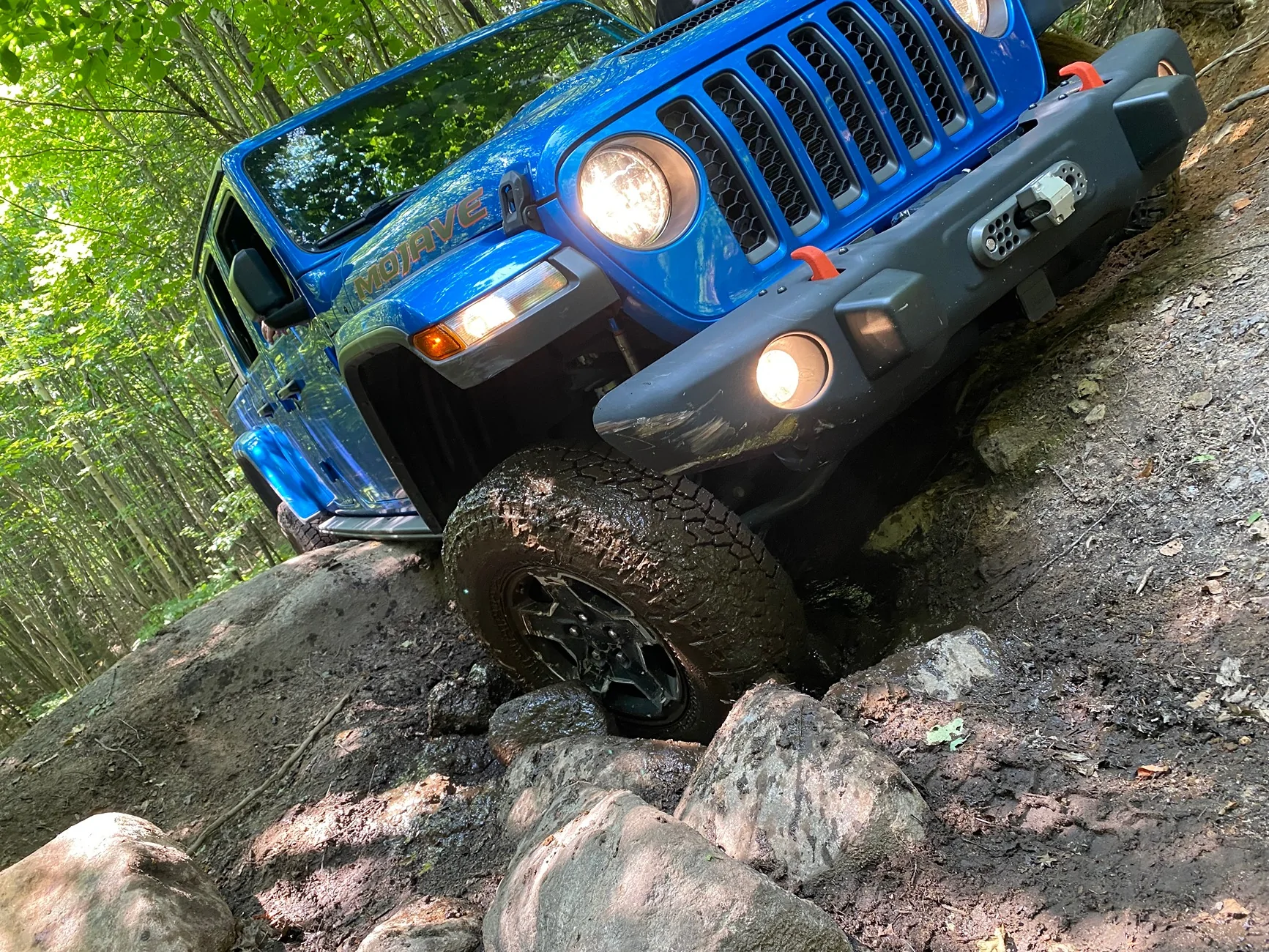

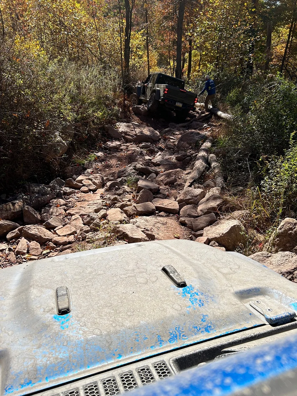

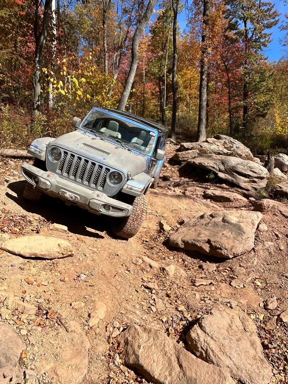

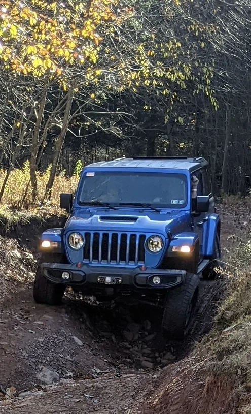

Mojave is fine , I added Apex front sway bar disconnects they are better then the factory that reconnect at a certain speed. The Rubicon is better cause of the ultra low transfer case and front locker , but Mojave from factory is an inch higher in front and suspension is better , any Gladiator can do more then most other vehicles off road….Jack
Enjoy the Mojave an awesome truck , had mine since 2021 and still love it!
