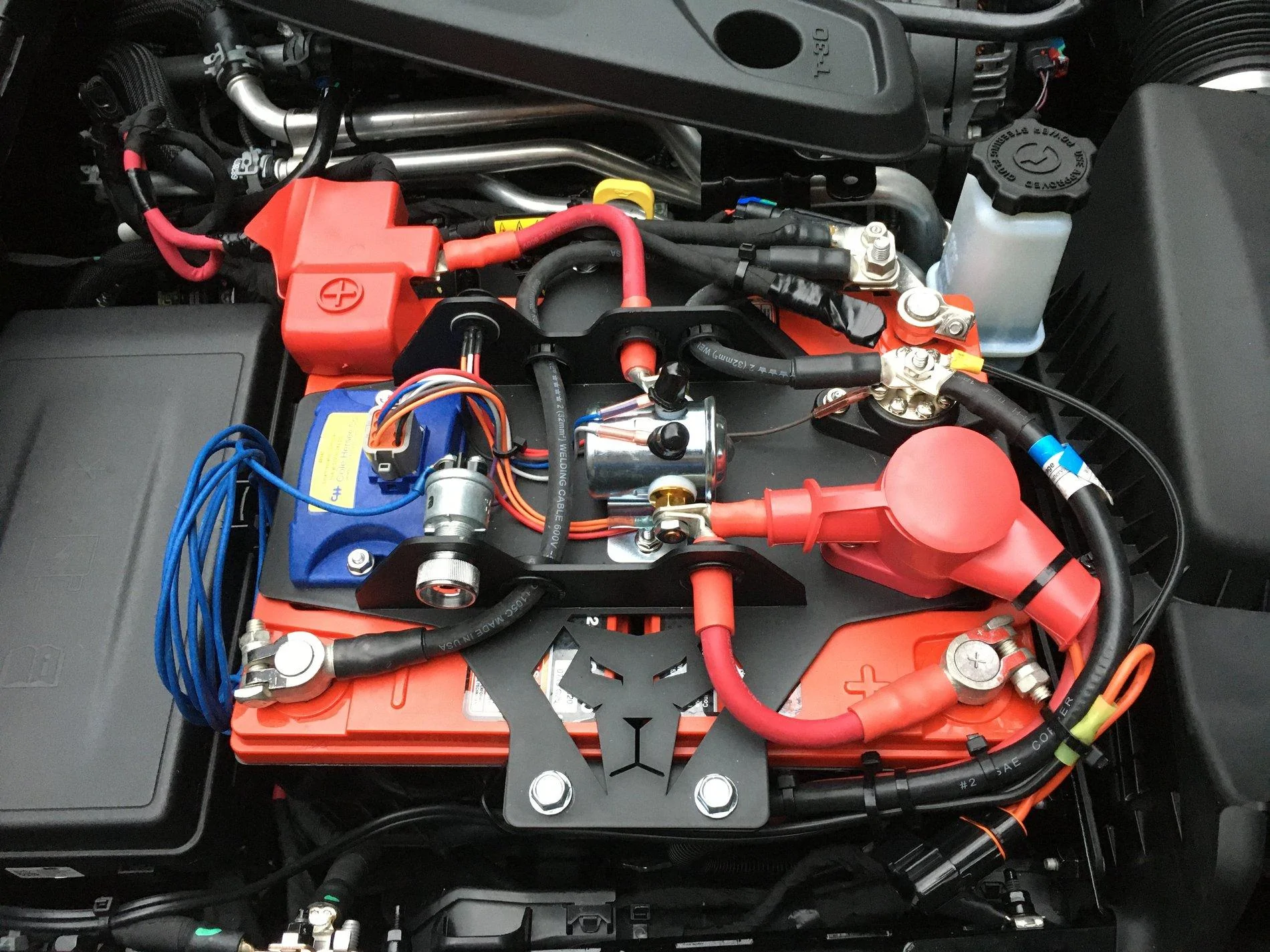

Checking with Genesis, but I plan to use one of the higher amp switches in the momentary mode to toggle the battery parallel switch mounted on the battery bracket. Waiting on their call back to let me know if this will work...... Oh, still waiting on my JTR to be delivered..

I installed the Genesis battery tray, but haven't wired up to my Aux switch yet. It's ready to got just got sidetracked on another project. Also, never got a good "nod" from Shane at Genesis, he said it should work and should be fine. I don't have doubts, and feel it will be fine. The blue wire that's coiled up is the one that I have plans to use.
The Battery Boost option lets you use the Auxiliary battery to start the truck if the Primary battery gets discharged. The problem with using an AUX switch is it's fed by the Primary battery and may not have enough voltage to trigger the boost function. Typically, you would want the boost enable button to be fed by the battery with the higher charge level (usually Auxiliary). It should work, as the battery may have enough charge to trigger a relay, even if it's too low to spin the starter.
