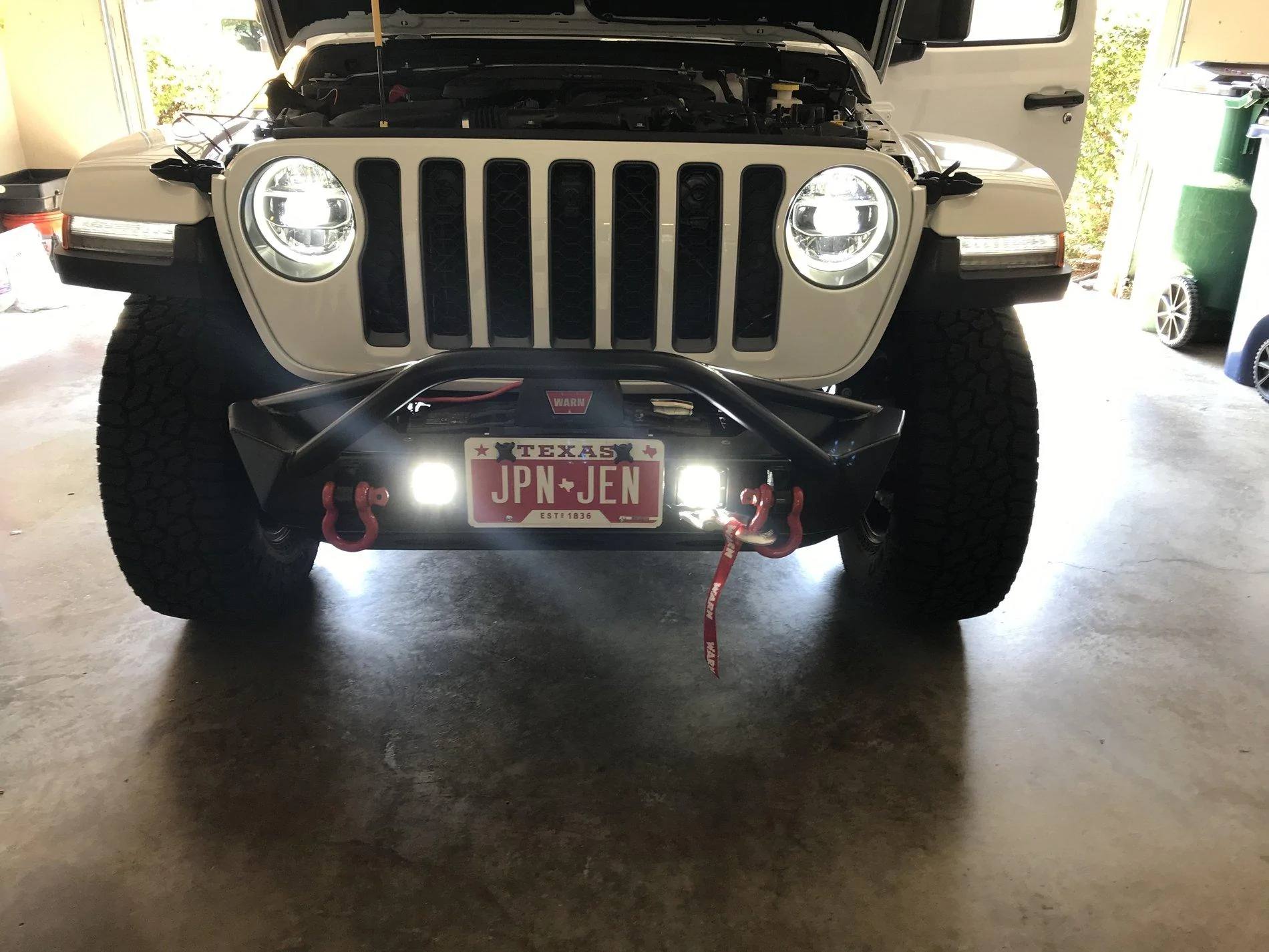

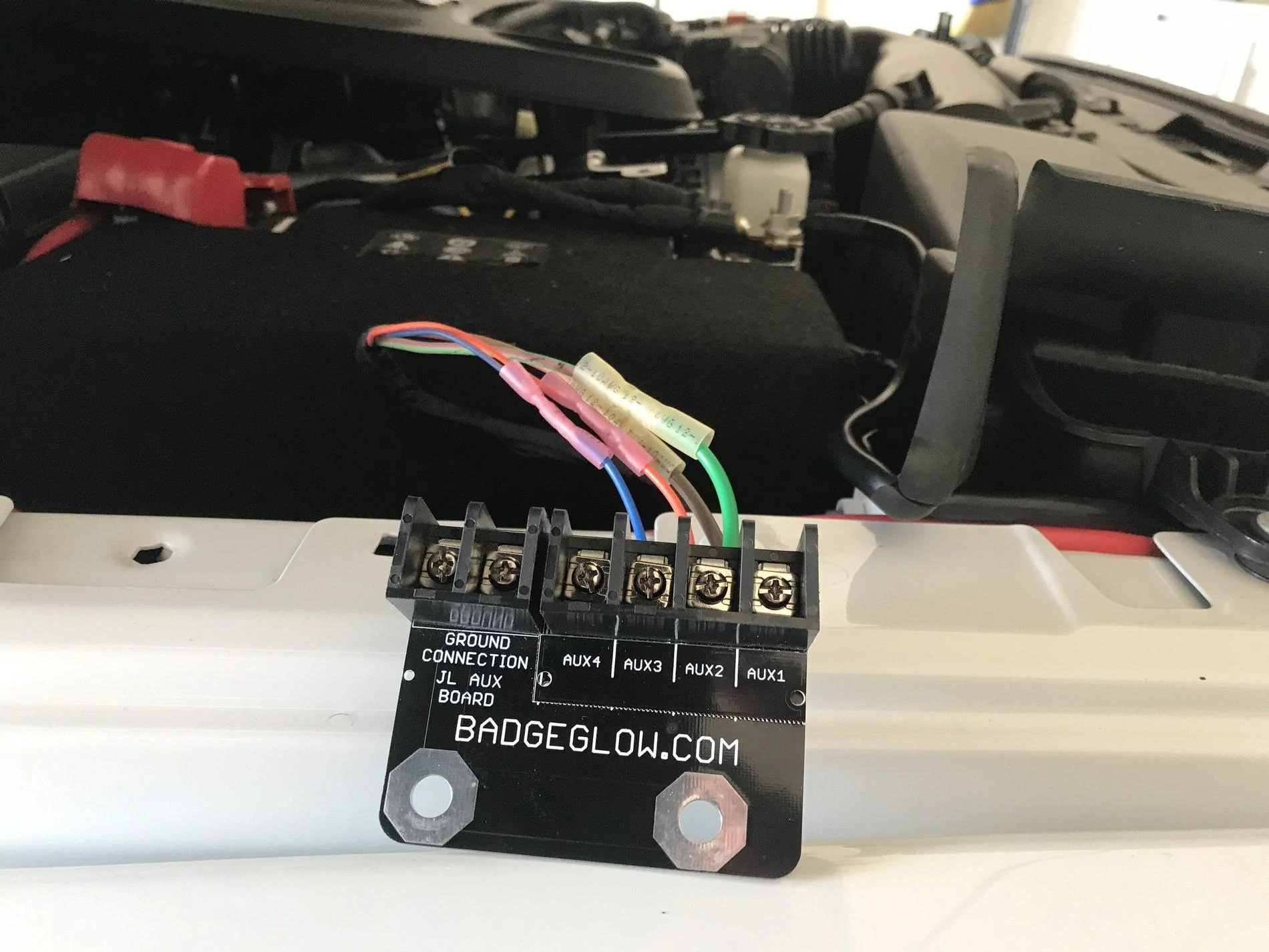

Used our Aux switches to wire up led cube lights for aftermarket bumper. Will probably add A pillar lights, and onboard air as well.

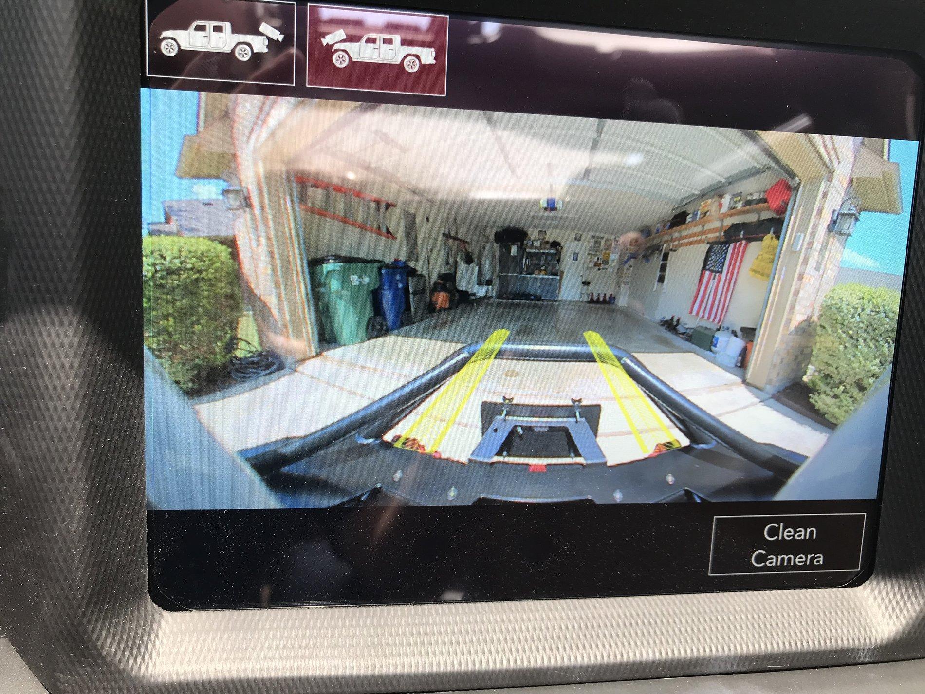

Nice setup, how is the trailcam view with that bumper? And what kind is it?
It is a Poison Spyder Bruiser. It interferes with the camera view. Not a big deal I though, doubt we’ll use it on the trail.

That doesn't look as bad as I thought. The camera seems to elongate the bar some but it kind of runs parellel to the lines and the rest of the view looks good. Thanks for the pic.

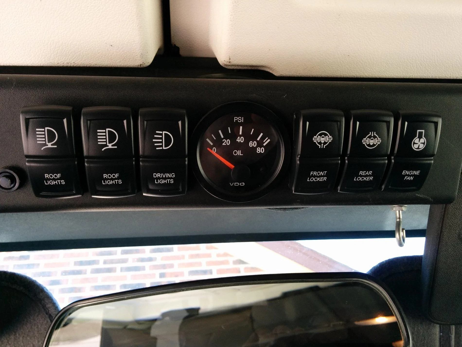

New to Jeeps - so need to ask a simple question: why would you get the auxiliary switch group and what would you do with it? What are some of the things you would hook up to this? Trying to understand if I should spend the money because I will need it later or if it is extraneous. Thanks for looking!
If you think you might do any mods whatsoever to your Jeep, this is a really great option. For my 2007 JK there was no such OEM choice. So I had to do a lot of wiring and buy the rather pricey sPOD (something like $400) plus custom switches, plus do some underdash wiring for my radio gear, and through the firewall wiring for other radio gear and the inverter and the fridge. This option will save a ton of work and expense. I'm glad Jeep followed Ford's lead on the Raptor making this an option. Will definitely have on mine once ordered (holding out for Gobi).
Edit: The switch labels are obvious except the engine fan. That one turns off the fan for when I ford deep water. Since switches are NOT programmable for the sPOD, I had to add another relay to accomplish that.
