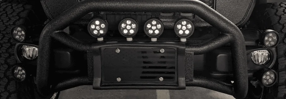

For the lights I added to the front bumper:
Jeep Gladiator Auxiliary switch group?  What do you do with it? upload_2019-9-24_15-29-40

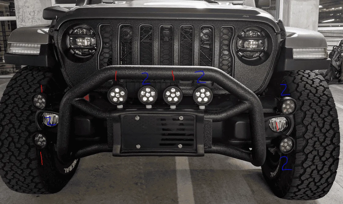

So, I used the wire loom as follows:
POS IN: the HOT Wire in the Aux Loom
NEG IN: the ground next to the fuse box
Switch: I tapped one into each of the factory fogs (you'll see why I did it this way in a minute)
OUT as follows:
Jeep Gladiator Auxiliary switch group?  What do you do with it? upload_2019-9-24_15-29-5
Doing it this way the bumper lights and OEM fogs all run off the OEM fog switch.

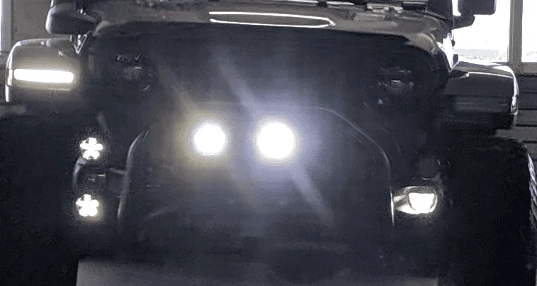

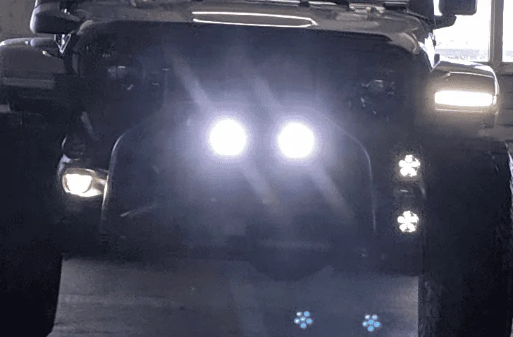

TAZER LIGHT SHOW!
Jeep Gladiator Auxiliary switch group?  What do you do with it? upload_2019-9-24_15-48-17
Jeep Gladiator Auxiliary switch group?  What do you do with it? upload_2019-9-24_15-49-1
