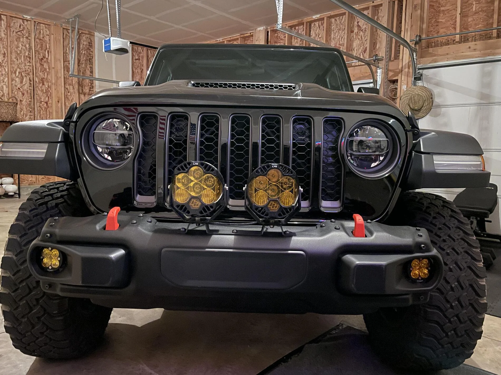

- Baja Squadron Sport Fog lights
- Baja LP6's

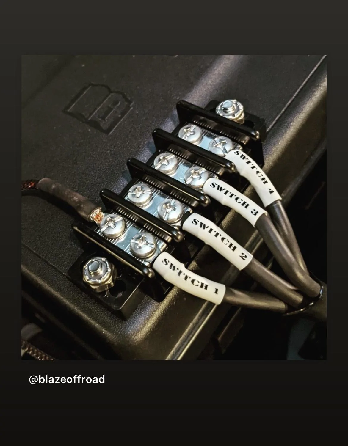

- Clean wired up install for future accessories to the stock switch panel (Done by Blaze Off Road here in Colorado. You won't find a better electrical guru in Colorado, PERIOD.) I don't trust anyone but him to wire my builds.
Still need to adjust the angle of them so all that light isn't just hitting the ground but pictures do not do these justice. These are probably twice as bright as the Baja S8 30" bar I had on my Sierra.

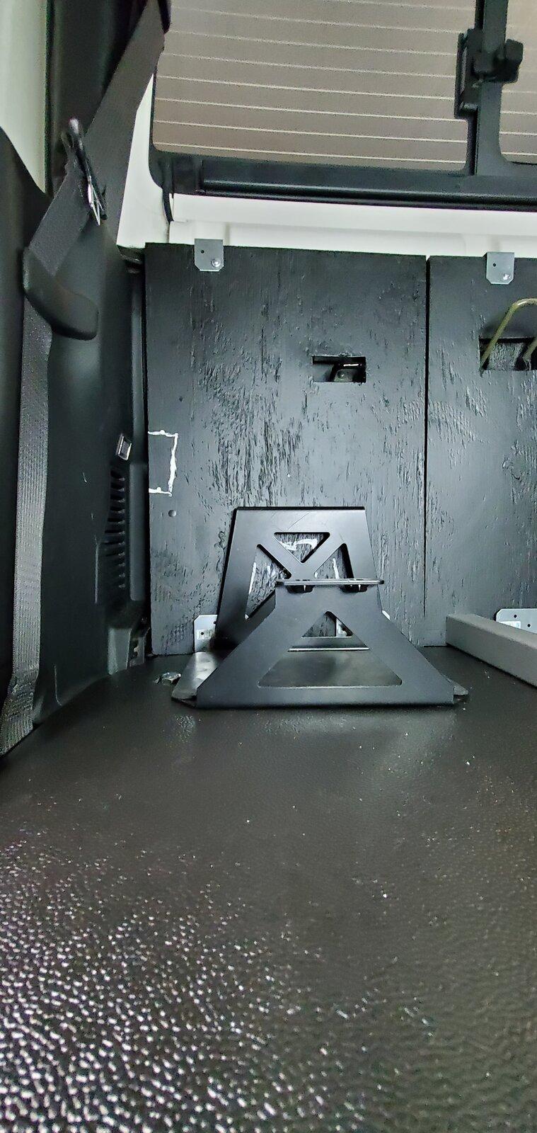

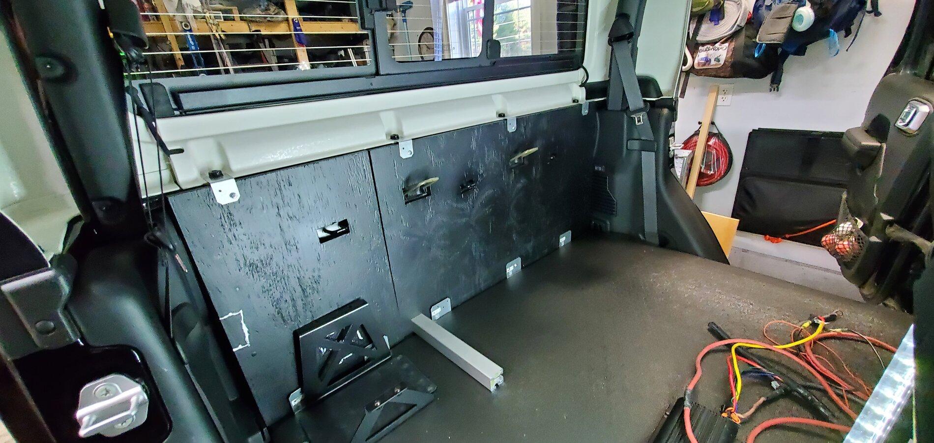

Ok, so things slowed down enough for me to make some more progress on this rear seat conversion. Mock-up starting to take shape now. The right 2/3's will be a storage compartment using the same aluminum extrusions as my deck base.
Jeep Gladiator What did you do TO your Gladiator today? [ADMIN WARNING: NO POLITICS, NO GUN TALK] 20211119_101928
Behind the aux battery holder will be a vent cutout. The middle left of the left panel will be a wire route cutout for my Redarc BCDC 1225D, which will be mounted above the cutout. And for the moment I'm looking at mounting my Trigger4 wireless controller on the upper right of this panel.

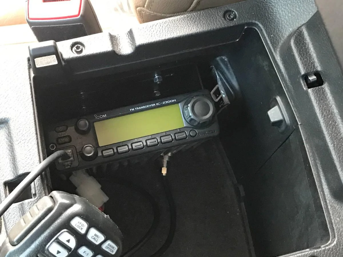

What I did to my Gladiator today (and yesterday)

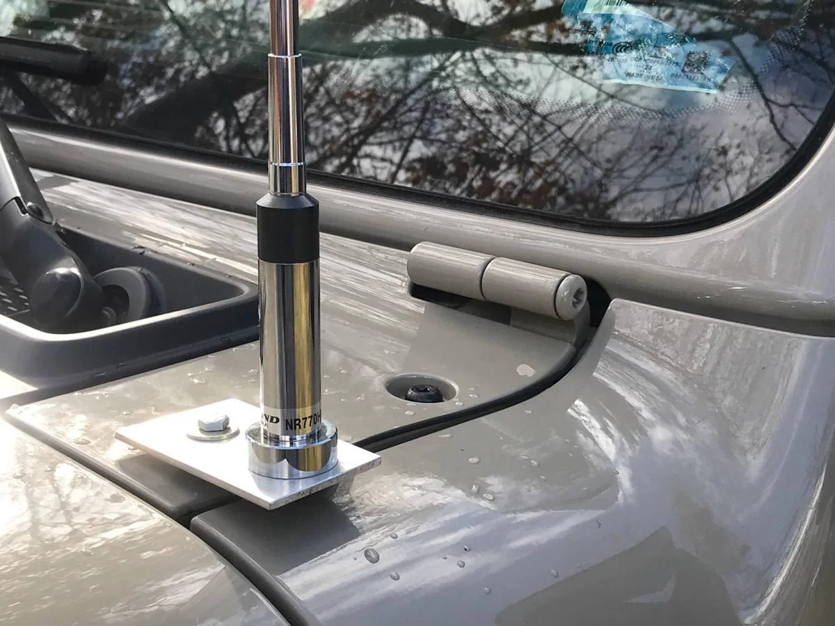

Installed a ham radio / scanner inside the console, as there aren't a lot of other locations to put it. This also keeps it completely hidden (and locked) when not in use. Remote control microphone lets you control the radio even if the console lid is closed. Antenna, power and external speaker wiring is all run underneath the console.
Accessing the radio while driving is slightly clumsy, as reaching it with my right hand has my arm bumping into the console cover - wish the cover would lay farther back when open. But again, not too bad, and once I have a few frequencies entered, I do very little fiddling while driving, and the remote control microphone has most of the functions covered.
Next steps:
- take power from one of the factory aux switches instead of the cigarette lighter power adapter
- clean up the antenna mounting bracket (this is just a prototype)
- install a speaker inside the fresh air vent to the right of the steering wheel
The antenna mount is a Comet NMO lip mount - low profile, just requires drilling a 3/4 inch diameter hole into a metal bracket, and it includes a short section of very thin coax so it can be run into the cab under a door molding - no drilling or cutting. Used existing bolt hole to mount the bracket to the Jeep.
Best part of the install, besides finally having a VHF radio again, is no need for drilling holes or routing cables through the firewall or body. I didn't even have to open the hood. Factory aux switches were so worth it. At first I thought the connections existed only under the hood, which would mean I still need to run power through the firewall, but then realized Jeep provides two sets - one under the hood for "external" items like winch and lights, and another set inside the cab for radios etc. Thank you Jeep ?

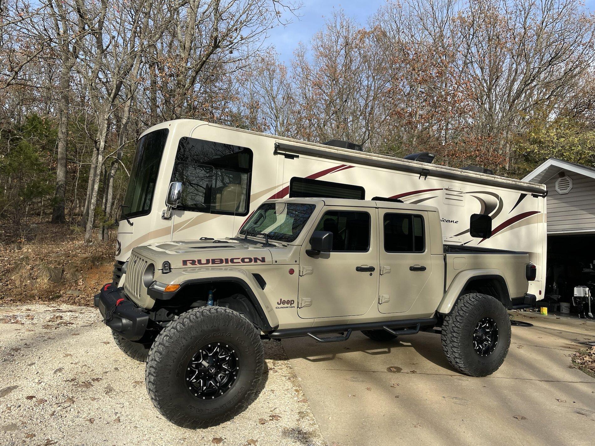

Washed/waxed and getting ready for 2k mile road trip toad behind rv starting tomorrow morning
