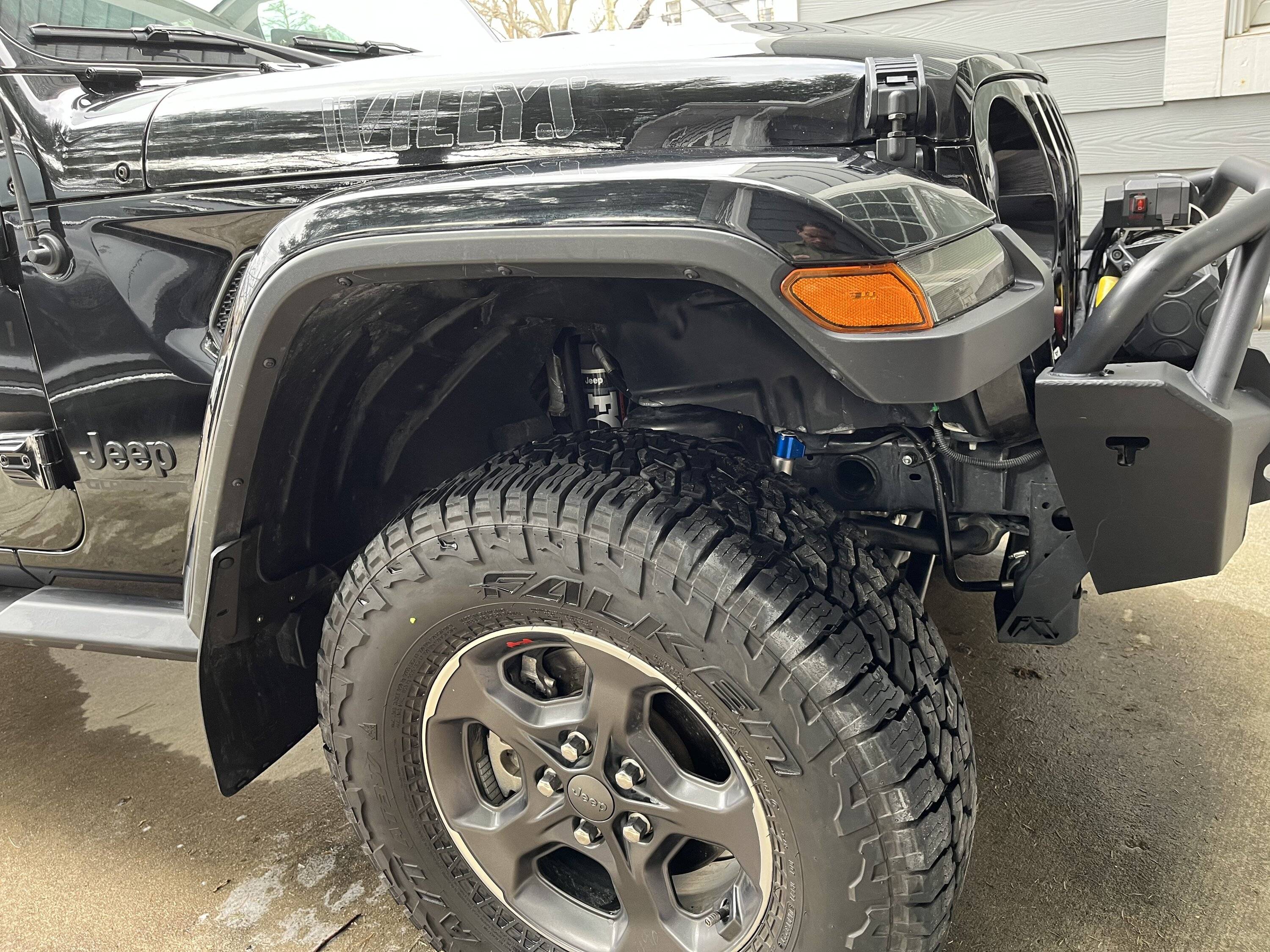

Whats the caster degree in the last hole? What lift are you running?
It's a 2" AEV, but I can't say what the caster angle is. I'm guessing it's 6.0-6.5.
The thing drives perfectly. Ran it 90 today and no issues at all.

I have the same brackets and ive pretty much stuck to the top hole following the recommendation of the forum and the bracket instructions. Id I remember right the top hole is intended for 2.5” of lift.
maybe ill try the middle one ?‍♂ i also have the mpp lcas though
It's something I just wanted to try out but it's definitely staying now.
Yesterday I installed the Metalcloak sector shaft brace, and it tightened things up to the point that the wheels didn't feel quite like they wanted to return to center easily, so I figured why not try?
I think with the Mojave you should consider the factory setup as 1.5" of lift on any other model.
If I can figure a reliable way to measure caster at home I'll do it.

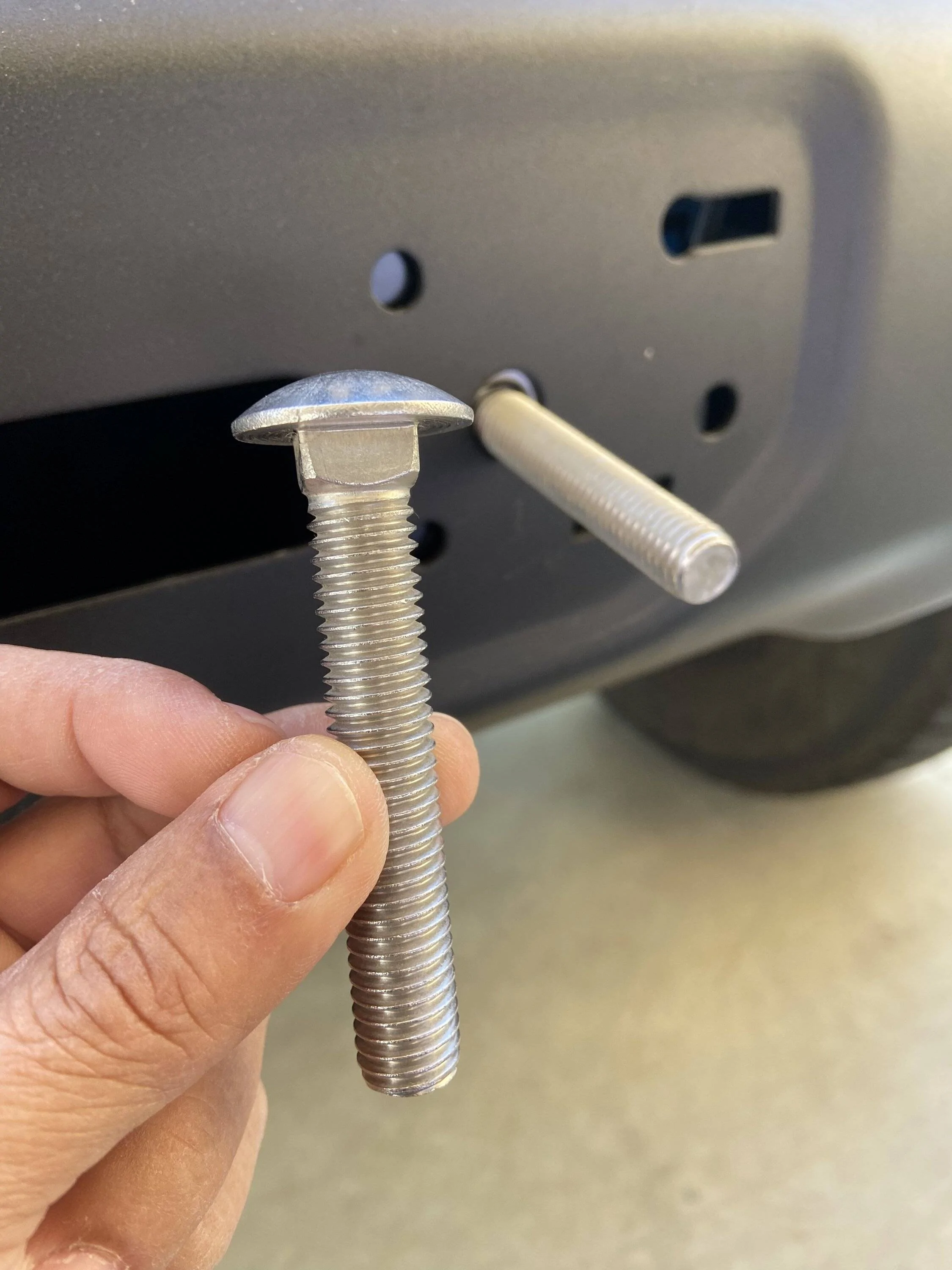

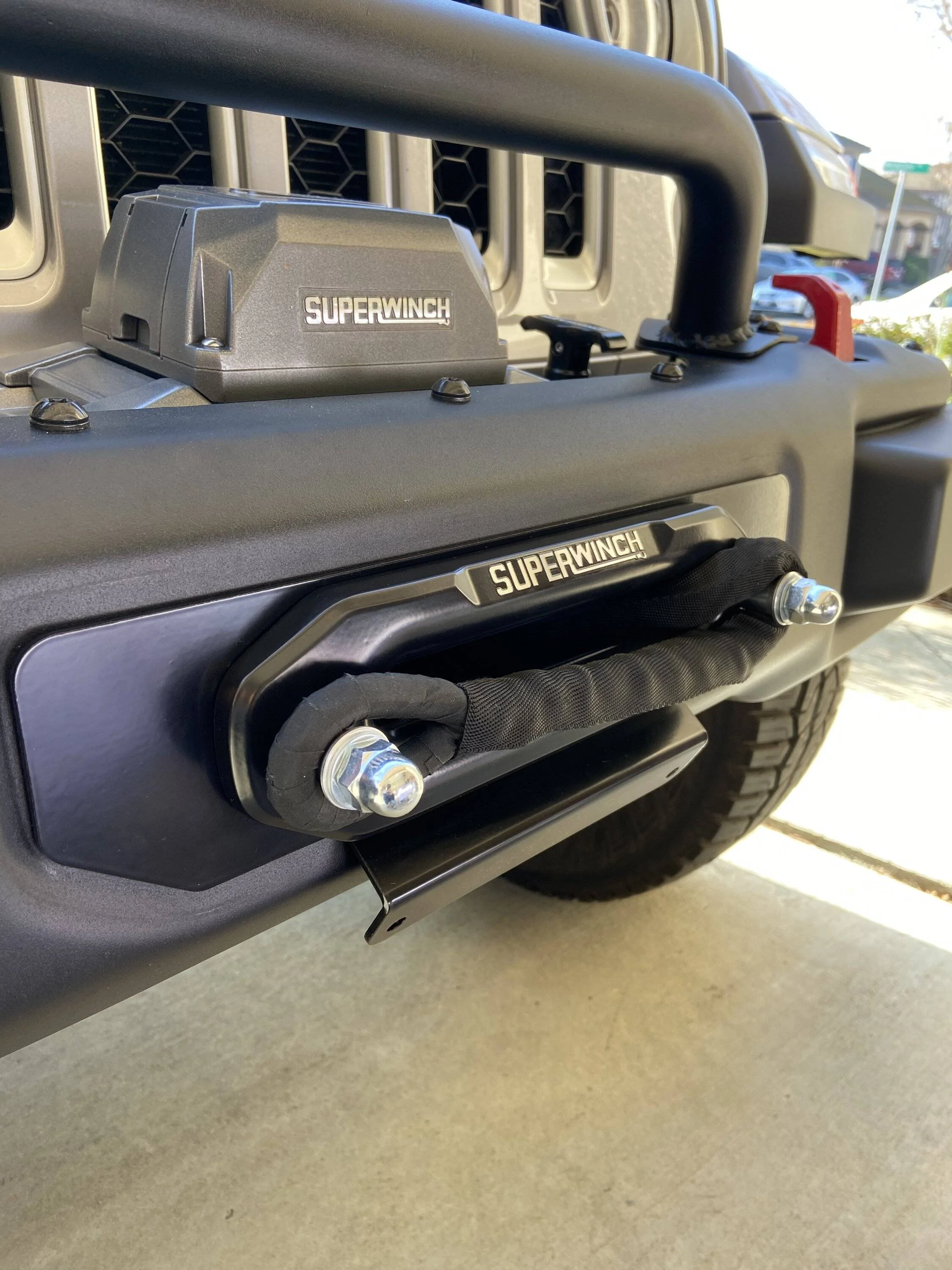

The thimble holder tapered spacers came in. Installed the fairlead. The 1/2" carriage bolts works perfectly with the Warn 1/2" slotted fairlead holes. Like some, I prefer not having the hook installed until it's needed.
Also, trimmed the factory plastic filler.

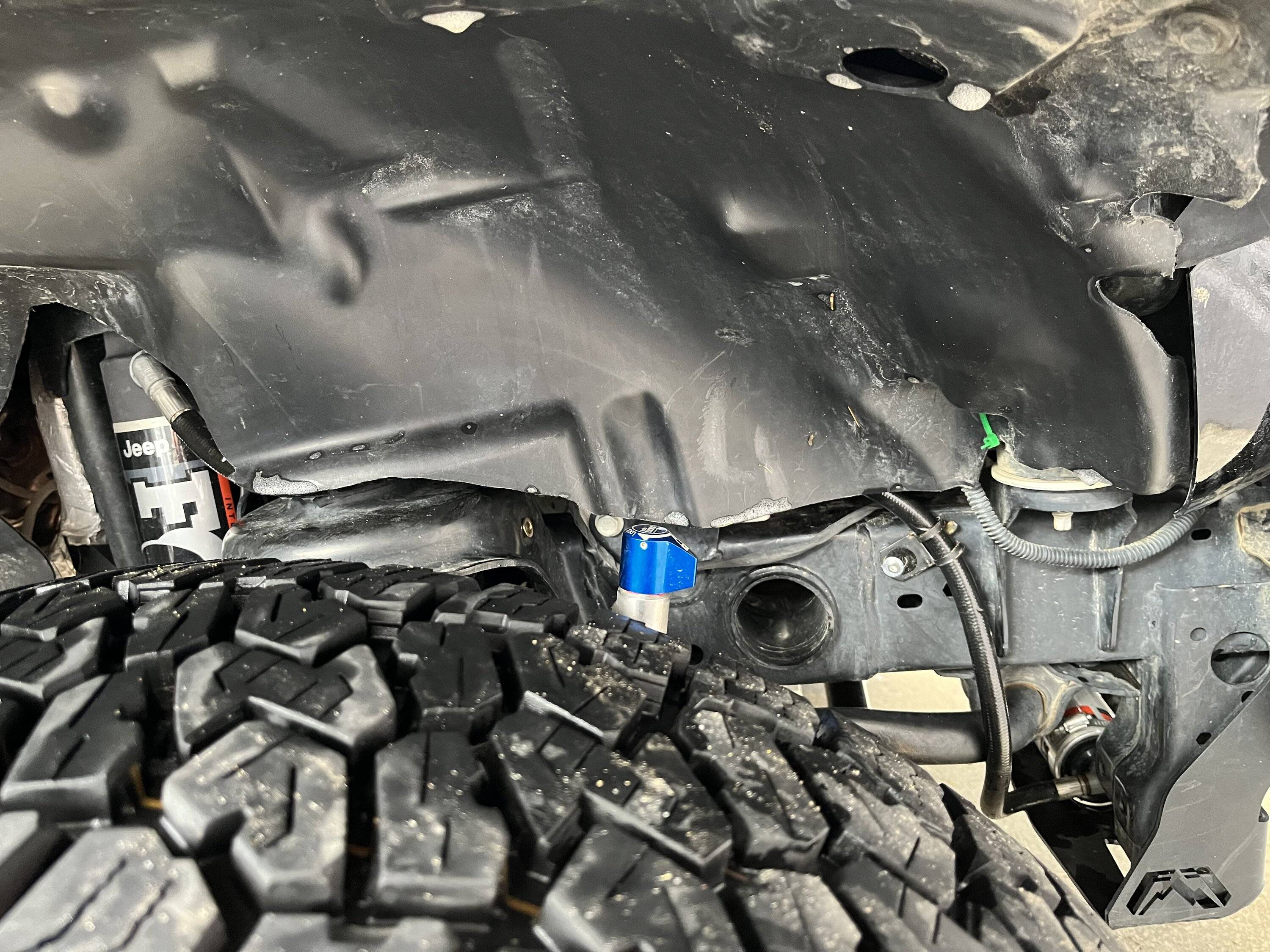

Installed Mojave shocks on my Willys. Really like the setup so far for on road dynamics when soaking up bumps / pot holes. TBD Offroad. Paired with Rock Krawler 1.5 inch lift front springs and Rubicon rear springs.
Some learnings / approaches for install:
- used in the front shocks to make up the difference with 12mm bolt
uxcell Sleeve Bearing 12mm Bore x... https://www.amazon.com/dp/B07JLBLBQ8?ref=ppx_pop_mob_ap_share
- didn’t come with front reservoir bracket so bought fox bracket
https://www.summitracing.com/parts/FRS-80302042-KIT
- secured it to my sway bar cover…similar position as Mojave
- used M6 rivnut into existing hole in frame to secure reservoir line
- front shocks are side specific
- rear shocks have piggy back reservoir positioned in front of main shock for clearance.
Hope this helps anyone else looking to install
