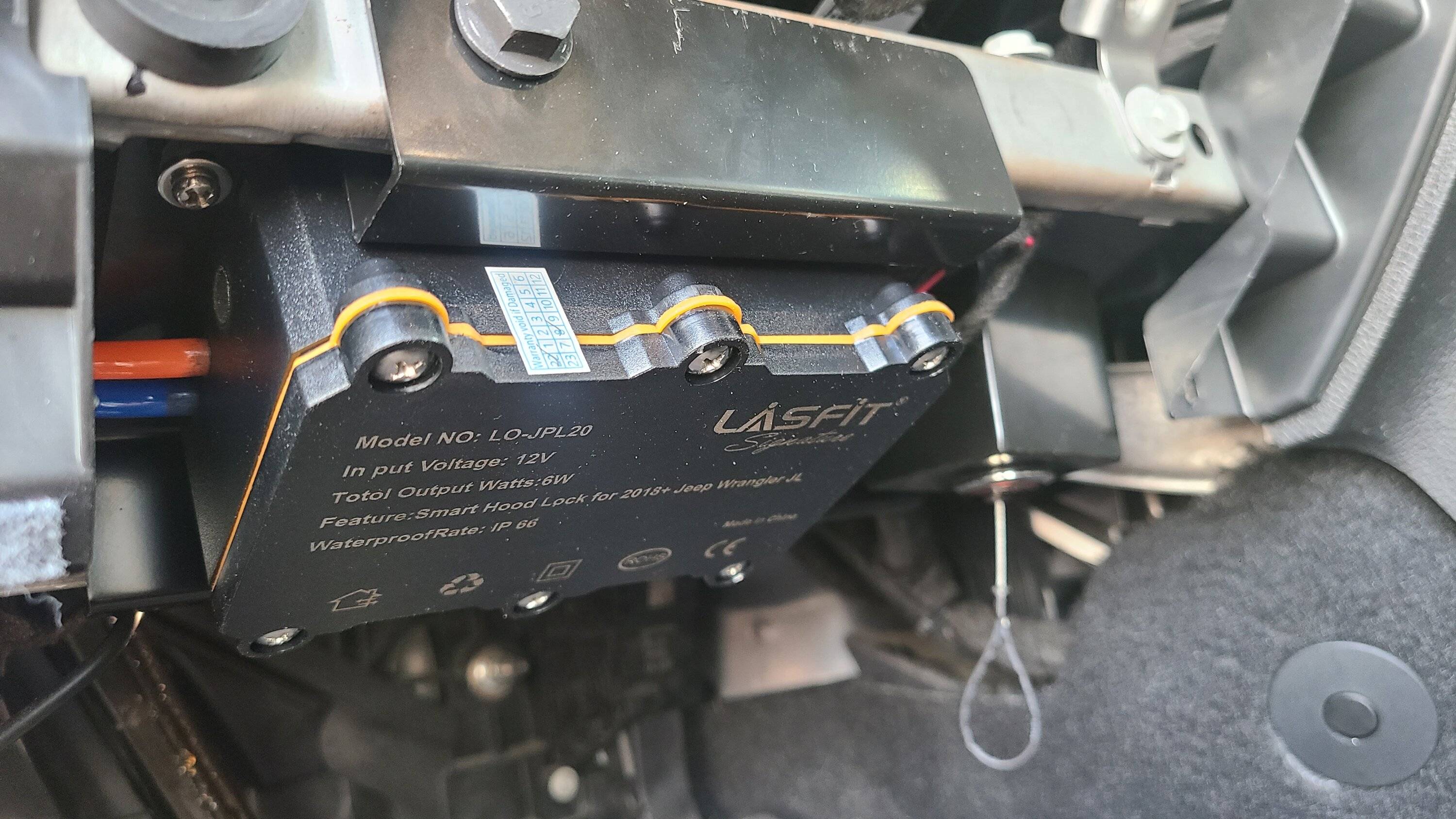

Had some guys "admiring" my jeep a bit too closely when I came out from the barber (they ran when I yelled from a distance... one hood latch was undone when I got there) ... Went home and moved one of my "someday" projects to the top of the list ... Installed the lasfit stealth automatic hood lock ... won't stop the determined but will slow them down
https://www.lasfit.com/products/las...k-for-18-22-jeep-wrangler-jl-and-gladiator-jt
Super easy install for what it is (just under 2 hours) ... granted locking latches are quicker to install
For the unfamiliar, this locks and unlocks the hood using the data bus signal on your gladiator (i.e. it locks and unlocks with your doors if you have electric locks) There is also a mechanical backup (pull cable) and and electric backup button.

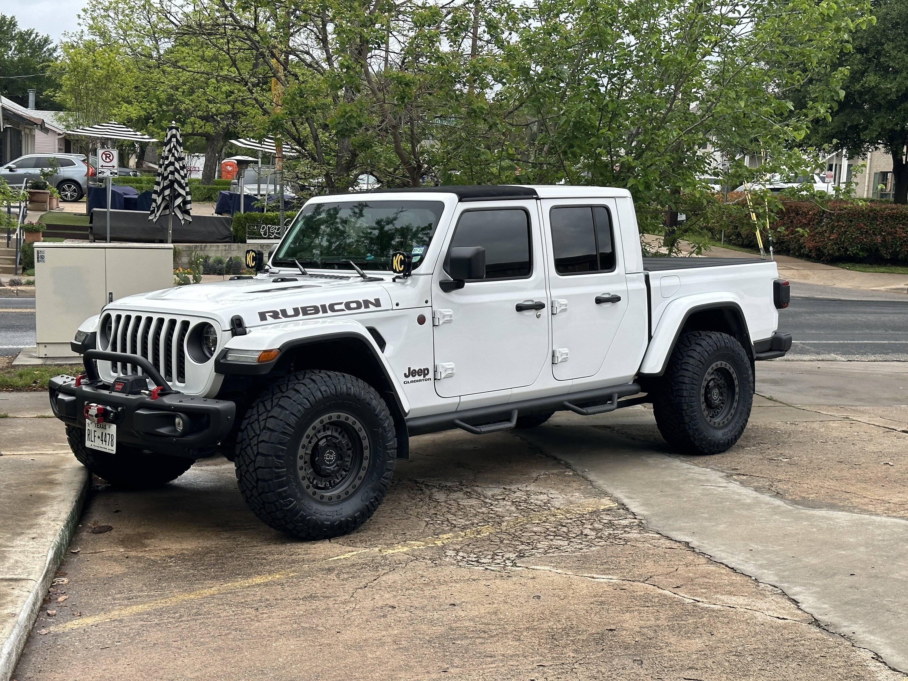

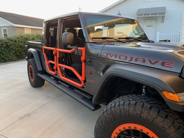

After a year of debating and research, new wheels and tires today. Nitto Ridge Grapplers 35" and Black Rhino Abrams Gun Metal. Couldn't be happier. Next. going to do a 1.5" level on front.

I have one in the Mojave. My MPG went up 3% and it cured my death wobble.
Cat got pregnant too, but I'm not sure that's the cause.

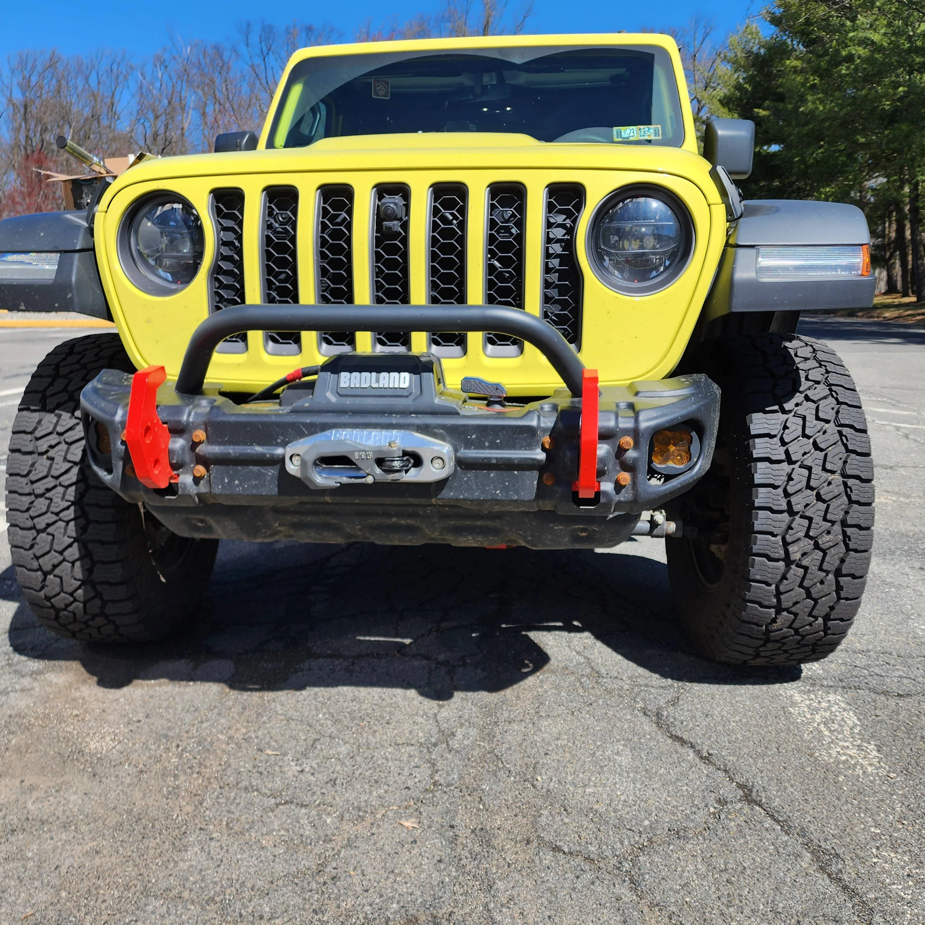

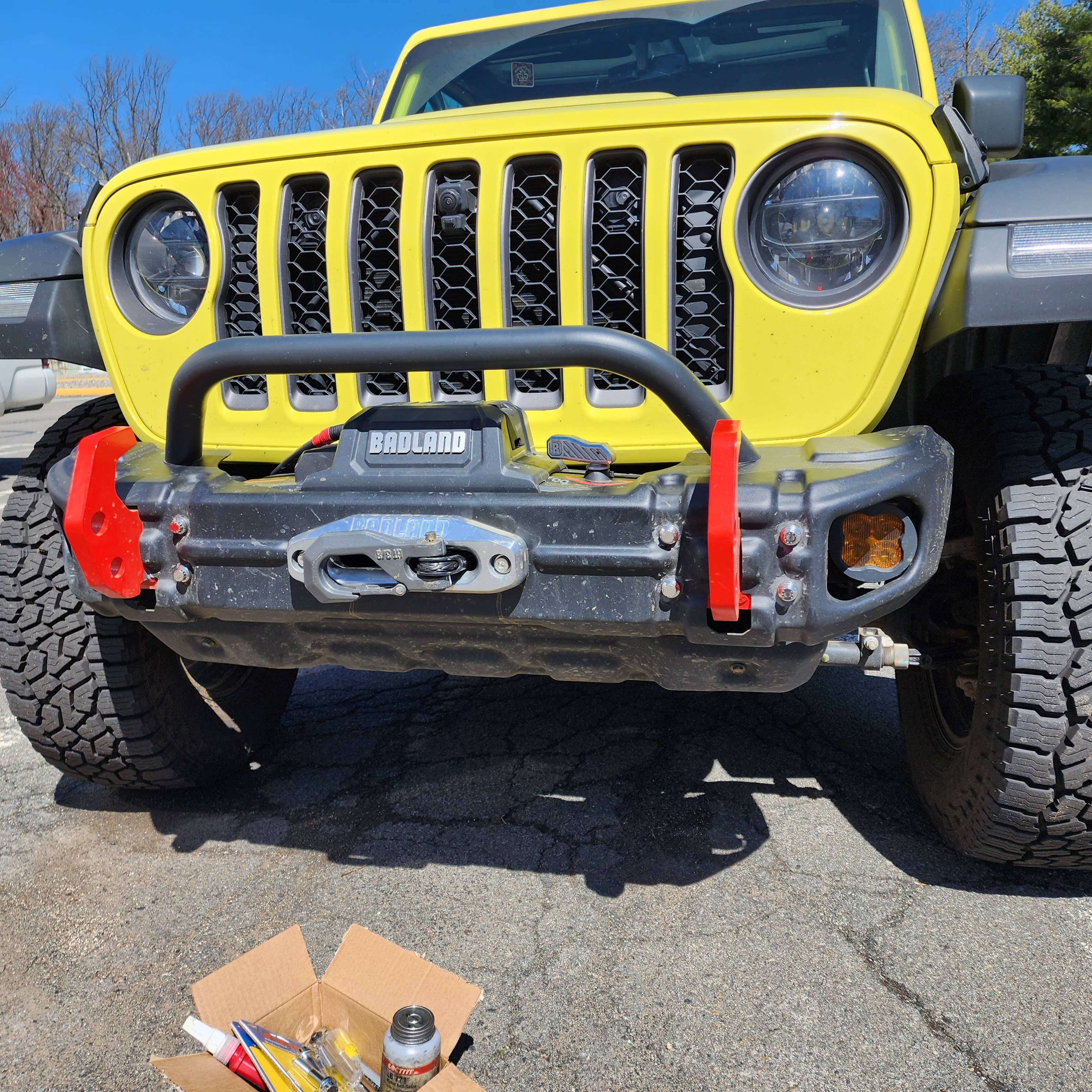

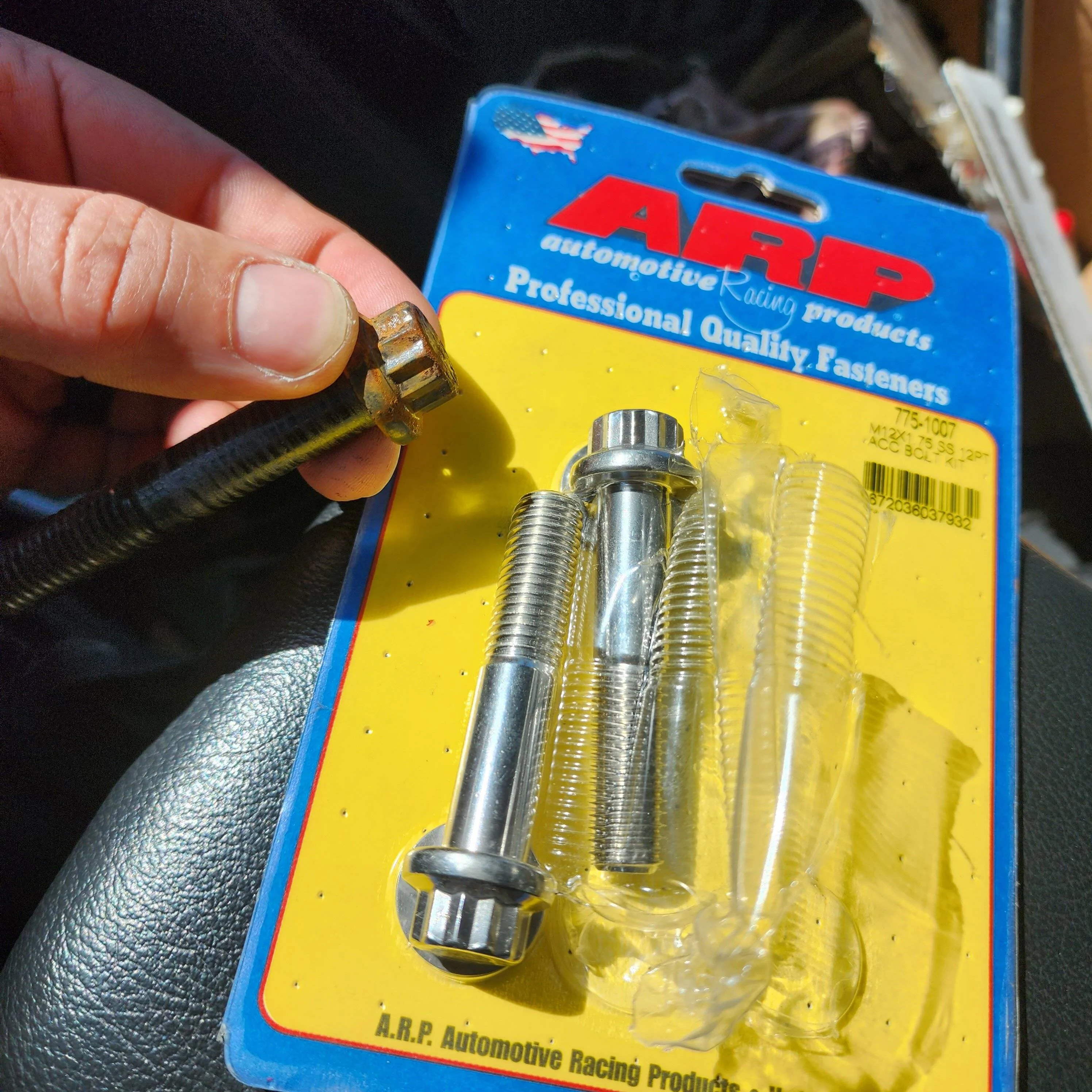

Careful with SS it likes to gaul up especially if you go in dry and use power tools.
I went in wet and by hand. Torqued to 100 ft/lbs. I work with a lot of non ferrous and SS hardware in my day job.

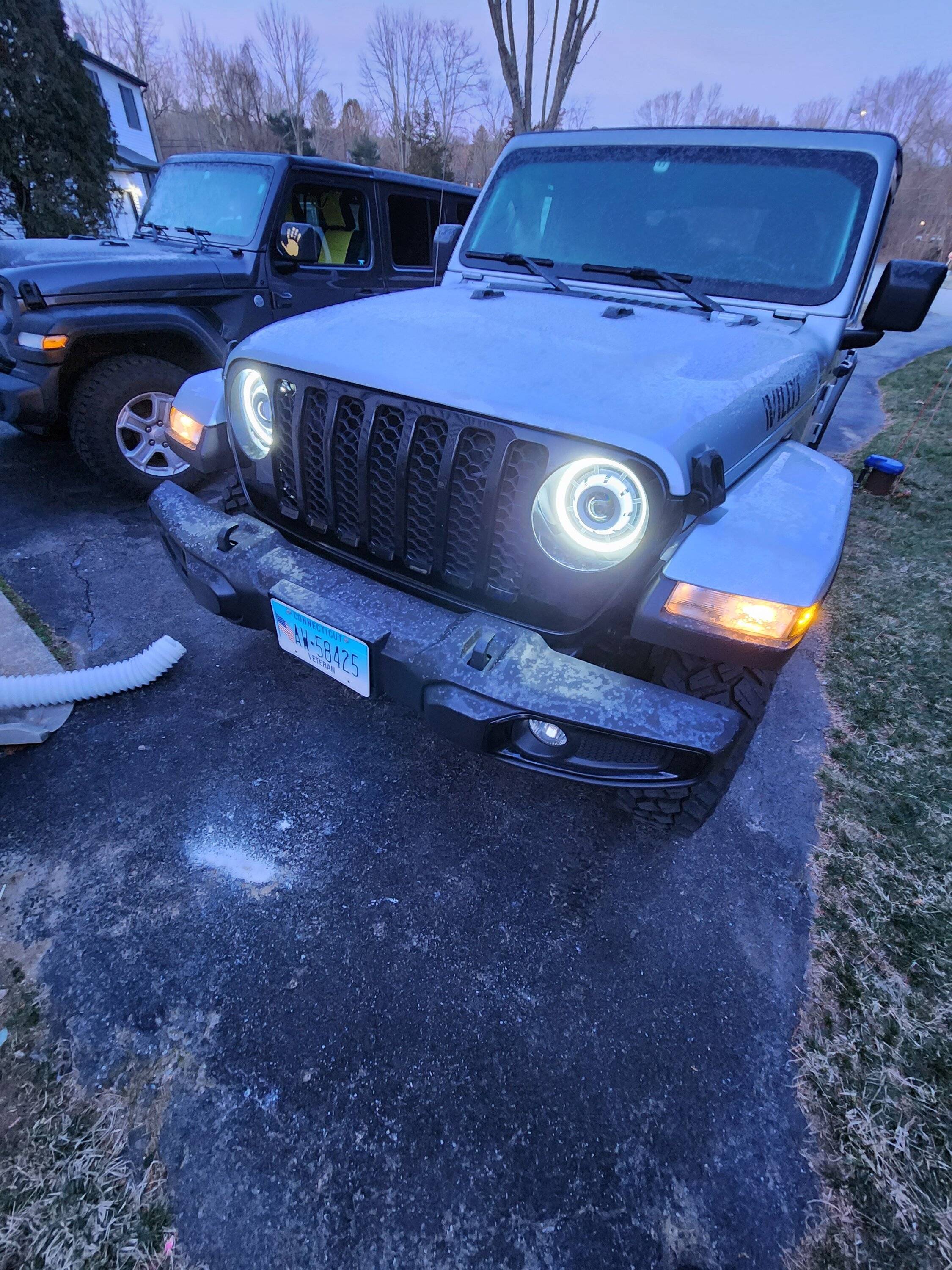

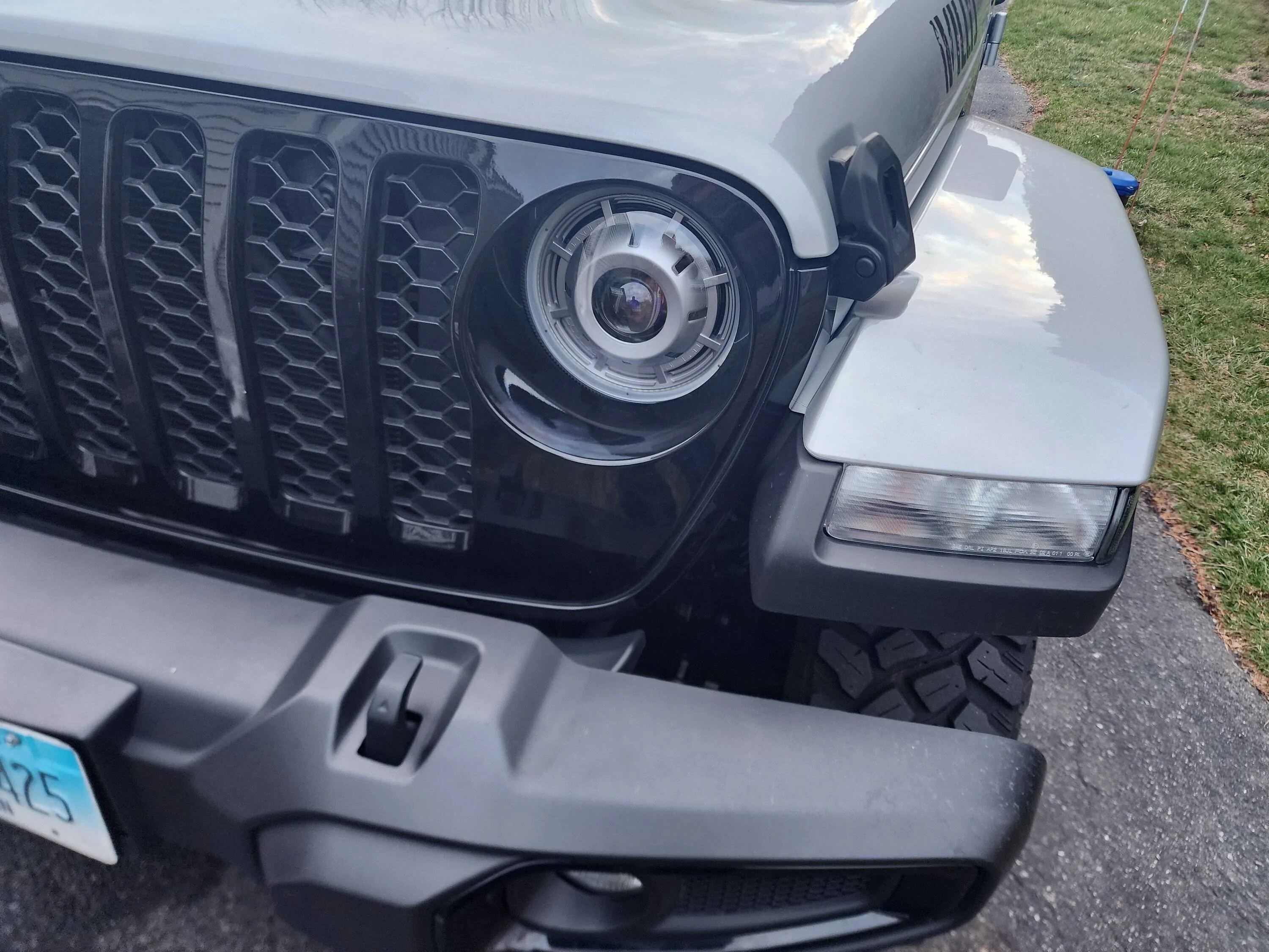

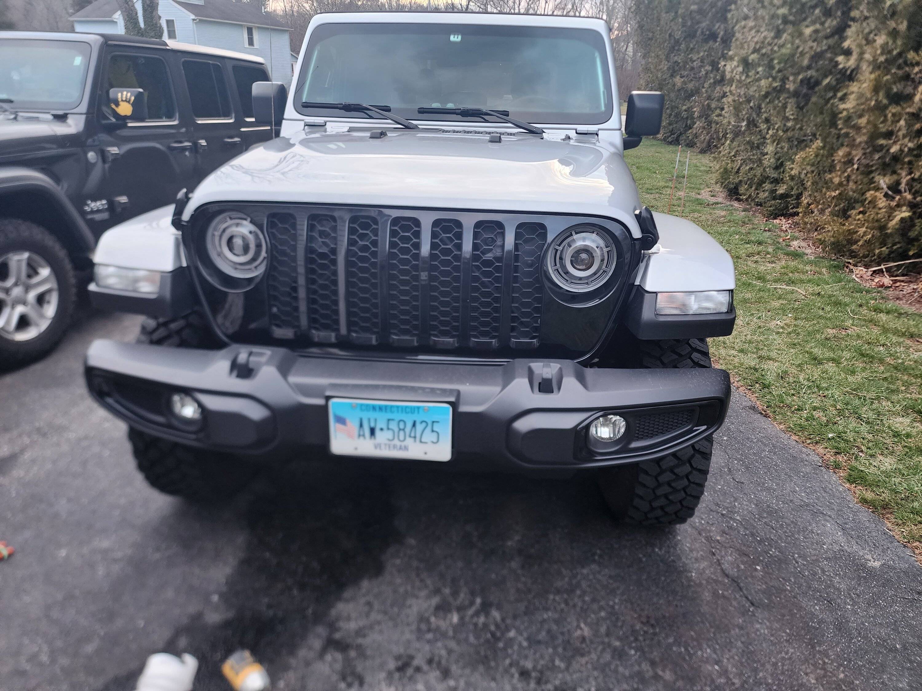

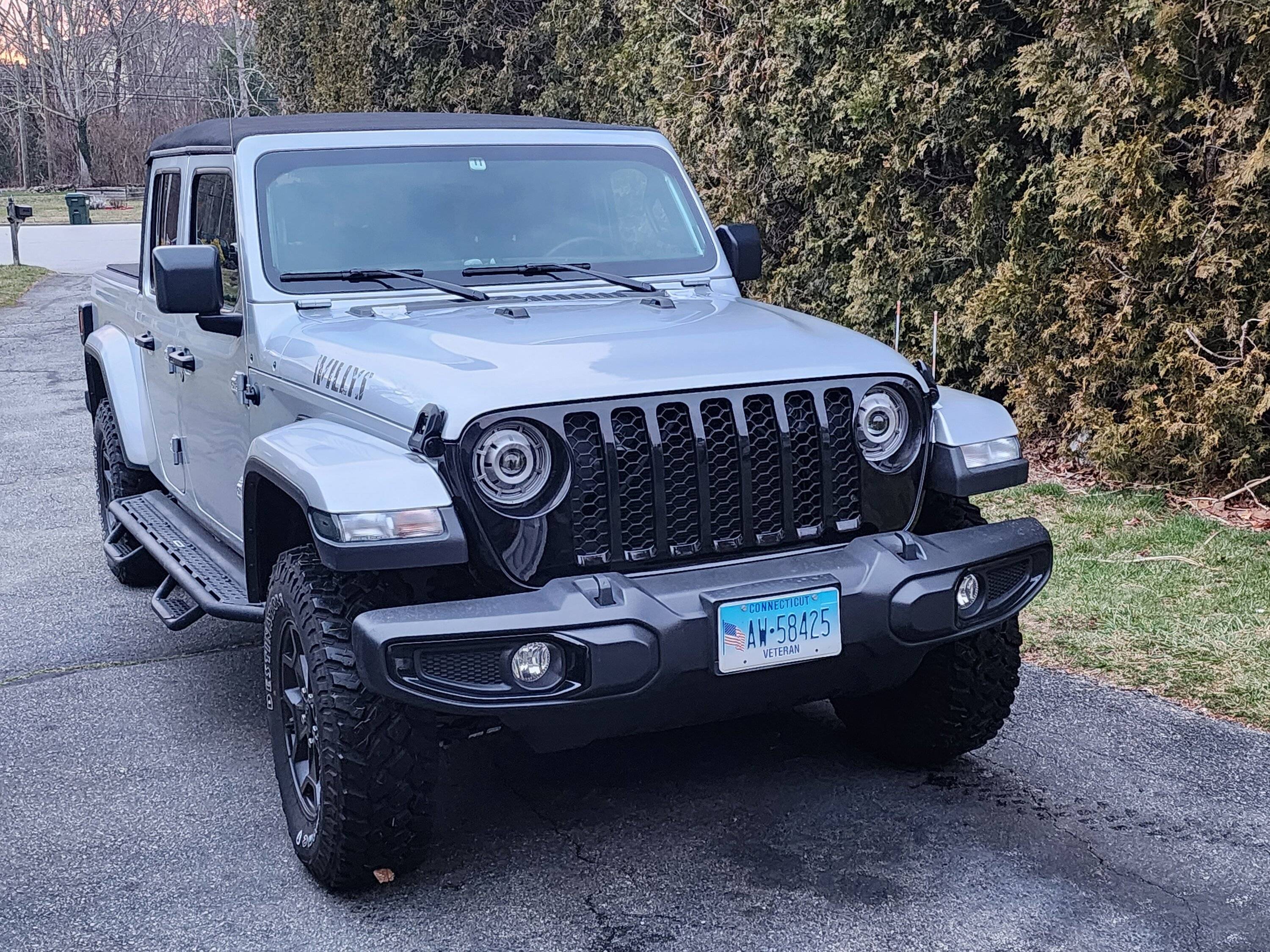

Finally bit the bullet and purchased the Oracle Oculus BI-LED headlights. I couldn't take the awful oem halogen lights. They are the perfect brightness. I was just going to get an amazon set but I really didn't care for the designs.
Also, I wanted to be different and get away from the black so I got the satin silver to match my paint color. So far so good, thanks @Northridge4x4 and @ORACLElights.
Just a side note, I finally purchased a JSCAN and the cables and reprogrammed the BCM to read LED headlights right away so I can't comment on using LEDs with the truck programmed to halogens.

When they’re off, looks like the eyes of a Transformer. ?
