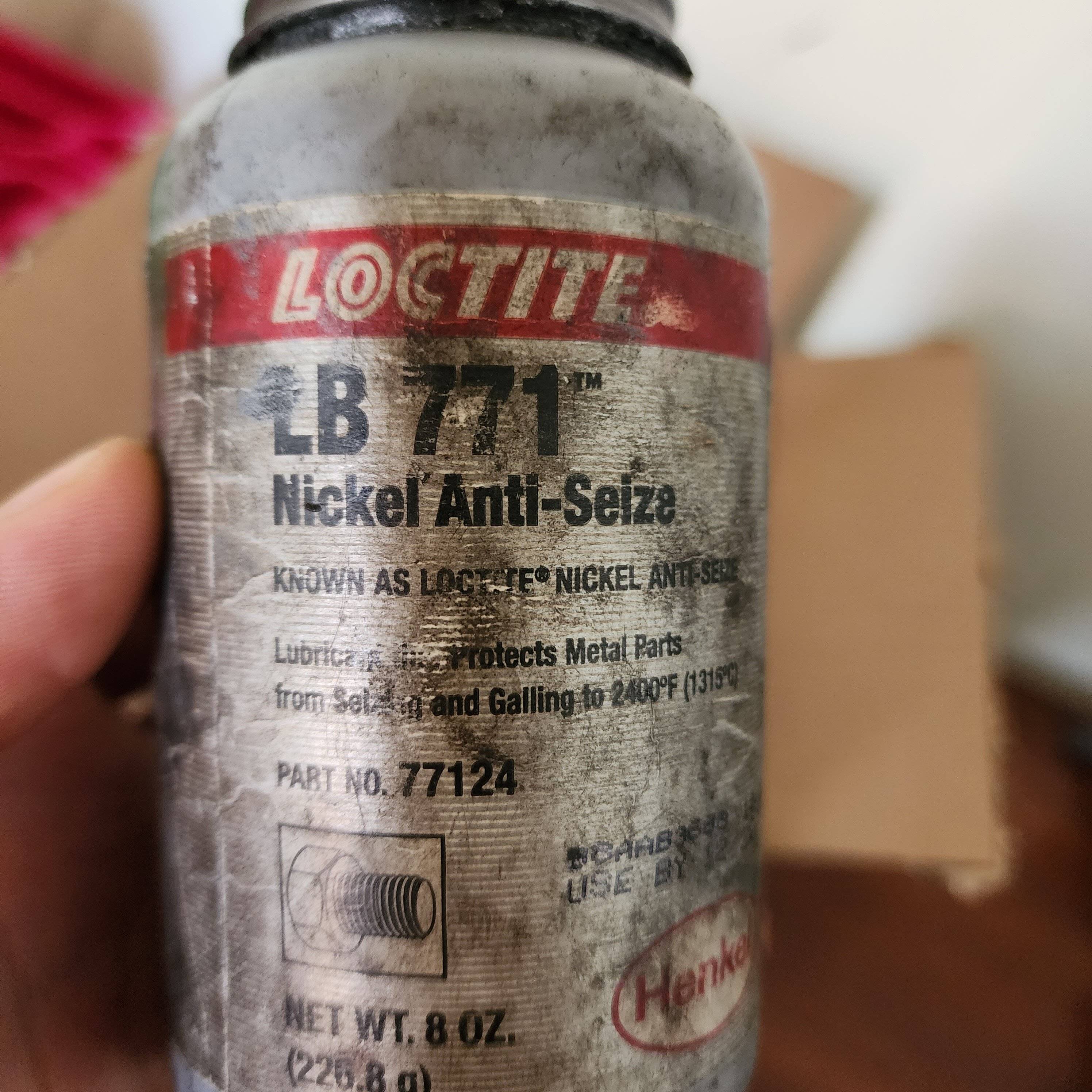

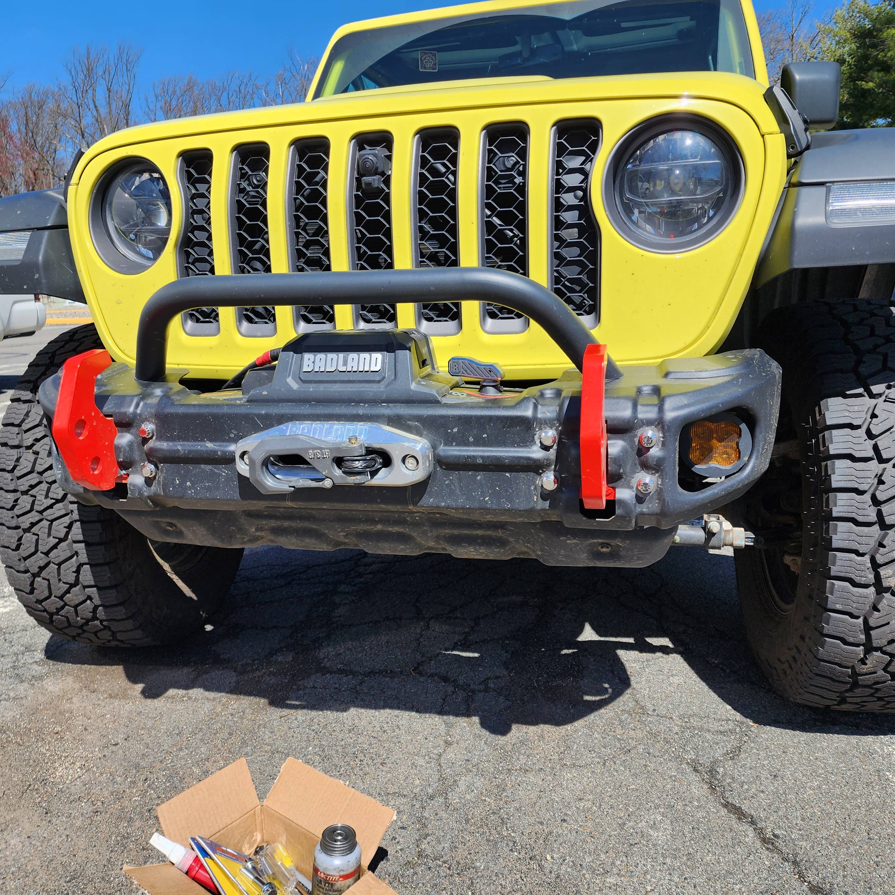

I went in wet and by hand. Torqued to 100 ft/lbs. I work with a lot of non ferrous and SS hardware in my day job.
anti-seize made for stainless fasteners?
Yes, I use nickle based antiseize on stainless. Well, I use it just about everywhere due to higher temps than aluminum or copper based. Copper based is a no no on stainless.
Jeep Gladiator What did you do TO your Gladiator today? [ADMIN WARNING: NO POLITICS, NO GUN TALK] 20230330_122714
You can just see it in the box, lol! Blue loctite too. Those dont get mixed, rofl
I painted everything up, removed one bolt, installed the SS bolt, and worked my way around to not disturb the alignment on the arcus components/spacer.

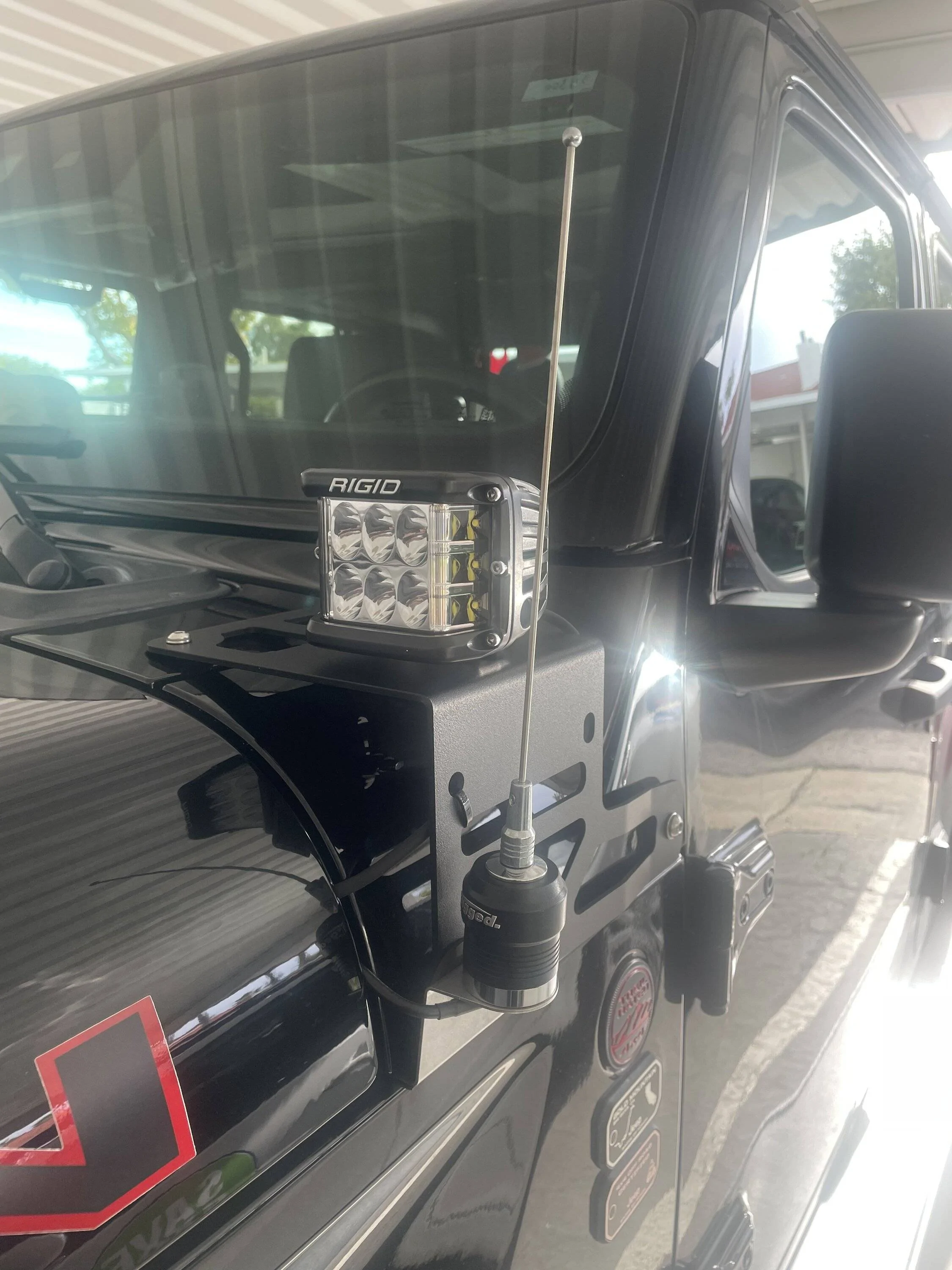

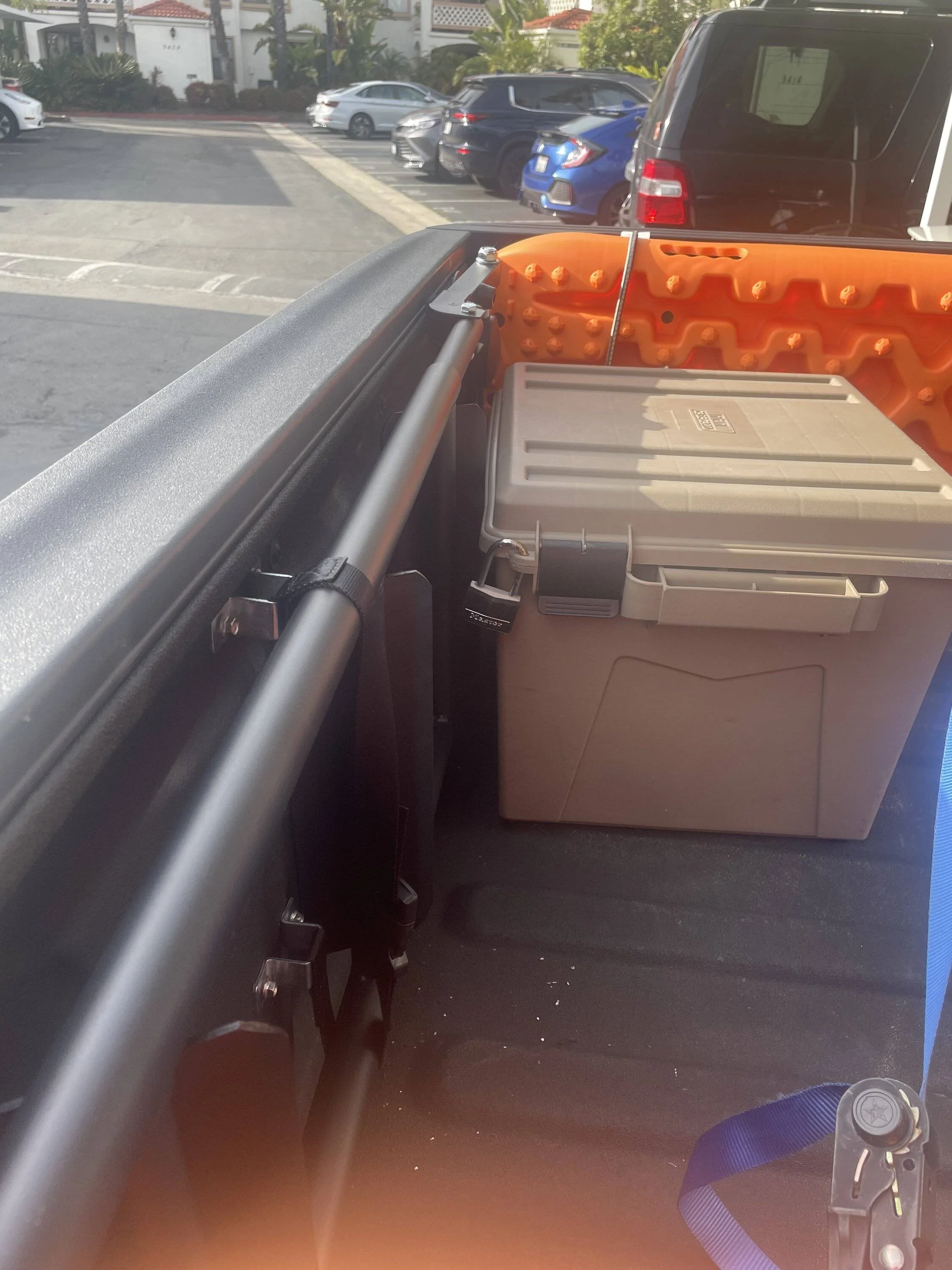

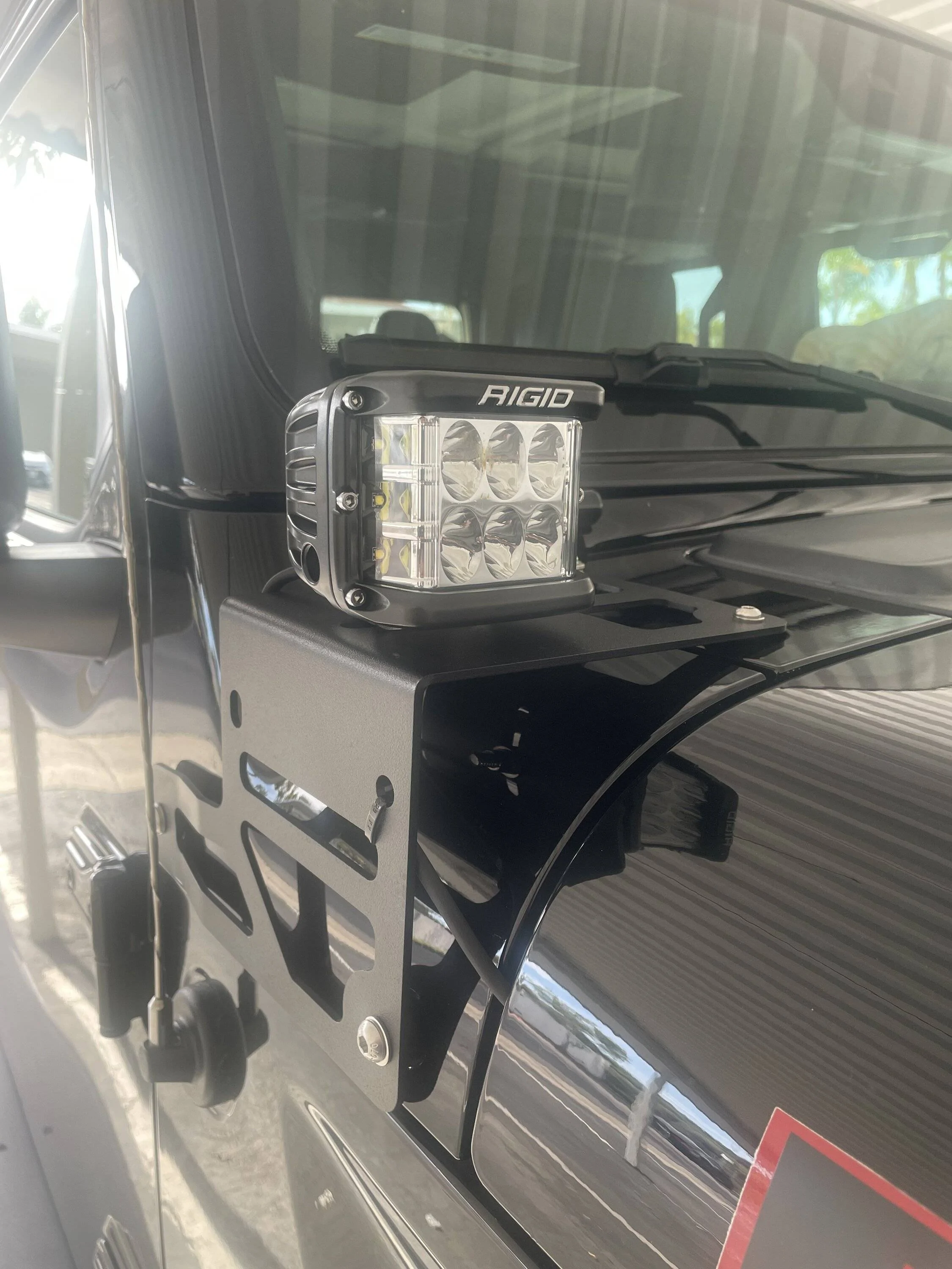

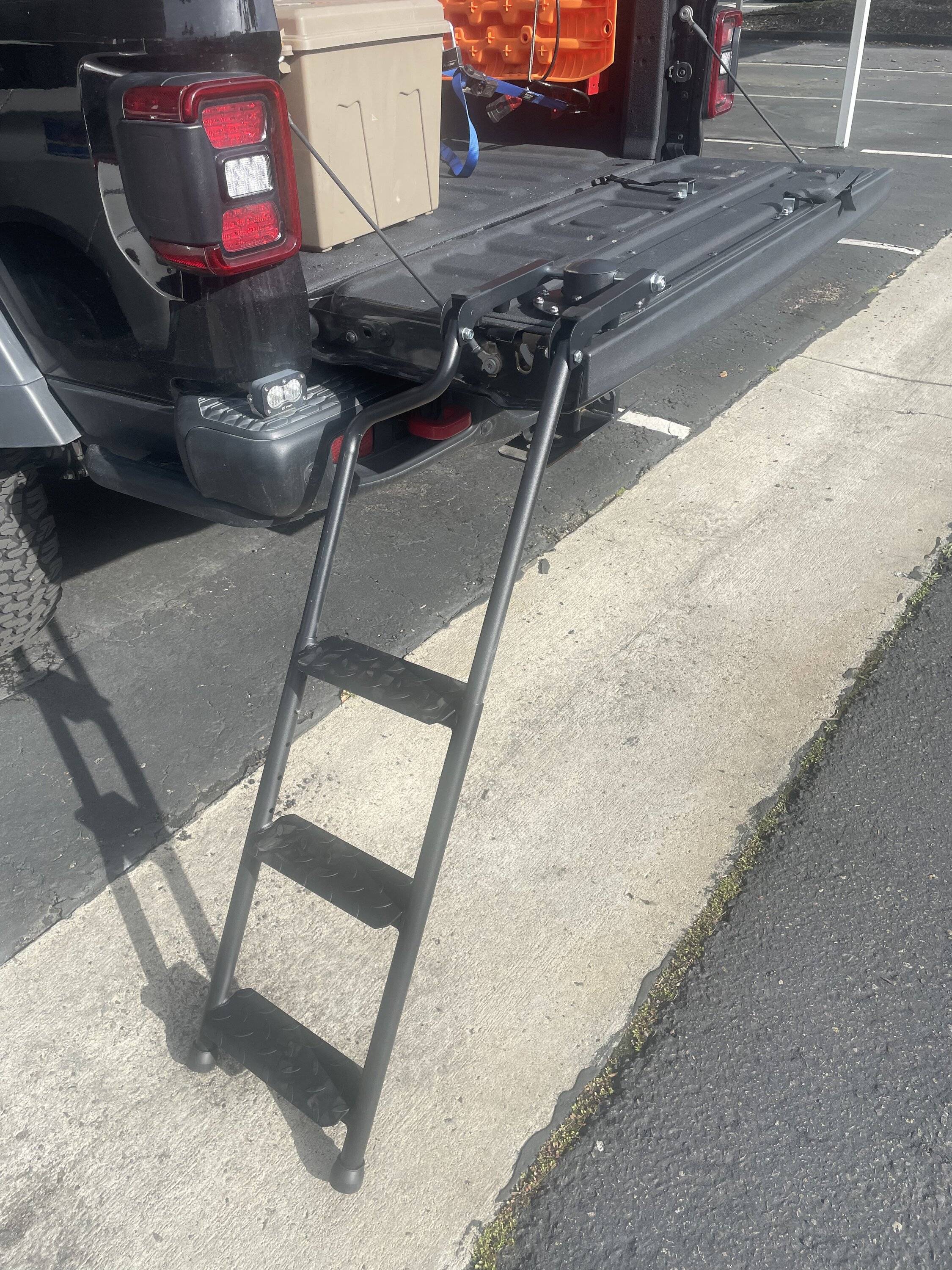

Added Rigid D-SS pro lights on my a-pillar and added foldable ladder on tail gate
I really like the ladder. Could you please share a picture of it folded? And a link please? How do you like it?

Bought it on Amazon
Details
Material
Iron
Brand
AA Products Inc.
Product Dimensions
3.5"W x 10.6"H
Color
02-black-upgraded Version With Wide Pedal

More info on ladder. Don’t know how to do link on my Phone
4.5 out of 5 stars547Reviews
AA Product Tailgate Ladder Foldable Pickup Truck Tailgate Ladder with Wide Pedal Non-Slip Sturdy for Truck Easy Install Durable Steel Omni-Directional Ladder Rack Capacity 660 lb(USPTO Patent Pending)

Hope this helps
Great. Thanks for all the info. That’s quite tempting. Is it Indy to remove completely, if needed for some long object that needs all 5’ of the bed? Quick release pins of something?
RangerG
Gary
Jan 2, 2021
262
345
San Diego
Jeep Gladiator
Aircraft Maintenance Instructor
No, the mounting plate is screwed down. You could remove the bolts that hold the ladder on the mounting plate

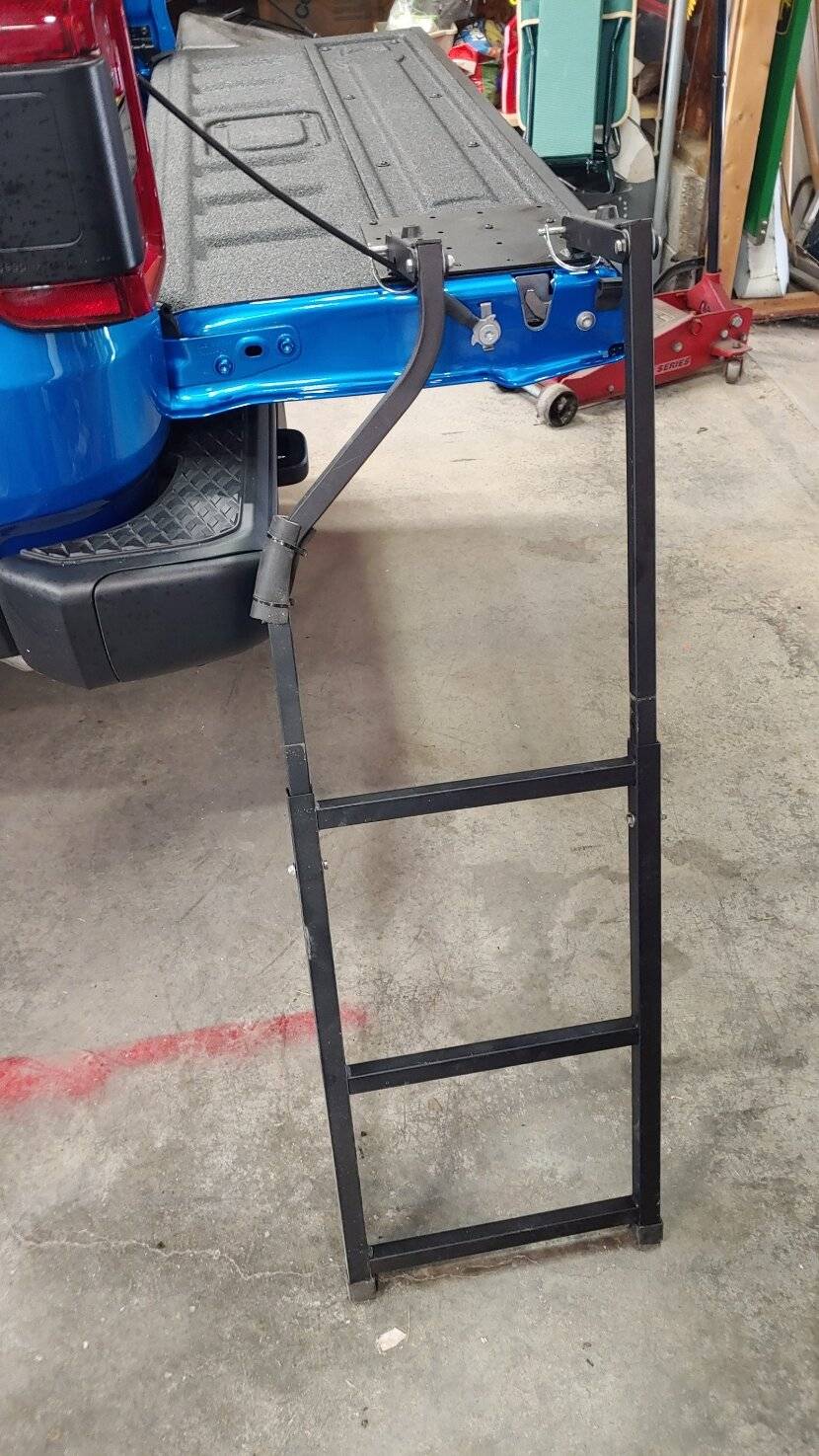

Looks like the updated version of my tailgate ladder. That one swivels so will work off the side or end of the tailgate if I recall.
I mounted mine "lower" on the tailgate to clear the tonneau cover and latches I made for the cover.
Jeep Gladiator What did you do TO your Gladiator today? [ADMIN WARNING: NO POLITICS, NO GUN TALK] 20220812_135743
40,514
54,051
I wonder if he could replace the bolts that hold the ladder to the pivot part with pins.
Mine comes off the mounting plate by pulling two pins. That's what I do for long stuff or for my tent. I also mounted the mounting plate to the tailgate using rivnuts and screws I could take out in a minute if I wanted the plate off.
