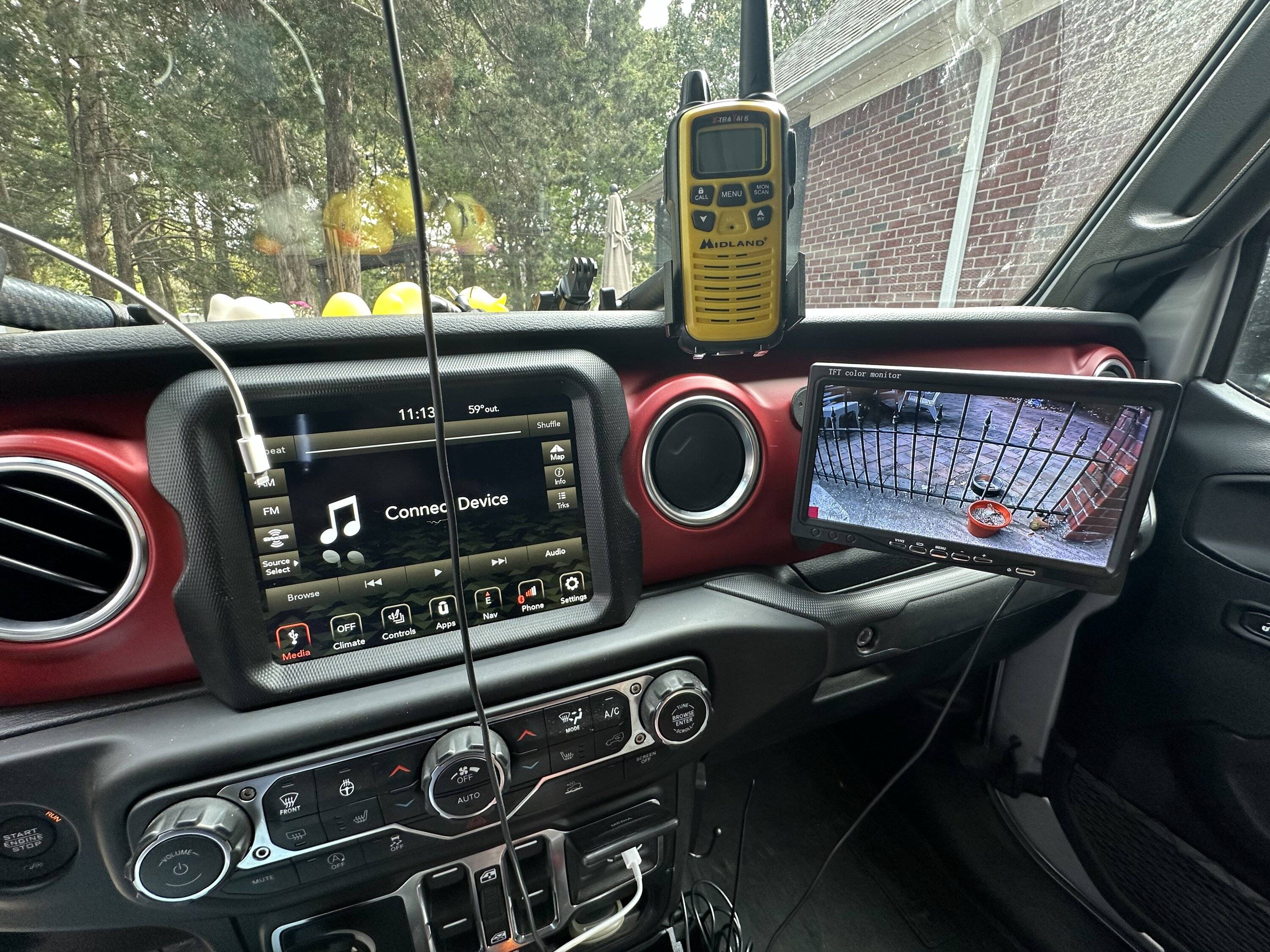

I added a $39 front camera. The kit comes with the screen, wiring, mounts, and the camera for that price, which is the deal of the year in my eyes. And a remote I'll never use for the screen, too! I've been looking for a camera that meets the criteria of A) Low Price, and B) easy to install. I am not sure that the front camera will be something I find valuable, and I have spent too much money on modifications that ended being a waste of money.
I found this camera for $39 on Amazon. Installation was a breeze- drilled a hole through the plug that goes through the fire wall, duct tape, and zip ties. I am well aware that not everyone is willing to "cheap out" on installation, but this is my "test it out" stage, and if I can't live without it, I'll graduate to tapping the bull bar and using hardware to install it.
Conceptually, though, it works great right now.
It appears you attached the monitor to the panel containing the passenger airbag…[insert worst case scenario]

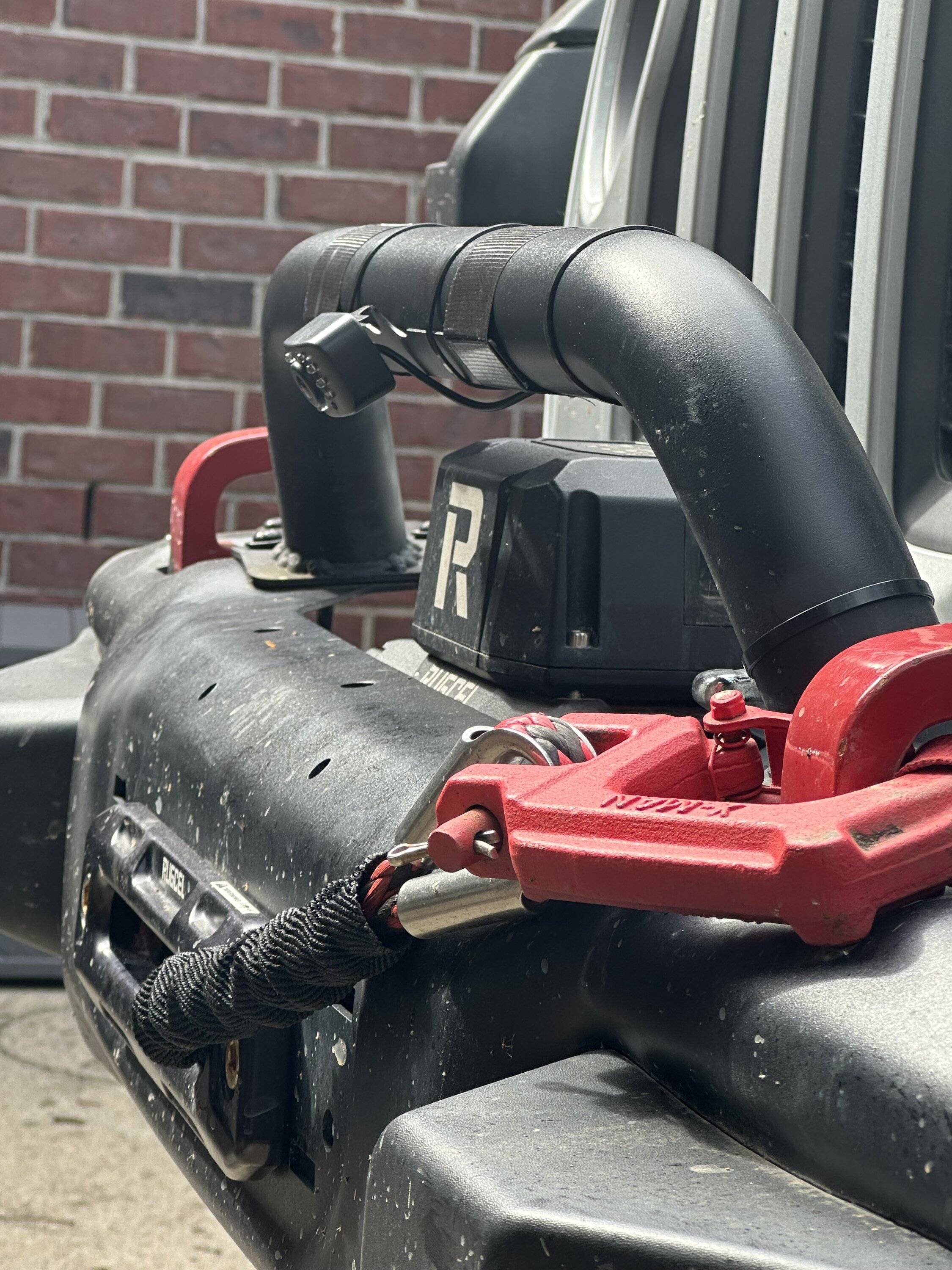

Winch install begins.... i found only one a ftermarket winch mounting bumper that claims to mount an 8274 and its aluminum and costs 7.925 gigabucks so im a bit short... plan going in was to enlarge the existing winch access I n the top side of the stock steel bumper. Not sure that will work as elegantly as id hoped....
So good sirs and madams assuming i need a new bumper i ask you, rectagular steel tube bumper? Round steel tube bumper. Li kely prerunner style, or try to make the stocker work even if i have to chop it up.
I tried to post a pic but met with utter failure. Said it wasnt a readable format...
Input please
