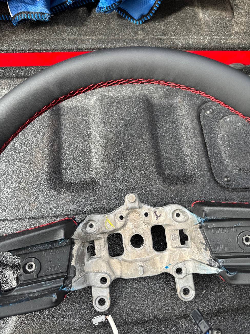

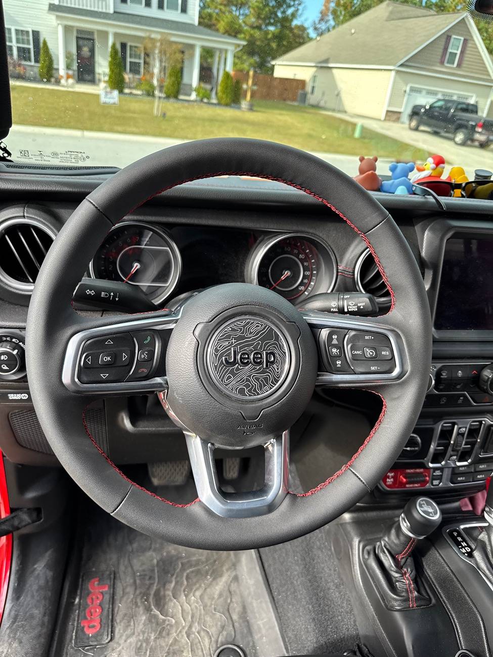

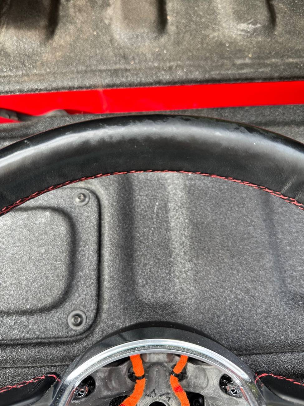

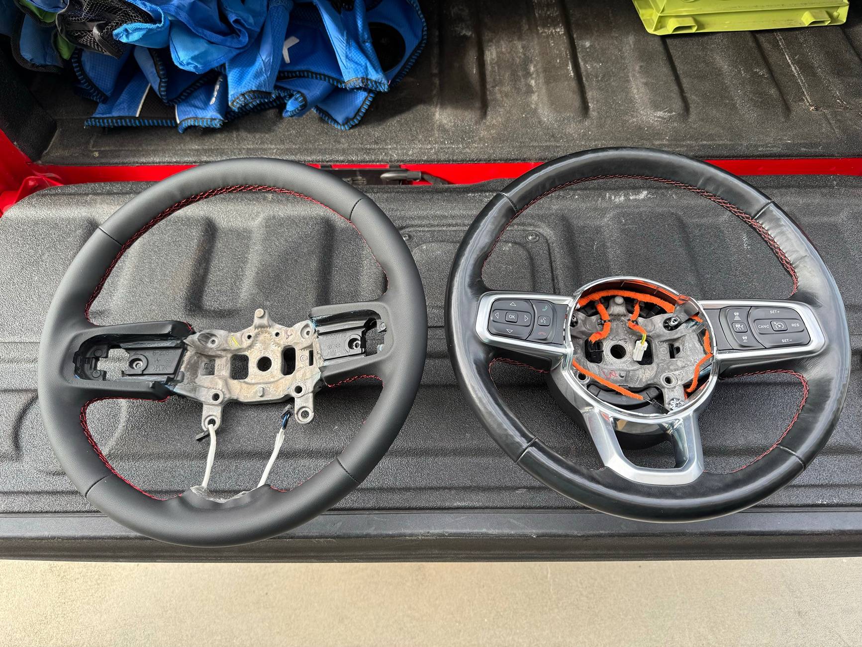

Switch out the steering wheel with a fresh OEM one. Feels like new! Kinda sad this old wheel wore so bad in 70k miles.
Just wondering, did you use a lot of alcohol based hand sanitizer during the "scare". There was a way noticeable uptick of peoples interior soft touch spots degrading prematurely from it during that time frame.
Not that I recall. I don’t even keep any in the truck. But now that you mention it, we were walking around all day putting it on so that is plausible!

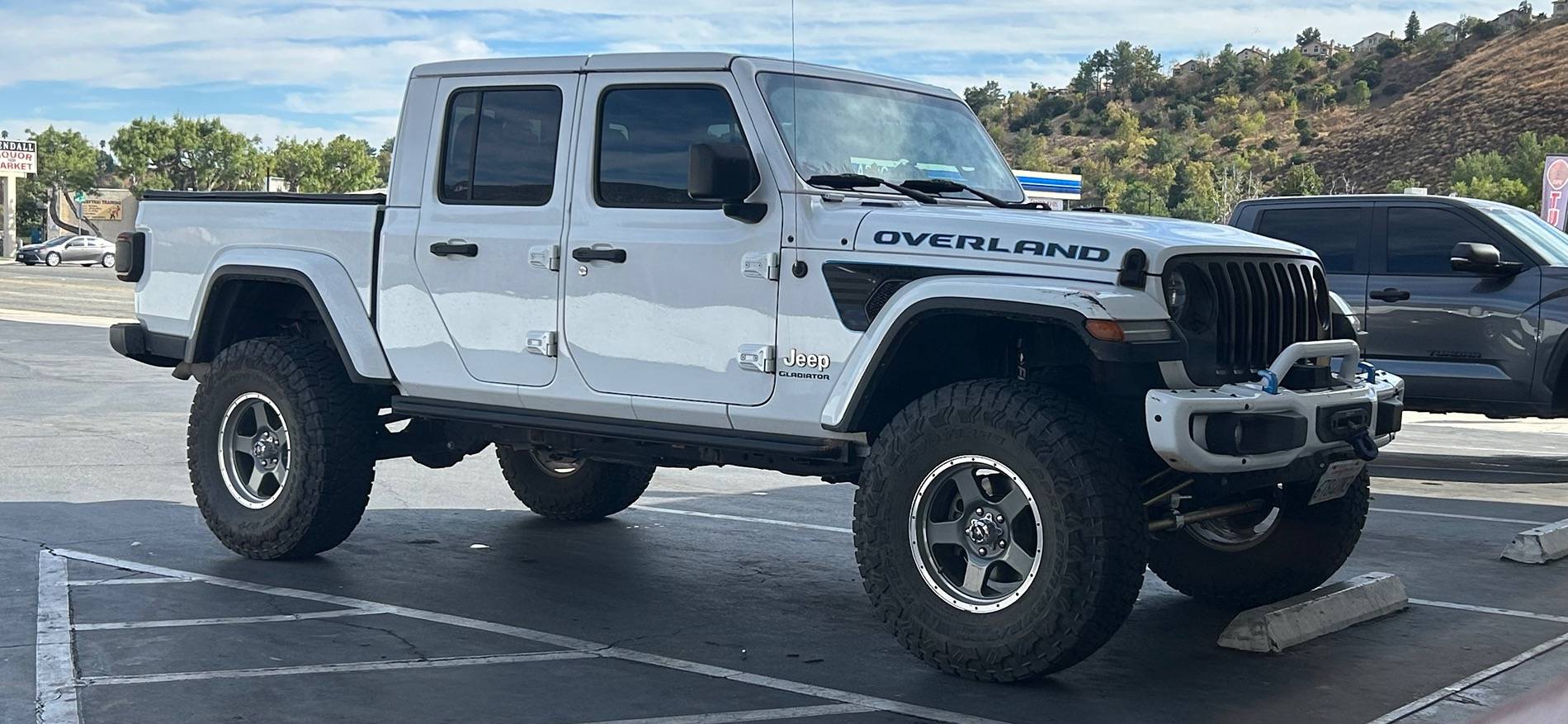

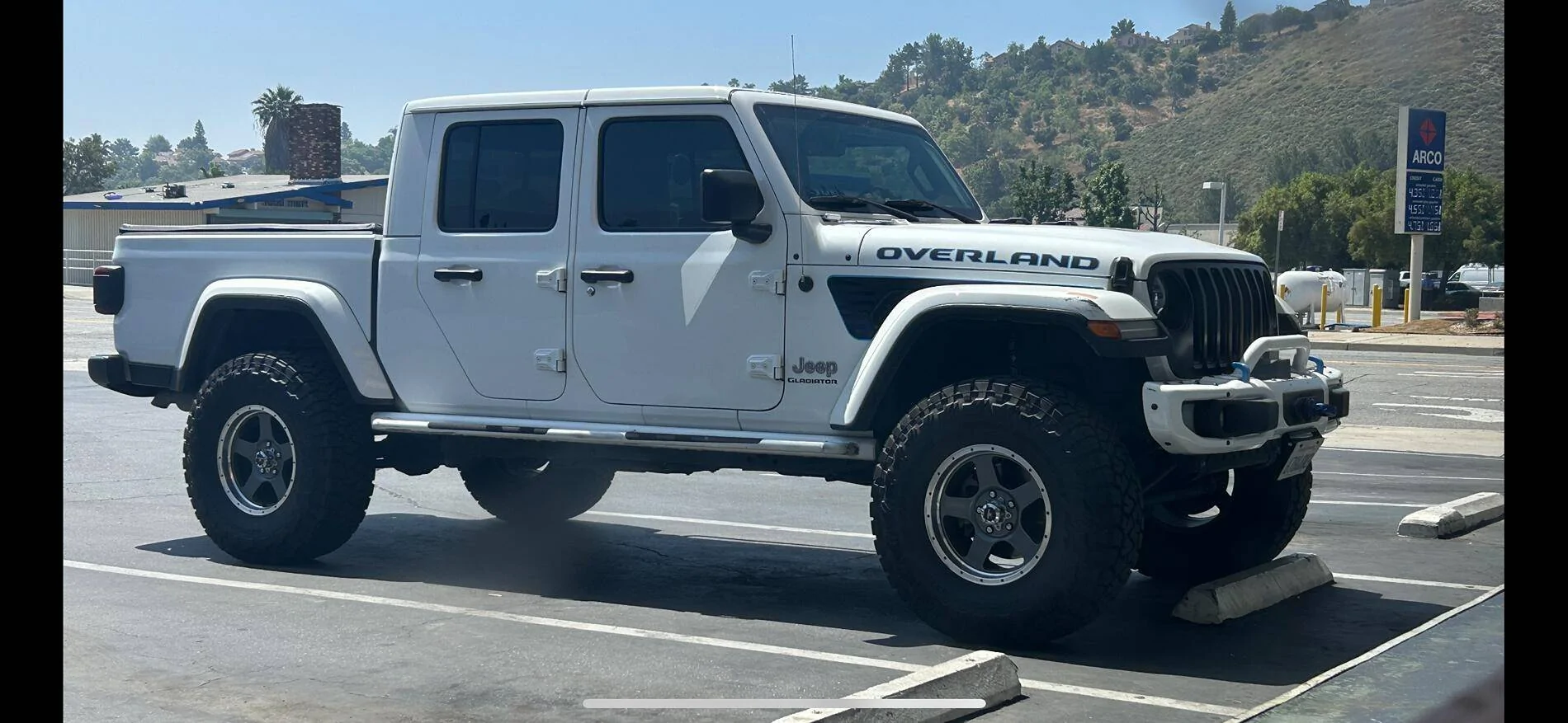

Replaced my stock rear springs with 3” spacers for some Fundamental Motorsport springs. Previous to this I was dead level at 4.5” front and 3” rear, but as I add more weight I’m starting to see a sag. The new springs got me to about 4 1/4” rear, should settle some. I still have a Westin steel bumper to install and that will bring it down a tad more.
before and after

I need apples to apples. I think you’re one parking space over. Come on. Details matter.
Looks great.

I tried! There was a car parked there when I pulled in lol. Next time 🤣
