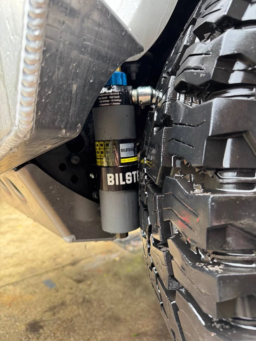

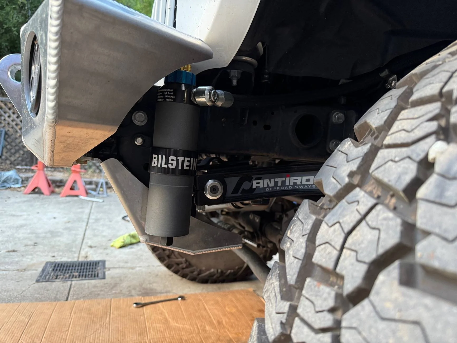

Finally got around to sorting out my 37” tire w/ 4.8” wheel backspace vs. 8100 external reservoir and Currie anti rock vs. 8100 external reservoir.
Tire would solidly contact the resi with full steering lock cross stuff and the anti rock and resi occupied the same space. Ended up picking up some nutserts and pushing the bracket to the front most factory holes.
Unfortunately didn’t take a full flex pic following the relocation.

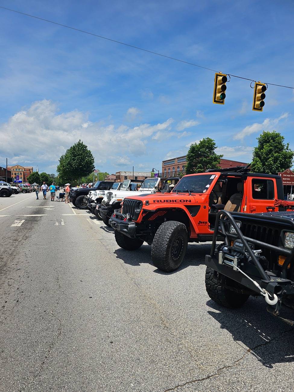

Parked on Main St in Walhalla, SC for their Jeep Fest.

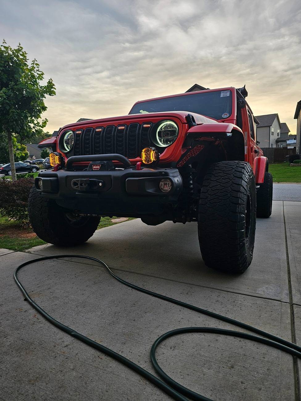

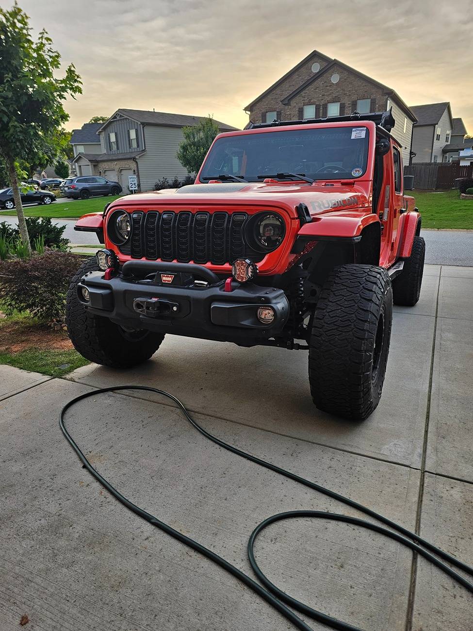

Then came home to my Distiction Applied 24+ grille. So I installed it along with the Z Automotive Trailcam, and Maiker grille lights.

Looks great, patiently waiting for mine to arrive.

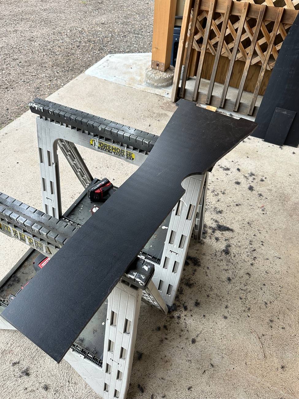

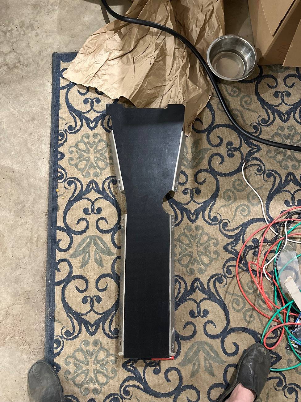

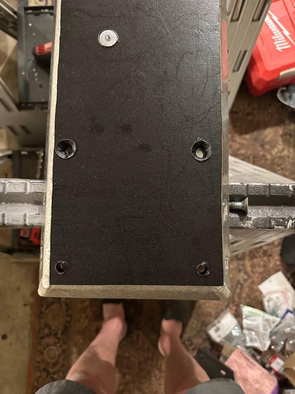

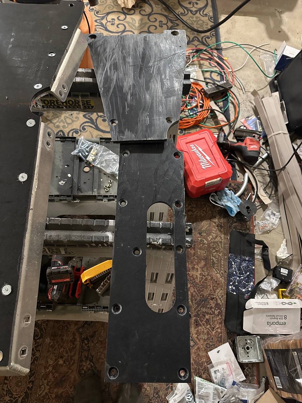

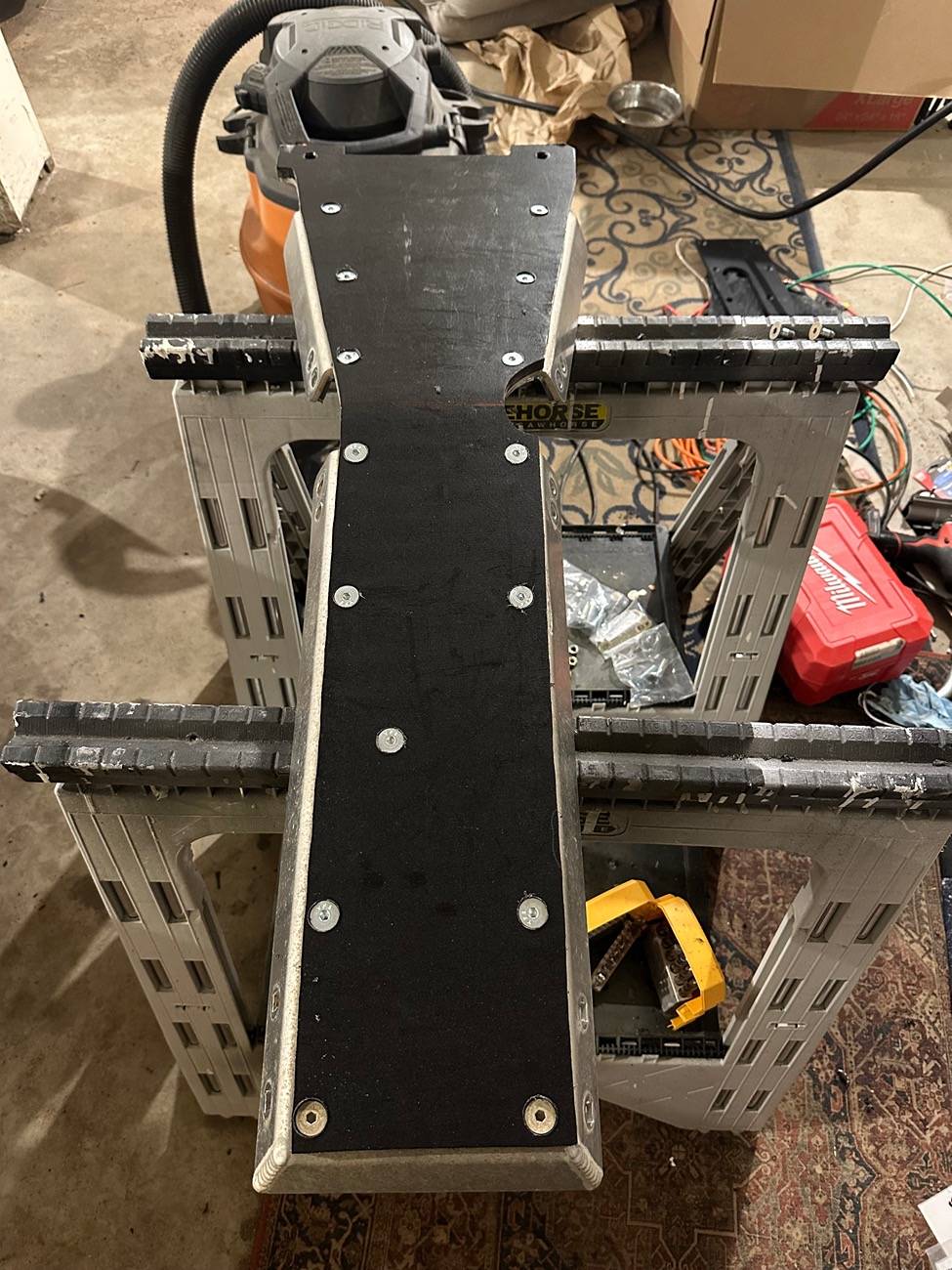

Worked on my reinforcement and refurbish of my engine/tranny skid. The steel reinforcement is from next venture. But I went further and cut out my own one piece UHMW, instead of the two piece design. I think it makes it stronger at the bend this way. Still 8 more holes to drill and that many bolts. Then I’ll do final trimming of the UHMW. And two brackets need paint. But it’s getting close to being able to test fit.

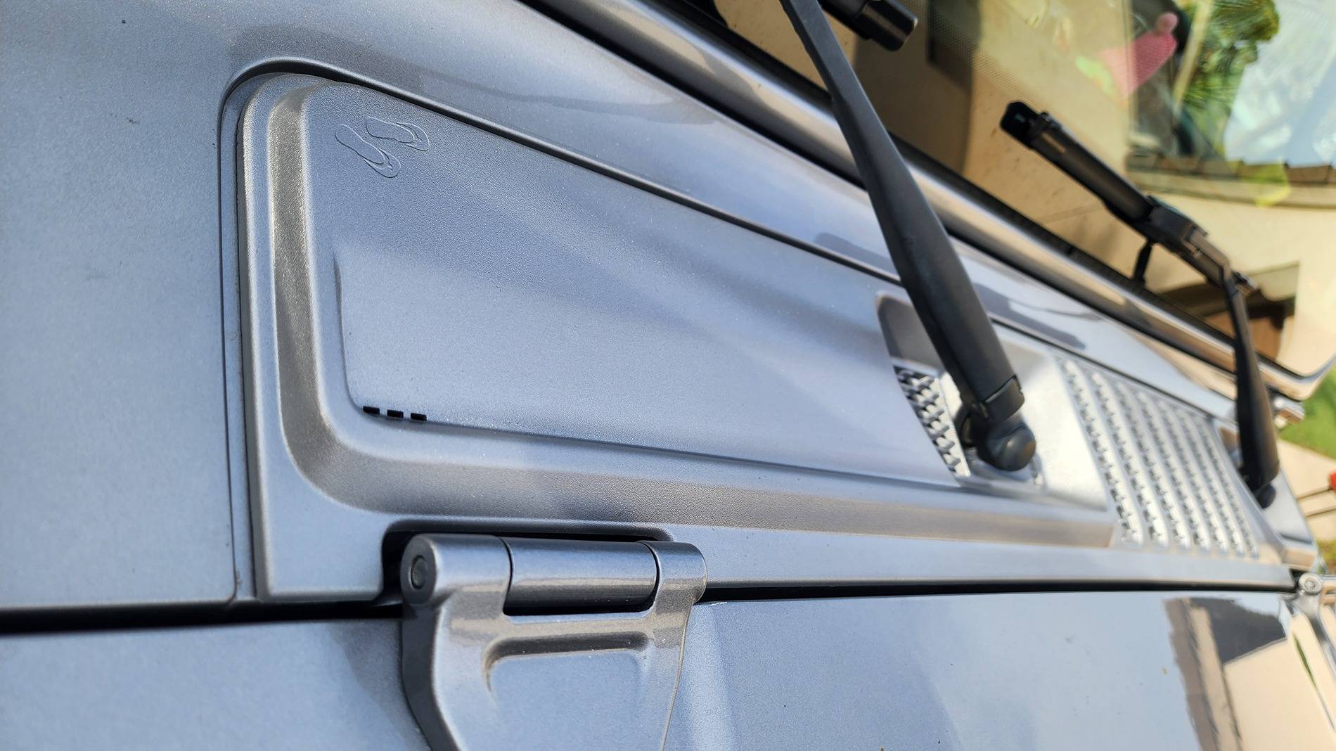

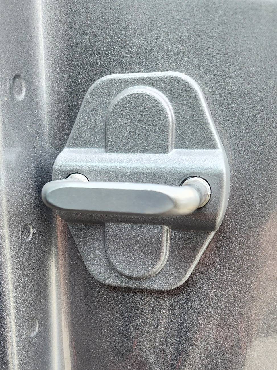

Painted the faded plastic cowl vent. Tried several black plastic restorers, but it eventually went back to the blotchy grey. I figured painting it should last a couple years before springing for a professionally painted piece. Came out pretty decent.
Oh gosh. No skills necessary. If you can operate a rattle can, you can do it. Based on what you're doing to your JT, I'd say you're qualified to use a spray can!
That’s all rattle can? Looks fantastic! Can you provide some tips on the prep required to paint the plastic?

For the cowl vent, I scrubbed it really good with dish soap and a scrub brush. The cowl vent is textured so the surface has tiny pits. Once it dried, I wiped it down with acetone (it didn't melt the plastic). The plastic must be polyethelene or polypropolene. Then, I sprayed a couple light coats of primer (Rustoleum). I sprayed several light coats of base color, followed by several light coats of clear coat. The first couple coats of clear has to be very light. Otherwise, a single heavy coat from the clear will make the base coat run.
For other plastic parts, like the mirror bolt covers, I had to trim the mold flash and lightly sand sharp edges before wiping down with acetone. Again, the acetone didn't melt the plastic. Then, I did the same routine of several base coat followed by several light coats of clear.
I also did the door latch covers.

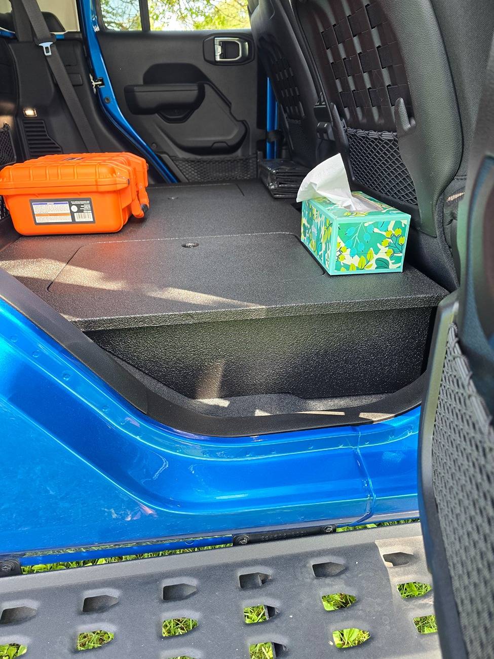

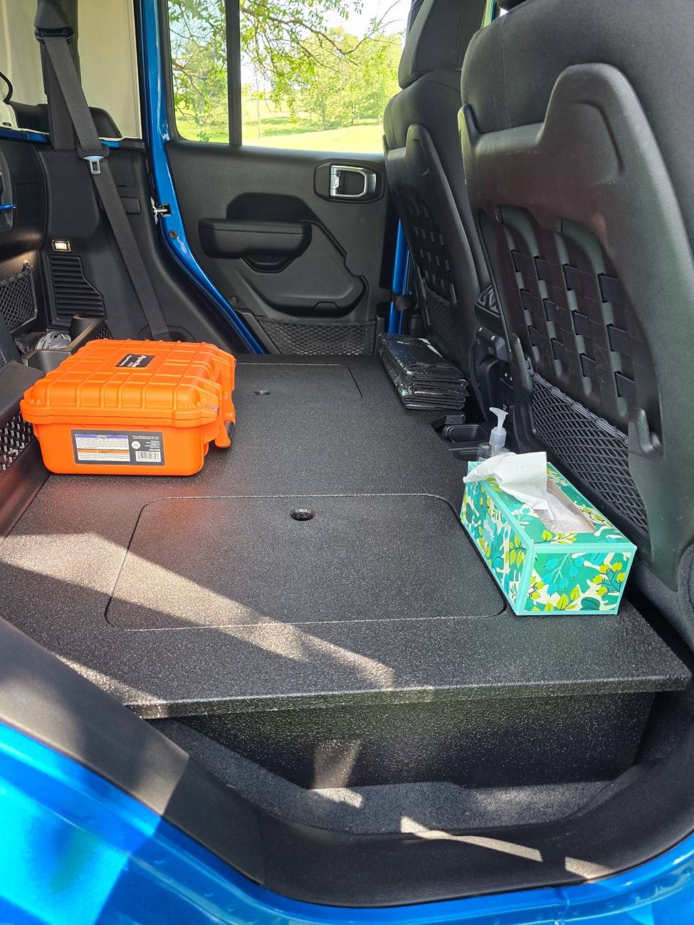

Finally found a back seat delete i love ..I have a back wall,shelf coming. If you want a simple delete this is it super fast shipping and fits like a glove BACK SEAT DELETE is the company
So you got this soon after you ordered it? Their website says made to order taking 8 weeks to get. Was considering it myself but that wait time sucks. Also, did you relocate the jack or can you easily get to it thru the access panel? Are the drink holders on he back of the console still fully usable as they appear?
Nice job Dan, I agree the one piece will make it stronger and the steel interior skeleton brace, should make it more difficult for you to bend. You must be getting nuts to drive your Jeep , been being refurbed for a while now…..Jack
