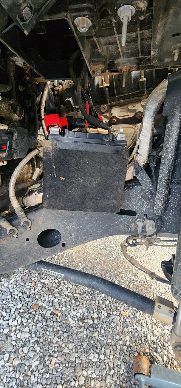

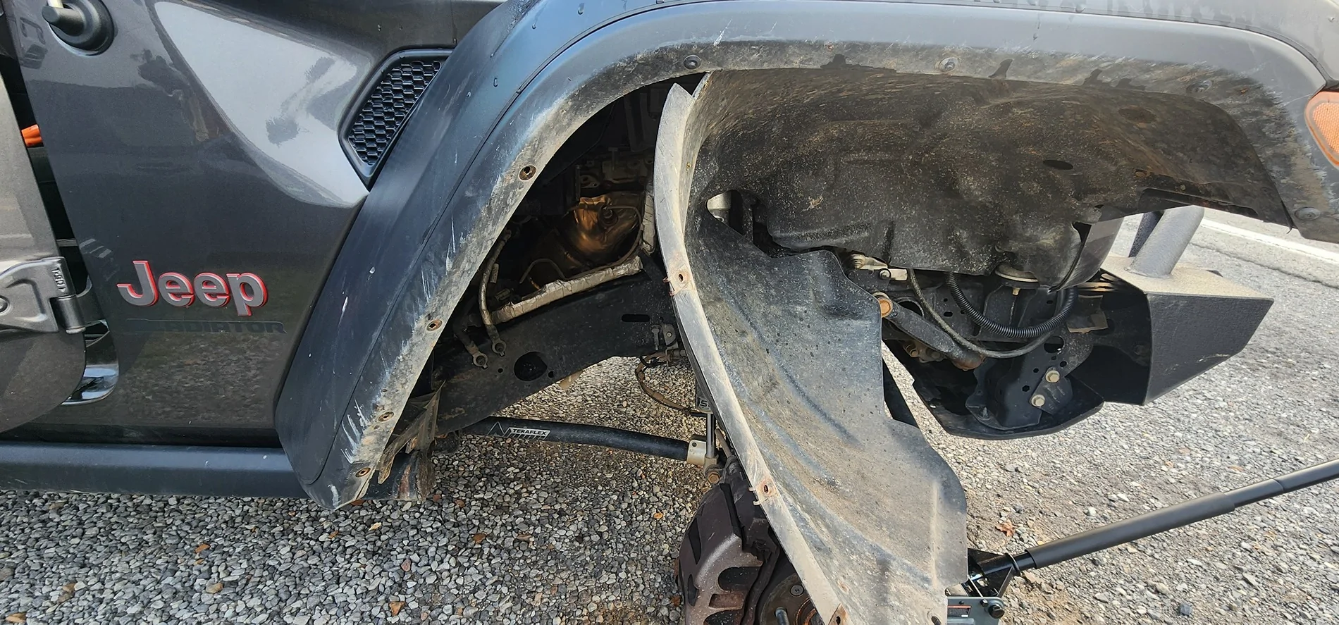

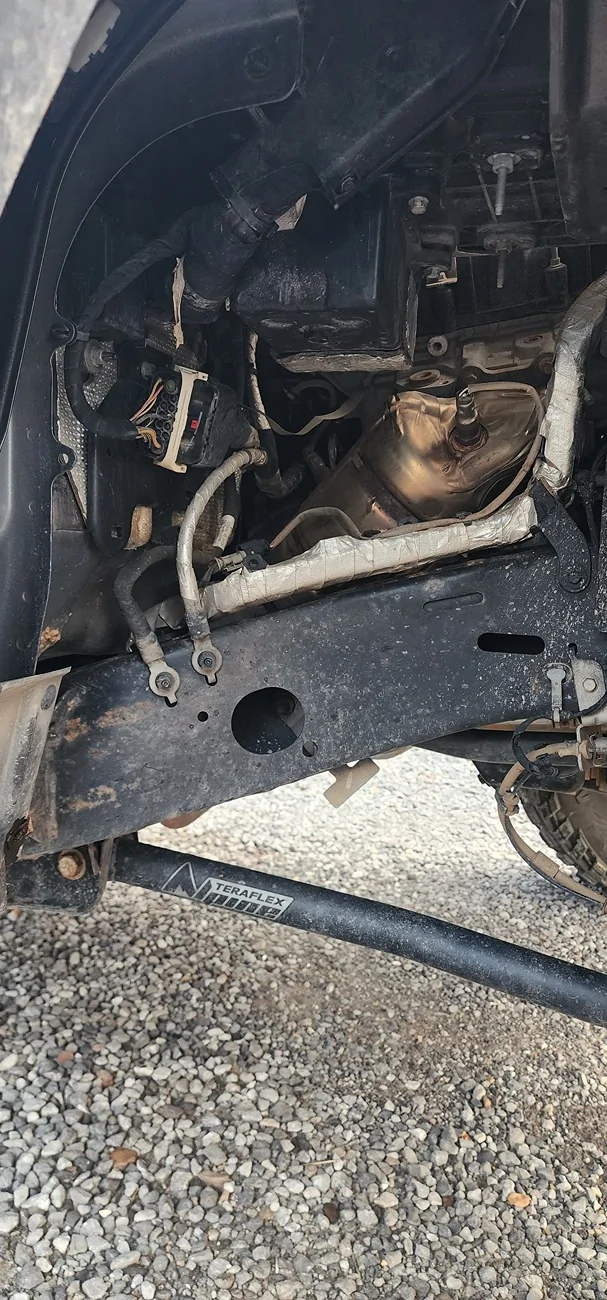

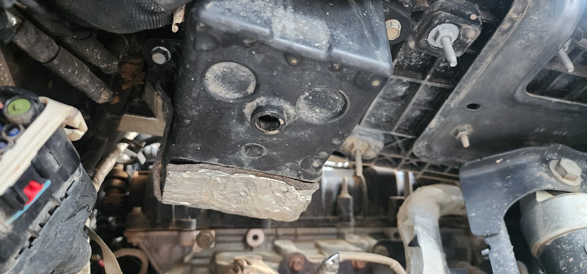

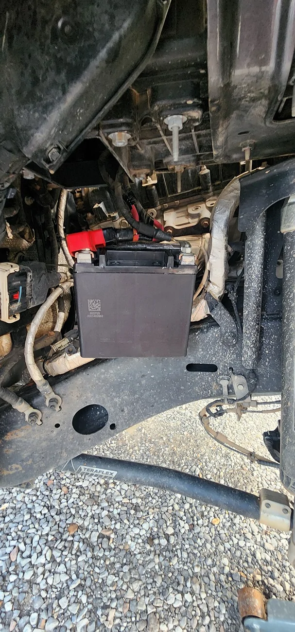

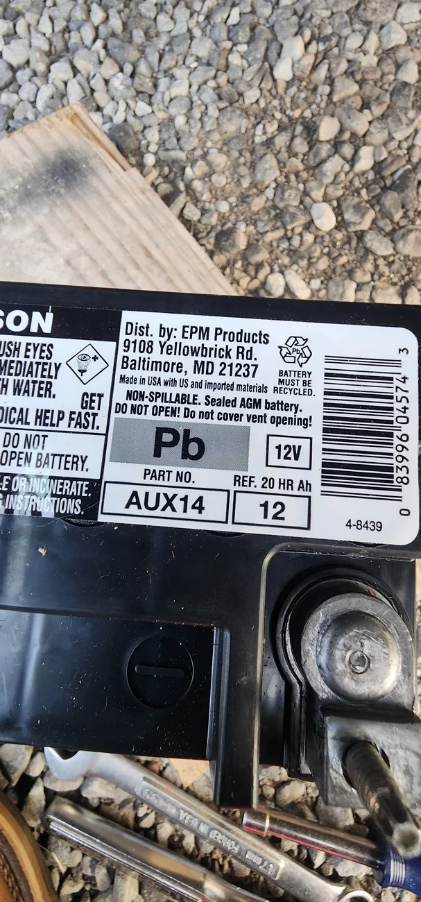

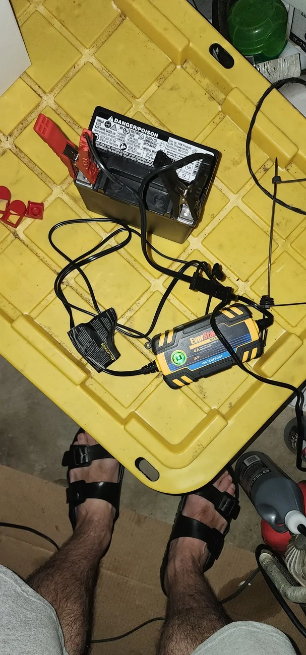

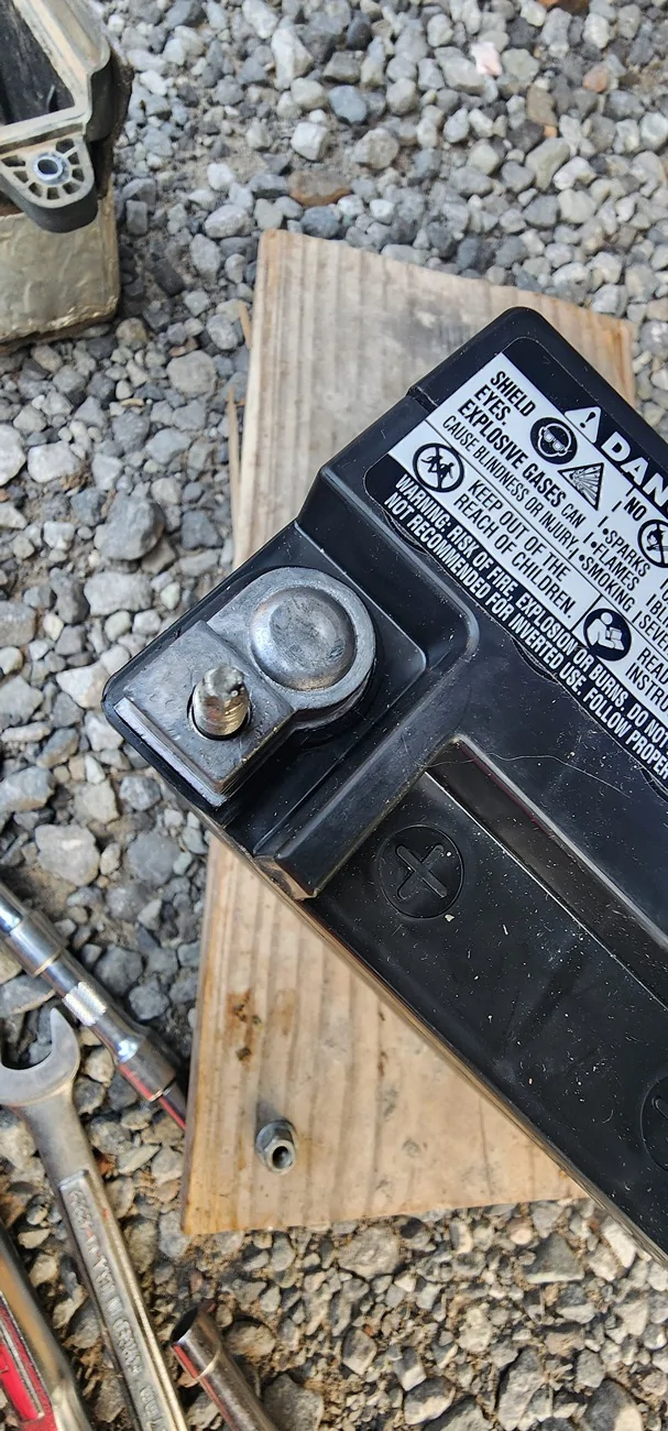

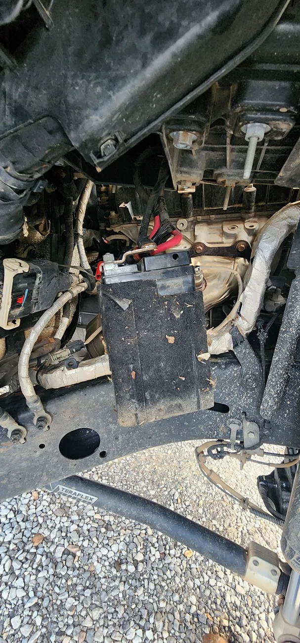

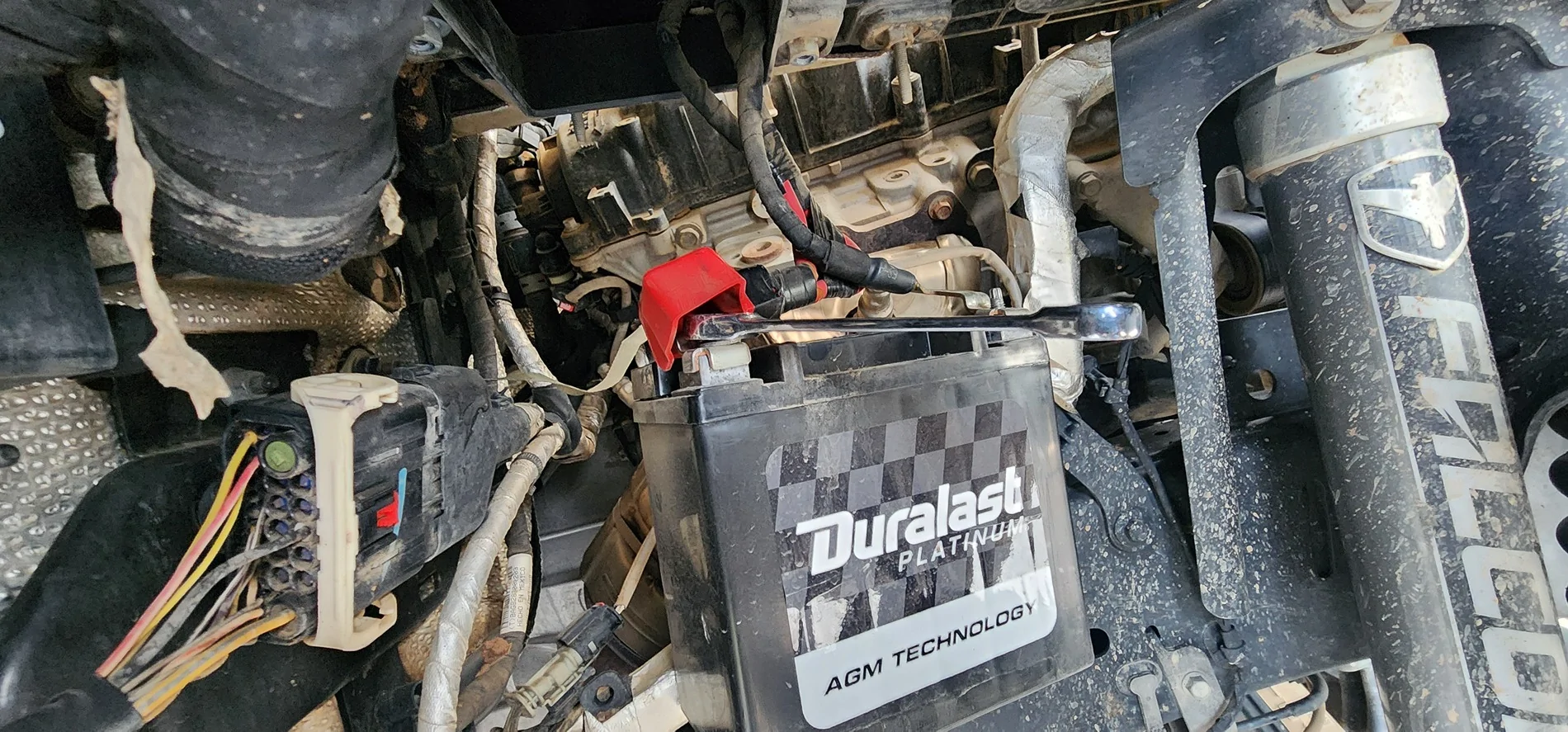

So for the second time I had to replace the Auxiliary Battery, the one I replaced was a dura last 200cca . Well this time I got a Napa 200cca in a group 14 . So hopefully this one last at least 3 yrs. Got up at 530 and went out about 630 had it done by 8am disconnected the negative and also the IBS (3rd time this week 😑😂) as @Minty JL says a post is lame without pics. The next to last pic after I started and the A 🔄 signal is gone.
One thing of note so I decided when I pulled the old one see what it did with the charger and the Son of a Gun was charged in that time it took to replace the Aux. Last pic is me charging the Aux all night long .
Looking at all the pictures, makes me love my diesel even more. So much easier of a job to swap batteries on it.

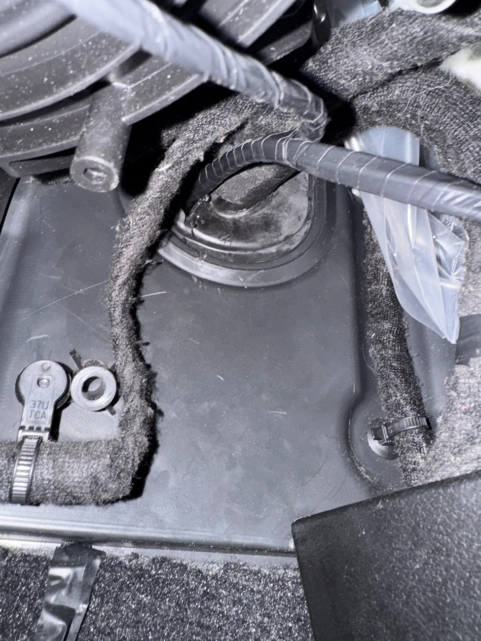

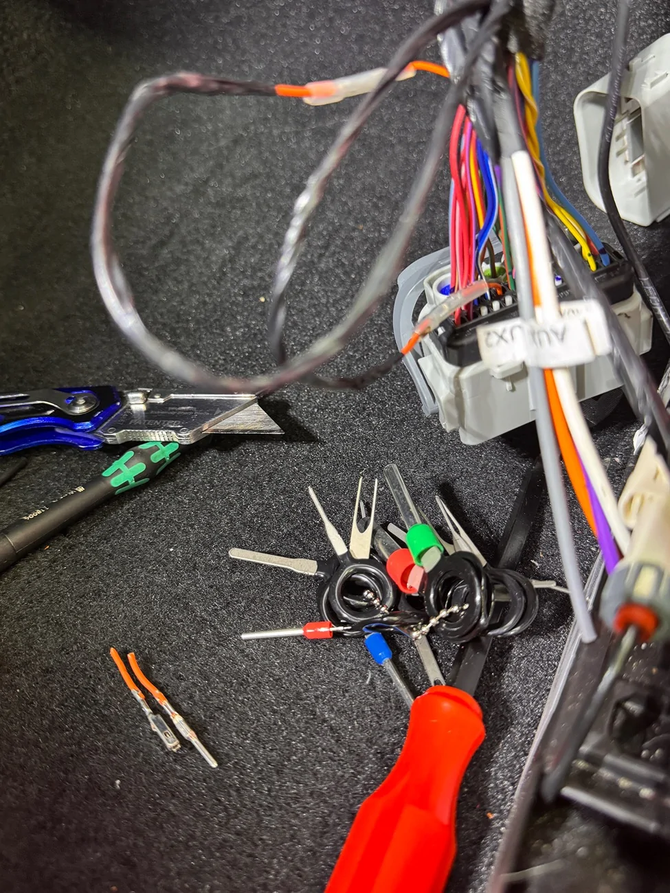

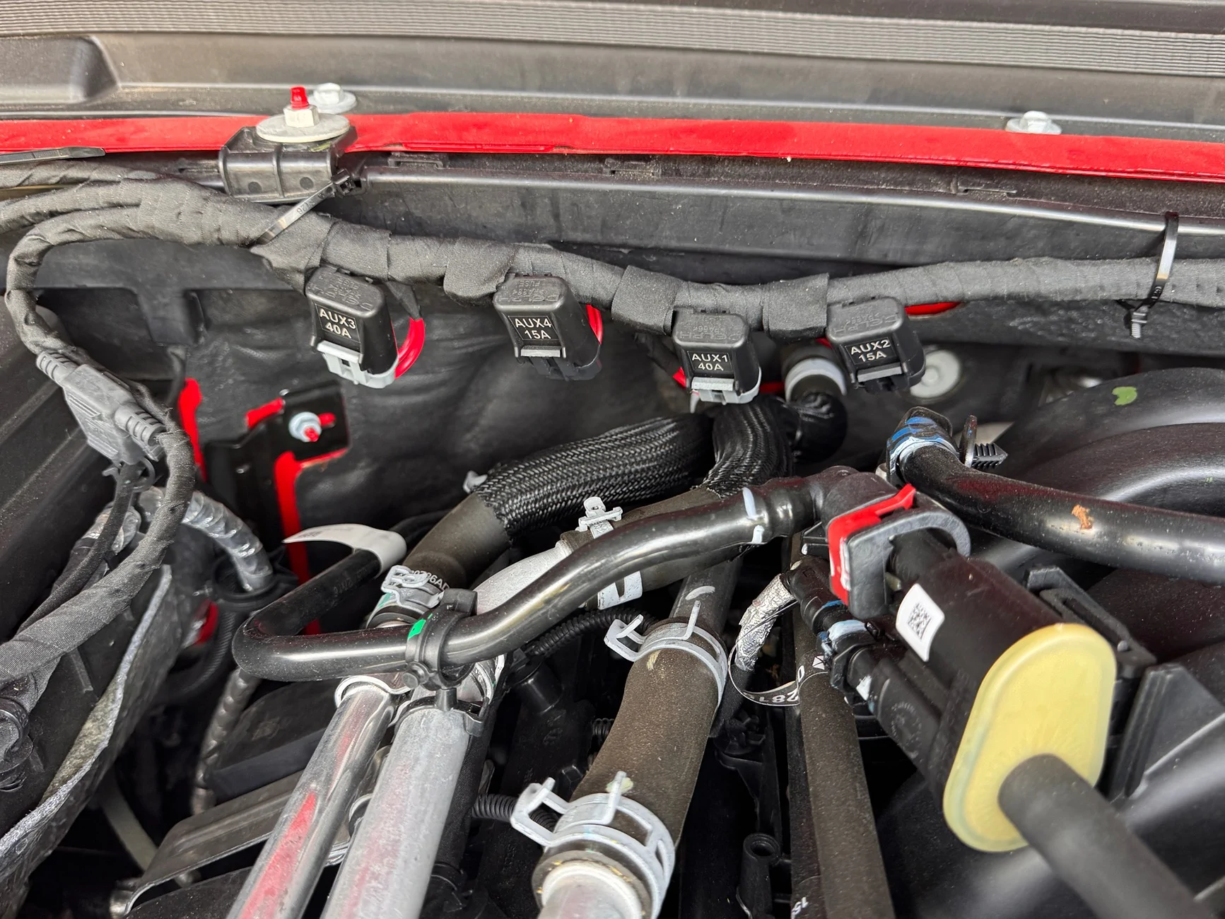

Installed the Mopar Aux Switch Kit. Didn't de-pin the connector but just spliced into the orange wire and continued on. I did try for a bit to get the pin out but was struggling with the de-pin kit I had so just went for the easier method and not worry about the pin. Used the Tazer to program and done.

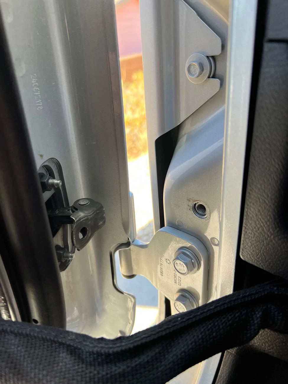

Finally couldn’t deal with the drivers door popping anymore. If this ever happens to you just remove the black bolt and then shut the door. The arm will pop twice and go back into the door. It’s reversible. I actually like this better. It’s old school and allows the door to open slightly more. I might just do it to all the doors.

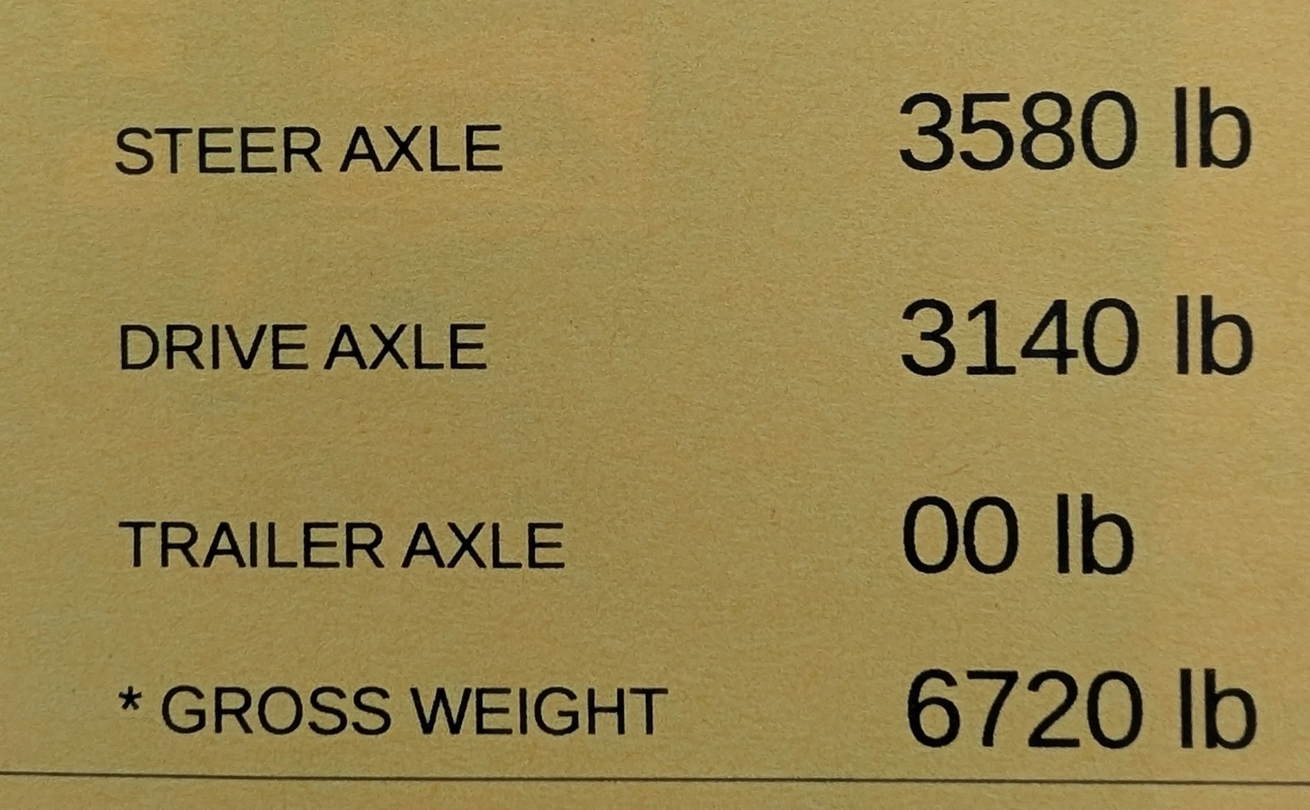

Took it down to the truck stop and weighed it... Been curious since a discussion at SMORR last month, so as I was loading up to go to the Jeep Invasion I loaded it as I would for a wheeling trip and took it down to the scale -

All my gear plus myself (minus a cooler, go bag) -
Firewall pass through looks good. I have done this one before on one of my other JT's and it was bit of a pain. If I was to do it again, probably would just do a bypass splice also on the kick panel connector wire.
