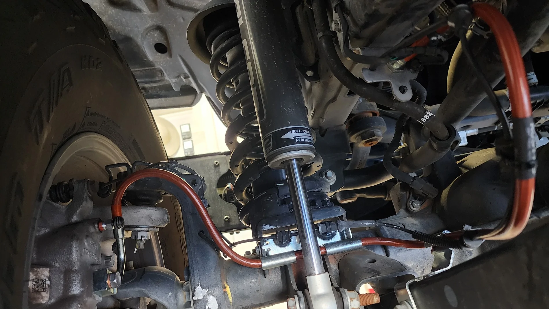

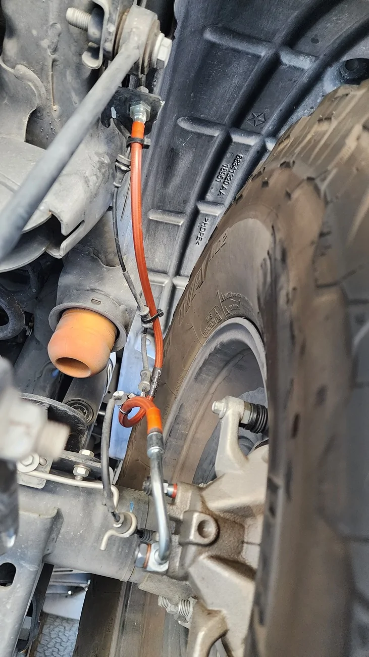

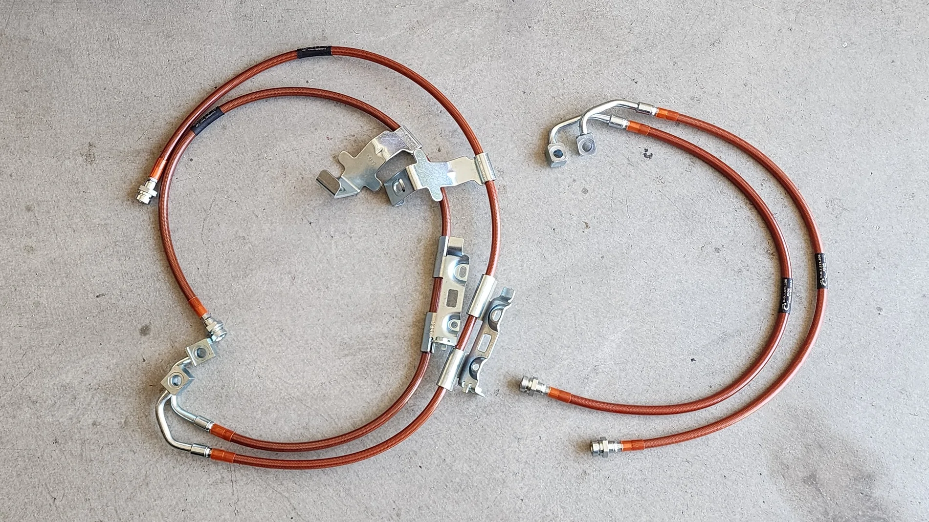

Installed a new set of stainless brake lines to go with the Z36 brakes I previously installed. Took a while to bleed (three times for all, and four for a couple). So much more responsive and feels more firm. The lines are a bit longer than stock. I went with Rusty's (made by Crown Automotive). Pretty happy with the kit.

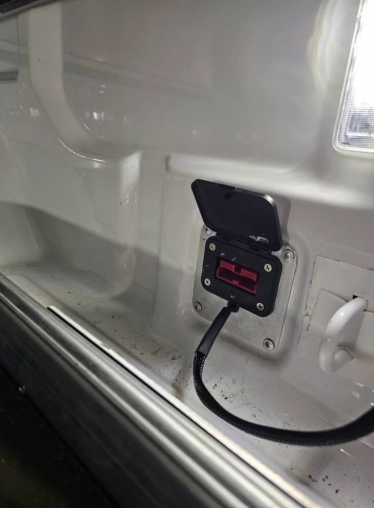

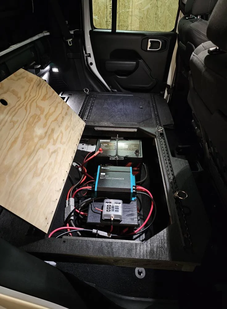

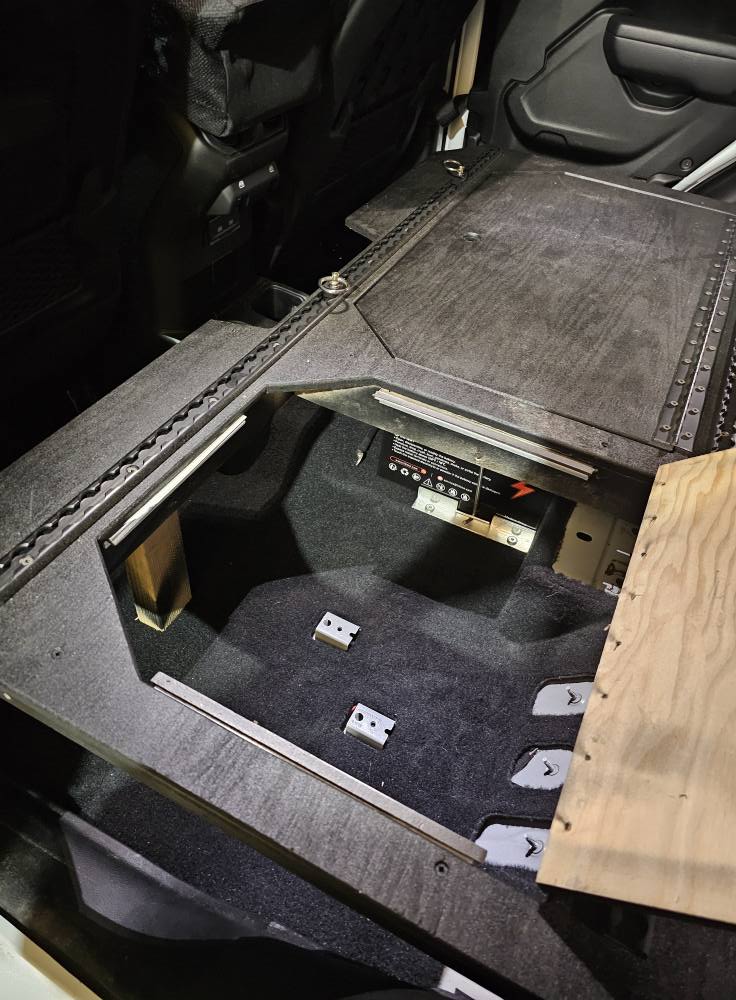

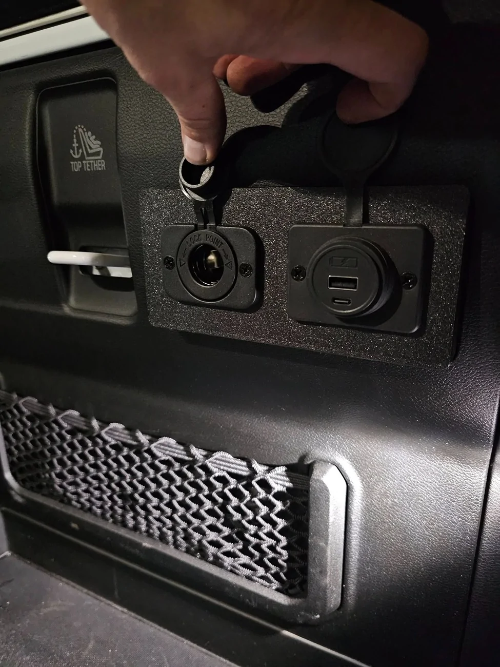

Finally got the house battery system 95% installed. I still need to build the electrical panel that will go in the bed, waiting on a bus bar to finish that. Everything ended up taking more space than I anticipated and I don't like seeing the cabling (even though its under the rear platform, so I'll eventually redo it all and hide the components, I just need to find a way to do so with everything still accessible.
100ah lithium battery, 20a Renogy DC-DC charger with monitor, Anderson plugs to make removal easy. Simple fuse panel in the cab for the 12 outlets and fridge. Electrical panel in the bed will have an Auxbeam for controlling everything else.

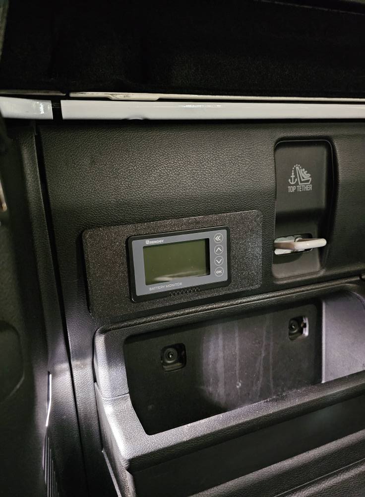

I 3d printed panels for the battery monitor and 12v outlets that replace the bus bar panels on the rear wall. They pop into place well enough but still felt like they aren't quite right, so I'm curious if they stay in place on the trail.

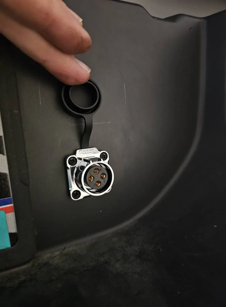

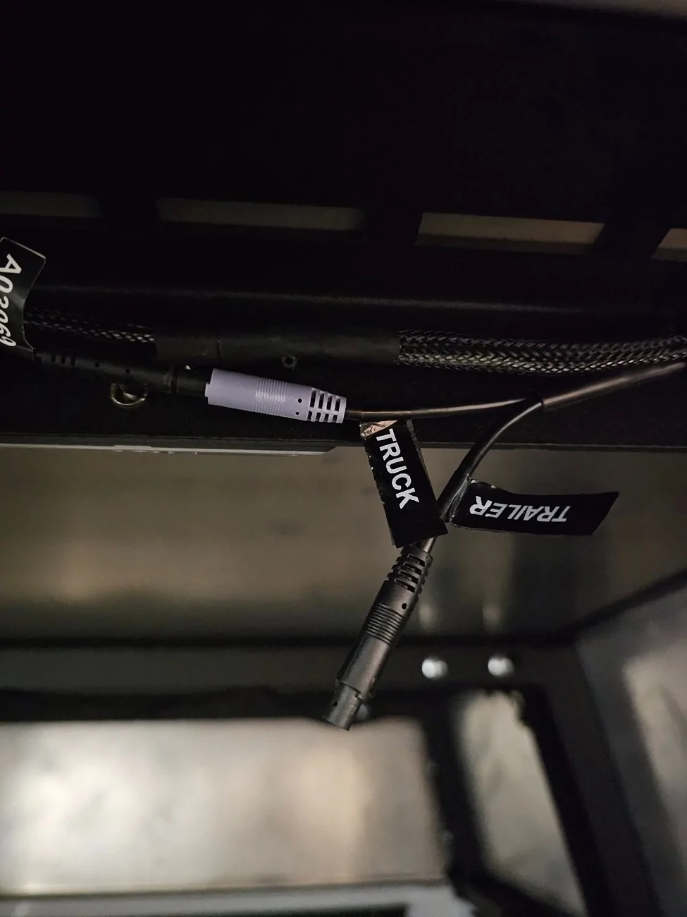

I also ran an extension for the Wolfbox camera down to a plug on the bumper so I can plug in my trailer camera. The Wolfbox wire is tiny and takes some finesse to strip and solder without breaking it. Unfortunately my dumb ass forgot to record what wire went to which pin, so I have to pull it back out, strip the heat shrink off and figure it out.

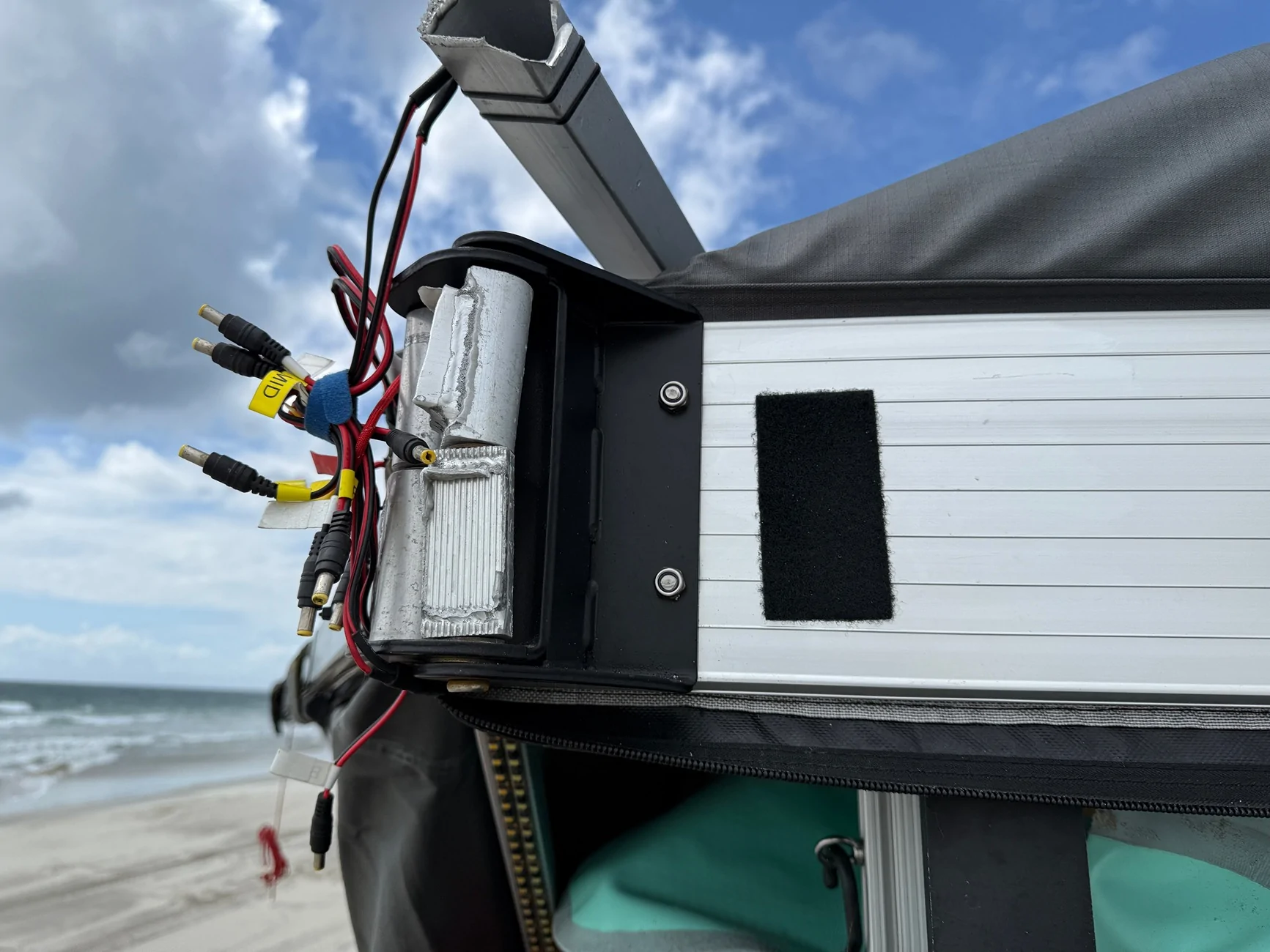

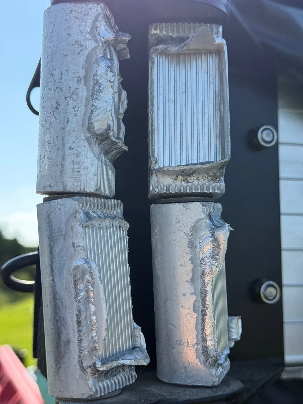

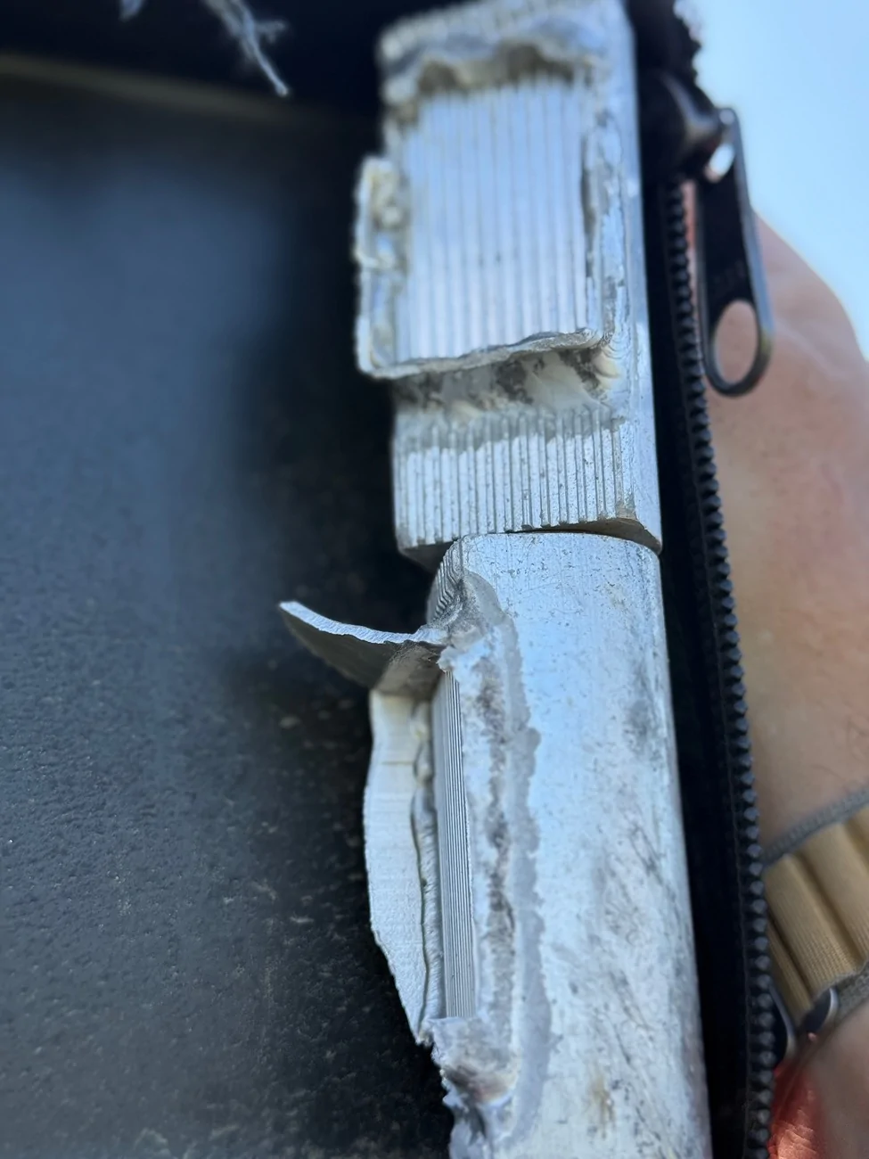

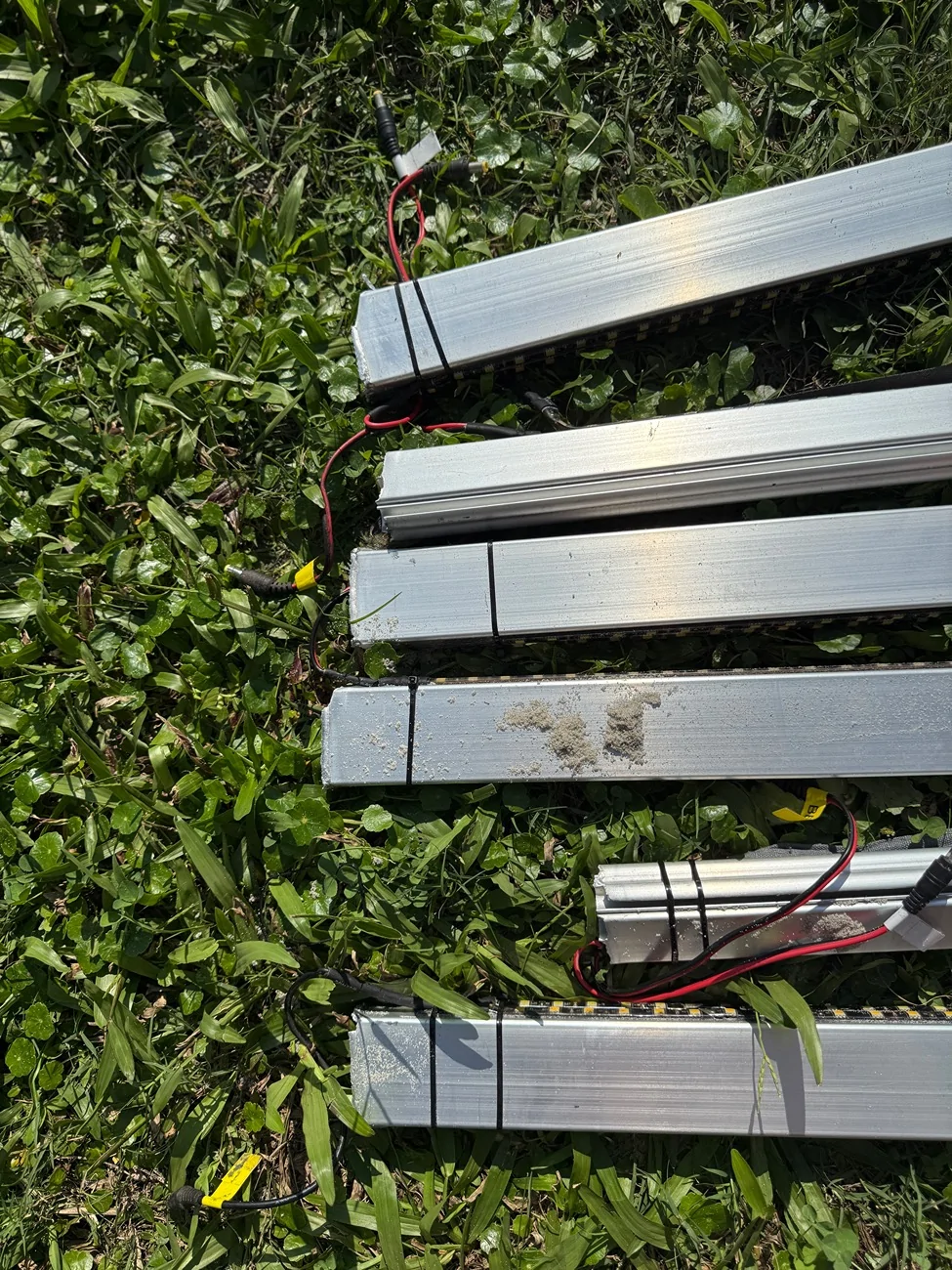

Exploded my OVS awning in 10kt OBX winds and almost killed 2 of us. They’re rated for 40MPH winds, which seems insane. Love the weld quality. Once the first one went, every arm failed at the weld.
I have a love-hate relationship with awnings. They are great to have, but only great when you can use them, and with how fast the weather seems the change these days it's always a gamble whether or not to set em up.

I’ve loved mine in OBX and camping before I got the camper. I can stay on the beach all day under the shade. This one has done well under much stronger wind. I’m going to try and warranty it based on their stated capabilities, its age and those welds.

That made my mind up on awnings
