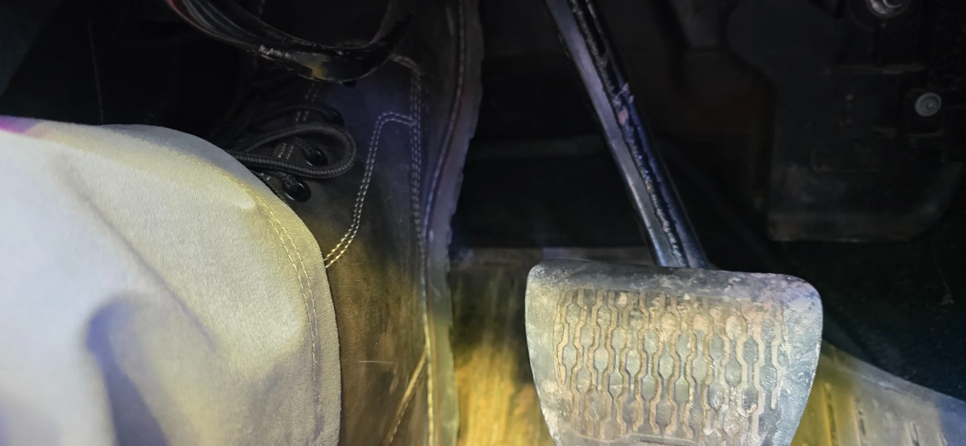

My foot rest flat on the firewall 😂
You must be blessed with long legs!!! Or huge feet! I can’t even get close. Worked with 813 to get an invoice for a dead pedal. Then within 2 days a fridge died epically and the van decided it wanted to identify as a Ford again so Jeepy money went the way of the dodo.
6'5" 215 🦾🦿

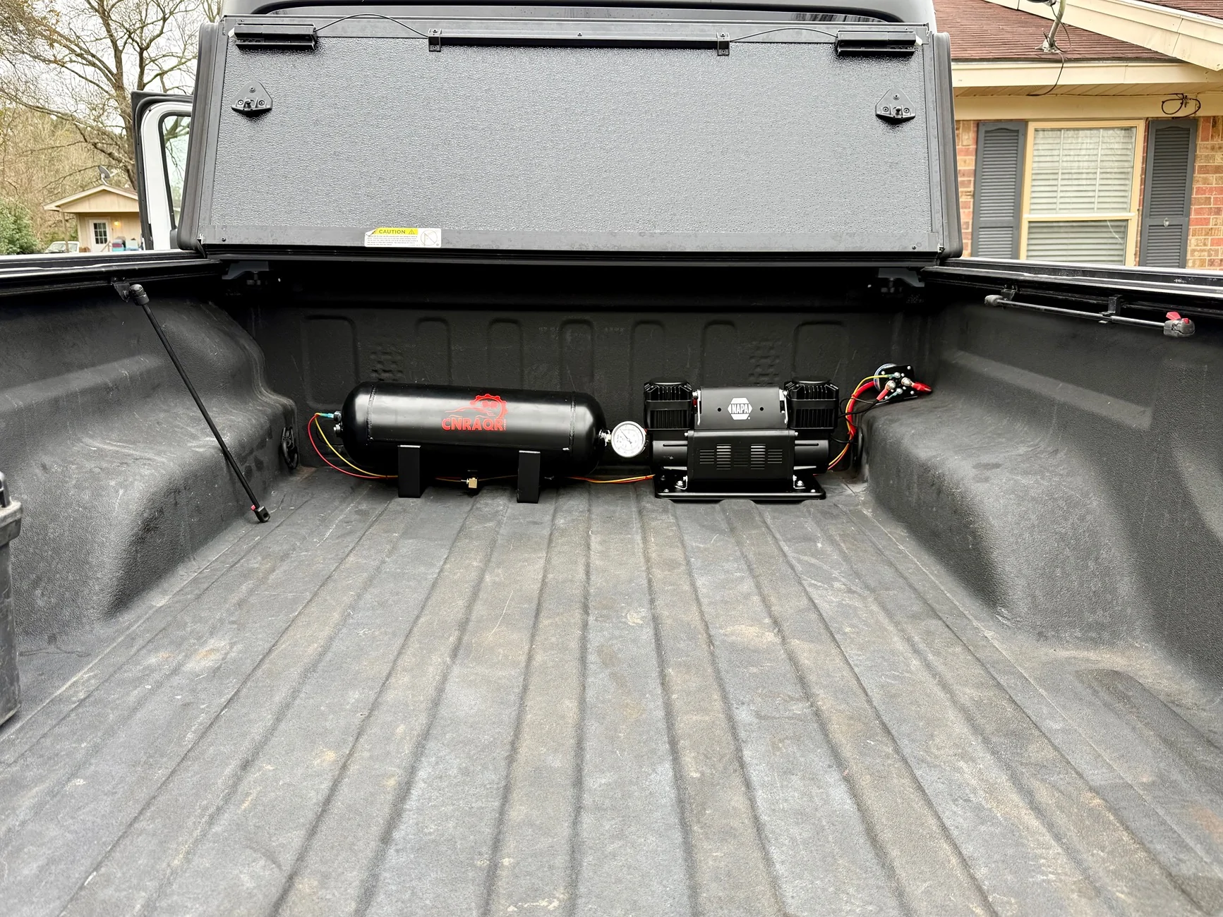

Finally finished my tank for my on board air. Got everything mounted to the front of the bed, using a high amp relay for the main power wire, sunbeam switch to a 90-120 pressure sensor and then pressure sensor to high amp relay.
Pumps up, shuts off, restarts as you’d want.
Gotta run grab a 1/4”npt QD I thought I had already to get my hose in there and I’ll be set.
